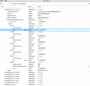

HS01 and SSP1 are sharing the same port. So, you got to have them in info.plist.  You have 4 USB 3.0 ports and probably 2 on board USB 2.0.  Therefore, you should have 6 HS## and 4 SSP# in info.plist. Now, I think you know which port address, like 01 00 00 00,  will be added.

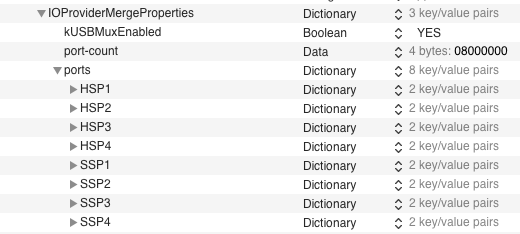

Look at your IORegistryExplorer, under XHC, it should show you HS01 to HS14 (for USB 2.0) and SSP1 (for USB 3.0).  So, you need to modify kext to match your hardware.

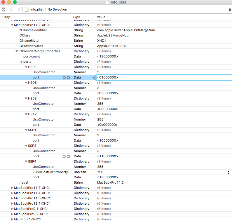

If you want to get all working ports, I would recommend you modify kext for SSP1 to SSP6 and using FakePCIID.kext and FakePCIID_XHCMux.kext to force USB 2.0 devices controlled by EHCI controller.

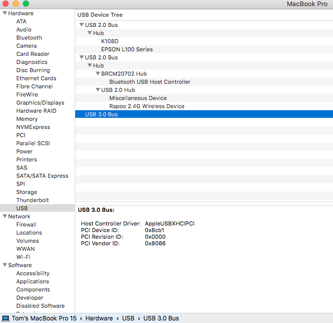

I want to understand this better. Without any modification in El Capitan:
So according to this screenshot:
USB Receiver (Logitech)
USB Flash Drive (Lexar)
USB Flash Memory (Toshiba)
Cruzer
The two back USB 2.0 ports and 1 front USB 2.0 and 1 Front USB 3.0 port are under the USB 3.0 Bus category with PCI Device ID 8C31.

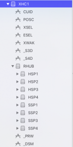

Looking at this in IORegistryExplorer:
I'm not understanding something. Isn't the front USB 3.0 port suppose to fall in SSP1 or SSP2?
From what I read this motherboard uses the VIA controller so this is detected in System Information:
I'm not sure what the other USB 2.0 Bus are for. So what exactly am I suppose to do to make the 4 usb 3.0 ports work? I don't know what the addresses are for the 4 USB ports and according to the guide, it says I have to modify the Device ID. So do I put the VIA device ID? Wouldn't that disable Intel USB (8C31) if I were to do that?
I do see EHCI and EHC2 in the DSDT but I don't think I need to do anything with that.

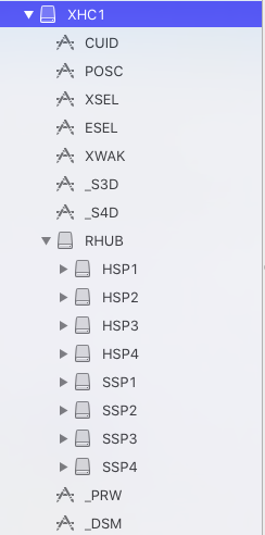

And then I have this under DSDT>_SB.PCI0>XHC>RHUB
So SSP1-SSP6 are my USB 3.0. Question is which one are the 4 USB 3.0 ports?

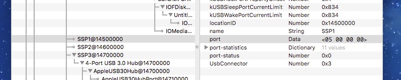

Also, see IORegistryExplorer about data address, like this example of Z77X-UP5 TH.
SSP1 address is 0x05.

Looking at IORegistryExplorer, these back 4 ports are inside AppleACPIPlatfromExpert/PCI0@0/AppleACPIPCI/RP06@1C,5/IOPP/PXSX@0
USB 3.0 devices are controlled by AppleUSB30XHCIPort@00#00000 under PXSX@00000000. So in my case it says that the USB 3.0 device AS2105 uses port (0x05). So one of the back USB 3.0 ports is here. This means that the other 3 back USB 3.0 ports use AppleUSB30XHCIPort@00400000, AppleUSB30XHCIPort@00300000, and AppleUSB30XHCIPort@00200000 when a 3.0 device is connected.
When a 2.0 device is connected, they are listed under AppleUSB20XHCIPort@00100000 > USB2.0 Hub @00100000.
So USB Flash Drive is using address 00110000, USB Flash Memory is using address 00120000, and Mass Storage Device is using address 00130000.
And then I decided to see what exactly each of the back usb 3.0 port belongs to:
PORT 1
USB 3.0 Device = AppleUSB30XHCIPort@00200000
USB 2.0 Device = AppleUSB20HubPort@00110000
PORT 2
USB 3.0 Device = AppleUSB30XHCIPort@00300000
USB 2.0 Device = AppleUSB20HubPort@00120000
PORT 3
USB 3.0 Device = AppleUSB30XHCIPort@00400000
USB 2.0 Device = AppleUSB20HubPort@00130000
PORT 4
USB 3.0 Device = AppleUSB30XHCIPort@00500000
USB 2.0 Device = AppleUSB20HubPort@00140000
So what does this mean? Is it not possible to fix this problem on this motherboard? Seems very different to that of the guide.
I've attached an IOReg dump if anyone else wants to take a look at how this motherboard is structured. SSP1 is not active because I did not connect a 3.0 device to it. AppleUSB20HubPort@00140000 is not active because the device connected to it is a 3.0 device.
MSI H81ME34 IOREG.zip
@ GhostRaider
Now, I got the point.  The board with H81 chipset will support only two USB 3.0 and eight USB 2.0. (see http://ark.intel.com/products/75016/Intel-DH82H81-PCH)
So, MSI H81M back four USB 3.0 will be hosted by VIA VL805 after I looked at the manual and more information.
Therefore, you don't have to do anything about USB 3.0/2.0 that controlled by H81 chipset.

Today I upgraded from Public Beta 4 to 5, and after that my USB3.0 all became USB2.0. See the screenshot. The USB3.0 port could work, but they displays as USB2.0 ports rather than USB 3.0.
Screenshot. The Bluetooth was on USB3.0 before update and became USB2.0 after upgrading to Public Beta 5.
USB3.0 are all right under 10.10, and El Capitan Public Beta 1, 2, 3, and 4. Native drivers, no third-party kexts for USB.
Do you have a USB 3.0 Bluetooth adapter? Otherwise it should be showing up under USB 2.0 Hub.
I fixed my El Capitan USB issues for the build in my signature as followed.
Changed my USB 2.0 device names from EHC1/EHC2 > EH01/EH02 via DSDT. Left the USB 3.0 device XHC alone and installed FakePCIID.kext & FakePCIID_XHCMux.kext into /EFI/Clover/Kexts/10.11/ or /System/Library/Extensions/ or /Library/Extension/
Now every USB port is working like it should, just like Yosemite with the USB 3.0 Multiplex patch.

Do you know the reason for the issue of USB3.0? Will there be methods that do not require DSDT?
Maybe the future FakeSMC will figure it out even we do not need the third party kext.
Tom
PS the Bluetooth displayed as USB3.0 on Yosemite. This 94360.now it displays as USB2.0.

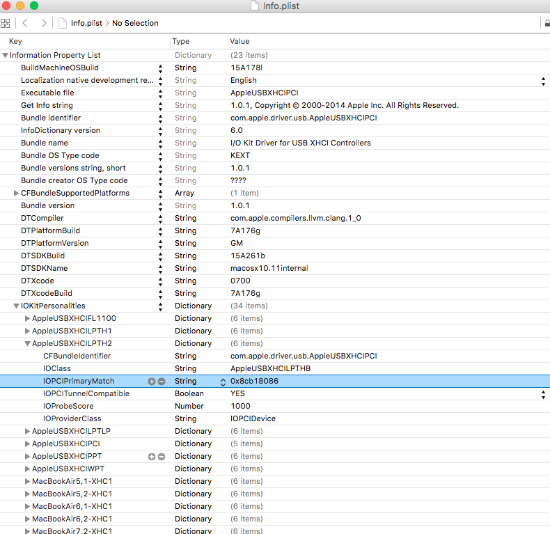

My USB3.0 device's ID is 8086 8cb1. This device ID is included in the kext of IOUSBHostFamily.kext/Contents/Plugins/AppleUSBXHCIPCI.kext/Contents/Info.plist
So it should be natively compatible, but it is not be.
So, first thing is that you look at your DSDT. You search for your XHC1 and look there how many ports do you have there.
Then you open that Info.plist and fill it with the number of ports you have in your DSDT.
Then you change the port-count to the exact number of ports you have there. (it has to be in hexadecimal ;) )
This same exact thing is written in the first post. :) Just more in depth. You should've read that like 10 times slowly to understand it.

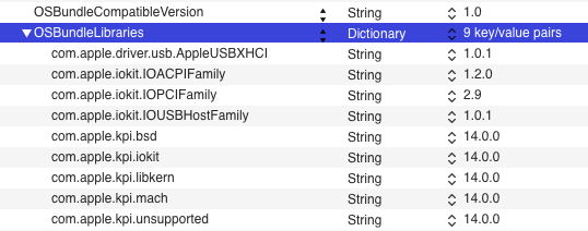

Oh, and now you need to change in the Info.plist two dependencies.
com.apple.driver.usb.AppleUSBXHCI from 1.0 to 1.0.1
com.apple.iokit.IOUSBHostFamily from 1.0 to 1.0.1
The port-count is actually not a "count of ports", but actually the maximum value for 'port' in the 'ports' dictionary.
Poor naming on the part of Apple.
