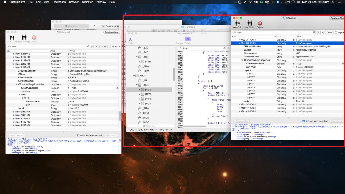

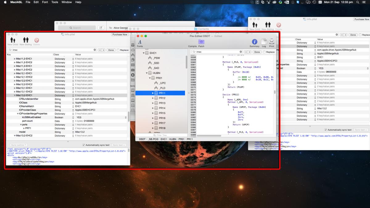

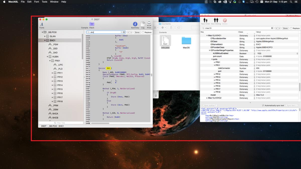

Cameron Nicholson Posted September 21, 2015 Share Posted September 21, 2015 Hey Poken, Two of my rear usb 2.0 ports aren't working on my Asus P8z77-v LK. So I followed part 2b of you guide. 2b. Add ports to Ports Restriction In this method, you will enable port restriction and add your ports. To enable port restrictions: - For USB 2.0, rename your USB to EHC1/EHC2 or change IONameMatch. - For USB 3.0, rename your USB to XHC1 or change IONameMatch. Then, you have to identify which ports you have in your DSDT. For example, my XHC1 has ports at 1, 2, 3, 4: However, the SMBIOS MacBookPro9,2 I'm using only contains ports 1, 2, 5, 6 (note that port name is not important): So I had to add ports 3 4, and the ports work again! Please note that there is still a limitation of 15 ports (discovered by VCH888). For example: If your DSDT defined 14 USB 2.0 ports HS01->HS14 and 6 USB 3.0 ports SS01->SS06, OS X will only recognize HS01->HS14 and SS01. To fix this problem, you have to identify which ports are real and which ports are unavailable, then add only valid ports. You can find example here: http://www.insanelymac.com/forum/topic/306777-guide-usb-fix-el-capitan-1011/?do=findComment&comment=2147401 My DSTD and Info was this - EHC1 XHC1 So I changed EHC1 to this And the two USB ports still aren't working, any idea what's wrong?Thanks Link to comment https://www.insanelymac.com/forum/topic/306777-guide-usb-fix-el-capitan-1011/page/13/#findComment-2169335 Share on other sites More sharing options...

TheRacerMaster Posted September 21, 2015 Share Posted September 21, 2015 Hey Poken, Two of my rear usb 2.0 ports aren't working on my Asus P8z77-v LK. So I followed part 2b of you guide. My DSTD and Info was this - EHC1 EHC1.jpg XHC1 XHC1.jpg So I changed EHC1 to this EHC1-new.jpg And the two USB ports still aren't working, any idea what's wrong? Thanks Post an IOReg dump with IORegistryExplorer v2.1. Link to comment https://www.insanelymac.com/forum/topic/306777-guide-usb-fix-el-capitan-1011/page/13/#findComment-2169523 Share on other sites More sharing options...

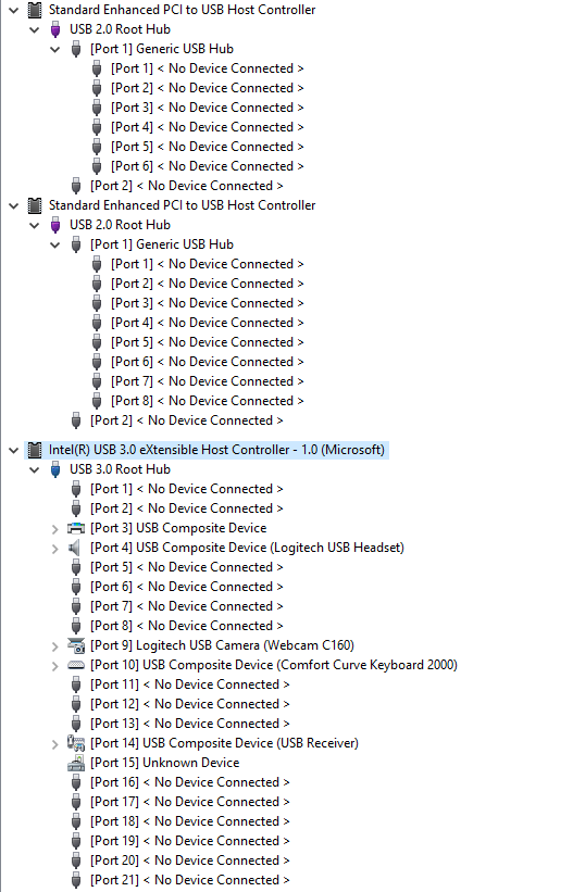

RealJoe Posted September 22, 2015 Share Posted September 22, 2015 I found Microsoft Windows 10 also put all USB 2.0 and 3.0 ports together in the XHC controller. The only difference is they don't have 15 port limitation. See the photo (Gigabyte Z97 board + Windows 10). So, we'd better find a way to unlock 15 port limitation in AppleUSBXHCI.kext ??? Link to comment https://www.insanelymac.com/forum/topic/306777-guide-usb-fix-el-capitan-1011/page/13/#findComment-2169673 Share on other sites More sharing options...
