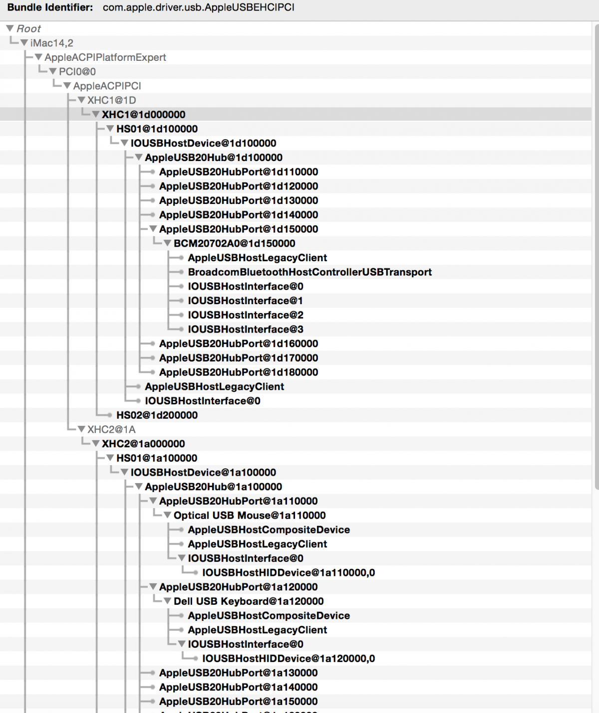

GhostRaider Posted September 25, 2015 Share Posted September 25, 2015 According to your IOReg your AS2105 is under a USB2.0 hub under the RP06/PXSX device. Not sure why this is happening, but this is probably what's limiting your speeds to USB 2.0. I think third-party xHCI controllers won't work for the time being with USB 3.0, so OS X is probably forcing all devices to connect to the USB 2.0 ports. Actually I forgot that I was using the FakePCIID Mux kext. That could be the reason why the AS2015 is detected as a USB 2.0 device. I remember before it was found under PXSX > AppleUSB30XHCIPort. So that means that any third party XHCI controller like VIA won't work with any USB fix for El Capitan unless someone makes some sort of XHCI kext? So far I haven't seen anybody here with this controller. Link to comment https://www.insanelymac.com/forum/topic/306777-guide-usb-fix-el-capitan-1011/page/15/#findComment-2170161 Share on other sites More sharing options...

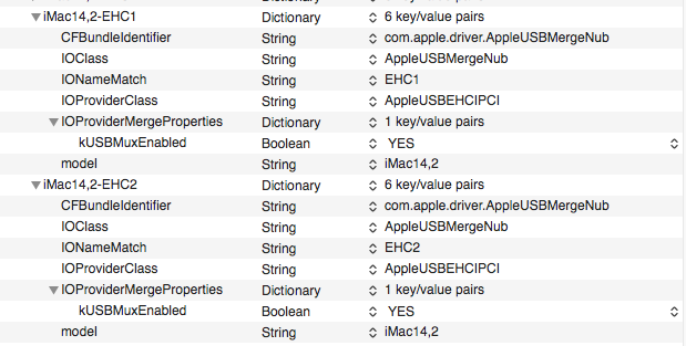

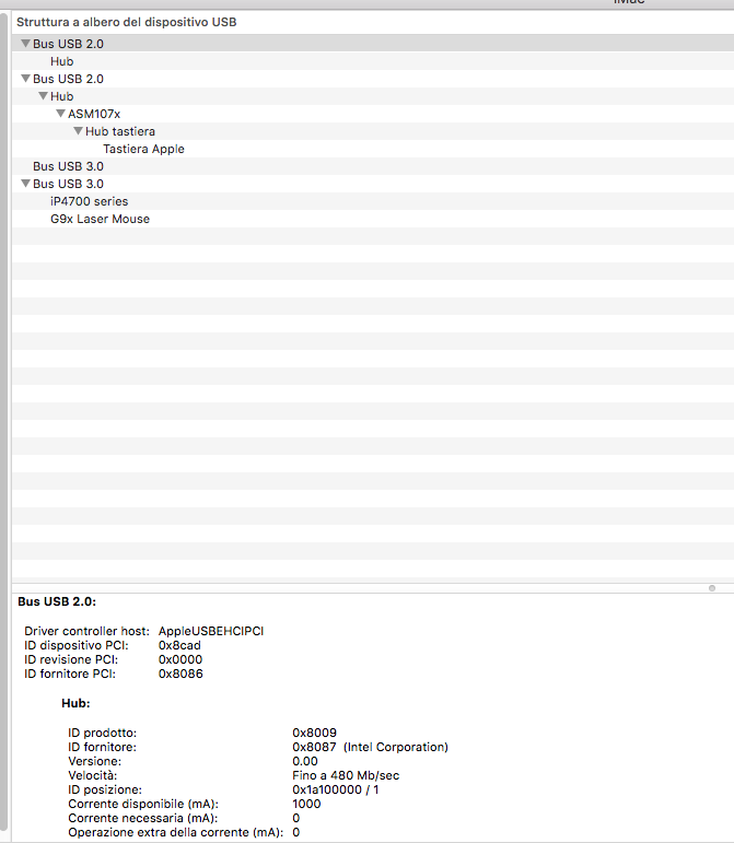

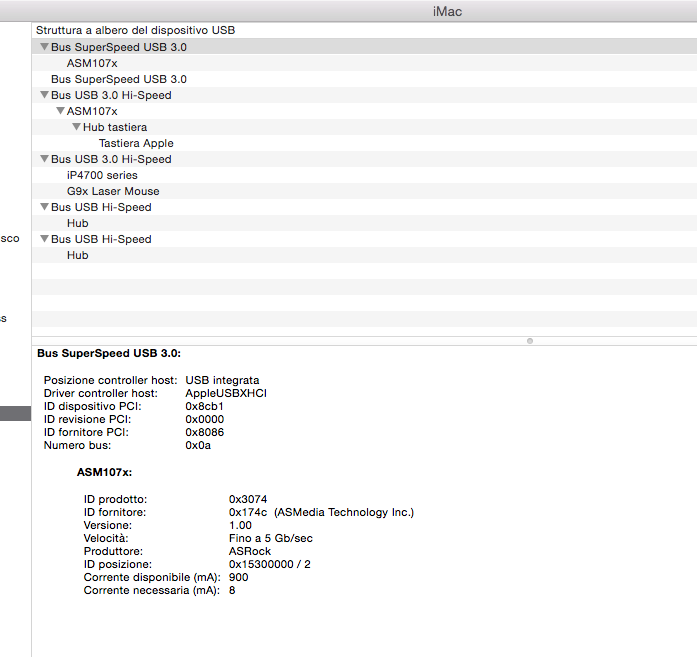

magnifico Posted September 28, 2015 Share Posted September 28, 2015 Hi Poke How are you? Listen me..i use imac 14,2 and i dont have restriction in info.plist....but why i see in system information USB2 ? That is a normal? Whyle on Yosemite i see only USB3 Only curiosity...for you what i need? 1 Link to comment https://www.insanelymac.com/forum/topic/306777-guide-usb-fix-el-capitan-1011/page/15/#findComment-2170908 Share on other sites More sharing options...

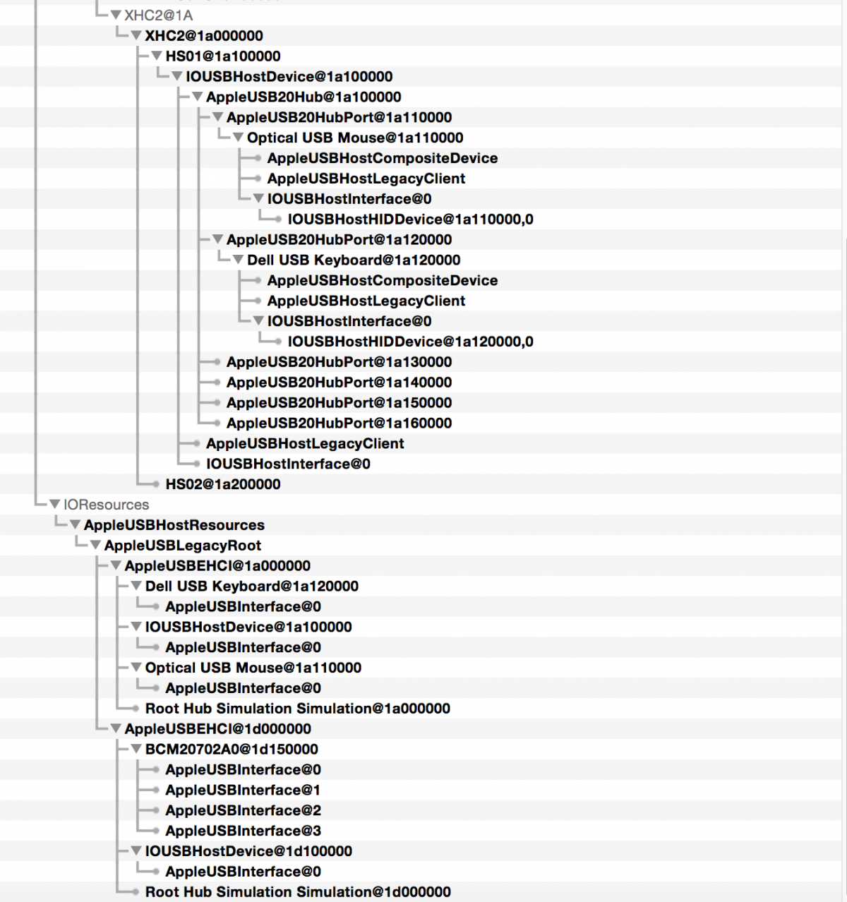

david_osx Posted September 28, 2015 Share Posted September 28, 2015 So I finally have all Intel USB2 ports working and no Panic on boot. I do not have to disable ASMedia USB3 in Bios. I just use the SSDT I mentioned in post #342 and an un-modified Dummy XHCI. What goes over my head is how can the USB2 and USB3 ASMedia ports all work if I do not use any 3rd party kexts or injectors and deal with the kernel panic and try to boot past it about 8 to 10 times I finally boot. I get the flood of ASMX messages and all but 3 of the ASMedia USB 3 ports are working. How is this possible? Ioreg screehshot link of all but a couple of USB3 ports working after about 8 to 10 reboots and get past the panic: http://www.insanelymac.com/forum/topic/306777-guide-usb-fix-el-capitan-1011/?p=2169752 Current Ioreg Screenshots with Dummy kext and properly edited SSDT all USB2 ports working: hey oSxFr33k could you help me fix my usb 2.0 and 3.0 i don't understand where to start man.. this screen is from 10.10.5 btw Link to comment https://www.insanelymac.com/forum/topic/306777-guide-usb-fix-el-capitan-1011/page/15/#findComment-2170921 Share on other sites More sharing options...
oSxFr33k Posted September 28, 2015 Share Posted September 28, 2015 @david_osx, Which motherboard do you have? Put all your PC's in your signature. I was kinda lucky to have a properly edited ssdt. I just use the dummy xhci kext to get around kernel panic. Other than that I don't think I can be much help. I will try though. Link to comment https://www.insanelymac.com/forum/topic/306777-guide-usb-fix-el-capitan-1011/page/15/#findComment-2170938 Share on other sites More sharing options...

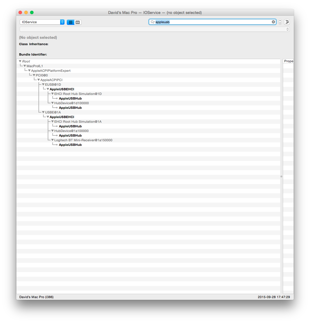

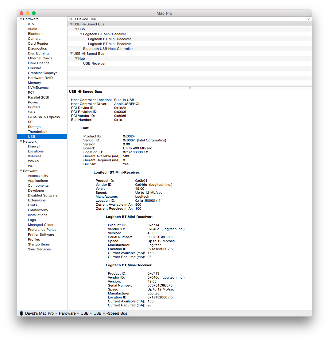

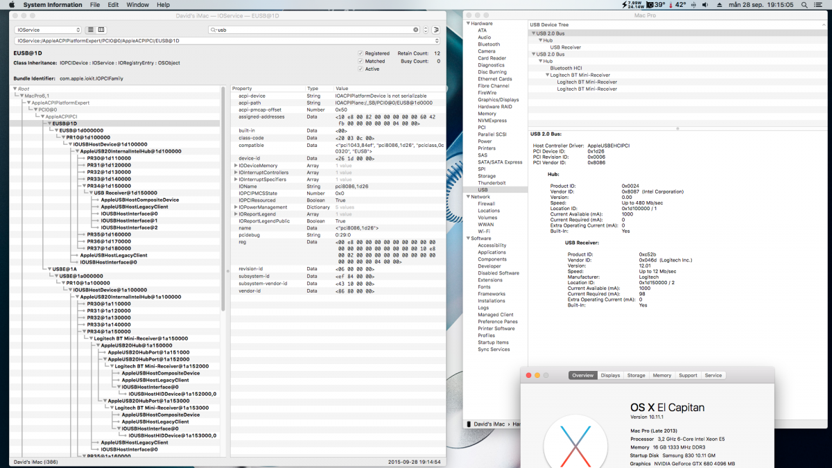

david_osx Posted September 28, 2015 Share Posted September 28, 2015 ok this one is from 10.11 1 Link to comment https://www.insanelymac.com/forum/topic/306777-guide-usb-fix-el-capitan-1011/page/15/#findComment-2170946 Share on other sites More sharing options...
oSxFr33k Posted September 28, 2015 Share Posted September 28, 2015 ok this one is from 10.11 So you can boot without panic if you don't run any kext like dummy? I get kernel panic. I have the Asus X79-Deluxe and I wonder now if its the built in Wifi/USB card. I am going to remove that card and see if the panic goes away. You basically have the same chipset Asus X79 Sabertooth just without Wifi/BT. Just grab the Rampagedev DMG for your board and get the ssdt's from there. Boot with them let me know what happens. I would also think about using smbios for iMac14,2 instead of MacPro6,1. If all your USB2 ports are working then I think you are good to go. The USB3 are ASMedia and we have to wait for new GenericUSBXHCI.kext or equivalent. I don't think the developer will be updating this any longer. Edited: I also see you are on 10.11.1 Beta. So no kernel panic on 10.11 or 10.11.1 without dummy kext? Link to comment https://www.insanelymac.com/forum/topic/306777-guide-usb-fix-el-capitan-1011/page/15/#findComment-2170963 Share on other sites More sharing options...

david_osx Posted September 28, 2015 Share Posted September 28, 2015 i've disabled ASMedia USB3 controller or else 10.11 panics but my goal now is to get all usb 2 and 3.0 to work in 10.11 or yosemite Link to comment https://www.insanelymac.com/forum/topic/306777-guide-usb-fix-el-capitan-1011/page/15/#findComment-2171011 Share on other sites More sharing options...

magnifico Posted September 29, 2015 Share Posted September 29, 2015 @ PJ Why is it strange? all USB ports on the back panel(asrock ) are usb3 ... it seems strange to me that El see USB2 is not very clear. While on Yo i see usb3 highspeed Link to comment https://www.insanelymac.com/forum/topic/306777-guide-usb-fix-el-capitan-1011/page/15/#findComment-2171088 Share on other sites More sharing options...
