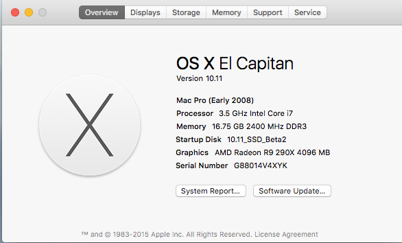

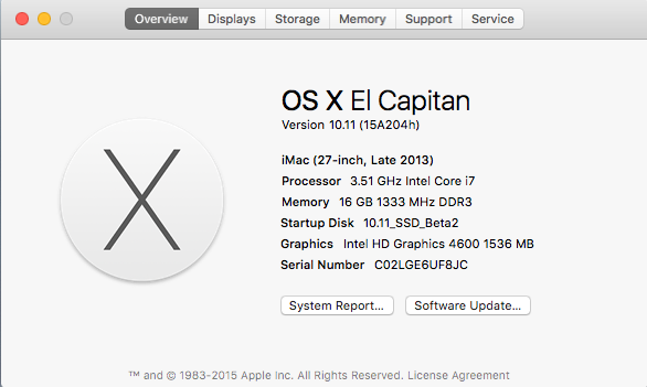

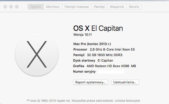

I have Asus R9 290x. In 10.11 dp2 work natively, without any patching.
Glad to know that because I am using 10.11 DP2 too.
Can you show me your config.plist if you boot by Clover or org.chameleon.Boot.plist if boot by Chameleon ?
Because this Asus 290X worked natively in 10.10.4, however no such luck in 10.11 DP2 now.

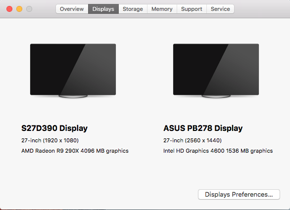

What really bothers me is in System Preference and About This Mac/Display there is HDMI display from AMD R9 290X card,
but actually it shows blank screen in HDMI monitor.
Hope it's not due to hardware problem in this card like over-heating, inadequate power supply, etc.
Immediately reboot to 10.10.4 resumed everything is working again !
The first one shows working in 10.10.4.
Anyone had the similar experience for AMD R9 290X card in 10.11 DP1 or DP2 ?

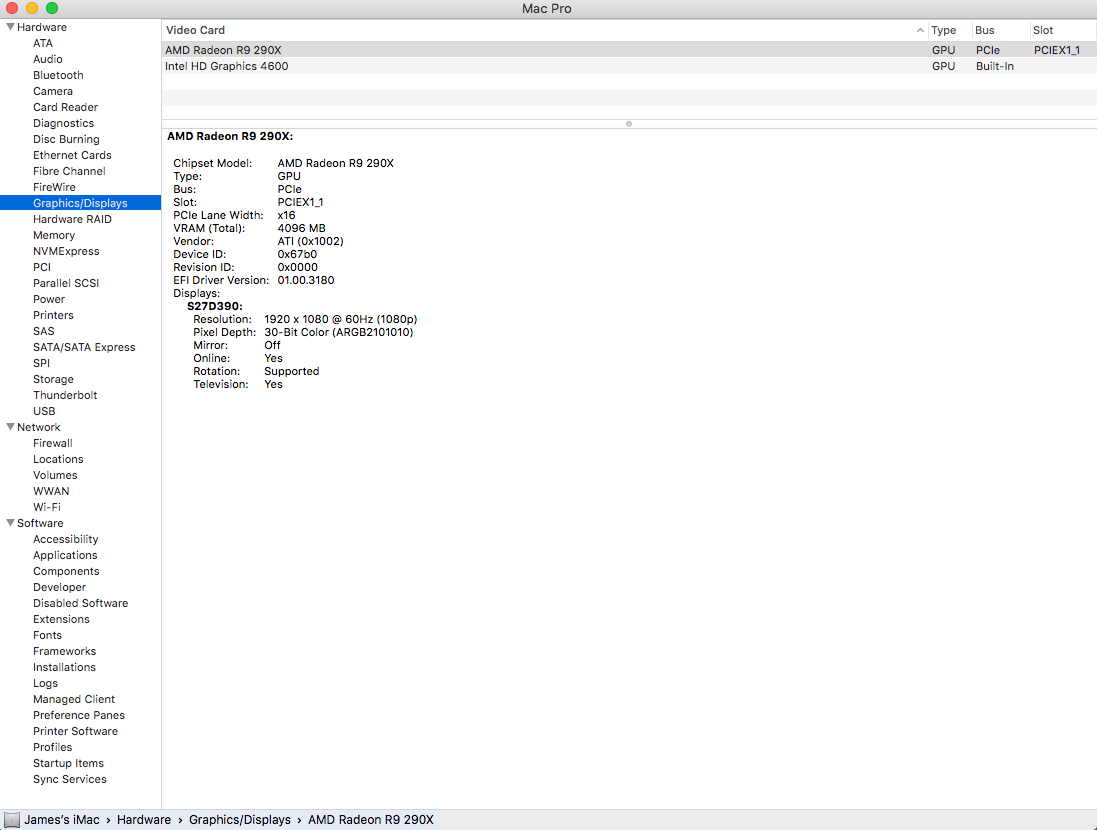

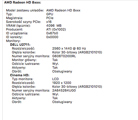

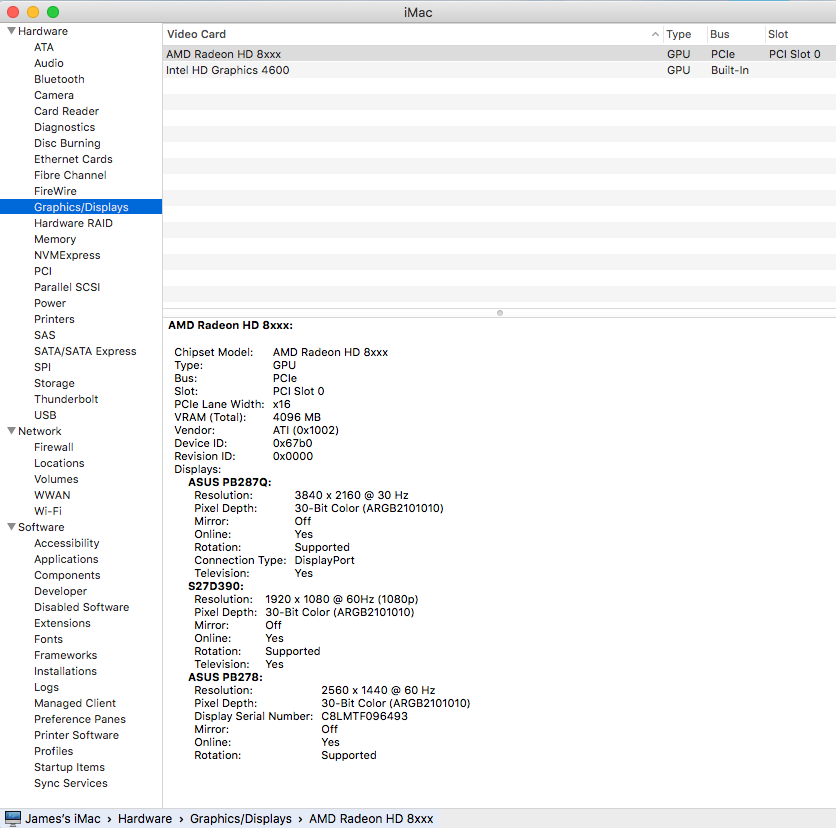

your 30-bit color is confusing. It says ARGB (Alpha Red Green Blue) 2101010 (2 10 10 10) that equals 32, not 30. Plus, if it's 30 then you have no Alpha channel (no transparency) and if it's 32, you only have a 2-bit alpha channel. Odd

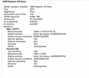

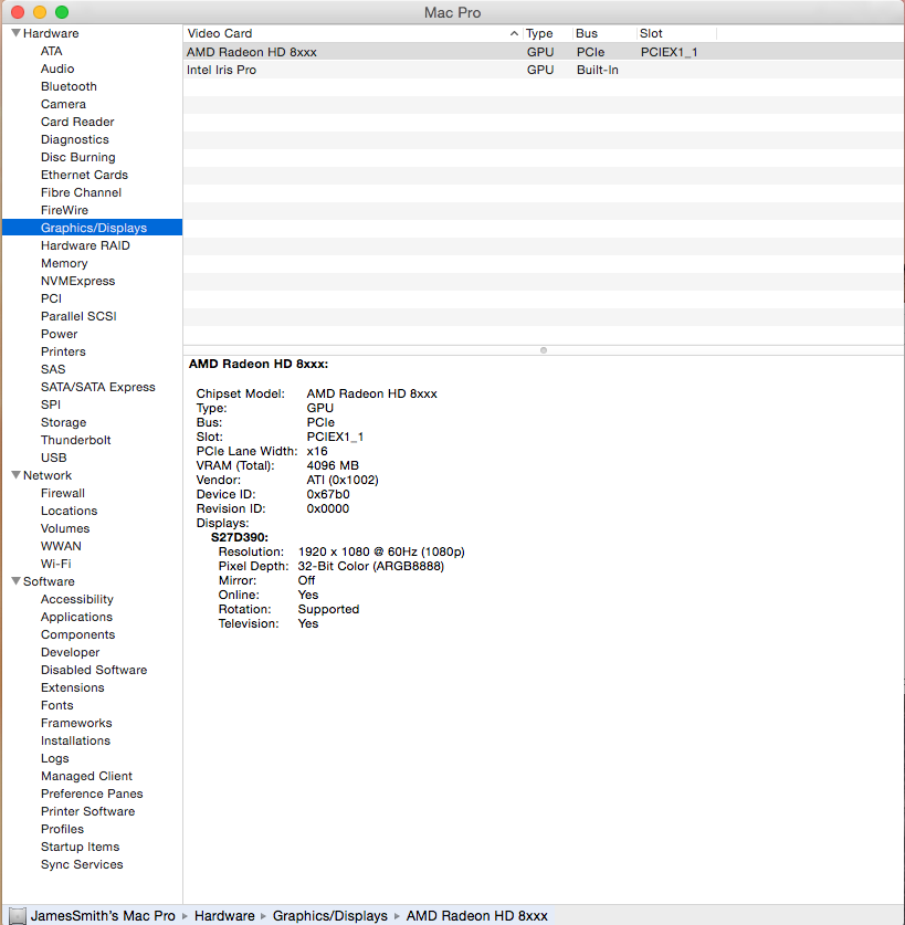

Thanks for your comment.

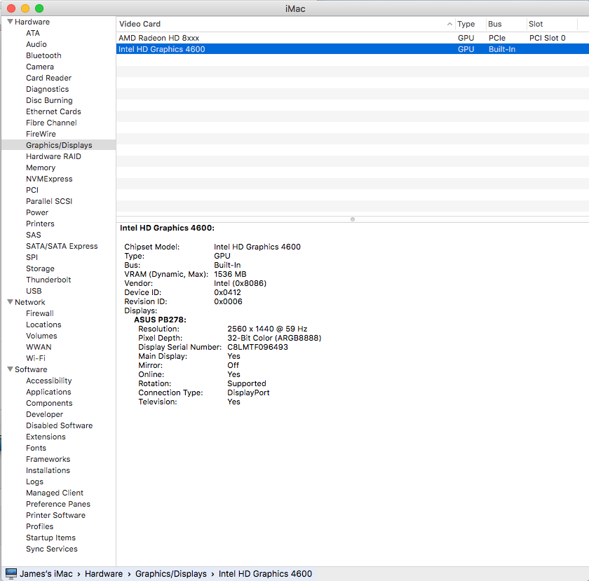

The working one in 10.10.4 was attached here:
Got some progress now after booting with GraphicsEnable=N and disable Intel HD4600 in BIOS
Almost normal display from 290X now but still suffered from 30-bitARGB(2101010) instead of 32-bitARGB(8888) in 10.10.4.
If I reduced screen resolution from 2560x1440x32 (HDMI 2.0) to 1920x1080x32, it will show normal 32-bitARGB(8888) in 10.11 DP2.

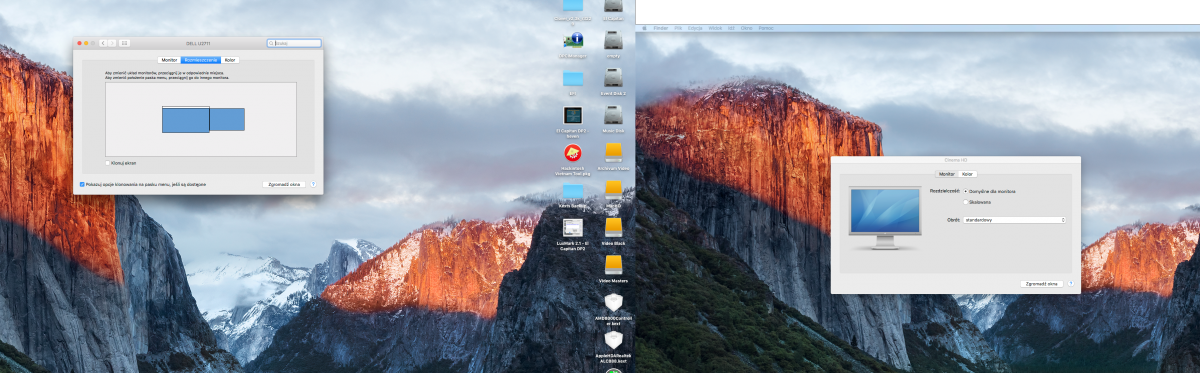

I have bad news. Dual monitors working randomly. I don't know why. This time i can't run HDMI display, only 2 monitors via DVI. But single monitor work always.post-916820-0-99051600-1435570843_thumb.pngpost-916820-0-55768200-1435570995_thumb.pngpost-916820-0-40330000-1435571020_thumb.png

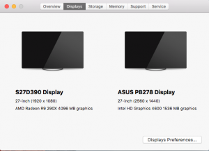

Boot by Clover I can get Intel HD4600 (DP display with DP audio) and AMD R9 290X (triple display by HDMI, DVI & DP ) at the same time.
Boot by Clover I can get Intel HD4600 (DP display with DP audio) and AMD R9  290X (HDMI display & DVI display) at the same time.
When i set as primary card 29 280x workin everything as you say (HDMI display & DVI display). But when 290x is primary or single working one of those ports.
My primary display is Intel HD4600 and AMD 290X is the secondary display.
Boot by Clover I can get 4 monitors at the same time while 3 from AMD 290X shown in my post #210 here.
If boot by Chameleon I can get only 2 monitors at the same time that means only one HDMI dispaly from AMD 290X and the other one from Intel HD4600.

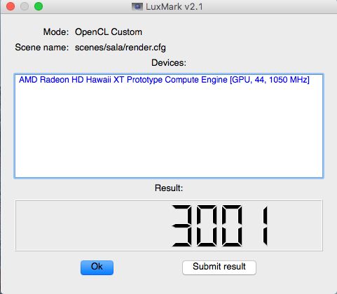

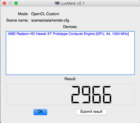

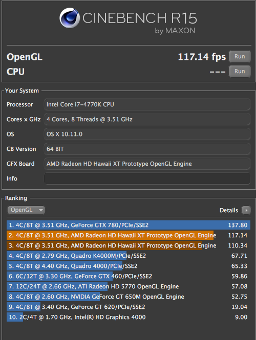

In my Asus Z87 Deluxe/Dual MB :
When 290X is the primary and only display the test score in LuxMark is about 1% higher (3001 vs. 2966) than 290X is the secondary display.
I would say there is no significant difference for OpenCL performance by LuxMark 2.1.
Regarding OpenGL bench test by CineBench R15 the difference was increased (117.14 fps vs. 110.34 fps) to 5~6 %.
