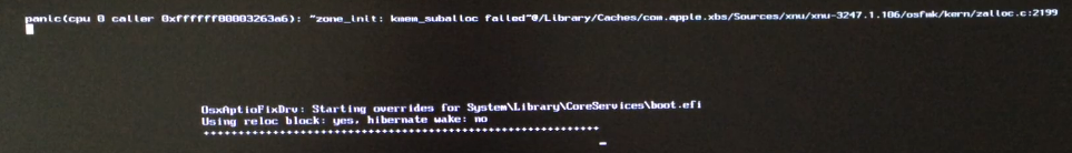

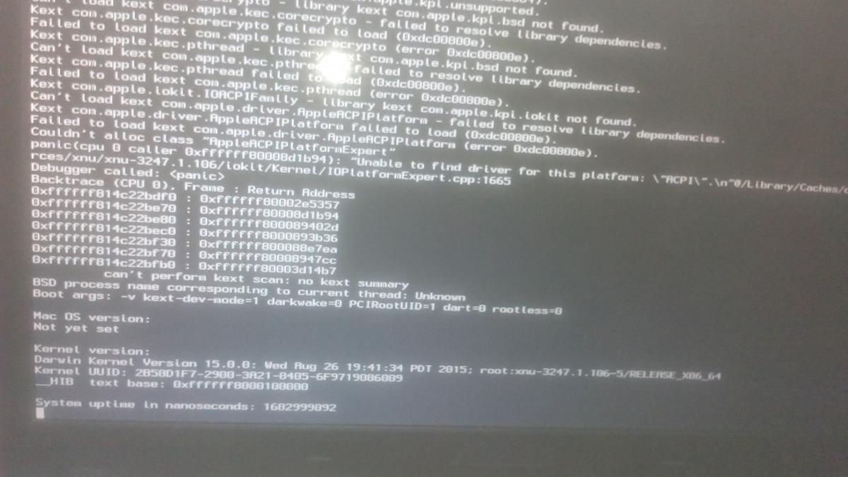

Morpheus NS Posted September 12, 2015 Share Posted September 12, 2015 I can't install GM no matter what I do... Tried: Clover r3259 (vanilla method copying Packages etc.) with "regular" AptioFix that comes with it (zone_init allocation error), AptioFix2 (zone_init allocation error) and patched Clover (old Clover, only partial success, can't get through Missing Bluetooth Controller) Clover r3264 (--createinstallmedia method) made with CloverGrower with new AptioFix (zone_init allocation error). Basically, the only way to get through zone_init error is ancient Clover (r2xxx)... Now I'm stuck, don't have any ideas left. I use FakeSMC.kext on EFI partition (6.16.1372). Config.plist includes 0x28 and 0x67 values for BooterConfig and CSRActiveConfig, are these correct? Any idea? Link to comment https://www.insanelymac.com/forum/topic/306555-os-x-el-capitan-test-thread/page/14/#findComment-2167351 Share on other sites More sharing options...

Morpheus NS Posted September 13, 2015 Share Posted September 13, 2015 I give up... 3162, 3259, 3264, AptioFixDrv, AptioFixDrv2, slide=0/8/10/100, three different FakeSMC kexts... nothing works on this damn machine... 1 Link to comment https://www.insanelymac.com/forum/topic/306555-os-x-el-capitan-test-thread/page/14/#findComment-2167515 Share on other sites More sharing options...
Slice Posted September 13, 2015 Share Posted September 13, 2015 I give up... IMG_0517.PNG 3162, 3259, 3264, AptioFixDrv, AptioFixDrv2, slide=0/8/10/100, three different FakeSMC kexts... nothing works on this damn machine... Did you try to do legacy boot to Clover? It will work without AptioFix. 1 Link to comment https://www.insanelymac.com/forum/topic/306555-os-x-el-capitan-test-thread/page/14/#findComment-2167542 Share on other sites More sharing options...
Morpheus NS Posted September 13, 2015 Share Posted September 13, 2015 I just tried legacy Clover and I get the same kernel panic. Earlier today I tried Enoch bootloader and it shows that I have 4042MB of RAM, could this be the cause? UEFI shows correct values, I have one stick of RAM in the second slot because the first one doesn't work. Yosemite works perfectly fine on the same machine... Link to comment https://www.insanelymac.com/forum/topic/306555-os-x-el-capitan-test-thread/page/14/#findComment-2167553 Share on other sites More sharing options...
