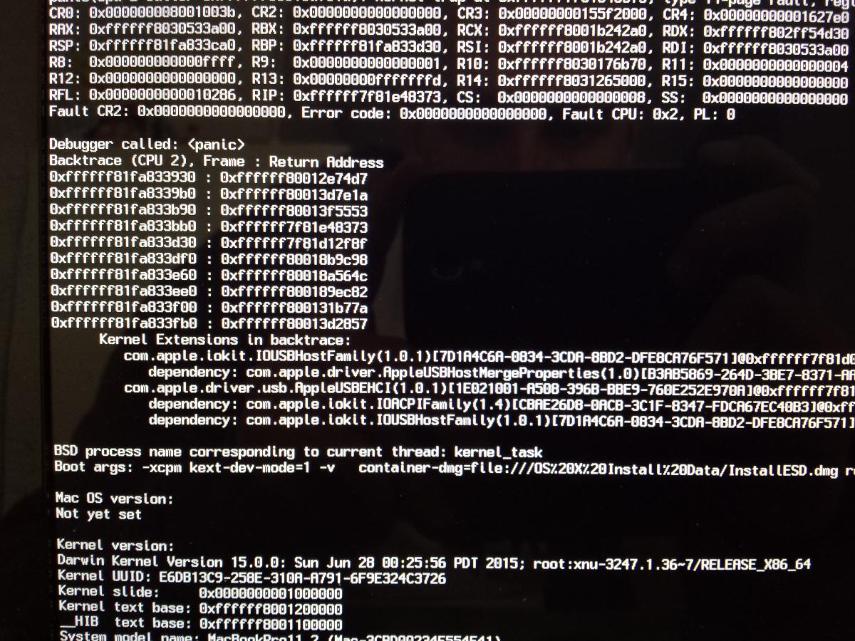

WaldMeister Posted July 10, 2015 Share Posted July 10, 2015 Hi, Public Beta from the app store returns this on first reboot: Reverting back to a DSDT without the usb 3.0 multiplex patch solves the problem. I also think the XHC device is named different between both DSDT's. Anyway, installing now. I'll have a look at the USB topic. Link to comment https://www.insanelymac.com/forum/topic/306555-os-x-el-capitan-test-thread/page/10/#findComment-2152117 Share on other sites More sharing options...
