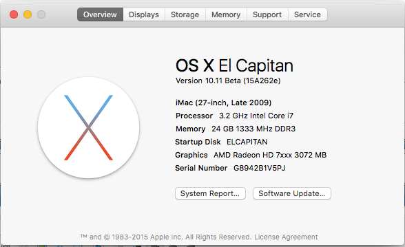

waqy Posted August 27, 2015 Share Posted August 27, 2015 I've got Yosemite installed which pretty much works perfectly, except that my card shows as AMD 7xxx rather than 7970. I've created a El Capitan USB installer with Clover legacy on it as my machine is not a UEFI-enabled one. The default flags are kext dev mode and rootless something, both enabled. When i select verbose mode, it will start booting up and just after the ++++++++++++++++++++++++ line it will reboot. Is there something I am doing wrong? Same thing happens if I boot the installer using the older version of Clover on the Yosemite HDD CPU: Intel Core i7(can't remember which one)Motherboard: Asus Rampage Extreme IIGPU: AMD Radeon HD 7970 3GB Edit: Yes, mendietinha, I am just at work at the moment, but thought I would make a brief post on here. Full screenshot and config will be posted later on. Link to comment https://www.insanelymac.com/forum/topic/306555-os-x-el-capitan-test-thread/page/13/#findComment-2163755 Share on other sites More sharing options...

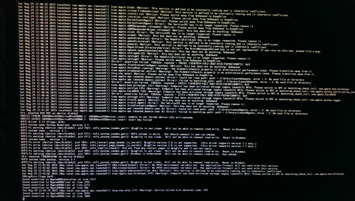

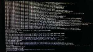

waqy Posted August 29, 2015 Share Posted August 29, 2015 I get Sound Assertion error when booting the USB. It's getting further than it was before. Is this related to FakeSMC by any chance? Screenshot attached! Link to comment https://www.insanelymac.com/forum/topic/306555-os-x-el-capitan-test-thread/page/13/#findComment-2164299 Share on other sites More sharing options...
TheRacerMaster Posted August 30, 2015 Share Posted August 30, 2015 Do you see DSMOS has arrived anywhere in the bootup process? If so, FakeSMC is not an issue, and it's probably graphics. If not, then FakeSMC is not properly injected/installed. Link to comment https://www.insanelymac.com/forum/topic/306555-os-x-el-capitan-test-thread/page/13/#findComment-2164347 Share on other sites More sharing options...
waqy Posted August 30, 2015 Share Posted August 30, 2015 Thanks for the reply TheRacerMaster. So after doing some further research and testing, i finally managed to boot into the installer. I change the OSX version in Clover to 10.11 rather than the default 10.10. whatever. I also booted with rootless=0 and left everything else as normal. I am happy to say I am now typing this from Safari in El capitan Just need to install clover now and get the USB 3.0 ports, and XFI sound card working! Link to comment https://www.insanelymac.com/forum/topic/306555-os-x-el-capitan-test-thread/page/13/#findComment-2164350 Share on other sites More sharing options...

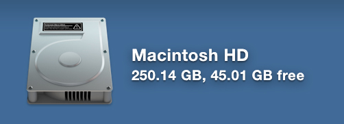

Allan Posted August 31, 2015 Share Posted August 31, 2015 Who can have the hard drive icon to El Capitan You mean this? What happened? Link to comment https://www.insanelymac.com/forum/topic/306555-os-x-el-capitan-test-thread/page/13/#findComment-2164646 Share on other sites More sharing options...
luky35 Posted August 31, 2015 Share Posted August 31, 2015 You mean this? HD.png What happened? Yeah, only that disk image of El Capitan. Link to comment https://www.insanelymac.com/forum/topic/306555-os-x-el-capitan-test-thread/page/13/#findComment-2164655 Share on other sites More sharing options...
Allan Posted August 31, 2015 Share Posted August 31, 2015 So....the disk icon doesn't appear?? Check if in Finder preferences this option is enabled or not. 1 Link to comment https://www.insanelymac.com/forum/topic/306555-os-x-el-capitan-test-thread/page/13/#findComment-2164658 Share on other sites More sharing options...
waqy Posted August 31, 2015 Share Posted August 31, 2015 When I select Sleep it starts to turn off, but doesn't fully turn itself off. The graphics turn off but normally the blue LED on my computer will flash on and off when in sleeps. and the fans will turn off too, What did you change in your DSDT? Mind helping me out if you can? @waqy yes... i did have a sleep/wake issue - but i fixed with some DSDT tweaks. does it sleep or immediately wake when trying to sleep. you should see the wake reason in the system.log for me, I had to remove some _PRW name/methods from HDEF and GBE devices so it stays asleep. plus renamed EHC1 and EHC2 Link to comment https://www.insanelymac.com/forum/topic/306555-os-x-el-capitan-test-thread/page/13/#findComment-2164669 Share on other sites More sharing options...
luky35 Posted August 31, 2015 Share Posted August 31, 2015 The icon is visible but I'd like to change default HD icon with El Capitan icon if it is possible. Link to comment https://www.insanelymac.com/forum/topic/306555-os-x-el-capitan-test-thread/page/13/#findComment-2164670 Share on other sites More sharing options...
Allan Posted August 31, 2015 Share Posted August 31, 2015 Strange.... Well, the good news is that i understand you now. But the bad news is that i don't use El Capitan yet Link to comment https://www.insanelymac.com/forum/topic/306555-os-x-el-capitan-test-thread/page/13/#findComment-2164704 Share on other sites More sharing options...
chris1111 Posted August 31, 2015 Share Posted August 31, 2015 The icon is visible but I'd like to change default HD icon with El Capitan icon if it is possible. http://mac-how-to.wonderhowto.com/how-to/change-your-mac-icons-0151545/ Link to comment https://www.insanelymac.com/forum/topic/306555-os-x-el-capitan-test-thread/page/13/#findComment-2164707 Share on other sites More sharing options...

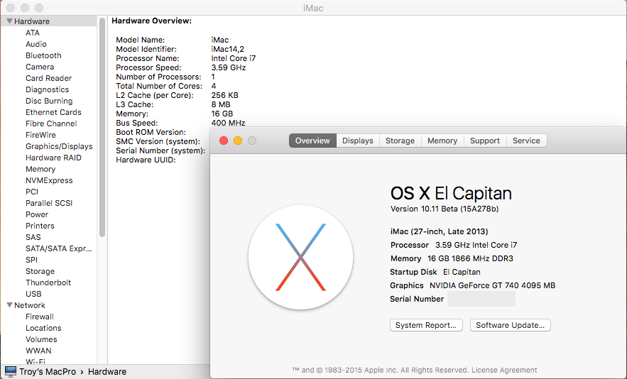

T a D Posted September 2, 2015 Share Posted September 2, 2015 After a bit of a struggle El Capitan PB6 is up and running. It seems the Nvidia web driver added nvda_drv=1 to my nvram. This caused the first boot of El Capitan to reboot before getting to the post installation steps. Adding nv_disable=1 allowed the system to boot properly. FakeSMC, realtekALC (plus Clover_ALC patches from Toleda) and RealtekRTL8111 kexts all loaded via kext injection using Clover r3259. Nvidia web drivers installed and working. Sound working. Handoff working (via bluetooth, no wifi installed) - iMessages and FaceTime all working. Happy times! Link to comment https://www.insanelymac.com/forum/topic/306555-os-x-el-capitan-test-thread/page/13/#findComment-2165045 Share on other sites More sharing options...
