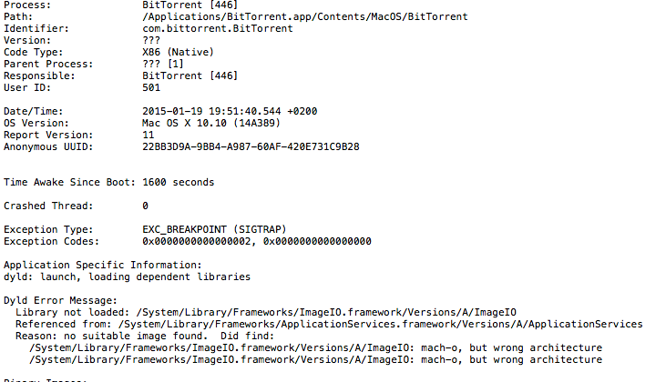

These issues Are from 10.10 ImageIO.framework & libllvmForJSC.dylib
Because Replace 10.9 Version ImageIO & libllvmForJSC.dylib can works
Must modify the new OPEMU for 10.10 ImageIO & libllvmForJSC

Hello i've been testing BSA_YOS_R5B.zip kernel for about 2 days and that's what i got:
The main problem imo with this kernel is that you should use
ImageIO.framework from 10.9.5  but if you use it a lot of apps don't work they just crash. Can't double click on icons. Adobe flash works fine with Safari-7.1.3.pkg
虎千代's patch. And i have a little bug in Launchpad sometimes
EDIT: I tested youtube with HTML 5 not with Adobe Flash. Adobe flash has visual glitches
The main problem imo with this kernel is that you should use ImageIO.framework from 10.9.5  but if you use it a lot of apps don't work they just crash. Can't double click on icons. Adobe flash works fine with Safari-7.1.3.pkg 虎千代's patch. And i have a little bug in Launchpad sometimes
only with the change of the file imageIO.Framework you will be able over the problem not solve, additionally must you the Software "Preview"  of 10.9.5 update, system cache  renew

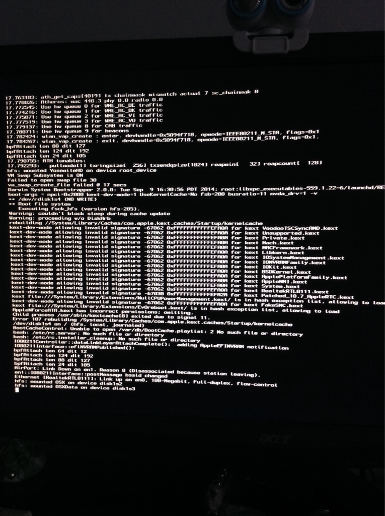

on my hardware I got sad results(
1. X86_64 kernel with replaced system.kext - shutdown while booting:
    https://www.dropbox.com/s/he48tw3rvsa7n1t/2015-01-24%2015.45.52.mov?dl=0
2. X86_64H kernel with replaced system.kext - kernel panic:
    https://www.dropbox.com/s/jhej6302a3yck66/2015-01-24%2016.04.28.mov?dl=0

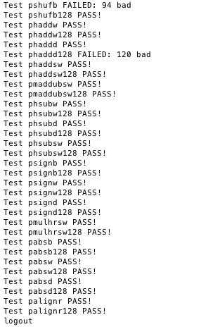

AnV , Yes ! i THIS KNOW ! This problem palignr and pshufb !
I have long said this ! )))
I found one thing - now functions from SSSEplus works !
For example :
xmmres.i = ssp_hadd_epi16_REF(xmmsrc.i xmmdst.i);<-- now working ! ))))
I'm not at home , i come and continue make ! And even i'll check thine BSA_YOS_R6 !

Hi AnV !
I check your BSA_YOS_R6!
I get invalid kernel opcode (32-bit): . I fix and work . You should fix this ))) .
1) i found in your opemu errors …
a) For pshufb I fix this function ssp_shuffle_pi8_REF in SSEPlus_emulation_REF.h !
In ssp_shuffle_pi8_REF i replace all 0xf to 0x7 :
B.s8[0]  = (MSK.s8[0]  & 0x80) ? 0 : A.s8[(MSK.s8[0]  & 0xf)];
to
B.s8[0]  = (MSK.s8[0]  & 0x80) ? 0 : A.s8[(MSK.s8[0]  & 0x7)];
b ) For phaddd128 I fix in opemu :
In function ssse3_run() I replace ssp_hadd_epi16_REF to ssp_hadd_epi32_REF ! ))))
​And works
​2)  In fetchoperands() :
unsigned int num_src = *ModRM & 0x7;         <-- replace num_src to num_dst - and work instructions.
unsigned int num_dst = (*ModRM >> 3) & 0x7;  <-- replace num_dst to num_src - and work instructions.
But you should replace all num_src and num_dst and etc …
I tested on Lion 10.7.5 :)))
But i no tested on Yosemite … ! )))

New kernel to test.
It is again based on SSEPlus.
Big thanks to Bronzovka for providing the fixes mentioned above.
Test please, and report.
BSA_YOS_R7.zip
