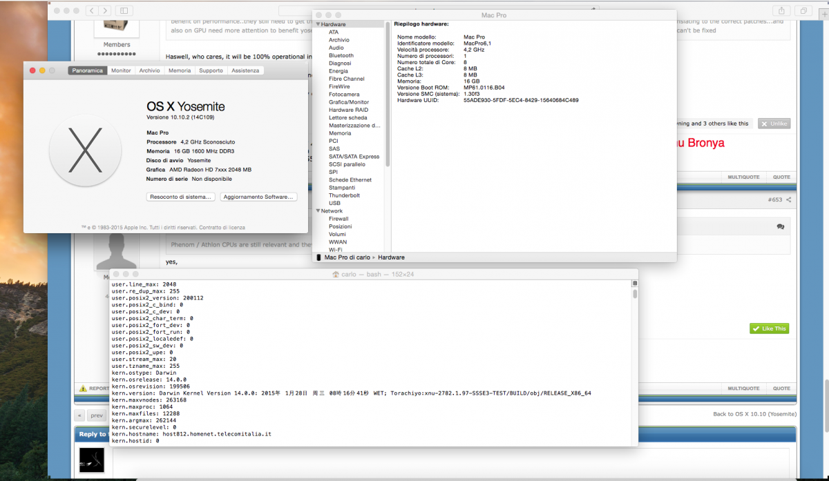

carlo_67 Posted January 29, 2015 Share Posted January 29, 2015 Here it is guys are on the desk Yosemite 10.10.2 AMD 5 Link to comment https://www.insanelymac.com/forum/topic/302075-amd-yosemite-kernel-testing-for-help-use-the-help-topic/page/26/#findComment-2106818 Share on other sites More sharing options...
lpukraine Posted January 29, 2015 Share Posted January 29, 2015 Here it is guys are on the desk Yosemite 10.10.2 AMD Great! What kernel are you use? Link to comment https://www.insanelymac.com/forum/topic/302075-amd-yosemite-kernel-testing-for-help-use-the-help-topic/page/26/#findComment-2106819 Share on other sites More sharing options...
carlo_67 Posted January 29, 2015 Share Posted January 29, 2015 kern.version: Darwin Kernel Version 14.0.0: 2015年 1月28日 周三 08時16分41秒 WET; Torachiyo:xnu-2782.1.97-SSSE3-TEST/BUILD/obj/RELEASE_X86_64 I thank in most of the kext that no place here because then there's people that you trust and makes clever Link to comment https://www.insanelymac.com/forum/topic/302075-amd-yosemite-kernel-testing-for-help-use-the-help-topic/page/26/#findComment-2106821 Share on other sites More sharing options...
yakei Posted January 29, 2015 Share Posted January 29, 2015 kern.version: Darwin Kernel Version 14.0.0: 2015年 1月28日 周三 08時16分41秒 WET; Torachiyo:xnu-2782.1.97-SSSE3-TEST/BUILD/obj/RELEASE_X86_64 and no problems with Safari, app store. Safari Picture Preview is correct, Picture correctly shown, it also no webkit used? everything ok ? compatible with AMD K10 ? Link to comment https://www.insanelymac.com/forum/topic/302075-amd-yosemite-kernel-testing-for-help-use-the-help-topic/page/26/#findComment-2106841 Share on other sites More sharing options...
gils83 Posted January 29, 2015 Share Posted January 29, 2015 and no problems with Safari, app store. Safari Picture Preview is correct, Picture correctly shown, it also no webkit used? everything ok ? compatible with AMD K10 ? Carlo use cpu FX , Safari no bug 1 Link to comment https://www.insanelymac.com/forum/topic/302075-amd-yosemite-kernel-testing-for-help-use-the-help-topic/page/26/#findComment-2106863 Share on other sites More sharing options...

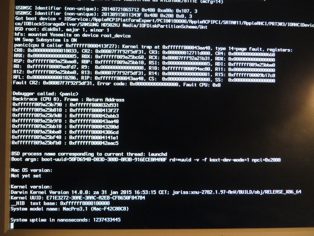

Andy Vandijck Posted January 31, 2015 Share Posted January 31, 2015 New opemu mark IV built and ready for testing. It's based on latest libudis86 my way... I also implemented the missing disp8 and disp32 relative displacement code. I also added the code required for proper immediate fetching... This one should work pretty cool! I'm hoping no more pixel bug... Download below. Previous opemu is still in place but new one is standard. Report after test please... Lets hope the eight build is what we need... BTW: I initialized a Github repo containing latest code. https://github.com/andyvand/XNU-AnV This will always contain latest available... BSA_YOS_R8.zip 7 Link to comment https://www.insanelymac.com/forum/topic/302075-amd-yosemite-kernel-testing-for-help-use-the-help-topic/page/26/#findComment-2107364 Share on other sites More sharing options...
yakei Posted January 31, 2015 Share Posted January 31, 2015 New opemu mark IV built and ready for testing. It's based on latest libudis86 my way... I also implemented the missing disp8 and disp32 relative displacement code. I also added the code required for proper immediate fetching... This one should work pretty cool! I'm hoping no more pixel bug... Download below. Previous opemu is still in place but new one is standard. Report after test please... Lets hope the eight build is what we need... BTW: I initialized a Github repo containing latest code. https://github.com/andyvand/XNU-AnV This will always contain latest available... BSA_YOS_R8 Hi Andy, sorry kernel panic. Best Regards Link to comment https://www.insanelymac.com/forum/topic/302075-amd-yosemite-kernel-testing-for-help-use-the-help-topic/page/26/#findComment-2107377 Share on other sites More sharing options...
schulze1963 Posted January 31, 2015 Share Posted January 31, 2015 I got kernel panic too. Hope you can fix it Link to comment https://www.insanelymac.com/forum/topic/302075-amd-yosemite-kernel-testing-for-help-use-the-help-topic/page/26/#findComment-2107395 Share on other sites More sharing options...

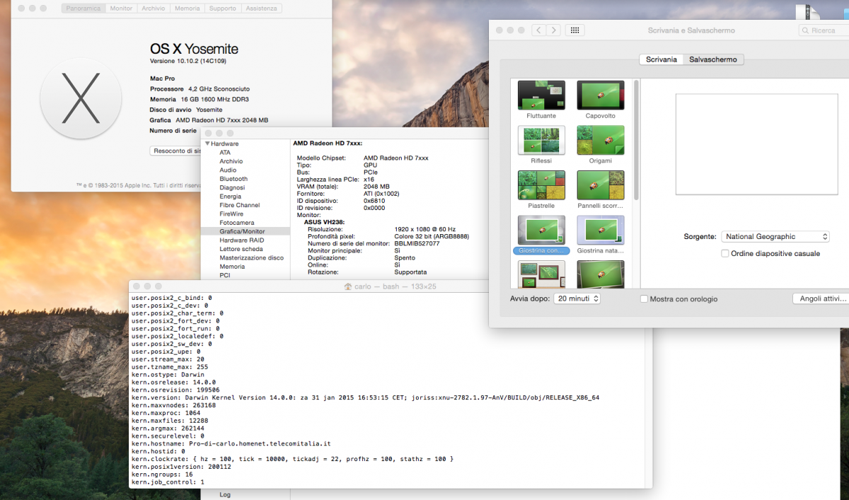

carlo_67 Posted January 31, 2015 Share Posted January 31, 2015 New opemu mark IV built and ready for testing. It's based on latest libudis86 my way... I also implemented the missing disp8 and disp32 relative displacement code. I also added the code required for proper immediate fetching... This one should work pretty cool! I'm hoping no more pixel bug... Download below. Previous opemu is still in place but new one is standard. Report after test please... Lets hope the eight build is what we need... BTW: I initialized a Github repo containing latest code. https://github.com/andyvand/XNU-AnV This will always contain latest available... good in 10.10.2 boot and shutdown ok but creates problems in graphics screensaver carlo_67 1 Link to comment https://www.insanelymac.com/forum/topic/302075-amd-yosemite-kernel-testing-for-help-use-the-help-topic/page/26/#findComment-2107398 Share on other sites More sharing options...
Andy Vandijck Posted January 31, 2015 Share Posted January 31, 2015 good in 10.10.2 boot and shutdown ok but creates problems in graphics screensaver Schermata 2015-01-31 alle 18.55.33.png carlo_67 And the rest of the graphics? Safari / Desktop / App Store / etc... EDIT: Desktop look fine, screenshot too... yeah! Link to comment https://www.insanelymac.com/forum/topic/302075-amd-yosemite-kernel-testing-for-help-use-the-help-topic/page/26/#findComment-2107406 Share on other sites More sharing options...
Bronya Posted January 31, 2015 Share Posted January 31, 2015 And the rest of the graphics? Safari / Desktop / App Store / etc... EDIT: Desktop look fine, screenshot too... yeah! carlo_67 use cpu FX ))) 1 Link to comment https://www.insanelymac.com/forum/topic/302075-amd-yosemite-kernel-testing-for-help-use-the-help-topic/page/26/#findComment-2107409 Share on other sites More sharing options...
