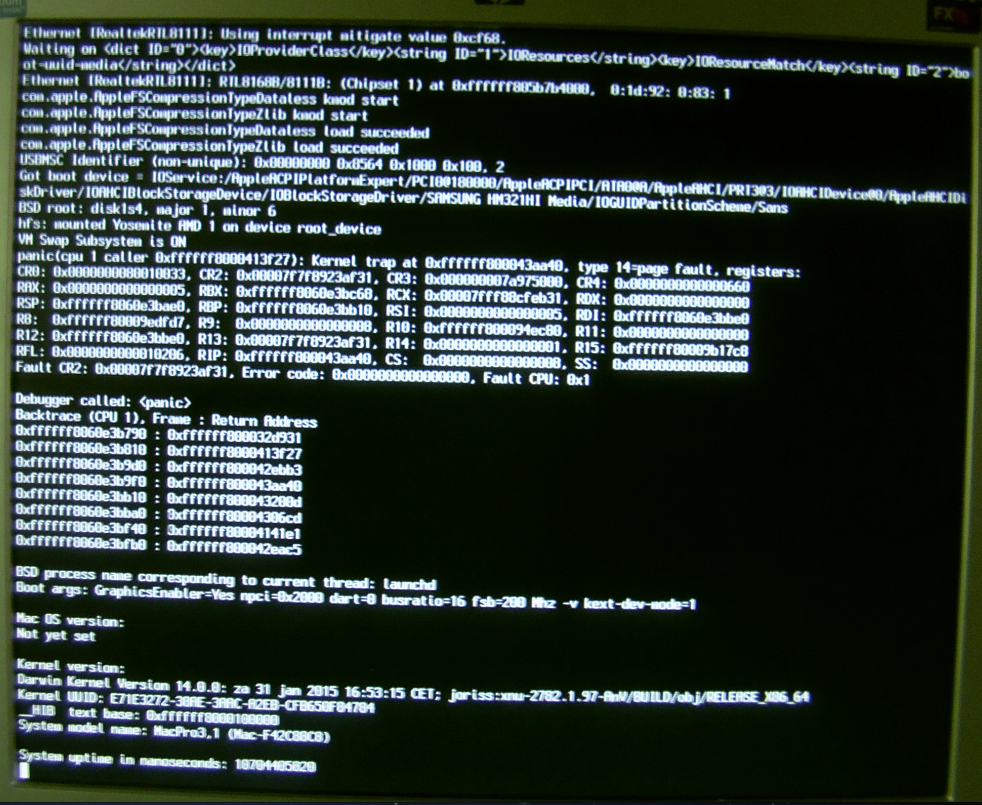

Bronya Posted January 31, 2015 Share Posted January 31, 2015 AnV , this panic - this function ud_insn_hex . This strange ... That's why I switched to SSD. Better boot times too I have ssd and ssd got in crashed ))) I bought new ssd and is normal works .. ))) Link to comment https://www.insanelymac.com/forum/topic/302075-amd-yosemite-kernel-testing-for-help-use-the-help-topic/page/27/#findComment-2107444 Share on other sites More sharing options...
Andy Vandijck Posted January 31, 2015 Share Posted January 31, 2015 AnV , this panic - this function ud_insn_hex . This strange ... Really? Weird... it should just return the hex data of the instruction :/ Can you trace it to its origin? Link to comment https://www.insanelymac.com/forum/topic/302075-amd-yosemite-kernel-testing-for-help-use-the-help-topic/page/27/#findComment-2107453 Share on other sites More sharing options...

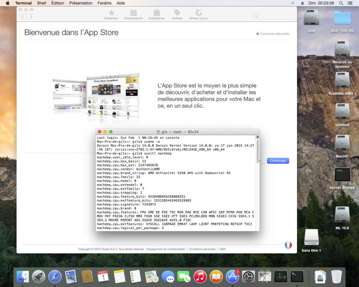

gils83 Posted January 31, 2015 Share Posted January 31, 2015 Does the latest kernel work for you Gils? I have yet to test your kernel but Andy AppStore on FX CPU works perfectly, Carlo has a direct problem with its network that has nothing to do with the kernel, I have not tested K10 CPU in Right now I galley on a HD 6850 that bug Link to comment https://www.insanelymac.com/forum/topic/302075-amd-yosemite-kernel-testing-for-help-use-the-help-topic/page/27/#findComment-2107473 Share on other sites More sharing options...
gils83 Posted January 31, 2015 Share Posted January 31, 2015 Andy , your kernel rev7 and rev8 works good (AMD CPU SSSE3) thank Link to comment https://www.insanelymac.com/forum/topic/302075-amd-yosemite-kernel-testing-for-help-use-the-help-topic/page/27/#findComment-2107494 Share on other sites More sharing options...

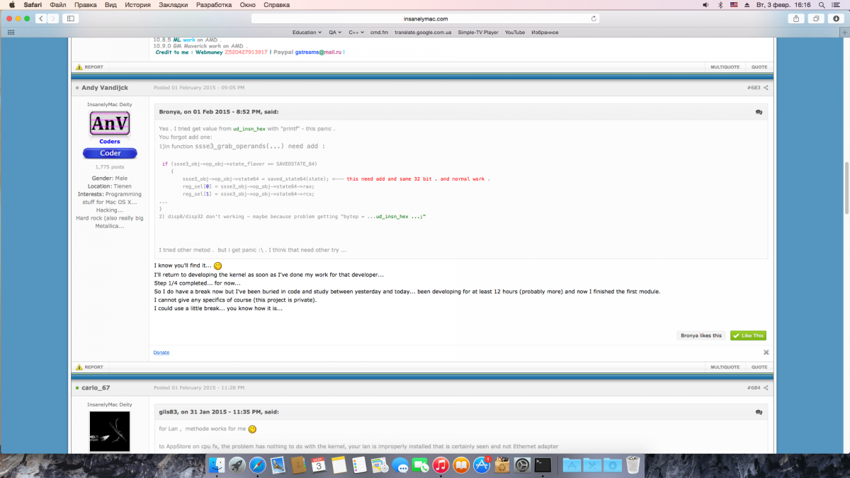

Bronya Posted February 1, 2015 Share Posted February 1, 2015 Really? Yes . I tried get value from ud_insn_hex with "printf" - this panic . You forgot add one: 1)in function ssse3_grab_operands(...) need add : if (ssse3_obj->op_obj->state_flavor == SAVEDSTATE_64) { ssse3_obj->op_obj->state64 = saved_state64(state); <--- this need add and same 32 bit . and normal work . reg_sel[0] = ssse3_obj->op_obj->state64->rax; reg_sel[1] = ssse3_obj->op_obj->state64->rcx; ... } 2) disp8/disp32 don't working - maybe because problem getting "bytep = ...ud_insn_hex ...;" Weird... it should just return the hex data of the instruction :/ Can you trace it to its origin? I tried other metod . but i get panic :\ . I think that need other try ... 1 Link to comment https://www.insanelymac.com/forum/topic/302075-amd-yosemite-kernel-testing-for-help-use-the-help-topic/page/27/#findComment-2107797 Share on other sites More sharing options...
Andy Vandijck Posted February 1, 2015 Share Posted February 1, 2015 Yes . I tried get value from ud_insn_hex with "printf" - this panic . You forgot add one: 1)in function ssse3_grab_operands(...) need add : if (ssse3_obj->op_obj->state_flavor == SAVEDSTATE_64) { ssse3_obj->op_obj->state64 = saved_state64(state); <--- this need add and same 32 bit . and normal work . reg_sel[0] = ssse3_obj->op_obj->state64->rax; reg_sel[1] = ssse3_obj->op_obj->state64->rcx; ... } 2) disp8/disp32 don't working - maybe because problem getting "bytep = ...ud_insn_hex ...;" I tried other metod . but i get panic :\ . I think that need other try ... I know you'll find it... I'll return to developing the kernel as soon as I've done my work for that developer... Step 1/4 completed... for now... So I do have a break now but I've been buried in code and study between yesterday and today... been developing for at least 12 hours (probably more) and now I finished the first module. I cannot give any specifics of course (this project is private). I could use a little break... you know how it is... 1 Link to comment https://www.insanelymac.com/forum/topic/302075-amd-yosemite-kernel-testing-for-help-use-the-help-topic/page/27/#findComment-2107804 Share on other sites More sharing options...

Bronya Posted February 1, 2015 Share Posted February 1, 2015 I found problem panic - this because don't working instructions palignr , because don't works palignr_getimm128() and palignr_getimm64() . I tested all instructions, this works, but palignr don't work. ))) Link to comment https://www.insanelymac.com/forum/topic/302075-amd-yosemite-kernel-testing-for-help-use-the-help-topic/page/27/#findComment-2107847 Share on other sites More sharing options...

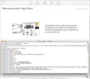

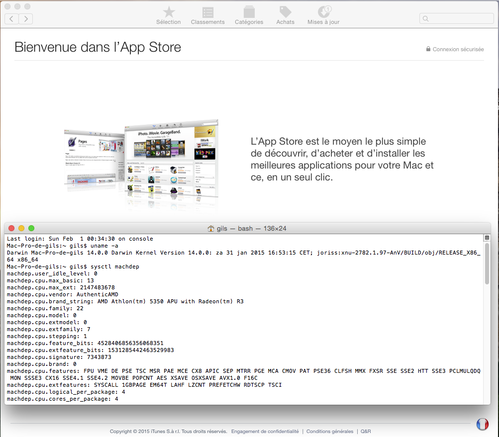

Meowthra Posted February 3, 2015 Share Posted February 3, 2015 10.10 SSSE3 FiX rev.1 for AMD K8 K10 fetchoperands memory pointer error FIX Screen Capture PNG & Tiff FIX Safari 8 & Webkit bug FIX SSSE3 palignr Building………… 1010-SSSE3-FIX-rev.1.zip 1010-SSSE3-FIX-rev.1.diff.zip 1010-SSEPlus-SSSE3-FIX.zip 13 Link to comment https://www.insanelymac.com/forum/topic/302075-amd-yosemite-kernel-testing-for-help-use-the-help-topic/page/27/#findComment-2108310 Share on other sites More sharing options...
lpukraine Posted February 3, 2015 Share Posted February 3, 2015 (edited) 10.10 SSSE3 FiX rev.1 for AMD K8 K10 fetchoperands memory pointer error FIX Screen Capture PNG & Tiff FIX Safari 8 & Webkit bug FIX My first results with 1010-SSSE3-FIX-rev.1.zip: Seems that work very...very good)) - png screenshot work - safari works - app store works - can select file with click on icon UPD1: Graphics bugs with some avatars in Safari: but it is a vary small problem for this nice kernel) Will be perfect to get iCloud too. Method with replacement files from Intel machine does not work for me. UPD2: Same results with 1010-SSEPlus-SSSE3-FIX.zip For now I don't see any difference. UPD3: Made fresh installation. Safari and App Store work perfect without webkit fix!!! Launchpad looks good without fixes. No need any kexts replacements. Almost perfect kernel! Thanks for it!!! But one question. Will it work with 10.10.2? Edited February 3, 2015 by lpukraine 5 Link to comment https://www.insanelymac.com/forum/topic/302075-amd-yosemite-kernel-testing-for-help-use-the-help-topic/page/27/#findComment-2108328 Share on other sites More sharing options...
yakei Posted February 3, 2015 Share Posted February 3, 2015 10.10 SSSE3 FiX rev.1 for AMD K8 K10 fetchoperands memory pointer error FIX Screen Capture PNG & Tiff FIX Safari 8 & Webkit bug FIX SSSE3 palignr Building………… 1010-SSSE3-FIX-rev Hi, quick test with safari webkit and Safari Preview kit installed. I could procedure the last 10 min obtain no error message in safari. after to open 15 internet sides (at the same time, incl. Youtube) no crashes, app store functioned also. I test ........ update 1: + without safari webkit and Safari Picture Preview kit, safari no crashes , app store functioned, i think this is the solution....... - without Safari Picture Preview kit, the Preview picture in Safari ,the picture are not sharp, color are not correctly represented (only the preview picture). update 2: - without Safari Picture Preview kit, the Preview picture in Safari ,the picture are not sharp, color are not correctly represented (only the preview picture). ----> Solution: simply the file ImageIO.Framework and preview app from 10.9.5 to 10.10.1, picture Preview in Safari are now ok. many thanks 1 Link to comment https://www.insanelymac.com/forum/topic/302075-amd-yosemite-kernel-testing-for-help-use-the-help-topic/page/27/#findComment-2108379 Share on other sites More sharing options...
