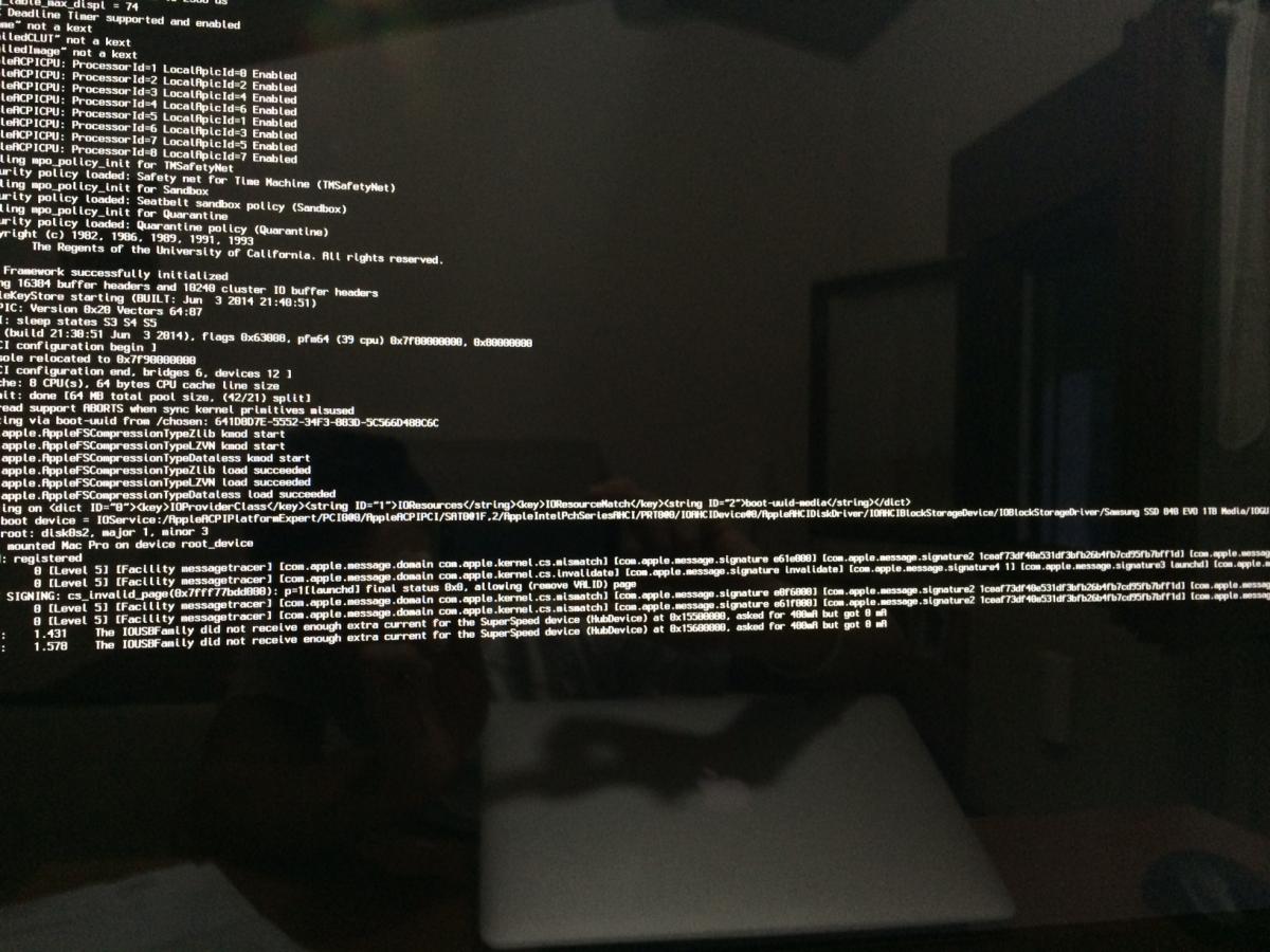

it says setvar is not a valid command

Ozmosis GA-B75M-D3H + GTX 650
10.9.4
I think it depend on GPU Issue.
When I choose Built-in EDK Shell  or Machintosh HD Partition.
And I also setup npci=0x2000 in com.apple.Boot.plist.
I don't use  NVIDIA drivers atm.
Plz, let me know
1. Do I need additional Boot-Flag?
2. How could I EDK Shell for insert variable or debugging when I choose BuiltIn EDK Shell for Booting.
3. Am I right of select BuiltIn EDK Shell or Machintosh HD for Ozmosis Booting?
No DSDT edits or Graphics Enabler required for GTX6xx and higher.
slide=0 is already in Ozmosis.
nvda_drv=1 you can use the NVIDIA drivers not apple driver.
npci=0x2000 OR npci=0x3000 is for  freezing at [PCI Configuration Begin].
But, I always have these issue.
10.9.4
Plz, let me know
the link is wrong.
did you use GTS 250?
check Nvidia drivers maybe will help.
