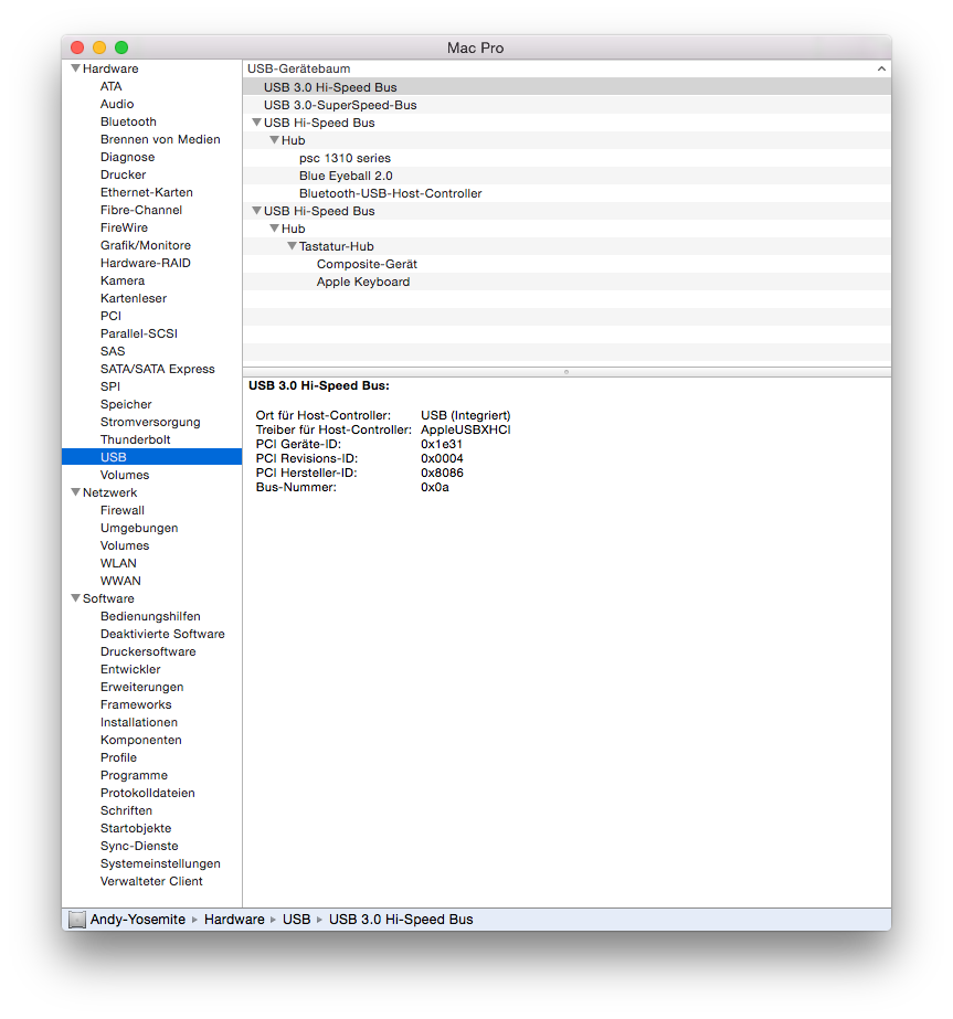

i have install yosemite with a tutorial on my board with osmosis 824 and i must make a kextload in single user modus for starting the installation. is this wrong or unnecessary?
About my USB3.0 Problem:
I have Mavericks on other HDD on the same board. there is USB 3.0 no problem. And in BIOS i can use the mouse on the Apple Keyboard to.
No, no, no ... The Mouse is in the Keyboard and the Keyboard in the USB 3.0 Port. But in Yosemite DP4 i have this Problem in the OS ... In BIOS before booting the Mac working the Keyboard+Mouse, but when i see the login screen, the keyboard and the mouse is dead.
by first installation i put the Keyboard in the 2.0 Port. Then install the kext and changed to USB 3.0 and works fine ... but after the Yosemite DP4 update the USB 3.0 ist missing. I install the GenericUSBHXCI again ... and the problem begin.
I have make a second try. the GenericUSBXHCI-1.2.7 is now in the Bios/Ozmosis and BIOS flash is ok ... But no USB3.0 working in OS. In Ozmosis Boot Menü (Home Key by Start) the Keyboard with Mouse in USB3.0 working, but after booting the OS ... NO :-(

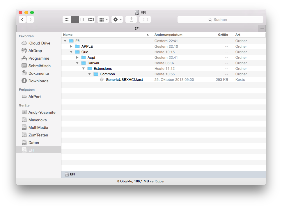

Can you give me the correct path for kext in Efi?
Is Volumes/EFI/Efi/Quo/Acpi/xxxxx.kext the right path?

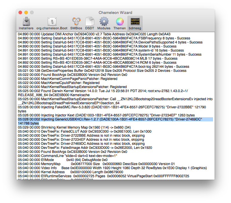

Ok ... my kext is in the right path.
but not loading.
i see the kext in bdmesg,
but in kextsat not
but not loading.
but in kextsat not

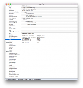

But I have still one question:
My Apple Keyboard with plugged in USB Mouse is on the USB3.0 Rear Slot. But in System Preferences i see the Keyboard not in the USB 3.0 tree. Is that normal?
OK ...I do not need to show pictures  :thumbsup_anim:
I have patched my dsdt again and again ... and now the usb 3.0 is working ... without extra kext ... Yeaaaahhhh.

Yes is normal since your keyboard is not using superspeed bus(USB3.0) but highspeed bus(USB2.0) and the port is routed.
