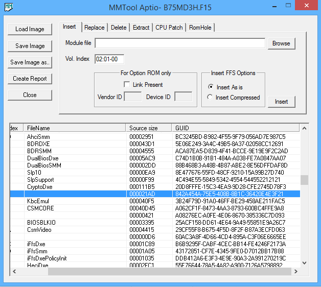

Riley Freeman Posted September 10, 2014 Share Posted September 10, 2014 For my P9X79 Pro, 3305 was the last one with writable NVRAM. So see if you can find a BIOS from around that time. If you open a BIOS file in MMTool or UefiTool and find a module with GUID 842A454A-75E5-408B-8B1C-36420E4E3F21 then your NVRAM is locked. Link to comment Share on other sites More sharing options...
jacoweb Posted September 10, 2014 Share Posted September 10, 2014 For my P9X79 Pro, 3305 was the last one with writable NVRAM. So see if you can find a BIOS from around that time. If you open a BIOS file in MMTool or UefiTool and find a module with GUID 842A454A-75E5-408B-8B1C-36420E4E3F21 then your NVRAM is locked. Thanks man! I gonna check this out right now Link to comment Share on other sites More sharing options...

JorgeMax Posted September 10, 2014 Share Posted September 10, 2014 For my P9X79 Pro, 3305 was the last one with writable NVRAM. So see if you can find a BIOS from around that time. If you open a BIOS file in MMTool or UefiTool and find a module with GUID 842A454A-75E5-408B-8B1C-36420E4E3F21 then your NVRAM is locked. Checked my friend here, and he presents this "key": How do I unlock the NVRAM? Link to comment Share on other sites More sharing options...
