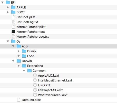

Hello,
I tried everything but unfortunately without success to start with the HD4600.
But then something unexpected happened. Suddenly my PC did not start anymore. The PC again and again restart with a pip tone.
After I found out that my bios is damaged, I made a recovery from my backup bios.
After that I reflashed the Z97D3H.F9-XMAX.rom.
Lo and behold, I was able to start Sierra, High Sierra and Mojave quite normally with the HD4600.
Without DSDT or any settings in the Ozmosis Defaults.plist, or in the KernextPatcher.plist for the HD4600.
I think Lilu and WhateverGreen takes over patching the HD4600 (see pic).
But why did it not work before. What was so shifted in my bios that it did not work before.
I've flashed my bios countless times and also reset the default values.
My guess is that on re-flashing of ROM parts will not be completely deleted or overwritten.
Still for information. What does not work is to start the older systems El Capitan and Yosemite.
I think that's because of the KernextPatcher which is not executed properly.
I've already posted that to cecekpawon. I do not know if he can find a solution here.
Edited by witjojo
