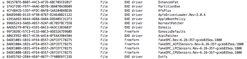

HI ALL.
          I have modified a copy of the Z97PD3.F8b-XMAX.rom. by adding the KernextPatcher_XMAX.plist to the bois .
          and i have managed to update to 10.14.4 Beta (18E174f) i seems to work ok. except it boots up a bit slow. some usb Ports and HDMI not working   sleep will restart
          could someone be so kind and check my Send me file please .
Send me Grahams-iMac.zip
heres a copy of the bios i moddified. i havent time to try and recreate what i did at the moment. the bios and file are from the german site. im now running.10.14.4 Beta (18E184e)KernextPatcher Log.txt file from efi folder
modded bios folder.zip
KenextPatcherLog folder.zip

Hello guys! I am a bit interested again after some time in Ozmosis. Do i have to build it myself or someone will send me a modded for my Z97-HD3? And are there some things changed from the time I was experimenting with it last time(november 2016)? I would be happy if i was not needed to reinstall macOS and could use my existing macOS(10.13) installation.
 you will need the app UEFITOOL  Motherboard bios. And (Kext2Ffs tool. to convert  kext you need to ffs file to add to your bios) and some 0mosis files the is a  how to on this site

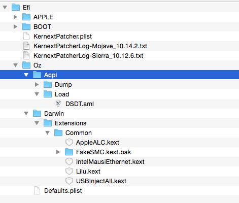

Hello Guys,
I have installed the following Rom Z97D3H.F9-XMAX-ROM. Previously, I had Z97D3H.F9-Sierra-ROM.
However, I have removed DarBoot because Legacy Boot does not work with it. DarBoot makes the APFS entries (UEFI) in the boot menu, but probably removes the legacy entries. Maybe that can be changed? And I do not need OzmosisHFTheme, so I removed it too.
Sierra and Mojave work without problems. But Yosemite and El Capitan do not start anymore.
Whereby I assume that it is the KeenextPatcher. Because when I start Yosemite or El Capitan no KernextPatcherLog.txt file is created. At Sierra and Mojave, this is created, and the systems also start.
I copied the FakeSMC to S / L / E on Yosemite, changed rights and updated Kext Cache.
Yosemite starts now. But no sound and no network. Kext under /Efi/OZ/Darwin/Extensions/Common will not load.
The second NVME SSD is not recognized. The KextsToPatch entries are probably not loaded from the KernextPatcher.plist. Or the KernextPatcher.plist will not be executed at all. Does the KernextPatcher not work with the old systems?
Furthermore, I can not update from Mojave 10.14.2 to 10.14.3. He simply aborts the update and restarts.
Can someone please look at that and help me? Attached my files and Sorry for my bad English.

Hello,
After you are able to boot into your Yosemite (by putting required kexts to S/L/E), still no KernextPatcherLog.txt on your \EFI folder? Have you tried another log option? https://github.com/cecekpawon/UEFTW/wiki/Howto-Driver-Log
I know its lame, KernextPatcher (or other driver by me) will delete your old log file and create a new one during boot. Which mean, once you are unable to reach the desktop and reset your pc, you will lost the last log file.
From your bootlog, latest Lilu will not allowed you to use their plugins when you set Firmware Vendor to "Apple". Try to change to "Eppla" or something else.
Maybe KernextPatcher are failed to read current booted system version. Try to rename "MatchOS" to "#MatchOS" to disable OS version filter.
** During testing please keep FakeSMC or other mandatory kexts on S/L/E to allow you to reach the desktop.
  • Like 3
I do not know exactly how to do that?
I know about it. I then boot into Windows there I have access to the EFI partition. There is no KernextPatcherLog.txt
Yes maybe, but the other kext have to load, like AppleALC.kext, IntelMausiWthernet.kext, USBInjectAll.kext.
I did that, but no change.
Perhaps the driver is incompatible with the older OS versions? And can something be changed there?
Or do you have any other ideas to test it out?
@witjojo
*) Theres another options to save the log besides SaveLogToFile (SaveLogToDeviceTree / SaveLogToNvram) that you can get it later from OS.
**) The driver will create a log file on first ESP found, in case you have more than one ESP installed. Or on same directory as driver was loaded from disk.
***) You are correct (1), it will create a log file when you are booting to Windows.
****) You are correct (2), you still have another kexts (IntelMausi etc) to load from EFI folder. And from your log, Ozmosis already done injecting em all flawlessly. KernextPatcher seems failed to patch the kernel for you.
*****) Sadly, I dont another OS / machine to do some test for you, only me here with 1 and only pc + macos ver. Perhaps someone can help you. The thing that you might want to try is to load the driver from ESP (with bcfg / DBounce) instead of FV as comparison.
