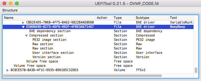

While creating a new oz firmware I realized that someone removed the DXE dependency section from the Ozmosis.ffs
Was this intended to make KernextPatcher and Co. work together with Ozmosis?

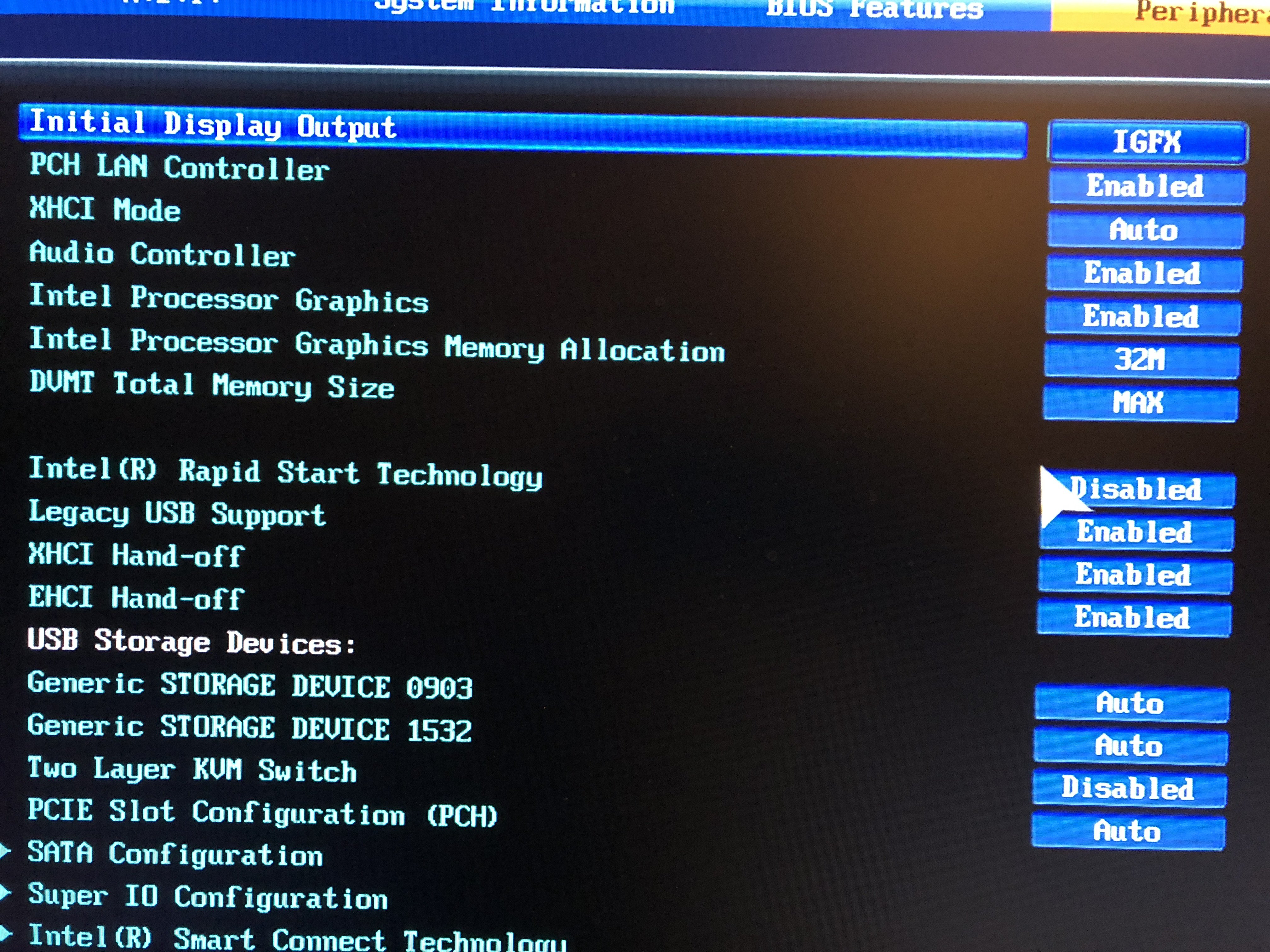

Did you activate your igpu from your firmware setup ?
Edit:
First you you need a working setup with your IGPU and High Sierra
So perform the obligatory steps
- Enable IGPU
- Set 32MB and MAX
- maybe remove your Nvidia temporary
From witjojos log, no. The class for gpu should be: 0300XX / 0380XX. Only his nvidia were detected.
Try to manually rebuild Ozmosis ffs by adding missing depex, take from this script as example.

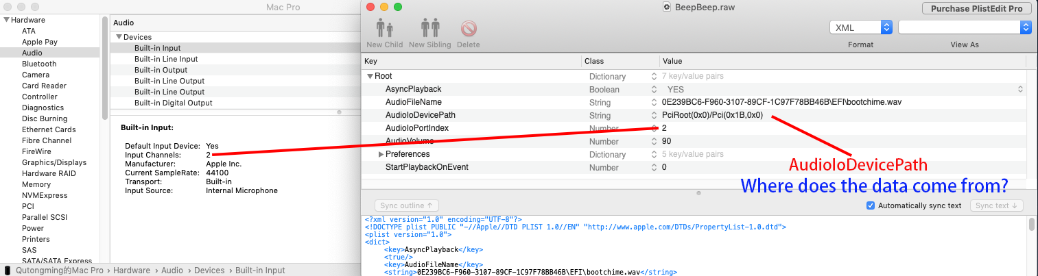

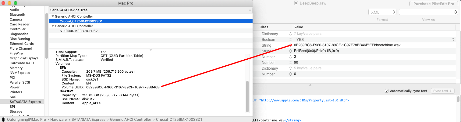

@qutongming
Wrong LOL. The easiest way you may use BootChimeCfg to configure devicepath, port and also volume. BeepBeep will able to read BootChimeCfgs saved config. Leave those properties in plist empty (or add some prefix to comment out / just simply delete it). For audio filepath, just rename and place your audio file in “\EFI\BeepBeep.wav” (default audio filepath), or embed it into ffs as a raw section.

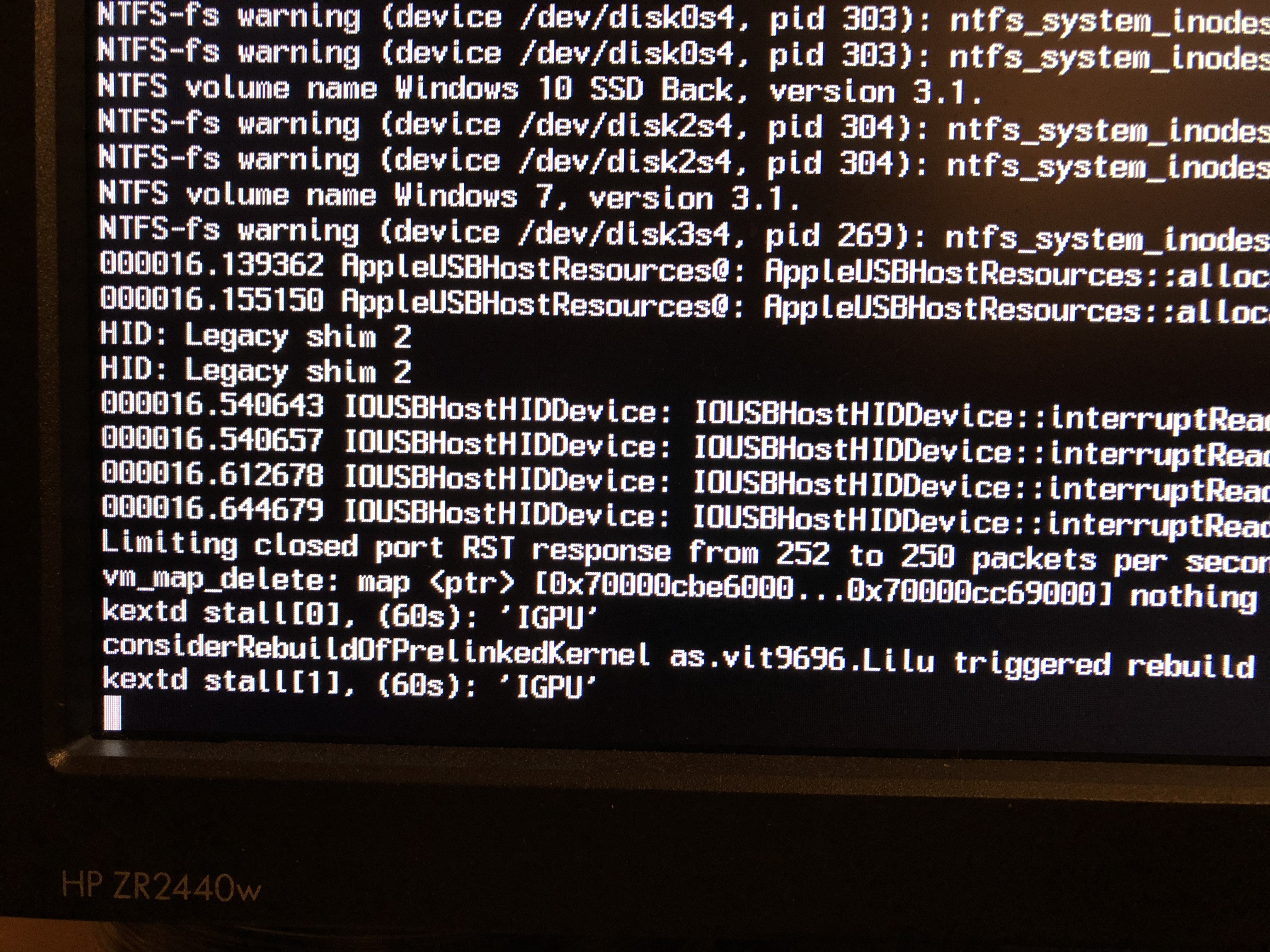

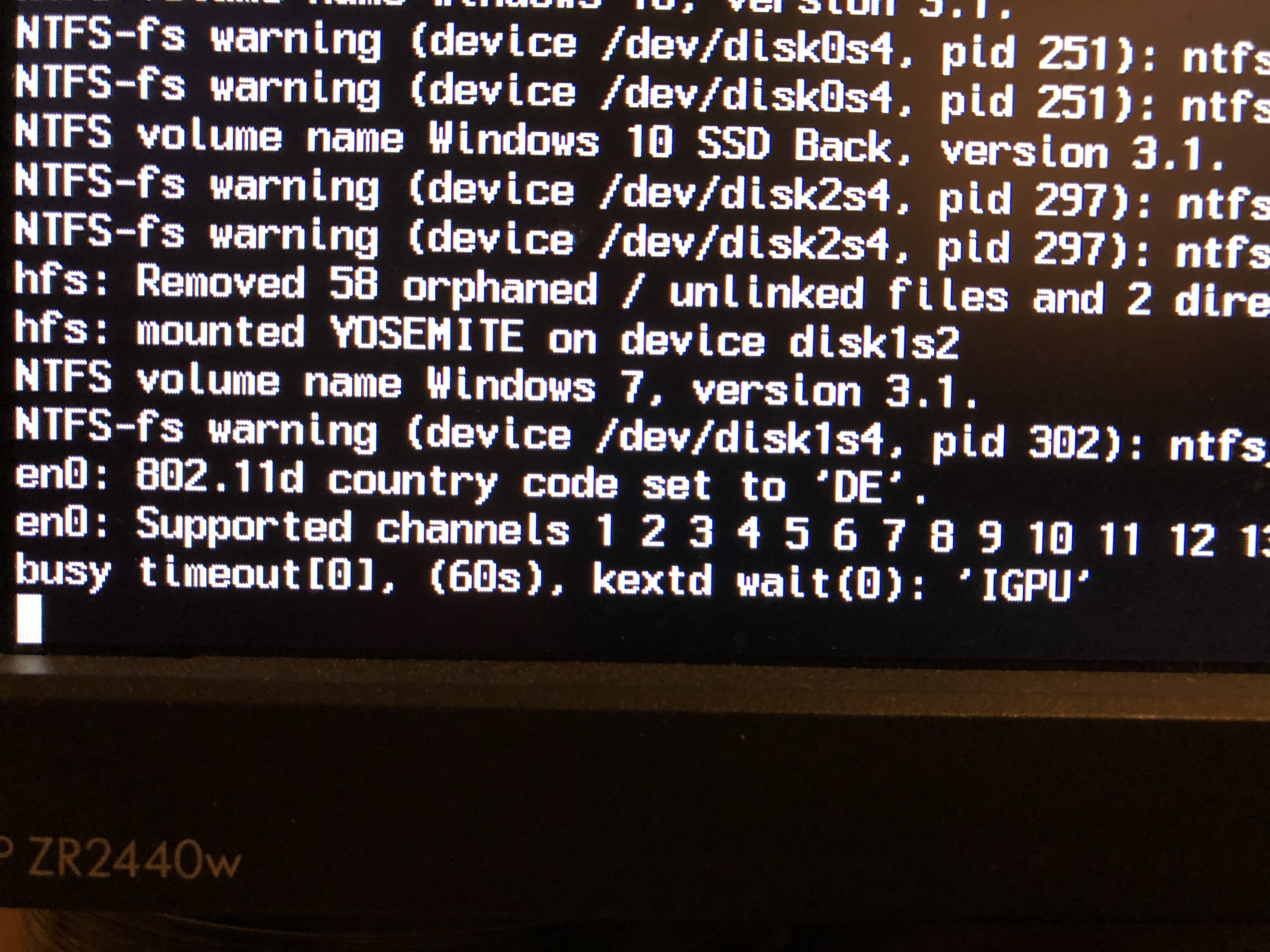

@uglyJoe
Ok - First i removed my Nvidia and activate my IGPU in my firmware setup.
...Did you made your firmware by your self? ... I used the ROM you created for me before.
I also deactivated my DSDT.
When i boot Sierra or Mojave it stops at the boot with the "IGPU" message.
Then I start windows to see if there are logs in the EFI partition from the boot. But there are no logs.
Why Windows? Because it is not possible to boot in any Apple system with the HD4600.
And when I start again with Nvidia the logs will be overwritten or recreated. That happened to me before.
So no logs are created. Why? Or is that still too early in the phase when booting?
And how should I run
./gfxutil -f IGPU
if I can not start a system with the HD4600?
See pictures

Have you analysed the effect of KxldUnmap on Ozmosis? Does a race condition appear in the mentioned case without the use of the patch?
The missing DXE Dependency section was not really intended. XMAX was released as a beta only and during testing no problems appeared when DXE Dep was missing (which doesnt really justify leaving it out though). After the Beta-Release I did some tests with readded DXE Dep as well (also regarding HD4600) but couldn't detect any advantage so I decided it was not worth updating all the ROMs again because of that. IMHO with the recent updates on HD4600 and all the drivers now commonly used in XMAX roms etc. DXE Depex should be rewritten (if even possible, probably no without source/inf and dsc) to ensure Ozmosis is loading at the intended time, I don't know if that is possible though, you are free to look into that if you want to :)

bootchimecfg.efi -t
Outputted devices:
1. HDMI - other internal
2. HDMI - other internal
3. HDMI - other internal
4. HDMI - other internal
5. SPDIF - other internal
6. Line - rear external
7. Line - rear external
8. Line - rear external
9. Headphones - front external
10. SPDIF - rear external
