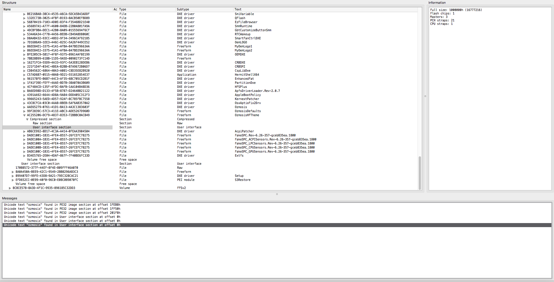

@cecekpawon I tried to use your Kernextpatcher.  File first I converted it to a FFS. AND ADDED TO A BIOS… (2)  THEN I PUT THE FILE IN TO OZ/Extentions/common/ folder  but I could not get to a boot screen in Catalina . Though I can install Mojove. From a usb stick
@cecekpawon I have tried your latest KernextPatcher. but with it I could not boot into Mojave o\s. the progress bar took a long time and went to a black screen for me so I did not try Cataalina from my usb install.
how I used your file. I replaced  the body of the KernextPatcher of a working bios with your file  using the UEFITOOL

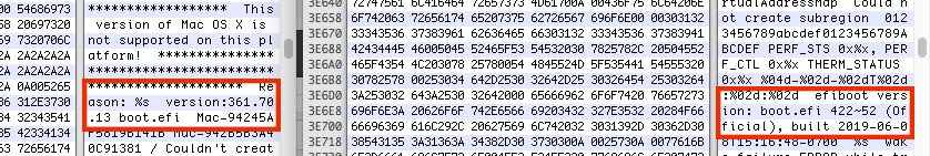

Yes, they forgot to include their stupid booter version (BooterOSVersion remain 10.12) on Catalina booter. I used it as my Clover booter patch filter by version.
Edited by cecekpawon

I think what you need to do is:
1. To insert all modules provided by @typethree above:
- Patched Ozmosis, config, and theme.
- FS driver: Replace FileSystem (93022F8C-1F09-47EF-BBB2-5814FF609DF5) with AppleFat(*). Insert AppleHfs(*), and ApfsLoader.
- UEFTW: KernextPatcher, DevProp + AppleDevProp (*), with additional Darboot+ AppleBootPolicy and AcpiPatcher(**).
- Aptio-Mem-Fix.
- Shell.
* You may extract latest Apple modules with this script https://gist.github.com/cecekpawon/e38bda384ff115f09e638482849deb2d
** Darboot is a helper to create boot entries when Ozmosis cant read some new boot.efi paths, mostly installer (if it isnt blessed already). Disable this driver with boot-args / plist if it start to screwed up your current boot entries by Ozmosis. Its recommended to load as one boot time only. You are still able to manually launch the boot.efi from uefi shell isnt it? While AcpiPatcher to bin patch your acpi tables. You dont need this if you are preferred to load your fixed tables by Ozmosis. https://github.com/cecekpawon/UEFTW/wiki
2. Pray for upcoming fresh release from trve devs.
