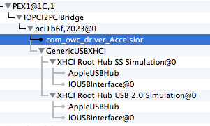

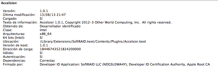

Maniac10 Posted August 22, 2013 Share Posted August 22, 2013 It looks like OWC Accelsio's kext is being loaded along with GenericUSBXHCI on Mavericks DP6. Weird... Loaded at boot: In IOREG: In loaded kexts: The kext is located in /Library/Extensions/SoftRAID.kext/Contents/PlugIns/ Link to comment https://www.insanelymac.com/forum/topic/286860-genericusbxhci-usb-30-driver-for-os-x-with-source/page/10/#findComment-1940675 Share on other sites More sharing options...

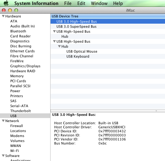

Slice Posted August 30, 2013 Share Posted August 30, 2013 Hi Zenith432, May I come in? I acquire an USB3 PCIe controller with chip VIA VL800-Q8 and I want to make it working. First results in 10.8.4 (my build from git): - Initialization about a minute. - Write 420Mb to USB3 stick at 30sec. - Read 420Mb from the stick at 8 sec. - Going to sleep and it waked up immediately . - After wake the USB drive is mounted but not working. I tried the same driver in 10.7.5 (not possible to compile here) It loaded but works incorrectly It seems PCI operations should be revised. PCI DeviceID must be uint16 but not uint32. Will think more. 1 Link to comment https://www.insanelymac.com/forum/topic/286860-genericusbxhci-usb-30-driver-for-os-x-with-source/page/10/#findComment-1942199 Share on other sites More sharing options...

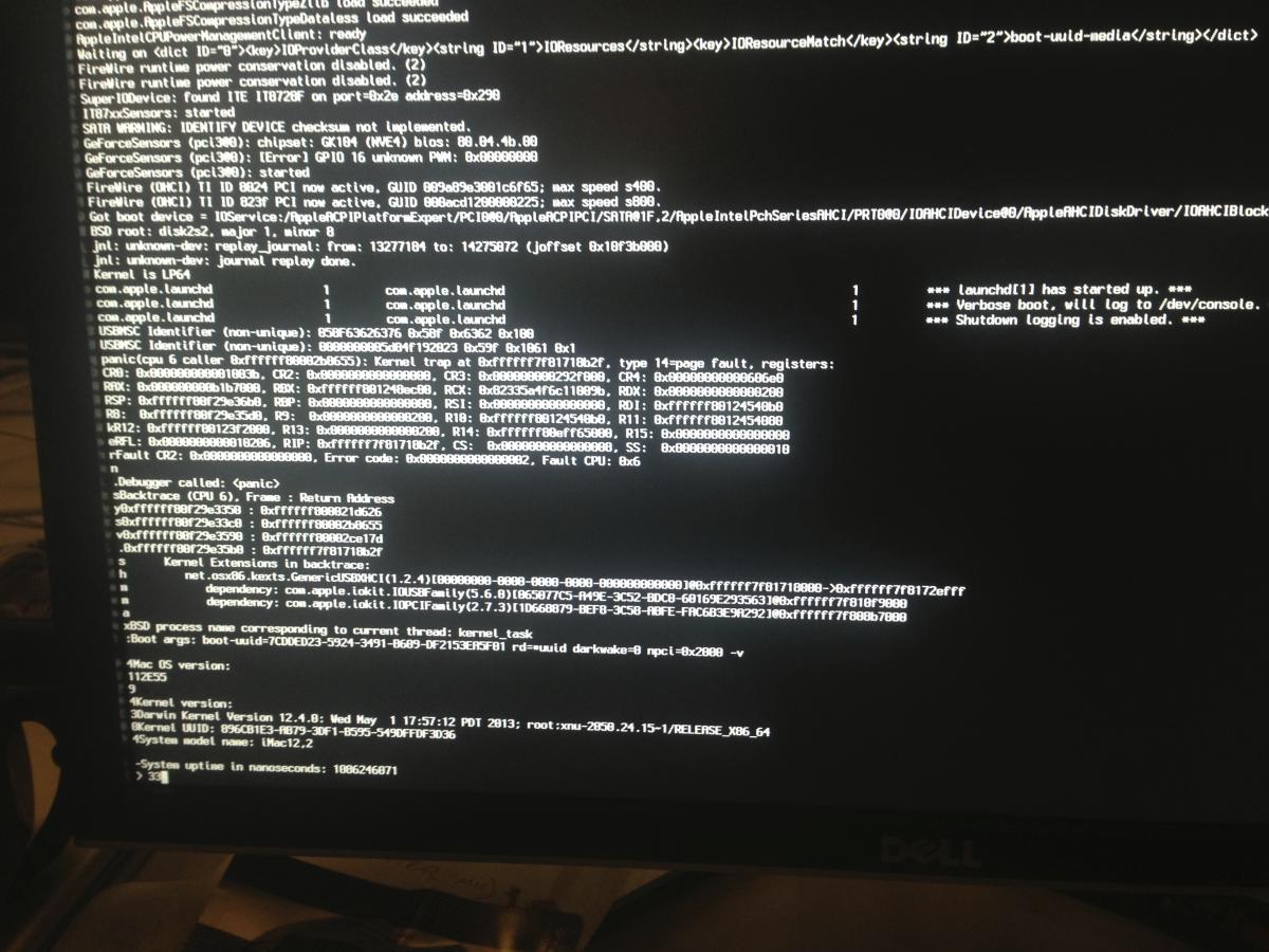

g3power Posted August 30, 2013 Share Posted August 30, 2013 Fri Aug 30 16:28:54 2013 panic(cpu 1 caller 0xffffff801e0b8655): Kernel trap at 0xffffff7f9f803b2f, type 14=page fault, registers: CR0: 0x000000008001003b, CR2: 0x0000000000000000, CR3: 0x0000000020d8b000, CR4: 0x0000000000000660 RAX: 0x00000001b2f7e000, RBX: 0xffffff803dc3fb00, RCX: 0x6333c418335a0028, RDX: 0x0000000000000200 RSP: 0xffffff810629b6b0, RBP: 0x0000000000000000, RSI: 0x0000000000000000, RDI: 0xffffff8042c2e2b0 R8: 0xffffff810629b5d0, R9: 0x0000000000000200, R10: 0xffffff8042c2e2b0, R11: 0xffffff8042c2e280 R12: 0xffffff8034618000, R13: 0x0000000000000200, R14: 0xffffff81062ee000, R15: 0x0000000000000000 RFL: 0x0000000000010206, RIP: 0xffffff7f9f803b2f, CS: 0x0000000000000008, SS: 0x0000000000000000 Fault CR2: 0x0000000000000000, Error code: 0x0000000000000002, Fault CPU: 0x1 Backtrace (CPU 1), Frame : Return Address 0xffffff810629b350 : 0xffffff801e01d626 0xffffff810629b3c0 : 0xffffff801e0b8655 0xffffff810629b590 : 0xffffff801e0ce17d 0xffffff810629b5b0 : 0xffffff7f9f803b2f Kernel Extensions in backtrace: net.osx86.kexts.GenericUSBXHCI(1.2.4)[00000000-0000-0000-0000-000000000000]@0xffffff7f9f803000->0xffffff7f9f819fff dependency: com.apple.iokit.IOUSBFamily(5.6.0)[065077C5-A49E-3C52-BDC0-60169E293563]@0xffffff7f9e597000 dependency: com.apple.iokit.IOPCIFamily(2.7.3)[1D668879-BEF8-3C58-ABFE-FAC6B3E9A292]@0xffffff7f9e56e000 BSD process name corresponding to current thread: kernel_task Mac OS version: 12E55 Kernel version: Darwin Kernel Version 12.4.0: Wed May 1 17:57:12 PDT 2013; root:xnu-2050.24.15~1/RELEASE_X86_64 Kernel UUID: 896CB1E3-AB79-3DF1-B595-549DFFDF3D36 Kernel slide: 0x000000001de00000 Kernel text base: 0xffffff801e000000 System model name: MacBookPro5,1 Hi Zenith432, thank you for working on this. I just got a USB 3.0 ExpressCard (Transcend TS-PNU3). It works with you driver, but only in a very limited fashion. I can mount and use a USB 2 stick. Sleep causes it to be disconnected (with the appropriate Apple warning) and it is remounted after waking up. When I connect a USB 3.0 2.5 or 3.5 inch disk I get a kernel panic like the one above. If you need further details, I will try and help to get to the root of this. Have you considered merging this into your main line source? https://github.com/RehabMan/OS-X-Generic-USB3 Link to comment https://www.insanelymac.com/forum/topic/286860-genericusbxhci-usb-30-driver-for-os-x-with-source/page/10/#findComment-1942307 Share on other sites More sharing options...
