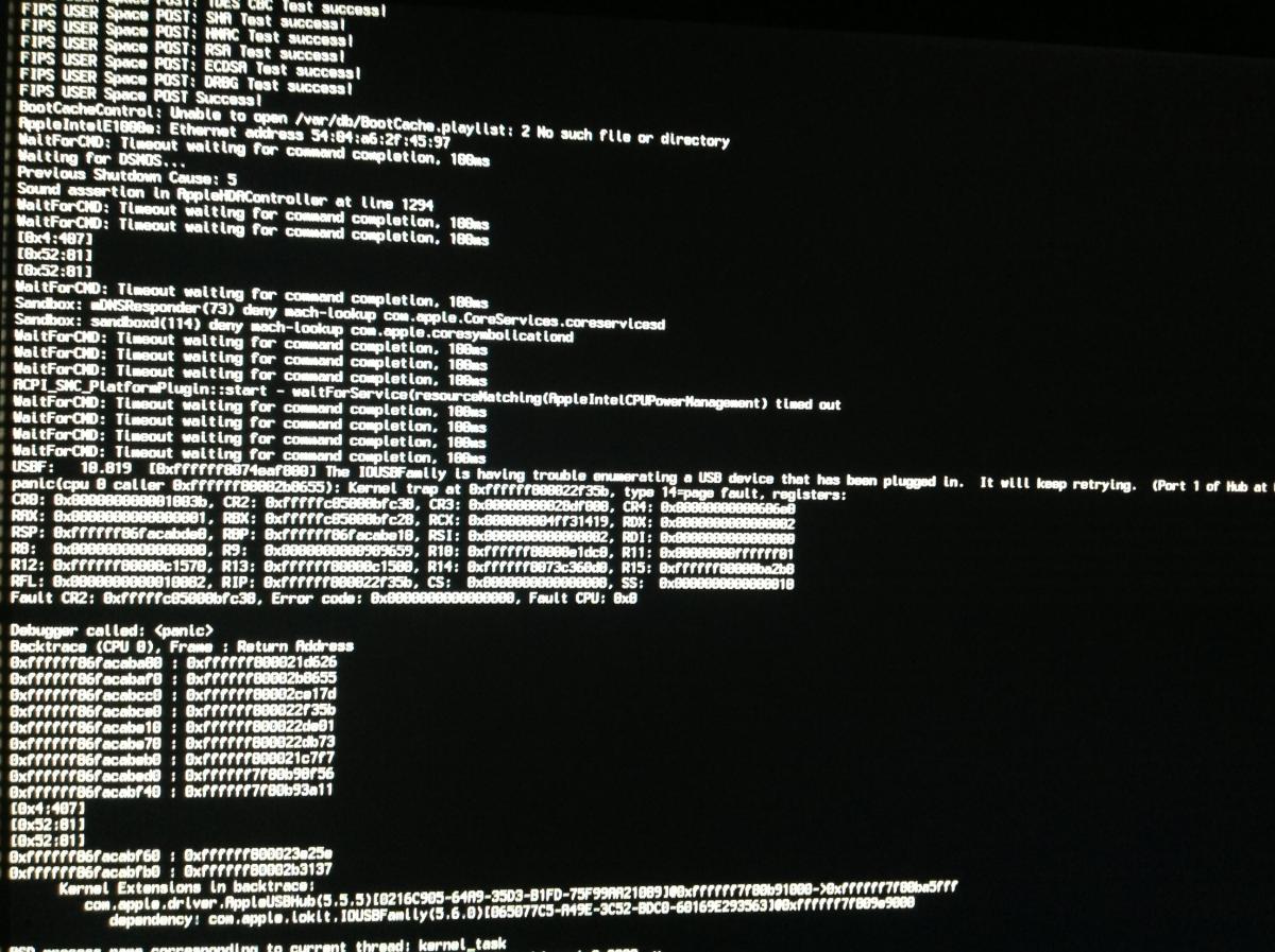

CalDigit - panic after a ~minute;
LaCie - no panic, but a logageddon happens :D no big deal. read speed 15-20 MBps, write speed almost the same (blackmagic disk speed test).
Oyen Digital - no panic.. yet, no log flood. read speed ~20, write speed ~50. i use it as a solution for the first time.
I've tried all of these as well with my Pro and if I inject ven/dev IDs into ASMX to get the rear hub-connected ports going I got a KP with the Oyen driver as well. Maybe it's just a 10.6 thing. At the moment I'm using the Oyen with just the front USB ports.
There's a patched copy of the Lacie to take care of the logging but ultimately I found it didn't work as well as the CalDigit/Oyen drivers.
after changing "legacy usb 3.0" option in bios to off i get kp with Oyen now.. but genericusbxhci now working for 2 ports with 20 MBs speed without kp. although i experience long power off with it. not tested new 1.1.6 version yet.
tested that patched lacie driver before - no luck. log fix is not quite thing i need. thanks anyway.

May 21 18:04:44 MBPX7 kernel[0]: Previous Shutdown Cause: 3
May 21 18:04:44 MBPX7 kernel[0]: SMC::smcInitHelper ERROR: MMIO regMap == NULL - fall back to old SMC mode
May 21 18:04:44 MBPX7 kernel[0]: Transcript Offline - Buffer Pool Allocate [181000] failed
May 21 18:04:44 MBPX7 kernel[0]: No interval found for . Using 8000000
May 21 18:04:44 MBPX7 kernel[0]: Sound assertion "0 == pathMap_aDriverInstance" failed in "/SourceCache/AppleHDA/AppleHDA-179.1.4/AppleHDA/AppleHDADriver.cpp" at line 1656 goto Exit
May 21 18:04:44 MBPX7 kernel[0]: Sound assertion "0 != createAudioEngines ( fPathMap_aDriverInstance )" failed in "/SourceCache/AppleHDA/AppleHDA-179.1.4/AppleHDA/AppleHDADriver.cpp" at line 203 goto Exit
May 21 18:04:44 MBPX7 kernel[0]: kxld[net.osx86.kexts.GenericUSBXHCI]: The super class vtable '__ZTV17IOUSBControllerV3' for vtable '__ZTV14GenericUSBXHCI' is out of date. Make sure your kext has been built against the correct headers.
May 21 18:04:44: --- last message repeated 1 time ---
May 21 18:04:44 MBPX7 kernel[0]: Can't load kext net.osx86.kexts.GenericUSBXHCI - link failed.
May 21 18:04:44 MBPX7 kernel[0]: Failed to load executable for kext net.osx86.kexts.GenericUSBXHCI.
May 21 18:04:44 MBPX7 kernel[0]: Kext net.osx86.kexts.GenericUSBXHCI failed to load (0xdc008016).
May 21 18:04:44 MBPX7 kernel[0]: Failed to load kext net.osx86.kexts.GenericUSBXHCI (error 0xdc008016).
You're using some outdated IOUSBFamily. The one in OS 10.7.5 should be version 510.4.6. I tried loading GenericUSBXHCI with it in both 64-bit and 32-bit yesterday and it worked.

Rampage Dev: The message
WaitForCMD: Timeout waiting for command completion, 100ms
indicates the xhci controller in stalled. The KP later is in Apple's code (AppleUSBHub), probably because the controller is stalled and returning errors AppleUSBHub doesn't process well. I'll need to see a xhcdump of the controller state. Maybe with no connected devices it won't KP so xhcdump can be recorded.
68x: Usually it's because auxillary power is not supplied to the xhci chip during sleep.
