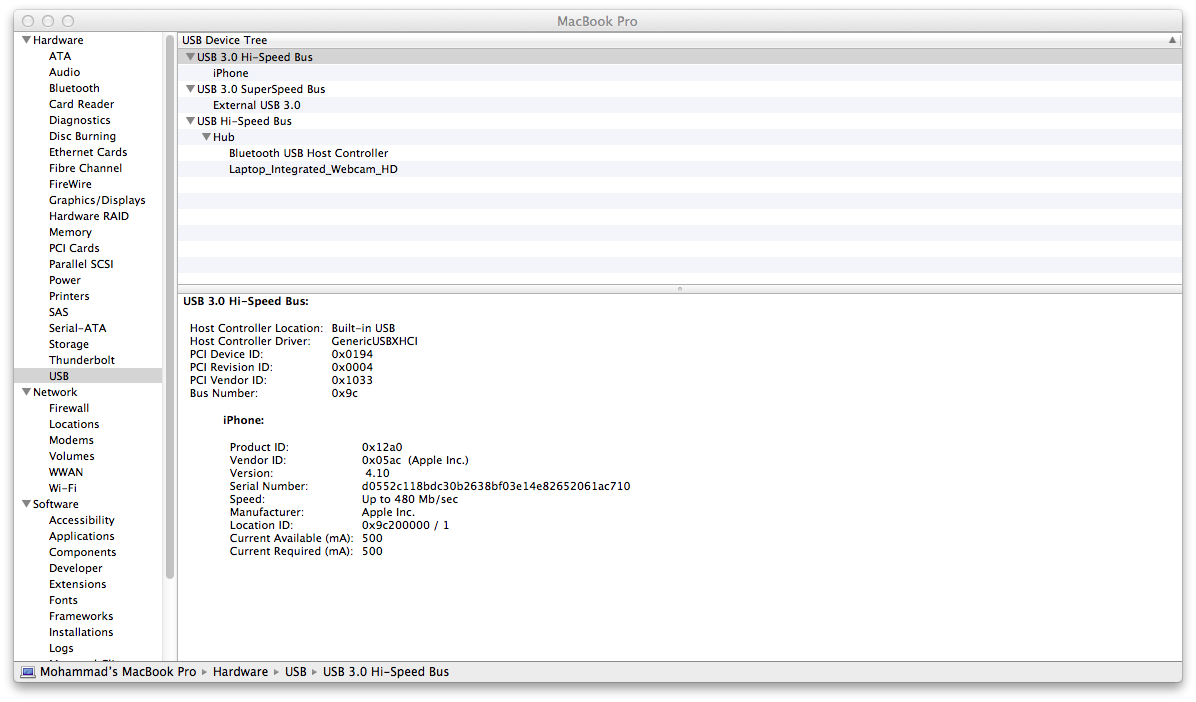

Anonymous03 Posted May 22, 2013 Share Posted May 22, 2013 The screen shot shows the iPhone is connected as a high-speed device, for which 500mA is max. The extra-current errors are for super-speed devices only. so is it possible to enable extra current? With Intel kext and on my macbook it also shows as high speed device, but adds extra operating current EDIT: Attached screens with native intel kext. Archive.zip Link to comment https://www.insanelymac.com/forum/topic/286860-genericusbxhci-usb-30-driver-for-os-x-with-source/page/6/#findComment-1917232 Share on other sites More sharing options...

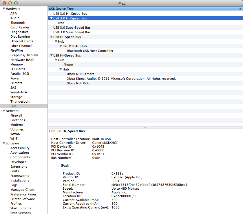

Anonymous03 Posted May 26, 2013 Share Posted May 26, 2013 so is it possible to enable extra current? With Intel kext and on my macbook it also shows as high speed device, but adds extra operating current EDIT: Attached screens with native intel kext. Oh wow! I made IOProbe = -1 on GenericUSBXHCI kext and now extra-current works on both Intel AND ASMedia ports. So now it's like: Generic (-1) -> ASMedia (Generic) works + Intel (Apple native) works + extra-current works Generic (1) -> ASMedia (Generic) works + Intel (Generic) works + NO extra-current Native -> ASMedia (Generic) NOT works + Intel (Apple native) works + extra-current works All devices USB2.0 and mounted on Hi-speed bus. Don't have usb 3.0 devices to test. Link to comment https://www.insanelymac.com/forum/topic/286860-genericusbxhci-usb-30-driver-for-os-x-with-source/page/6/#findComment-1918016 Share on other sites More sharing options...

Zenith432 Posted June 2, 2013 Author Share Posted June 2, 2013 Try changing IOProbeScore from 1 to -1.He's got a Renesas uPD720200a, so that's not going to do anything. This chip is rejected by AppleUSBXHCI. Your screendumps show that you get extra current with AppleUSBXHCI, because the iPad is in fact connected to the EHCI chip on your system. I mentioned in post #134 that you can get the same result by using GenericUSBXHCI with kernel flag '-gux_defer_usb2'. With Intel Series 7, USB2 ports 1-4 can be routed to either XHCI or EHCI. Link to comment https://www.insanelymac.com/forum/topic/286860-genericusbxhci-usb-30-driver-for-os-x-with-source/page/6/#findComment-1919294 Share on other sites More sharing options...
Anonymous03 Posted June 2, 2013 Share Posted June 2, 2013 He's got a Renesas uPD720200a, so that's not going to do anything. This chip is rejected by AppleUSBXHCI. Your screendumps show that you get extra current with AppleUSBXHCI, because the iPad is in fact connected to the EHCI chip on your system. I mentioned in post #134 that you can get the same result by using GenericUSBXHCI with kernel flag '-gux_defer_usb2'. With Intel Series 7, USB2 ports 1-4 can be routed to either XHCI or EHCI. So as far as I understand all usb ports on my motherboard (2 USB2.0 Intel, 2 USB3.0 Intel, 2 USB3.0 ASMedia - 6 total) routs it's USB2.0 devices to Intel EHCI chip (even in ASMedia port) that (with IOProbeScore -1) controlled by AppleUSBEHCI, correct? And even if System Information -> USB -> Host Controller Driver says GenericUSBXHCI in fact iPad at ASMedia port really routed to Intel EHCI chip and controlled via AppleUSBEHCI driver, so extra current works in any port. With IOProbeScore 1 all ports routs to XHCI(intel chip for intel ports, asmedia chip for asmedia ports)/EHCI chip and controlled only via GenericUSBXHCI with no extra current Am I correct? Please correct me if I'm wrong. 1 Link to comment https://www.insanelymac.com/forum/topic/286860-genericusbxhci-usb-30-driver-for-os-x-with-source/page/6/#findComment-1919300 Share on other sites More sharing options...
Zenith432 Posted June 2, 2013 Author Share Posted June 2, 2013 (edited) Am I correct? Please correct me if I'm wrong.Please run 'ioreg -l' (in a Terminal) with your system exactly like in the last screenshot (with 1600mA extra current on any port), and msg me the text dump. This will help me figure out how to enable extra current. Thanks. Edit: The extra-current errors are resolved. I uploaded v1.2.2 that fixes this. Edited June 2, 2013 by Zenith432 2 Link to comment https://www.insanelymac.com/forum/topic/286860-genericusbxhci-usb-30-driver-for-os-x-with-source/page/6/#findComment-1919303 Share on other sites More sharing options...

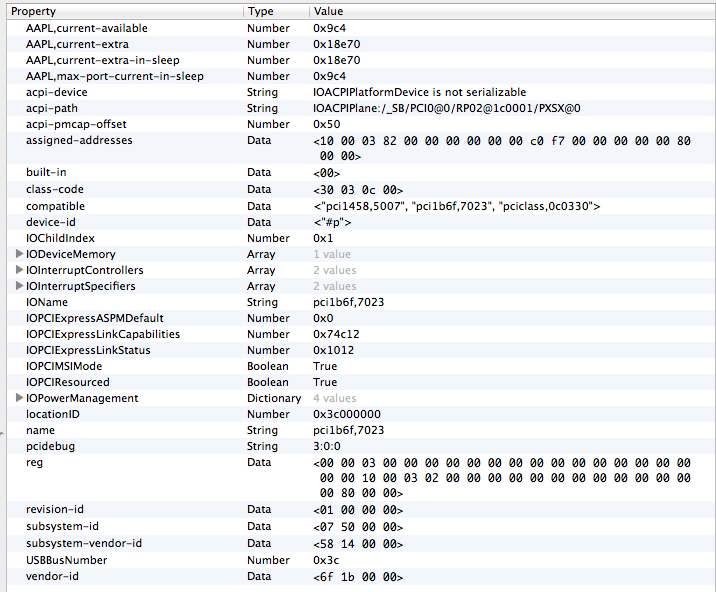

Maniac10 Posted June 3, 2013 Share Posted June 3, 2013 Edit: The extra-current errors are resolved. I uploaded v1.2.2 that fixes this. Is this right? The current values seems too high. Link to comment https://www.insanelymac.com/forum/topic/286860-genericusbxhci-usb-30-driver-for-os-x-with-source/page/6/#findComment-1919441 Share on other sites More sharing options...
Zenith432 Posted June 3, 2013 Author Share Posted June 3, 2013 Is this right? The current values seems too high.It's right. You can inject these values on your own to the xHC PCI devices via DSDT. AAPL,current-available - max current per port (integer) AAPL,current-extra - total available extra current for all ports in system (integer) AAPL,max-port-current-in-sleep - max current per port in sleep (integer) AAPL,current-extra-in-sleep - total available extra current for all ports in system during sleep (integer) The defaults are high so requests for extra current succeed Finally got the dump from the user.These dumps show the xHC is operating normally before the offending device is inserted. There is one connected USB3 hub, but I assume it's a different device that does work. So it must be something about the offending device's descriptors that's causing the problem. There are a couple of things about the KP dump in post #122 That msg with WaitForCMD Timeout - I added more info to that in 1.2.2 that would help me better determine where it's coming from. So if the user could rerun the KP with 1.2.2 and upload the panic log that would help. It shows IOUSBFamily v5.6.0, which is from some beta build of 10.8.4. I don't have the binaries (or sources) for this IOUSBFamily, so I can't locate the point of crash. It's possible (in theory) that changes in the UIM interface in 10.8.4beta introduced some new incompatibility that's partially responsible for the KP. If you could either try the offending device on 10.8.3 (with kext v1.2.2), or upload the binary of IOUSBFamily being used for me, that would help. Does the offending device cause the KP when connected via the USB3 hub, when connected directly to the root hub, or both? Link to comment https://www.insanelymac.com/forum/topic/286860-genericusbxhci-usb-30-driver-for-os-x-with-source/page/6/#findComment-1919478 Share on other sites More sharing options...
Maniac10 Posted June 4, 2013 Share Posted June 4, 2013 It's right. You can inject these values on your own to the xHC PCI devices via DSDT. AAPL,current-available - max current per port (integer) AAPL,current-extra - total available extra current for all ports in system (integer) AAPL,max-port-current-in-sleep - max current per port in sleep (integer) AAPL,current-extra-in-sleep - total available extra current for all ports in system during sleep (integer) The defaults are high so requests for extra current succeed No need to touch the DSDT, I trust your judgement. I just thought current-extra and current-extra-in-sleep values (0x18e70) were too high compared to the ones in most USB patches (0xa8c-0x834) <- Are these other values correct? Link to comment https://www.insanelymac.com/forum/topic/286860-genericusbxhci-usb-30-driver-for-os-x-with-source/page/6/#findComment-1919657 Share on other sites More sharing options...
