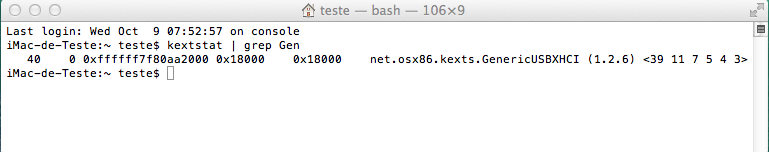

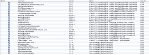

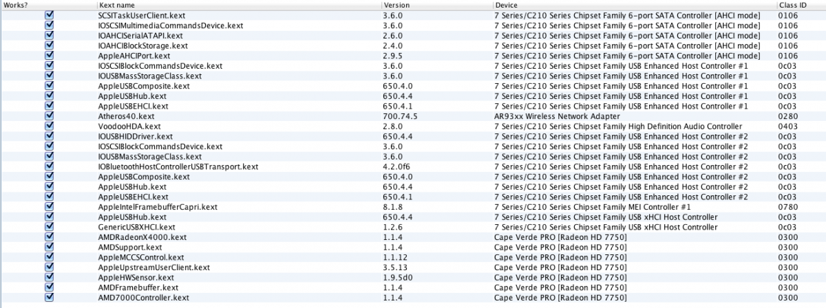

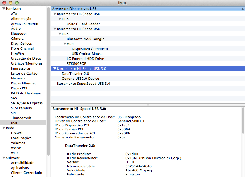

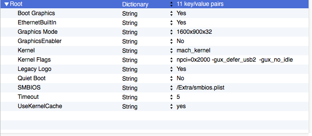

JorgeMax Posted October 9, 2013 Share Posted October 9, 2013 With the run command in the terminal: How is my org.chameleon.boot.plist configured: And here's report system: With System Info: Link to comment https://www.insanelymac.com/forum/topic/286860-genericusbxhci-usb-30-driver-for-os-x-with-source/page/15/#findComment-1952645 Share on other sites More sharing options...

Zenith432 Posted October 9, 2013 Author Share Posted October 9, 2013 JorgeMax: What exactly is not working? Upload output of 'xhcdump running'. PS: If using '-gux_defer_usb2', then any USB 2.0 device would appear under the EHCI tree. You should see only superspeed xhci devices under "Barramento Superspeed USB 3.0", assuming such device is connected. joe75: If you mean loadedkextmt.plist, then I do have one under GM. Link to comment https://www.insanelymac.com/forum/topic/286860-genericusbxhci-usb-30-driver-for-os-x-with-source/page/15/#findComment-1952702 Share on other sites More sharing options...

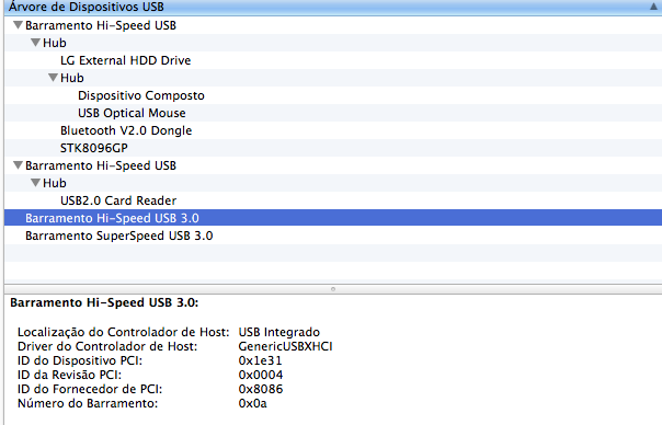

JorgeMax Posted October 9, 2013 Share Posted October 9, 2013 JorgeMax: What exactly is not working? Upload output of 'xhcdump running'. PS: If using '-gux_defer_usb2', then any USB 2.0 device would appear under the EHCI tree. You should see only superspeed xhci devices under "Barramento Superspeed USB 3.0", assuming such device is connected. joe75: If you mean loadedkextmt.plist, then I do have one under GM. Friend the only USB device when I can test is version 2.0, 3.0 with one USB 3.0 external HDD from my brother. But I can only test it on my doors at night when he gets the service. Only I'm finding it strange the USB 2.0 ports are not recognized by USB 3.0 when I'm using the Mavericks ML 10.8.5 and now it is recognized. Link to comment https://www.insanelymac.com/forum/topic/286860-genericusbxhci-usb-30-driver-for-os-x-with-source/page/15/#findComment-1952760 Share on other sites More sharing options...
Zenith432 Posted October 9, 2013 Author Share Posted October 9, 2013 When booting with '-gux_defer_usb2' USB 2.0 devices are never going to be recognized by the USB 3.0 controller. They'll show up on the USB 2.0 controller. Remove this kernel flag, reboot, and see what happens then. The reason this flag is recommended, is because on some MBs with Intel series 7, when USB 2.0 ports are routed to xhci, they cause instant-wakeup-on-sleep. It's a hardware bug, but not all MBs suffer from this. So try taking it out and see. Friend the only USB device when I can test is version 2.0, 3.0 with one USB 3.0 external HDD from my brother. But I can only test it on my doors at night when he gets the service. Only I'm finding it strange the USB 2.0 ports are not recognized by USB 3.0 when I'm using the Mavericks ML 10.8.5 and now it is recognized. Link to comment https://www.insanelymac.com/forum/topic/286860-genericusbxhci-usb-30-driver-for-os-x-with-source/page/15/#findComment-1952774 Share on other sites More sharing options...
JorgeMax Posted October 9, 2013 Share Posted October 9, 2013 Removed the flag "-gux_defer_usb2" friend, but still the same, no work with USB 2.0 devices such as USB key, keyboard, mouse and a USB 2.0 HDD I have here none was recognized. Just missing one that I test is 3.0. Link to comment https://www.insanelymac.com/forum/topic/286860-genericusbxhci-usb-30-driver-for-os-x-with-source/page/15/#findComment-1952780 Share on other sites More sharing options...

JorgeMax Posted October 9, 2013 Share Posted October 9, 2013 Upload 'xhcdump running' with these devices connected. Look says that the command does not exist! And with two USB 2.0 flash drives plugged into USB 3.0 ports. And do not react at all. Link to comment https://www.insanelymac.com/forum/topic/286860-genericusbxhci-usb-30-driver-for-os-x-with-source/page/15/#findComment-1952791 Share on other sites More sharing options...

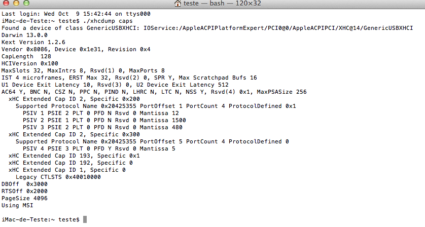

Zenith432 Posted October 9, 2013 Author Share Posted October 9, 2013 JorgeMax: xhci chip is hosed because it's not delivering interrupts. Are you sure you have '-gux_no_idle'? Please run './xhcdump caps' as well and upload. Thanks. 1 Link to comment https://www.insanelymac.com/forum/topic/286860-genericusbxhci-usb-30-driver-for-os-x-with-source/page/15/#findComment-1952813 Share on other sites More sharing options...
JorgeMax Posted October 9, 2013 Share Posted October 9, 2013 Devices appeared here: . / xhcdump caps look: Link to comment https://www.insanelymac.com/forum/topic/286860-genericusbxhci-usb-30-driver-for-os-x-with-source/page/15/#findComment-1952817 Share on other sites More sharing options...
Zenith432 Posted October 9, 2013 Author Share Posted October 9, 2013 It's because you're running without '-gux_no_idle'. It's a new issue with 10.9 that sometimes interrupts are stalled due to the Intel low-power mode. Add '-gux_no_idle' kernel flag and reboot. Run './xhcdump caps'. It should say "Intel Doze Disabled" in the very last line. Link to comment https://www.insanelymac.com/forum/topic/286860-genericusbxhci-usb-30-driver-for-os-x-with-source/page/15/#findComment-1952825 Share on other sites More sharing options...

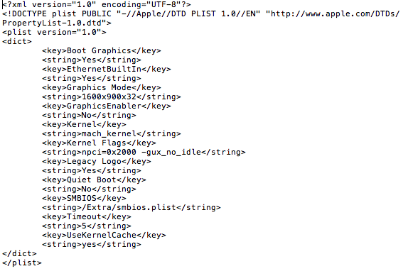

JorgeMax Posted October 9, 2013 Share Posted October 9, 2013 Take a look at my org.chameleon.boot.plist!: Is it also because this flag: npci = 0x2000? Because it does not have the ML 10.8.5 and USB 3.0 ports work in ML. Link to comment https://www.insanelymac.com/forum/topic/286860-genericusbxhci-usb-30-driver-for-os-x-with-source/page/15/#findComment-1952832 Share on other sites More sharing options...
Zenith432 Posted October 9, 2013 Author Share Posted October 9, 2013 Your Boot.plist file looks fine, but maybe you have two different Boot.plist - one for 10.8.5, and one for 10.9. Do you have the chameleon bdmesg utility (in /usr/sbin/bdmesg). If so, boot 10.9, and run 'bdmesg >bdmesg.txt'. Look in bdmesg.txt toward the end. It lists all the kernel flags it booted with. See what it says. Anyhow, if you boot with '-gux_no_idle', your 'xhcdump caps' should say 'Intel Doze Disabled' as the last line. Edit: try to manually type '-gux_no_idle' on the chameleon command line before booting - see if that catches on. Is it also because this flag: npci = 0x2000? Because it does not have the ML 10.8.5 and USB 3.0 ports work in ML. 1 Link to comment https://www.insanelymac.com/forum/topic/286860-genericusbxhci-usb-30-driver-for-os-x-with-source/page/15/#findComment-1952838 Share on other sites More sharing options...
JorgeMax Posted October 9, 2013 Share Posted October 9, 2013 I alternated boot.plist friend in the flags "-gux_no_idle" and placed before the "NPCI = 0x2000". But I put in the time to boot the system to flag you indicated and when the system started and appeared to "Desktop / Mesa" I plugged in the USB ports USB 3.0 and it worked, now I try to start the system without typing anything on startup. Your Boot.plist file looks fine, but maybe you have two different Boot.plist - one for 10.8.5, and one for 10.9. Do you have the chameleon bdmesg utility (in /usr/sbin/bdmesg). If so, boot 10.9, and run 'bdmesg >bdmesg.txt'. Look in bdmesg.txt toward the end. It lists all the kernel flags it booted with. See what it says. Anyhow, if you boot with '-gux_no_idle', your 'xhcdump caps' should say 'Intel Doze Disabled' as the last line. Edit: try to manually type '-gux_no_idle' on the chameleon command line before booting - see if that catches on. No works by boot.plist, only if I start typing on the screen chameleon works oh yes flag:-gux_no_idle. Does it have another way to make this work without flag be entered manually? Link to comment https://www.insanelymac.com/forum/topic/286860-genericusbxhci-usb-30-driver-for-os-x-with-source/page/15/#findComment-1952849 Share on other sites More sharing options...

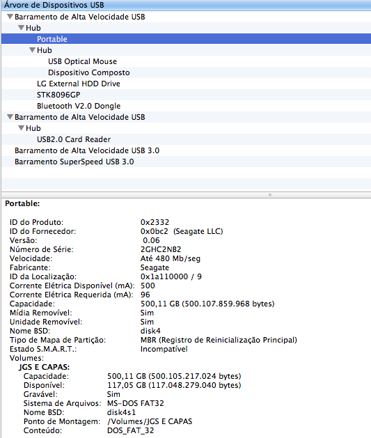

JorgeMax Posted October 11, 2013 Share Posted October 11, 2013 Have here a Seagate HDD USB 3.0 with the reference number: P / N 9SCAL4-500 and S / N 2GHC2NB2 that when plugged in the USB 3.0 ports do not ride it! But the power led lights it. I'm with GenereicUSBXHCI in version 1.2.6 Final. This is now the HDD plugged into a USB 2.0 port. That does not mount a USB 3.0 port. And @ Zenith432, the problem is the bootloader Mavericks 10.9GM same! That is not 100% compatible with this system yet, the boot flag "-gux_no_idle" does not load when inserted into org.chameleon.boot.plist only if manually typed in the same tele boot. Link to comment https://www.insanelymac.com/forum/topic/286860-genericusbxhci-usb-30-driver-for-os-x-with-source/page/15/#findComment-1953480 Share on other sites More sharing options...
