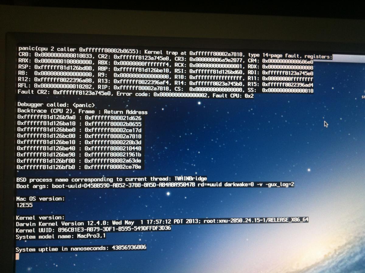

Inspector42 Posted June 16, 2013 Share Posted June 16, 2013 This is really great stuff, my external Seagate Expansion Drive works like a charm. There is only one downside: Every time I try to access my old USB Scanner (Agfa SnapScan) while the USB3 external disk is connected the system freezes. This happens either after startup or restart when you log in as a user with the scanner connected or if you connect the scanner while the system is running I have been able to capture one kernel panic (see below), which indicates that TWAINBridge is the culprit, but I have no clue what is happening. I have also installed TWAIN SANE from Mattias Ellert (http://www.ellert.se/twain-sane/) incl. libusb (http://libusb.sourceforge.net/). Strange enough, if the external drive is connected via USB2, everything works without issues. I am running 10.8.4 on a GA-Z68X-UD3H-B3 with F12 Bios and Version 1.2.4 of GenericUSBXHCI.kext. What would be a reasonable next step to further investigate ? [EDIT] Removed TWAIN SANE and no more freezes. Unfortunately the scanner is not working without. Link to comment https://www.insanelymac.com/forum/topic/286860-genericusbxhci-usb-30-driver-for-os-x-with-source/page/8/#findComment-1924668 Share on other sites More sharing options...

Zenith432 Posted June 16, 2013 Author Share Posted June 16, 2013 Really attaching the KP. When TWAIN SANE is not installed and it doesn't freeze, run 'xhcdump slots', and the 'xhcdump endpoints #' on the slot # for the scanner and upload the output. What would be a reasonable next step to further investigate ? [EDIT] Removed TWAIN SANE and no more freezes. Unfortunately the scanner is not working without. Link to comment https://www.insanelymac.com/forum/topic/286860-genericusbxhci-usb-30-driver-for-os-x-with-source/page/8/#findComment-1924750 Share on other sites More sharing options...

Inspector42 Posted June 17, 2013 Share Posted June 17, 2013 Really attaching the KP. When TWAIN SANE is not installed and it doesn't freeze, run 'xhcdump slots', and the 'xhcdump endpoints #' on the slot # for the scanner and upload the output. Sorry I forgot to attach the KP. When running xhcdump the scanner does not show up as it is connected to one of the USB2 sockets via a hub (USB1 only). All USB2 sockets on my board are served from the Z68 Chipset, the USB3 is served by Etron EJ168. I have attached the results anyway including Apples System Report and IORegistryExplorer data. $ xhcdump slots Found a device of class GenericUSBXHCI: IOService:/AppleACPIPlatformExpert/PCI0@0/AppleACPIPCI/PEG1@1,1/IOPCI2PCIBridge/pci1b6f,7023@0/GenericUSBXHCI Slot 1, Device Address 1 State Configured Route String 0 Speed Super, Last Endpoint 4 RH Port #3, Interrupter 0, Max Exit Latency 0 us Found a device of class GenericUSBXHCI: IOService:/AppleACPIPlatformExpert/PCI0@0/AppleACPIPCI/PEX4@1C,4/IOPCI2PCIBridge/pci1b6f,7023@0/GenericUSBXHCI $ xhcdump endpoints 1 Found a device of class GenericUSBXHCI: IOService:/AppleACPIPlatformExpert/PCI0@0/AppleACPIPCI/PEG1@1,1/IOPCI2PCIBridge/pci1b6f,7023@0/GenericUSBXHCI Endpoint 1, Type Control, State Running Multiple 1, Interval 1 microframes, CErr 3, Max Burst 1, Max Packet Size 512 Average TRB Length 8, Max ESIT Payload 0 Endpoint 3, Type Bulk In, State Running Multiple 1, Interval 1 microframes, CErr 3, Max Burst 16, Max Packet Size 1024 Average TRB Length 1024, Max ESIT Payload 0 Endpoint 4, Type Bulk Out, State Running Multiple 1, Interval 1 microframes, CErr 3, Max Burst 16, Max Packet Size 1024 Average TRB Length 1024, Max ESIT Payload 0 Found a device of class GenericUSBXHCI: IOService:/AppleACPIPlatformExpert/PCI0@0/AppleACPIPCI/PEX4@1C,4/IOPCI2PCIBridge/pci1b6f,7023@0/GenericUSBXHCI USB_Config_Freeze_USB3.tiff USB_Config_System_Report_Freeze_USB3.tiff Link to comment https://www.insanelymac.com/forum/topic/286860-genericusbxhci-usb-30-driver-for-os-x-with-source/page/8/#findComment-1924999 Share on other sites More sharing options...
