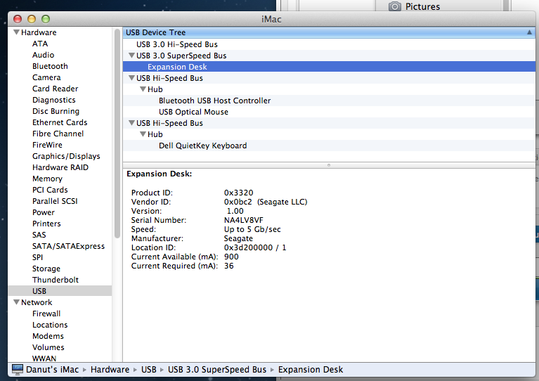

Zenith432 Posted September 26, 2013 Author Share Posted September 26, 2013 daniesy: The device is recognized, but for some reason is inoperable. I need to you to run "xhcdump slots", and then "xhcdump endpoints #", where # is the slot # where the drive is listed in the slots dump. Then upload them. Also, run "diskutil list" check to see if you see the volume names you expect on this drive on one of the devices, and load the /dev/disk... for that device. Thanks. loKEY: You're not using 1.2.6d3, because I don't see the new prints I added in your dump. 1 Link to comment https://www.insanelymac.com/forum/topic/286860-genericusbxhci-usb-30-driver-for-os-x-with-source/page/13/#findComment-1948829 Share on other sites More sharing options...
daniesy Posted September 26, 2013 Share Posted September 26, 2013 Thanks for the response! I've uploaded both the slots and endpoints dumps. The diskutil list only shows my internal sata drives... I should mention that the drive works correctly on the other USB 2 ports and if i leave it plugged in when i boot, it takes a lot of time, and after boot is finished, the mouse and keyboard hangs for about 15 seconds. This started happening only after installing the GenericUSBXHCI.kext file. slots.txt endpoints.txt Link to comment https://www.insanelymac.com/forum/topic/286860-genericusbxhci-usb-30-driver-for-os-x-with-source/page/13/#findComment-1948830 Share on other sites More sharing options...
Zenith432 Posted September 26, 2013 Author Share Posted September 26, 2013 The drive uses streams-endpoints. Support for streams appears to be broken at the moment for all such drives. There's an open ticket about this. The reason it works on USB 2.0 ports is because it falls back to legacy mode (USB 2.0 didn't have streams at all.) I'll try make a temporary workaround that disables streams support and (hopefully) forces the drive to fallback to normal bulk endpoints. This probably impacts performance, but at the least the drive will work. I've uploaded both the slots and endpoints dumps. 1 Link to comment https://www.insanelymac.com/forum/topic/286860-genericusbxhci-usb-30-driver-for-os-x-with-source/page/13/#findComment-1948837 Share on other sites More sharing options...
