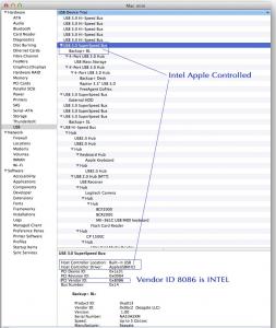

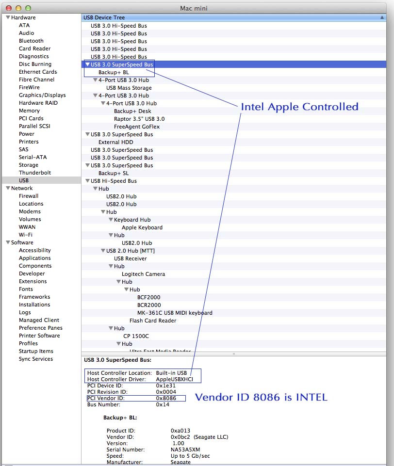

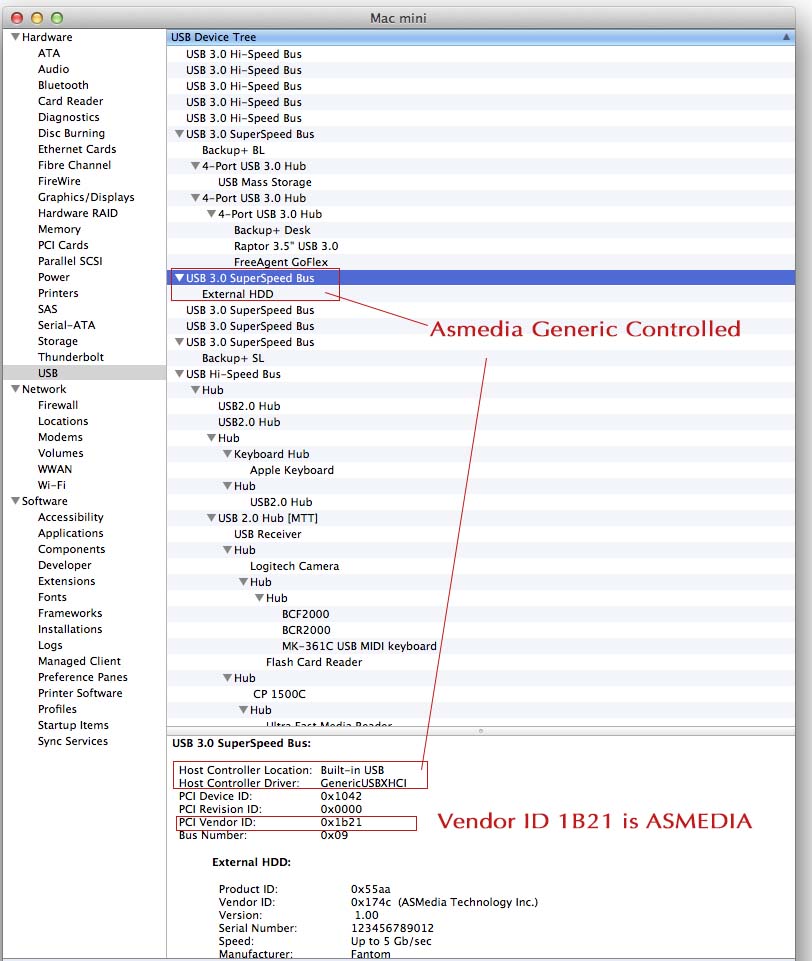

Gringo Vermelho Posted September 1, 2013 Share Posted September 1, 2013 By changing the Generic driver IOProbe to -1 it now has lesser priority then Apple (0). The Apple driver as such takes priority for any device it finds, which in this case is only the intel controller. Then the generic driver is free to control any other non-intel device-id USB 3.0 controller it finds. Thank you, this is a great trick. I like to leave system files alone as far as possible, I'd given up figuring out how to get around this without modifying the Apple driver ioprobescore value. I'd never have thought of trying -1 in zenith's driver, I wasn't aware you could go below zero. Link to comment https://www.insanelymac.com/forum/topic/286860-genericusbxhci-usb-30-driver-for-os-x-with-source/page/11/#findComment-1942700 Share on other sites More sharing options...
flmmkr Posted September 1, 2013 Share Posted September 1, 2013 Genzai, thanks a lot for all your help with this. I checked System Info and the ports are using the different kext as they should. I hooked up another external hard drive (actually just a SATA to USB3 interface from an external hard drive I had taken apart previously with a 3.5" hard drive) and tested that instead of my portable drives. The speeds were the same with or without the kext installed. I was using The Blackmagic Design Disk Speed Test utility and that shows a slow speed for the portable drive when the kext is installed. So I ran the AJA System Test and that showed a speed that was the same whether the kext was installed or not. So the BMD Disk Speed Test seems to give different results for some reason. So you were right of course. It looks to be working properly just like you said and just an anomaly in the disk speed test. Now I just need to get hold of a drive that was causing the freezing so I can test that. And thanks for the explanation of what's happening with the IO Probe Score. It helps a lot to understand how all this is working. Link to comment https://www.insanelymac.com/forum/topic/286860-genericusbxhci-usb-30-driver-for-os-x-with-source/page/11/#findComment-1942728 Share on other sites More sharing options...
