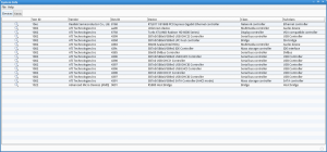

clemj06 Posted April 16, 2013 Share Posted April 16, 2013 I knew to change to PEGP from the wordpress site...I used the same for my DSDT, its just that yours is a bit more complicated than mine... Yeah, you do have the systeminfo app right? from http://olarila.com/kexts/SystemInfo.zip Link to comment https://www.insanelymac.com/forum/topic/285760-help-topic-for-help-in-os-x-yosemite-1010-and-below/page/39/#findComment-1907599 Share on other sites More sharing options...

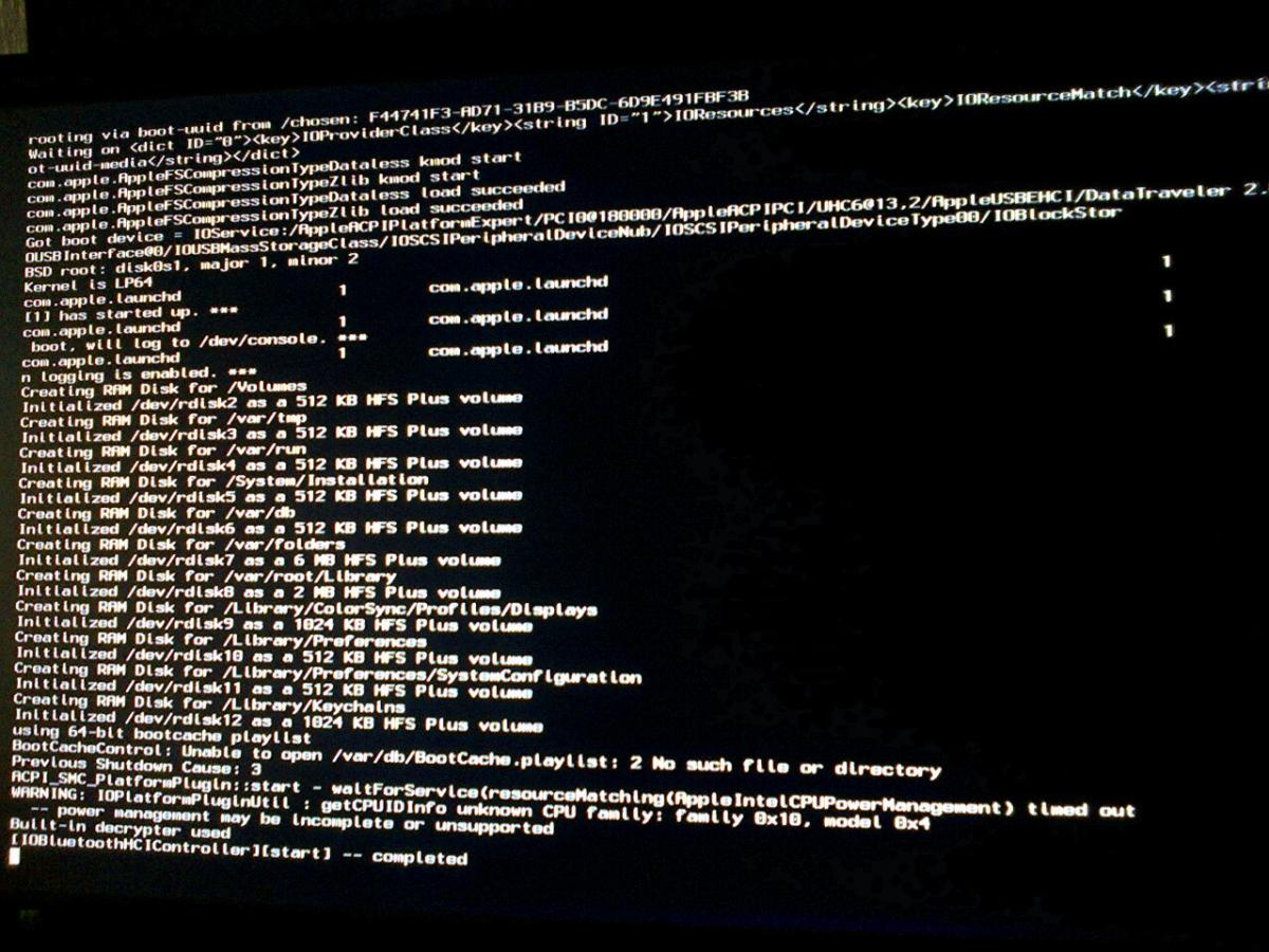

cannon_dt Posted April 16, 2013 Share Posted April 16, 2013 Delete the ati6000.kext, once you do that the installer will load up guaranteed...use the flags that got you to the white screen and add -f I got rid of ati6000 kext and the first set of flags I tried were: amd_kernel npci=0x3000 arch=x86_64 GraphicsEnabler=No USBBusFix=Yes -v -f Look at the attached images, I got to the installer screen But neither my keyboard nor mouse was responsive. It just hung on that screen for 10 minutes. But what is worse is, I cold booted and tried the same set of flags and this time I got stuck at "root device" How can the same flags with the same USB not work the second time? It is really frustrating that I am not even able to replay my successful flags more than once. Badly need help Link to comment https://www.insanelymac.com/forum/topic/285760-help-topic-for-help-in-os-x-yosemite-1010-and-below/page/39/#findComment-1907648 Share on other sites More sharing options...
theconnactic Posted April 16, 2013 Share Posted April 16, 2013 But neither my keyboard nor mouse was responsive. It just hung on that screen for 10 minutes. You need a USB mouse+USB keyboard. Link to comment https://www.insanelymac.com/forum/topic/285760-help-topic-for-help-in-os-x-yosemite-1010-and-below/page/39/#findComment-1907650 Share on other sites More sharing options...

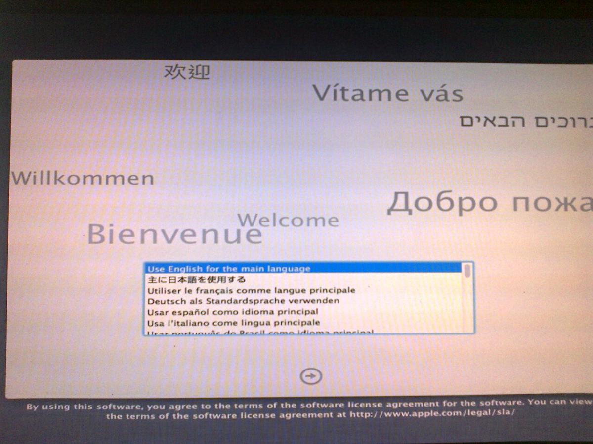

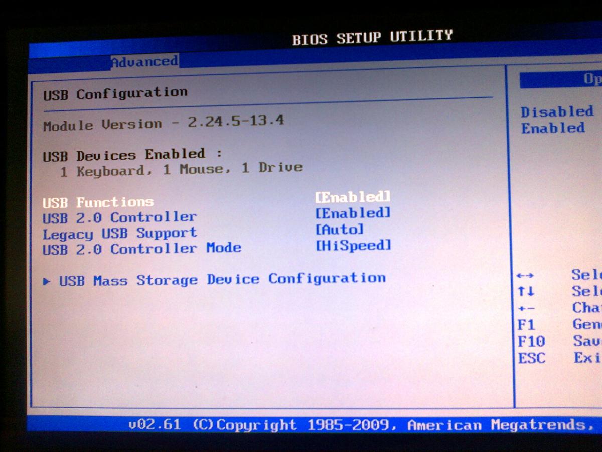

ptp Posted April 16, 2013 Share Posted April 16, 2013 I got rid of ati6000 kext and the first set of flags I tried were: amd_kernel npci=0x3000 arch=x86_64 GraphicsEnabler=No USBBusFix=Yes -v -f Look at the attached images, I got to the installer screen But neither my keyboard nor mouse was responsive. It just hung on that screen for 10 minutes. But what is worse is, I cold booted and tried the same set of flags and this time I got stuck at "root device" How can the same flags with the same USB not work the second time? It is really frustrating that I am not even able to replay my successful flags more than once. Badly need help Try to boot whitout USBBusFix=Yes. Link to comment https://www.insanelymac.com/forum/topic/285760-help-topic-for-help-in-os-x-yosemite-1010-and-below/page/39/#findComment-1907653 Share on other sites More sharing options...
cannon_dt Posted April 16, 2013 Share Posted April 16, 2013 @theconnactic I do have a USB mouse and keyboard that is connected @ptp, @clemj06 Here are more flags that I tried amd_kernel npci=0x3000 arch=x86_64 GraphicsEnabler=No USBBusFix=Yes -v -f -x amd_kernel npci=0x3000 arch=x86_64 GraphicsEnabler=No USBBusFix=Yes -v -x amd_kernel npci=0x3000 arch=x86_64 GraphicsEnabler=No USBBusFix=Yes PCIRootUID=0 -v -f amd_kernel npci=0x3000 arch=x86_64 GraphicsEnabler=No USBBusFix=Yes PCIRootUID=0 -v amd_kernel npci=0x3000 arch=x86_64 GraphicsEnabler=No USBBusFix=Yes PCIRootUID=1 -v -f amd_kernel npci=0x2000 arch=x86_64 GraphicsEnabler=No USBBusFix=Yes -v -x Every time I got stuck at root device. So once again I tried my working combination amd_kernel npci=0x3000 arch=x86_64 GraphicsEnabler=No USBBusFix=Yes -v -f And this time I got this (screenie attached) What really gets to me is the fact that what set works once does not work the very next minute - is it that flaky? I almost feel like it works only once a day @ptp Will try the following and let you know amd_kernel npci=0x3000 arch=x86_64 GraphicsEnabler=No -v -f EDIT @ptp If I dont give USBBusFix=Yes I get stuck at RTC : Only Single RAM Bank (Photo0093) @theconnactic Enabled USB, mouse, drive in BIOS (Photo0092) Link to comment https://www.insanelymac.com/forum/topic/285760-help-topic-for-help-in-os-x-yosemite-1010-and-below/page/39/#findComment-1907657 Share on other sites More sharing options...
ptp Posted April 16, 2013 Share Posted April 16, 2013 pfff... I dont know. Try amd_kernel npci=0x3000 arch=x86_64 GraphicsEnabler=No USBBusFix=Yes UseKernelCache=No -v if that dont work check this: http://blog.yerkania...-mountain-lion/ Edit: or try another mouse , or update your BIOS. Your case is very weird , shouldn't cost so much to get to the installer, you have tried almost all combinations of kernel flags Link to comment https://www.insanelymac.com/forum/topic/285760-help-topic-for-help-in-os-x-yosemite-1010-and-below/page/39/#findComment-1907662 Share on other sites More sharing options...

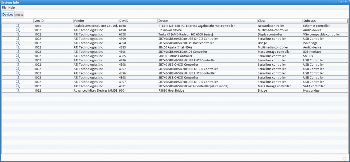

cannon_dt Posted April 16, 2013 Share Posted April 16, 2013 Do you have a link, it seems rather difficult to find 10.7 dmg images... Here is system info and a system dump (from linux command line) abc.txt Link to comment https://www.insanelymac.com/forum/topic/285760-help-topic-for-help-in-os-x-yosemite-1010-and-below/page/39/#findComment-1907751 Share on other sites More sharing options...
