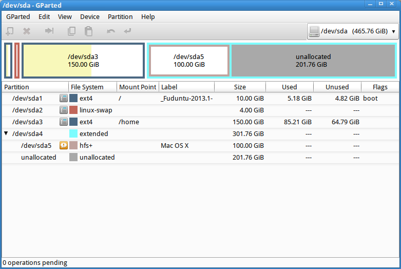

I looked at your HDD setup, you can not add more partition because of MBR limitations.
So, you waste your HDD space.
You can try using a Gparted.
@dkechoi
I have a hfs partition created, so I can put os x into that right.
I definitely want to put it into HDD but your warnings/instructions are not very clear to me. Can you please explain in detail what I should do next?
Like you said I do know that there are no guest additions for mac os guest. So how should I expose the partition/adjust grub etc.
Please let me know the steps and I can do it.

Yes, I know that, but later if you want to use a blank HDD space, you can not get it.
In MBR, you can only 4 primary partitions and you used up all 4.
So, the fourth partition must be extended partition, then you can make any number of logical partion.
So, go to gparted, delete an existing OSX partition ( i assume it's ok to delete), make extended partion with a whole available space,
make an osx partion at the beginning of space. You don't need to format it.
You should have osx partion in sda5.
After finish it, let me know, so we can proceed.
I want to do step by step, so we don't mess up your system.
Risk is not an issue. Worst case is a reinstall, I can manage that with linux any time.
What do you mean by "For ML 10.8, you can do by yourself."?
I think I understand what you are asking me to do but I did not realize I already have 4 primary partitions:
1. Are you saying that sda1, sda2, sda3 and sda4 are all primary partitions, I did not even realize that.
2. What you are asking me to do is delete sda4 first - DONE
3. Create an extended partition with all remaining space - DONE
4. Create sda5 OS X partition - DONE ( I did give the format as hfs+)
One other question I have is - are we going to install Lion or ML? I still have not managed to ML onto VB, should I try that or should I just accept that 10.7.4 is what that will work?
Please see the below screen shot and let me know if all is correct.
Peace
@cannon_dt
Logical partition starts from sda5 in MBR disk.
Now, let's make a file for VB.
In terminal, go to your VM directory, type
VBoxManage internalcommands createrawvmdk -filename sda5.vmdk -rawdisk /dev/sda -partitions 5 -relative
This will make a file which your sda5 partition is available to VB.
Please post the result.
