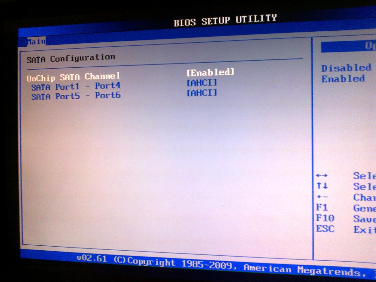

cannon_dt Posted April 15, 2013 Share Posted April 15, 2013 Under SATA configuration I do have it set to AHCI. Image attached Link to comment Share on other sites More sharing options...

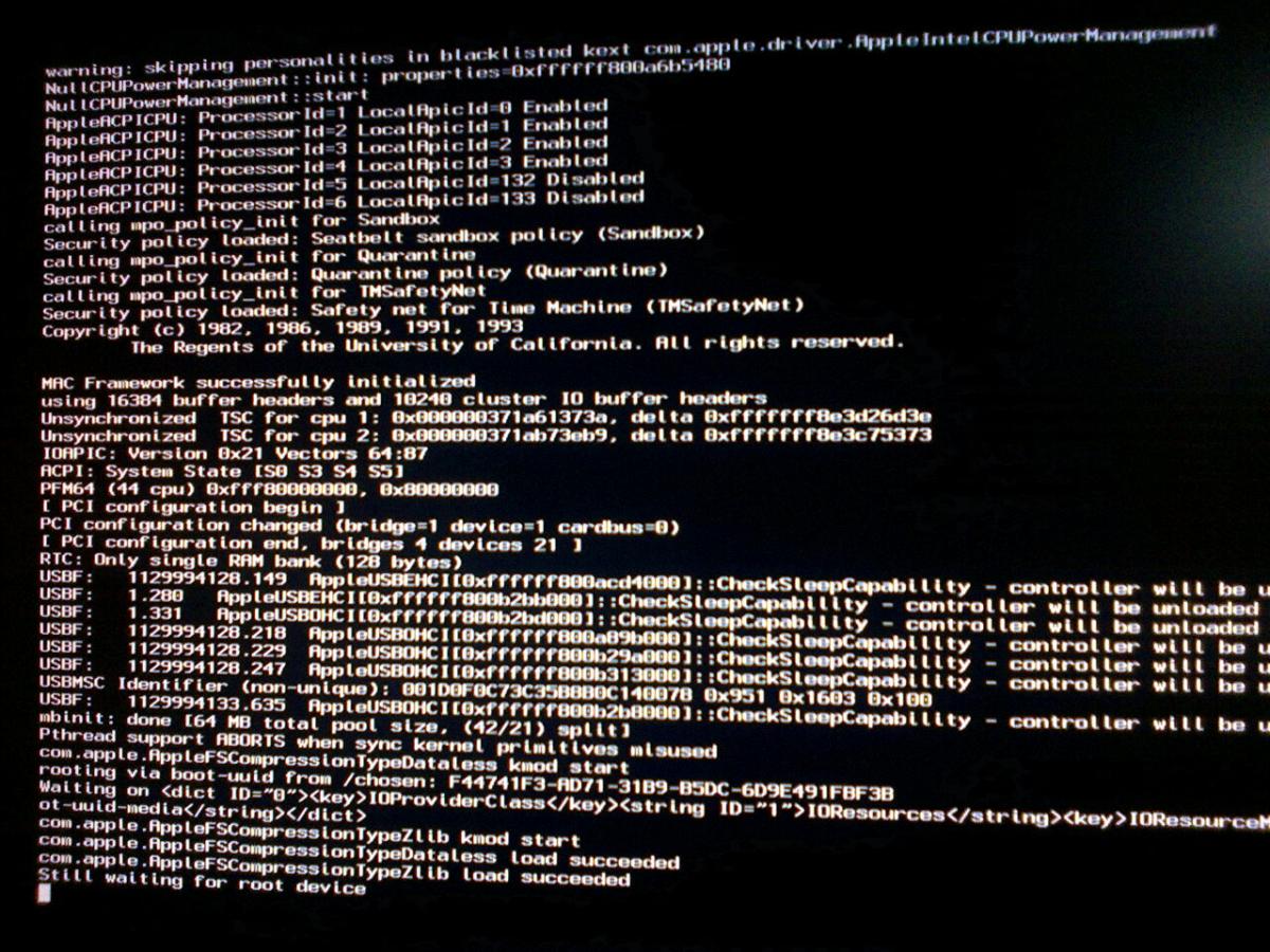

cannon_dt Posted April 15, 2013 Share Posted April 15, 2013 Before deletion Test 1 : amd_kernel arch=x86_64 npci=0x2000 GraphicsEnabler=No USBBusFix=Yes -v -f Test 2 : amd_kernel arch=x86_64 npci=0x2000 GraphicsEnabler=No USBBusFix=Yes -v In both cases I got till "still waiting for root device" Images attached, please let me know if I should proceed to delete fakesmc and try or after seeing the image if you need me to do anything else Also if you want me to proceed with deletion then I got to try both 0x3000 and 0x2000 right? Link to comment Share on other sites More sharing options...

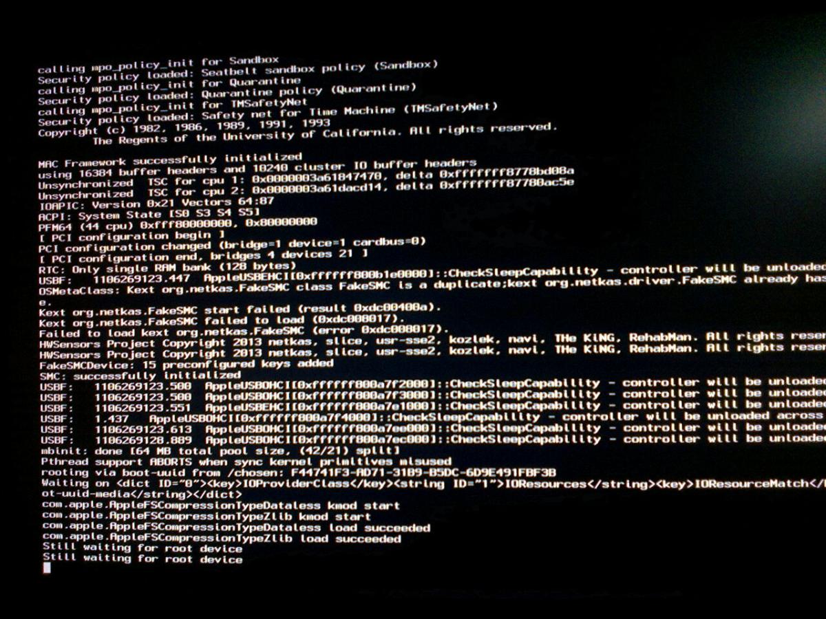

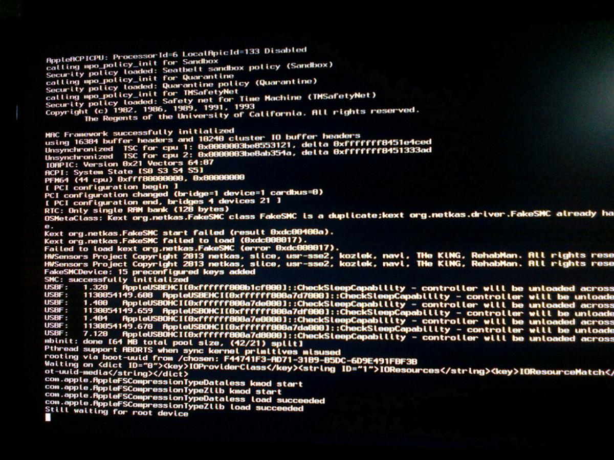

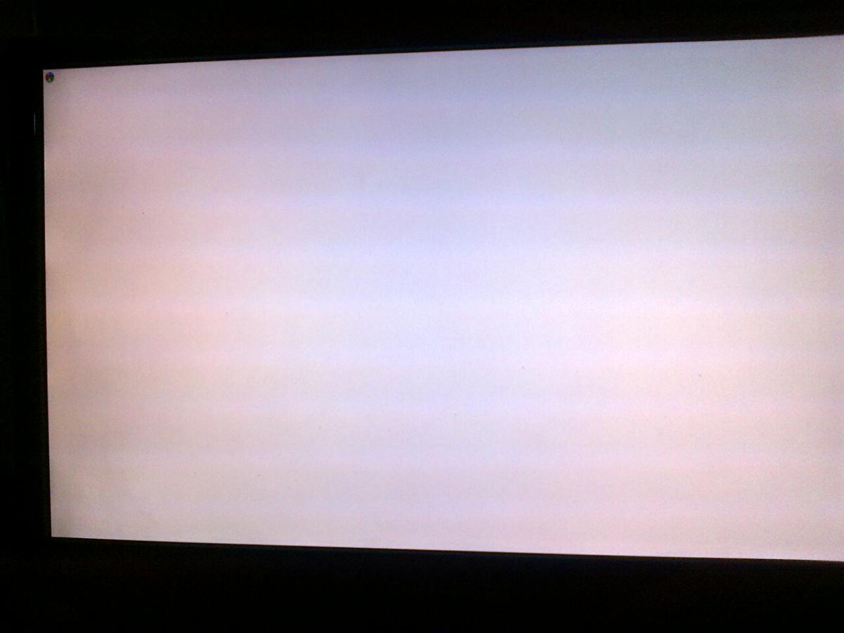

cannon_dt Posted April 15, 2013 Share Posted April 15, 2013 I saw your post just now, I had proceeded with my deletion tests: Strange this are occurring: After deletion I first tried the following: 1. amd_kernel npci=0x2000 arch=x86_64 GraphicsEnabler=No USBBusFix=Yes -v -f 2. amd_kernel npci=0x2000 arch=x86_64 GraphicsEnabler=No USBBusFix=Yes -v In both cases I got the "still waiting for root device" The I went with thebelow: amd_kernel npci=0x3000 arch=x86_64 GraphicsEnabler=No USBBusFix=Yes -v Once again - "still waiting for root device" Then I did amd_kernel npci=0x3000 arch=x86_64 GraphicsEnabler=No USBBusFix=Yes -v -f And this time I got to a white screen but did not proceed (you can see the multi colored wheel at the top left corner) beyond that and my mouse seemed to be stuck (like the last time I got to the installer) So I rebooted and once again tried the above and this time I ended at "still waiting for root device" What is happening clemj06? I am just short of banging my head against the wall EDIT: Tried with PCIRootUID=0 and 1. With this set : amd_kernel npci=0x3000 arch=x86_64 GraphicsEnabler=No USBBusFix=Yes -v -f PCIRootUID=1 I once again got to the white screen which just stared at me for more than 20 minutes. More I dont think the hackintosh is meant to be. Link to comment Share on other sites More sharing options...
clemj06 Posted April 15, 2013 Share Posted April 15, 2013 You did say you deleted the ati6000.kext right? The mouse thing was a good sign, the white screen is usually because of the ati6000.kext Try: amd_kernel npci=0x3000 arch=x86_64 GraphicsEnabler=No USBBusFix=Yes -v -f amd_kernel npci=0x3000 arch=x86_64 GraphicsEnabler=No USBBusFix=Yes -v amd_kernel npci=0x2000 arch=x86_64 GraphicsEnabler=No USBBusFix=Yes -v -f amd_kernel npci=0x2000 arch=x86_64 GraphicsEnabler=No USBBusFix=Yes -v amd_kernel npci=0x3000 arch=x86_64 GraphicsEnabler=No USBBusFix=Yes PCIRootUID=0 -v amd_kernel npci=0x3000 arch=x86_64 GraphicsEnabler=No USBBusFix=Yes PCIRootUID=1 -v amd_kernel npci=0x2000 arch=x86_64 GraphicsEnabler=No USBBusFix=Yes PCIRootUID=0 -v amd_kernel npci=0x2000 arch=x86_64 GraphicsEnabler=No USBBusFix=Yes PCIRootUID=1 -v 1 Link to comment Share on other sites More sharing options...
theconnactic Posted April 15, 2013 Share Posted April 15, 2013 Tried with PCIRootUID=0 and 1. With this set : amd_kernel npci=0x3000 arch=x86_64 GraphicsEnabler=No USBBusFix=Yes -v -f PCIRootUID=1 I once again got to the white screen which just stared at me for more than 20 minutes. You're almost there. Use also GraphicsEnabler=No, or GraphicsEnabler=No -x: -x means safe boot. Good luck! Link to comment Share on other sites More sharing options...
