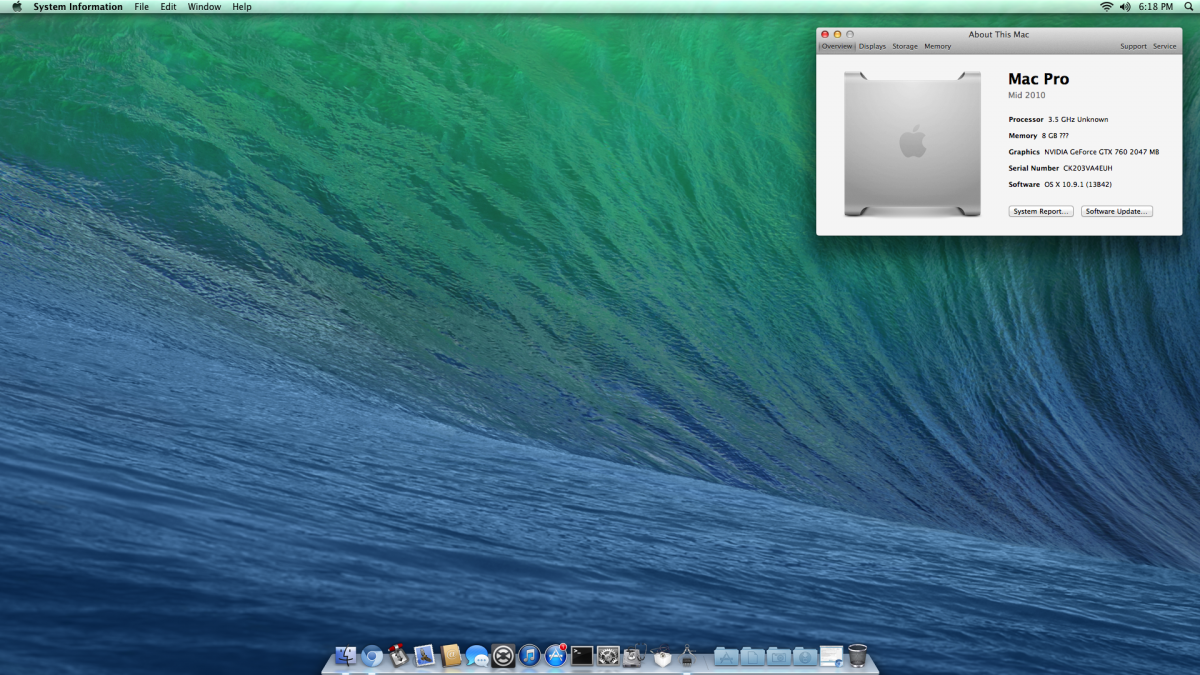

lightskreen Posted March 27, 2014 Share Posted March 27, 2014 My build went surprisingly smoothly. The only things that don't work are little and can't be bothered with.CPU: AMD FX-6300 3.5 GHz working without NCPUPM.kext. Shows up as "3.5 GHz unknown" in about this mac. Help with that is always appreciated.RAM: 8 GB DDR3 @ 1600 mhz dual-channel. In about this mac it shows up as "8 GB ???". Any help would be appreciated. GPU: MSI GTX 760. Shows up as an NVIDIA Geforce GTX 760 and runs smoothly out of the box. The web drivers for 10.9.1 SEEM to make it feel faster.HDD's: Installed onto a 64 GB Sandisk SSD alongside windows 8.1 purely gpt/uefi as well as a 1 TB WD Blue for data. I would like to know how to set it so that OS X always is the default boot option for clover, even if I boot into windows. If I boot into windows in fast mode, it never lets me select OS X again and I would like to have it just default to OS X and have access to windows whenever I need it.Motherboard: Asrock 990fx extreme3. all usb 2.0 work perfectly as well as 3.0 with a PXHCD.kext installed. Ethernet works perfectly after installing a modified IONetworkingFamily.kext.Wifi: Atheros AR938x chipset. Great signal and works out of box.Bootloader: Clover revision 2652. Installer boots with "npci=0x2000 -x", The working install boots with "npci=0x2000" only which I have set in the config.plist.Kernel: My kernel is the one from this link. http://www.osx86.net/files/file/3736-amd-10910911092-kernel-update-iii-with-full-sse4-support/If there's a better one, suggest it to me, but this is the best I could find for my build.OS: All of this was completed on Mavericks 10.9.1 and some of the beginning stages were done on 10.9.0. I used Windows 8.1 Professional because some games just can't run on Mac OS. Link to comment https://www.insanelymac.com/forum/topic/285110-amd-working-builds/page/7/#findComment-2007997 Share on other sites More sharing options...

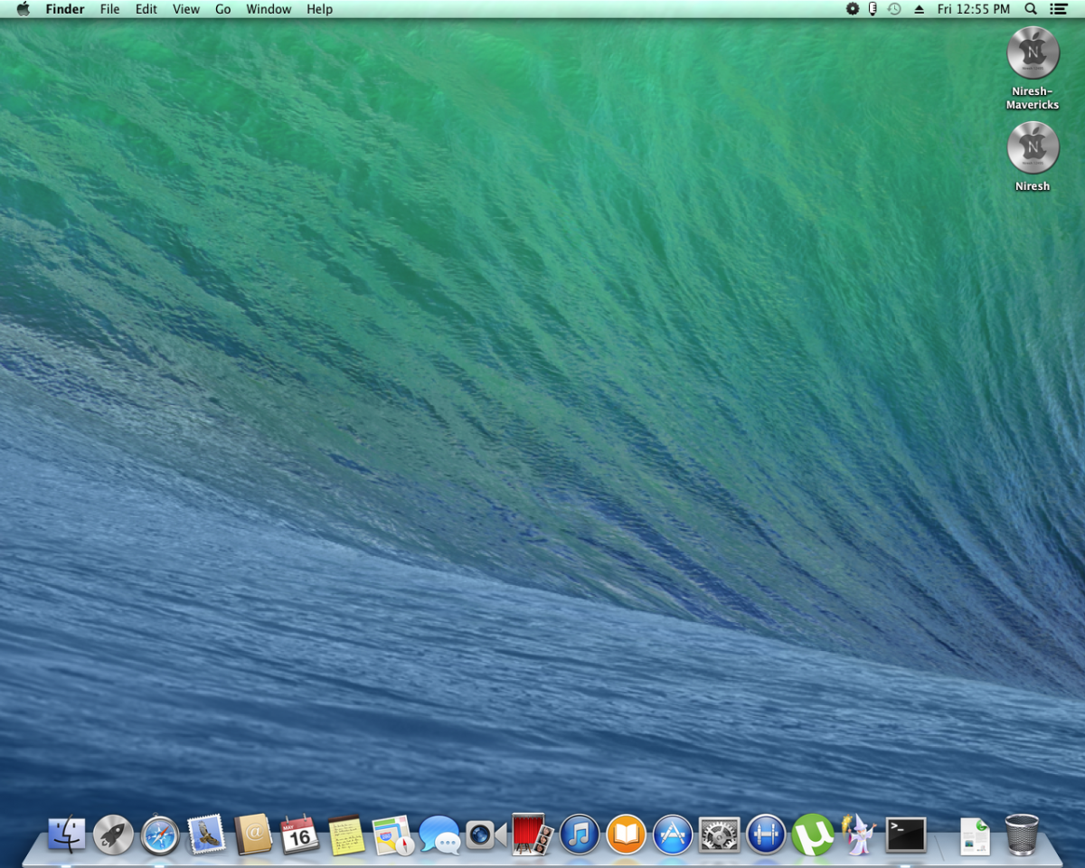

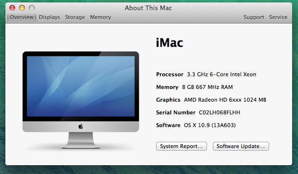

mikazo Posted April 19, 2014 Share Posted April 19, 2014 motherboard: ASUS M5A78L-M processor: PHENOM 965 graphics: HD 6000 series osx: mavericks 10.9.0 distro: niresh boot flags: amd64 arch=x86_64 npci=0x3000 -v spent a while trying to make an official copy of 10.9.2 work with myhack - tried a variety of boot flags then a variety of kernels - i think the new 10.9.2 AMD kernel is not ready yet 1 Link to comment https://www.insanelymac.com/forum/topic/285110-amd-working-builds/page/7/#findComment-2013786 Share on other sites More sharing options...

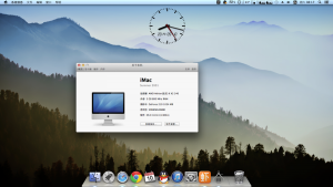

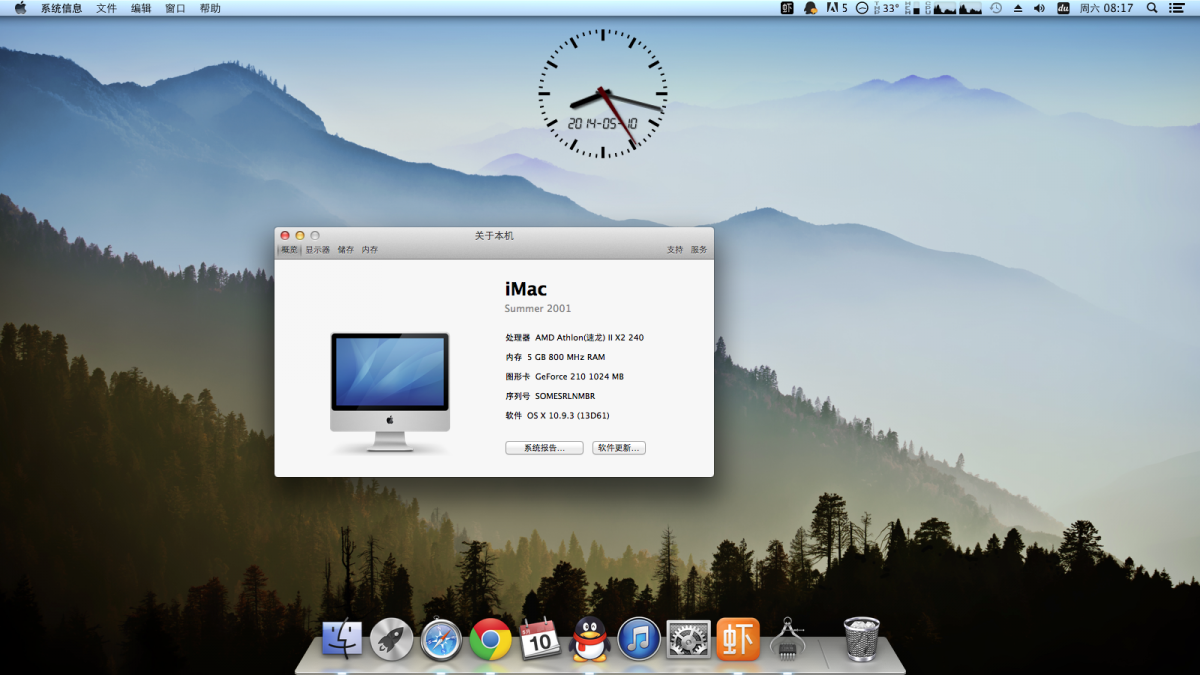

tip1988 Posted May 10, 2014 Share Posted May 10, 2014 CPU AMD Athlon(速龙) II X2 240 双核 BIOS 技嘉 GA-MA785GM-US2H(DSDT sleep)RAM 5120 MB ( 金士顿 DDR2 800MHz )SATA 西数 WDC WD5000AAKS-00N7B0 ( 500 GB / 7200 转/分 )GPU Nvidia GeForce 210 ( 128 MB )声卡 瑞昱 ALC885 @ ATI IXP SB600/SB700/SB800 高保真音频(万能) 网卡 瑞昱 RTL8168C(P)/8111C(P) PCI-E Gigabit Ethernet NIC / 技嘉 10.9.3 13D61 new up!!! 2 Link to comment https://www.insanelymac.com/forum/topic/285110-amd-working-builds/page/7/#findComment-2018352 Share on other sites More sharing options...

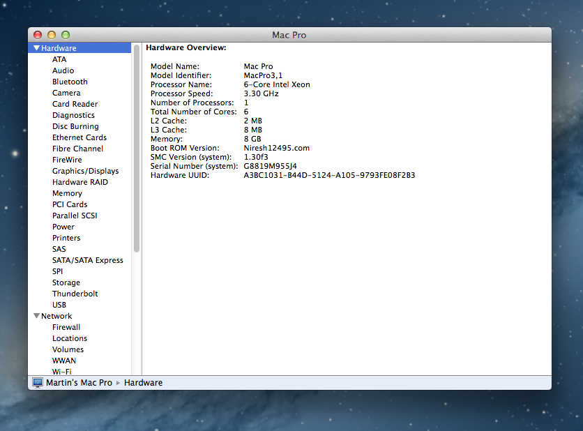

martodim Posted May 16, 2014 Share Posted May 16, 2014 CPU: AMD FX-6100 3.3 GHz Six-CoreMotherboard: ASUS M5A88-MRAM: 4+4 GB DDR3 Corsair Vengeance 1600MHzSATA: 1TB WD Caviar Green+ 250GB Seagate Barracuda USB:4 Rear USB 2.0 Working + 2 Rear USB 3.0 WorkingGPU: AMD Radeon HD 6450 1GB DDR3 (Also a not tested integrated AMD Radeon HD 4250 which will be tested also later) + nVidia 9800GT 512MB DDR3LAN: Working like a charm. Audio: Working just fine. I used All in one Audio Solution 1.0. http://www.niresh12495.com/files/file/136-all-in-one-audio-solution/PS2: Not testedSleep: Can't wake up yet Used Niresh distro for Mavericks 10.9.0--> Installed with amdfx -v boot flags on 250GB HDD, used Disabler instead of NullCPU in Customize Options in installation, Set GraphicsEnabler=no, not installed audio and ethernet drivers. Used default bootloader. Im not getting stuck on the first time setup. Information will be updated when fully tested. Everything seems to work fine on first sight. I will also try to get 10.9.3 I am seeking for some help. Got a nVidia GeForce 9800GT 512MB DDR3. I replaced the 6450 Radeon with the nVidia but it won't boot. After loading [iOBluetoothHCIController][start] -- completed screen just goes black.. I can get only to boot the PC when I moved all nVidia, ATI, Intel Graphics Kexts to Backup folder. But now I get only 1024x768 no QE/CI. Ideas how to fix this? FIX!!! When installing Niresh 10.9.0 Distro DO NOT CHOOSE any different SMBios than the default selected in the installer. Install like that and first boot should be with -f flag. Then just add -f in the boot.plist file. nVidia 9800GT 512MB DDR3 works like a charm with QE/CI. ALWAYS USE DVI PORT ON GRAPHICS CARD OR IT WON'T WORK (I am using DVI to VGA adapter-DVI is plugged in the graphics card port). Further testing will be made today by playing League Of Legends game to see how the graphics card performs. POST WILL BE UPDATED LATER. Screenshots from the nVidia 9800GT configuration down below. Tests were finished. The nVidia performs really well on high-quality games (though chess still lags ). 1 Link to comment https://www.insanelymac.com/forum/topic/285110-amd-working-builds/page/7/#findComment-2020032 Share on other sites More sharing options...

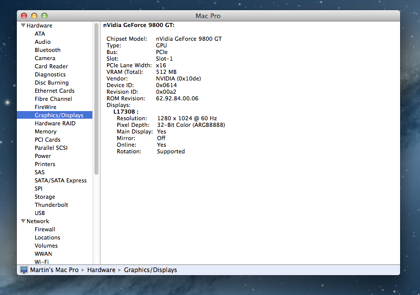

martodim Posted May 28, 2014 Share Posted May 28, 2014 Hi, I'm struggling with my own installation with a GeForce 9800GT. I had it working natively under SL 10.6.8 after a DSDT patch (nVidia 9800GT injection + PCI0 root set to 0). In Lion 10.7.5, ML 10.8.5 and Mav 10.9.0 I had to use NVEnabler64 to get the card to work (with some very minor graphics glitches in Mav). No such luck since 10.9.2 and 10.9.3: I'm either just getting black screen when NVEnabler64 is not used and just getting the white/light gray screen with moving mouse pointer when NVEnabler64 is used. I only reach desktop by booting in safe mode. :-( Could you indicate: . which SMBIOS profile/plist you used? . which FakeSMC version you have? . which SMC version you use? Ideally, if you could post the SMBIOS.plist + FakeSMC.kext and SystemProfiler's saved output, that'd be great! What I have used is the default setting which the Niresh Distro uses. The SMBios I believe was MacPro 3.1 or something like that. Everything used is selected by default. What version of 9800GT are you using? Also are you using the DVI port? Tomorrow I will test update to 10.9.3 and I will answer you. Feel free to PM me at any time. Link to comment https://www.insanelymac.com/forum/topic/285110-amd-working-builds/page/7/#findComment-2022888 Share on other sites More sharing options...
martodim Posted May 30, 2014 Share Posted May 30, 2014 Hi, I'm struggling with my own installation with a GeForce 9800GT. I had it working natively under SL 10.6.8 after a DSDT patch (nVidia 9800GT injection + PCI0 root set to 0). In Lion 10.7.5, ML 10.8.5 and Mav 10.9.0 I had to use NVEnabler64 to get the card to work (with some very minor graphics glitches in Mav). No such luck since 10.9.2 and 10.9.3: I'm either just getting black screen when NVEnabler64 is not used and just getting the white/light gray screen with moving mouse pointer when NVEnabler64 is used. I only reach desktop by booting in safe mode. :-( Could you indicate: . which SMBIOS profile/plist you used? . which FakeSMC version you have? . which SMC version you use? Ideally, if you could post the SMBIOS.plist + FakeSMC.kext and SystemProfiler's saved output, that'd be great! Hi, Here you are what you requested. Later I will update to 10.9.3. Sorry for writing here. It just seems I'm dumb enough not to be able to attach files on PM. LSPCI .rtf SMBios.txt bootplist.txt Link to comment https://www.insanelymac.com/forum/topic/285110-amd-working-builds/page/7/#findComment-2023322 Share on other sites More sharing options...

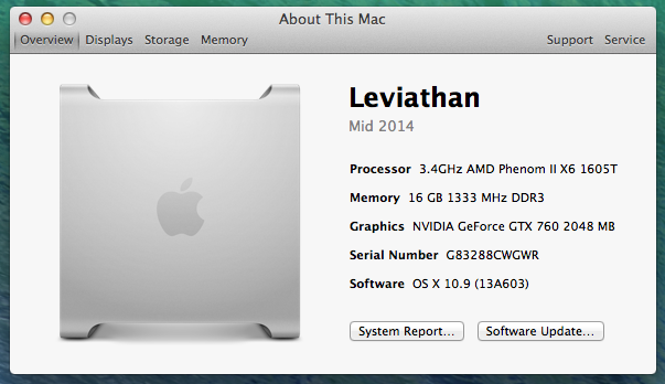

Andycore Posted August 16, 2014 Share Posted August 16, 2014 Motherboard: AsRock 990FX Fatal1ty Professional Chipset: NB: 990 SB: 950 CPU: AMD Phenom II 960T X4 Black Edition (Unlocked to X6 1605T) GPU: Gigabyte GeForce GTX 760OC 2GB (Worked out of the box with stock nVidia kexts and GraphicsEnabler=No. Full QE/CI, driving three monitors at 1680x1050) RAM: Kingston DDR3-1333 16GB (4 x 4GB) Network: Broadcom BCM55781 (Found here but only functions on 10.9.0, device detected but doesn't work on 10.9.3 or 10.9.4) Audio: Realtek ALC892 - Works with a very specific VoodooHDA without crackling/hissing (I have about 5 I've tried and honestly don't remember which one it was to link it, but can supply it if needed -- currently working on getting analog 5.1 working) OS X: Mavericks 10.9.0 (Capable of 10.9.4 but lose ethernet, so holding off until newer kexts / I jump ship to Intel) Kernel: "Niresh" default amd64 (Also Tested: "mckay_kernel" and kexts, worked perfectly with myHack) Boot flags: npci=0x2000 dmar=0 GraphicsEnabler=No Bootloader: Chameleon 2.2.1 Link to comment https://www.insanelymac.com/forum/topic/285110-amd-working-builds/page/7/#findComment-2052391 Share on other sites More sharing options...
