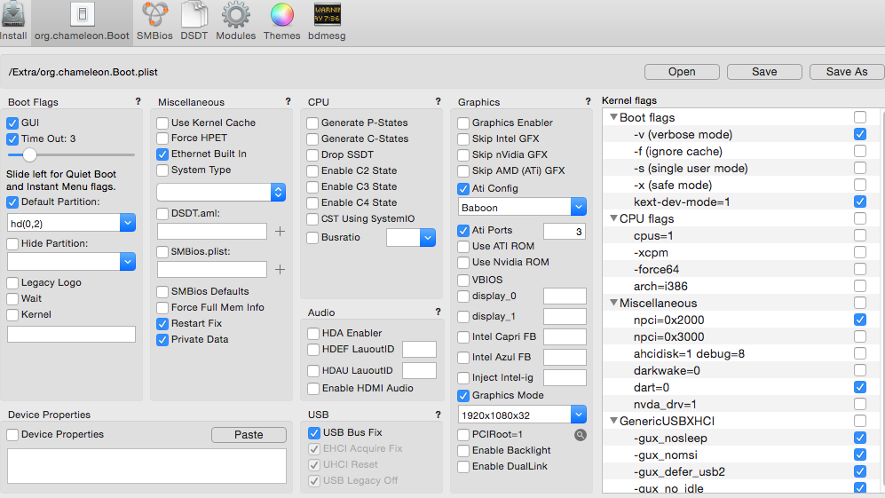

    Bootloader : Chameleon 2.3 2468
10.10 flags:
<dict>
    <key>GraphicsEnabler</key>
    <string>Yes</string>
    <key>Kernel</key>
    <string>/System/Library/Kernels/kernel</string>
    <key>Kernel Flags</key>
    <string>-v kext-dev-mode=1 npci=0x2000</string>
    <key>USBLegacyOff</key>
</dict>

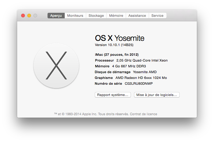

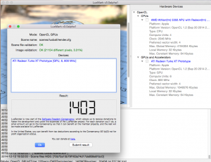

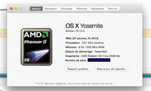

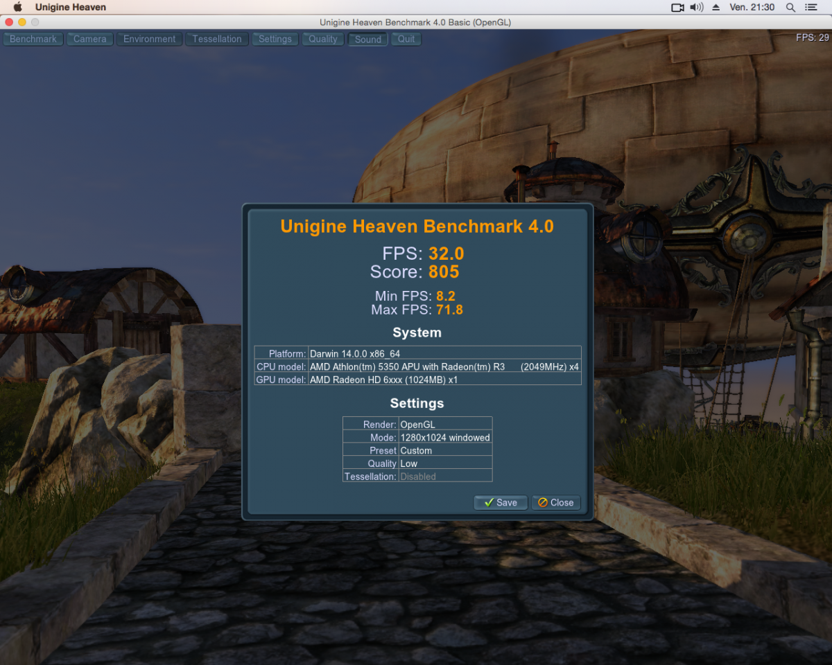

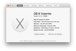

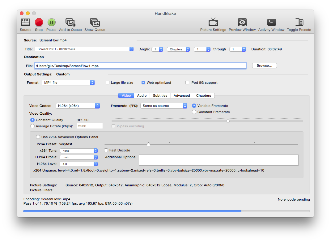

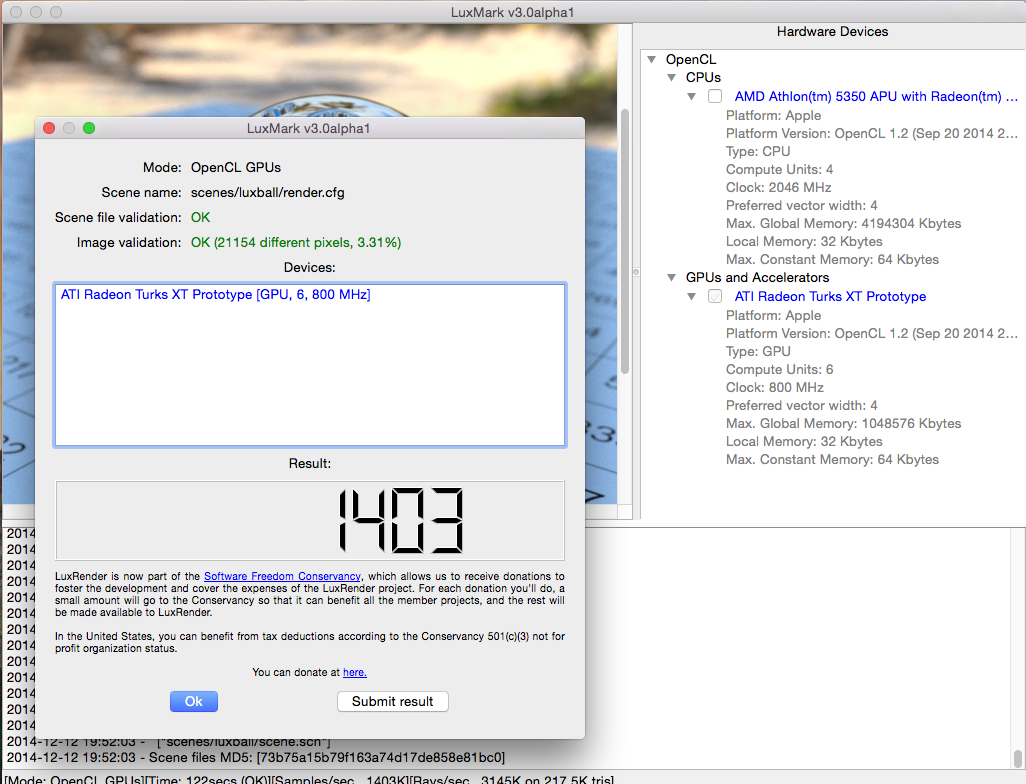

My build
-MSI AM1I (AM1 PCIE x4)
-APU Athlon 5350 with R3 (R3 no works CI/QE)
-Kingston DDR3 4 G0 1600 (667)
-HD 6670 1024 low profile
-SSD SanDisk 128 GO
-Lan RTL 8111
-Audio ?  (voodooHDA 2.8.4)
-kext :
FakeSMC (V 2009)
IOPCIFamily  M 10.9 13A603
AppleACPIPlatform M 10.9 13A603
IOUSBFamily M 10.9 13A603
IOUSBMassStorageClass M 10.9 13A603
RealtekRTL8111
VoodooHDA 2.8.4
No use NullCPUPowerManagement ;)
No use DSDT
No use SSDT
use chameleon 2437
use kernel bronya rc2 v1 opemu bronya  (14.0.0 Darwin Kernel Version 14.0.0: пятница, 14 ноября 2014 г. 00:59:36 (MSK); root:xnu-2782.1.97/BUILD/obj/RELEASE_X86_64 x86_64)
Sleep no works

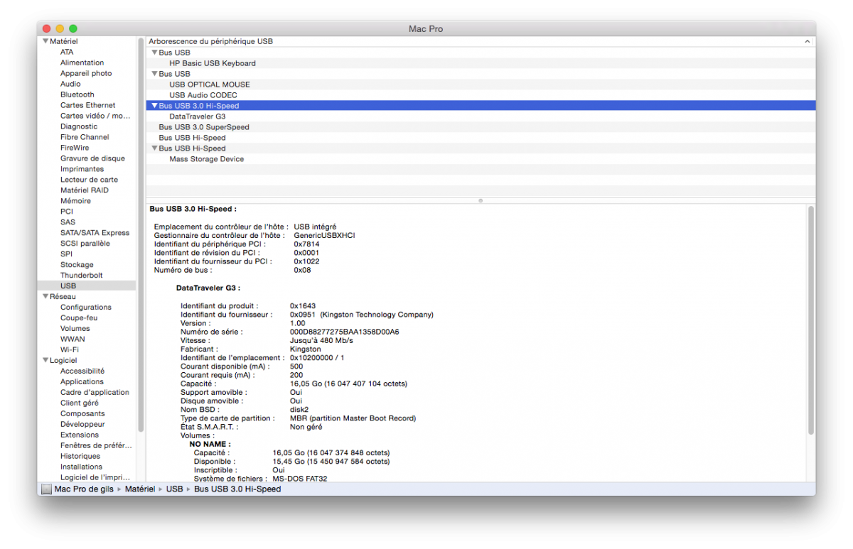

USB3 no works works !!   :thumbsup_anim:
Software : All works sauf iCoud . (inutile)

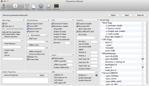

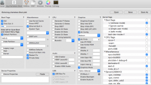

<plist version="1.0">
<dict>
        <key>EthernetBuiltIn</key>
        <key>AtiConfig</key>
	<string>Lotus</string>
	<key>AtiPorts</key>
	<string>2</string>
	<string>npci=0x2000 dart=0 -f</string>
</dict>
</plist>

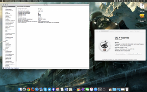

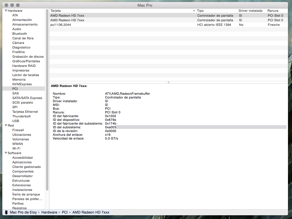

My fully working Hackintosh:
What's working:
Sapphire Radeon HD7850 OC 2GB with full QE/CI, no glitches at all
Realtek 8111C ethernet
ALC888 with VooDooHDA
restart, shutdown and sleep
all USB Ports
IDE DVD Drive with AppleATIATA.kext (reading and writing as well)

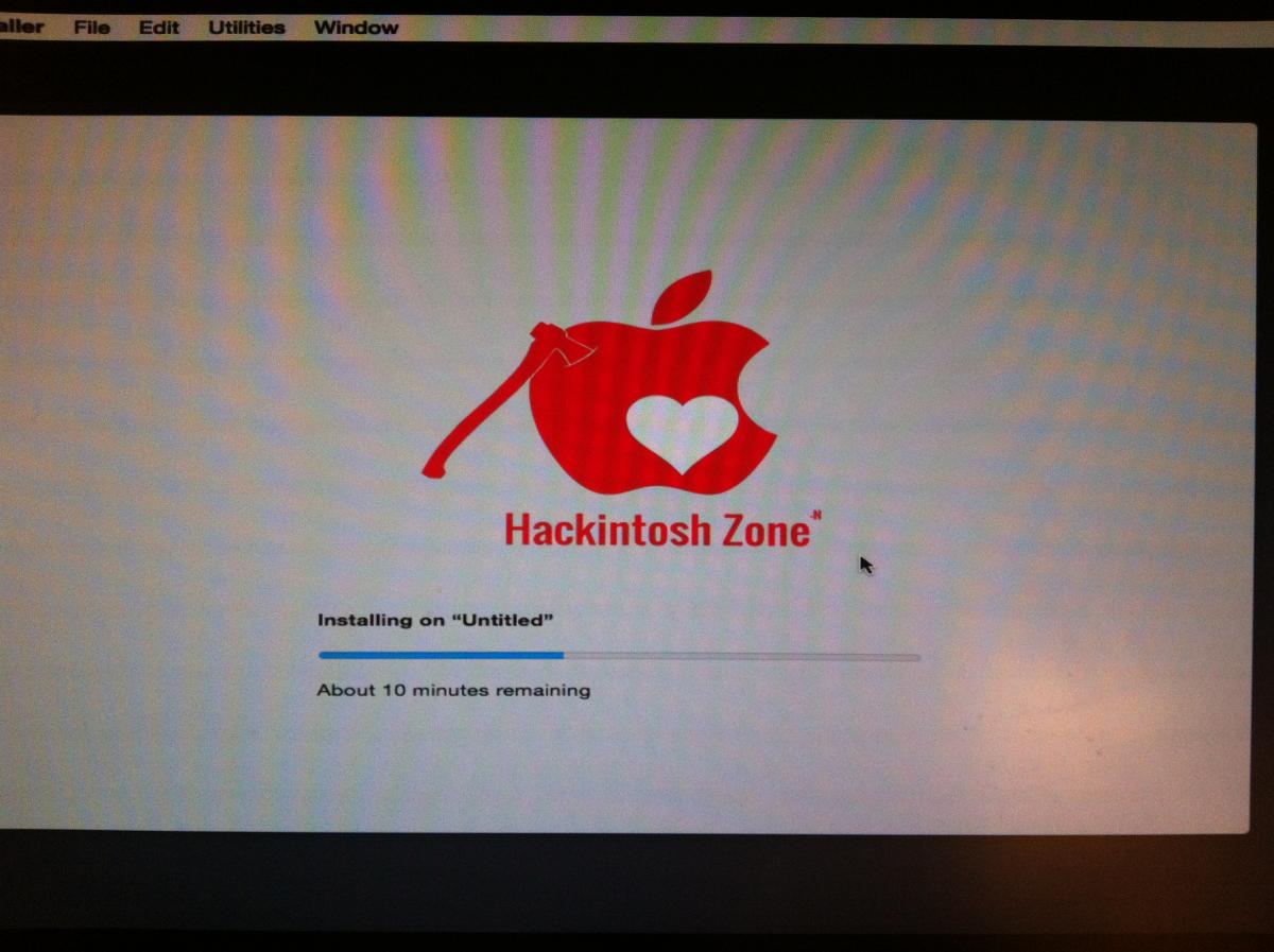

Install Software
Snow Leopard Retail DVD
I tried Chameleon and Chimera and a lot of Boot-Flags
Booting works with Nawcom-CD
SATA is not working
Resolution 1024x768 at VGA
Resolution 1024x768 with a black frame at DVI
Resolution 1024x768 at VGA at the Mainboard without graphic card
Update
I changed the mainboard used SSD
ECS EliteGroup Geforce 6100 SM-M2
Its working perfect!
Software:
Nawcom-USB-Snow Leopard
10.6.8 Comboupdate
Nawcom legacy_kernel-10.6.8.v2.pkg
nForceLAN_0.64.6  insanelymac.com/forum/topic/125569-nforce-lan-driver
Natit
VoodooHDA 0.2.1
My 2. passive cooled build
- Asrock N68-S3 UCC
- AMD Athlon II X4 605e, 4x 2.30GHz
- 2x2GB Ram
- USB Mouse Fujitsu / Keyboard MS wired 200
- Graphics 8400GS
- Intel SSD 320 Series 40GB
- Tranced USB3 card TS-PDU3
- Monitor on DVI-Port
Disconnected every USB-Cable and the Lan-cable
Bios:
First: Load Bios Default
Disabled Cool and quiet
Primary Graphics Adapter: PCIe
Disabled IDE
Disabled Floppy
Disabled I/O
Boot with: NawcomModCD
Snow-Leopard-Retail-DVD
I installed a Dual-Boot System with Win7 on first partition
DVD don’t works
Booting works oob
Graphics works oob 1920x1080
Sound works oob
Lan: nforce lan RTL82xx from matze (thanks)
http://hackintosh-forum.de/index.php?page=Thread&threadID=5729
So, LAN works
USB 3.0 NEC/Renesas KEXT installed
So USB2/USB3 works
PS2 Kext installed.
Customized as MacMini

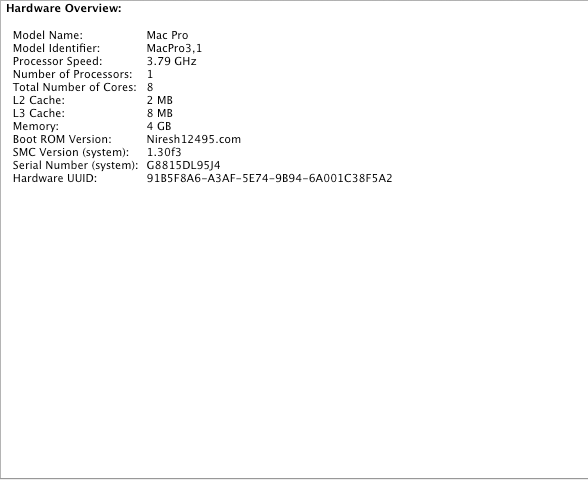

-MSI MS 7369 (K9Nneov3) bios beta 30R /Phenom II x2 555 / 2x2 GO DDR2 / Yosemite but bug
chipset NV 560 ootb / sata 2 ok / ahci ok / PCIE ok
audio ok
lan ok
open/halt/restart  ok
sleep ?
-MSI MS 7255 MSI P4M890M-L) /Pentium D 915 / 2x1 GO DDR2 / Yosemite but bug
chipset VIA ok / sata 1 ok / PCIE ok
audio ?
lan ?
sleep ?
Thank Bronya and Andy   :thumbsup_anim:

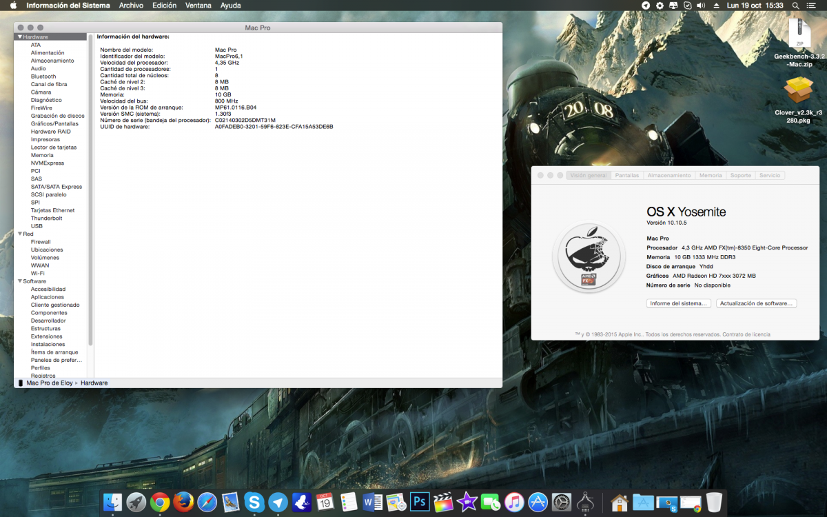

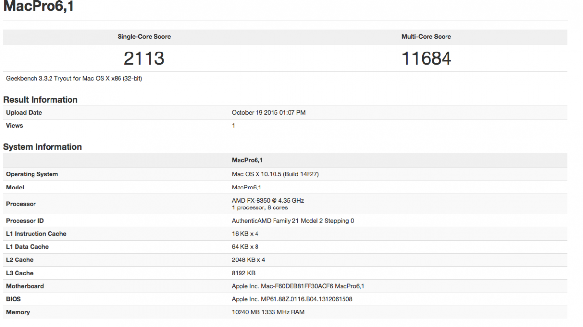

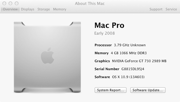

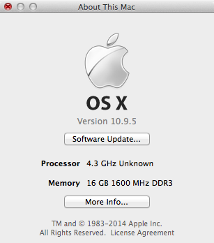

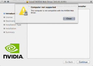

CPU: AMD FX-8350 4.0Ghz ( OC @ 4.6GHz)
Motherboard: ASUS Crosshair V Formula-Z (ASUS BIOS rev. 2011)
Chipset: 990FX
  • Southbridge: SB950
  • Network: Intel® 82583V Gigabit Network Adapter
  • SATA: ASMedia® ASM1061 (two ports, unused)
  • USB3: ASMedia® USB 3.0 controller
Memory: 16GB Crucial Ballistix Tactical high profile
Version: OS X 10.9 Mavericks - Niresh distribution Updated to 10.9.5
Graphics: ASUS GTX 560 1GB GTX 970 4GB [2D Only] nv_disable=1 GraphicsEnabler=No
System Drive: Samsung 840 series 120GB an old 80GB Seagate HDD from 2004 until I figure this OS out.
Audio:
  • Creative SoundBlaster SB-Z (PCI-Express) Doesn't work.
  • SupremeFX IIITM (Realtek) Working!  :thumbsup_anim:
  • Nvidia HDMI Audio chipset: I have no idea. I am using DVI and I can't find my HDMI cable.
Mouse: Logitech G400S, seems to be working all right
Keyboard:​ Logitech G710+
  • ​Volume control: Works!
  • Mute: Works!
  • Previous song: Works!
  • Next song: Works!
  • Pause: Works!
  • Stop: Does not work in iTunes
  • G keys and M profiles: Probably requires software
Xbox 360 game controller
  • OS X Installer: Ring of Light flashes
  • Installed system: RoL Lights up once then turns off after a second

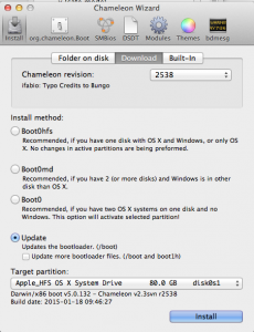

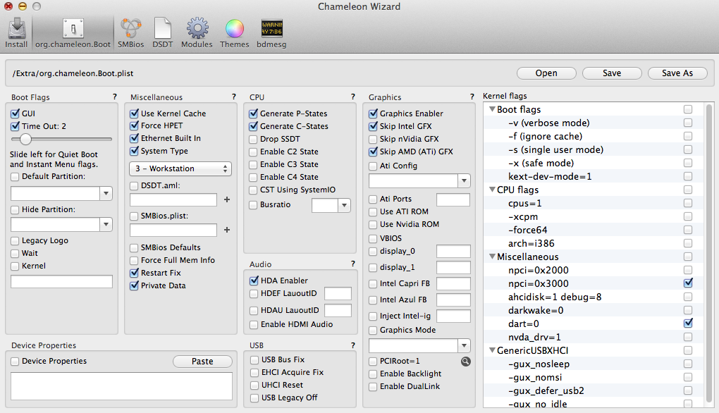

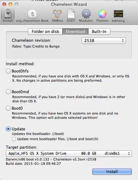

​Bootloader: Chameleon 2538
post-1211974-0-46627800-1423602621_thumb.pngpost-1211974-0-87018000-1423602516_thumb.png
Problems:

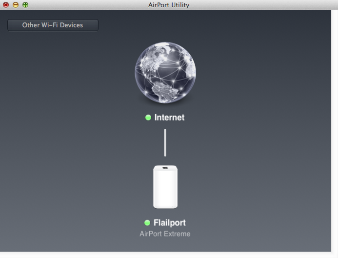

Network:
  • Intel® 82583V Gigabit Network Adapter drops connectivity with Airport Extreme under load* but appears "connected".
    Unusable until reboot. Logging the account out and back in has no effect.
    *: My educated guess is that it breaks if the number of HTTP connections gets too high.
    This makes online gaming and downloading Xcode/Updates impossible.
    Disabling UEFI Network Stack in the bios does not seem to help
    Update 2/11/2015: Setting "Ethernet Built In" in Chameleon seems to fix it. I have successfully downloaded Xcode.
    Working state:
Video:
  • Nvidia Maxwell works in the installer. Causes kernel panic when trying to boot the installed system. (help?)
    Will however boot and still have usable 2D performance using nv_disable=1.
  • Nvidia Kepler causes Kernel Panic at the "gray screen" (after the loading spinner) Update 2/10/2015: Needs to be tested with the new install
Bottom line:
The setup "Works".
Todo: Test for network stability during online games/else. This requires working 3D.
I could always copy Xcode and Sublime Text with a USB key or my other drives but that's going to be annoying.
Yosemite 10.10 on same hardware: Not working yet.
Early notes: I appear to have messed up my KEXT selection. USB 3.0 is not a good idea for keyboard and mouse.
Status: Fixing blank screen nv_disable=1 required for initial setup with both GTX560 and GTX970
installing patched nvidia driver
attempting boot with nvda_drv=1
Contemplating grey screen
Scary white on black text mentioning Nvidia Fault
Empty screen with a white cursor
Attempting nvda_drv=1 GraphicsEnabler=Yes
Attempting boot with no extra flags
Booting with nv_disable=1 and attempting another driver
==== Reinstallation ====
Booting installer with /amd npci=0x2000
After several hours, I managed to sucessfully boot with the Nvidia web driver. it however crashed within minutes with "Apple.webkit caught using excessive wakeups".
Updating to 10.0.2 killed the cat. Giving up on Yosemite for now.

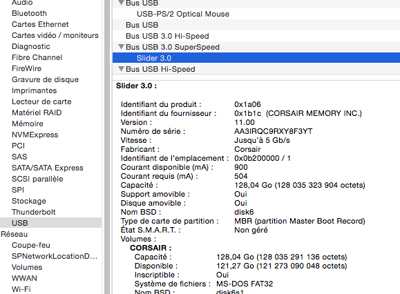

AMD FX6300
MSI 970a-g43
Shappire ATI HD5670 1gb ddr3
Frescologic PCIE USB3 card
TPLINK TG3468 (RTL-8168) Pcie gigabit (internal lan broken)
Sound : External BCD3000 (internal not tested)
Install Method : Yosemitezone 10.10.1
Bios settings :
Turn off UEFI boot only so it can accept legacy bios / mbr boot
- Windows 8 Function off
- MSI Fastboot & Fastboot off
- Save & Boot
Installation Steps:
1. Make bootable USB Yosemitezone 10.10.1 in mac
2. Boot > Press f11 > Select USB Drive
3. Boot flag : /amd64 -v npci=0x2000 GraphicsEnabler=No
4. Format mac drive with GPT
5. Install with Chameleon boot loader
6. Finish install
7. Boot to new mac install with -x (safemode), it won't boot normally as it would stuck in grey screen + beachball
8. Go through initial setup, no network right now, realtek chip not detected.
9. Boot again in safemode to install FIX and Kext
FIX:
you will need to connect your mac with another method, as the lan not detected yet, i use usb disk with HFS formatted to download everything i need from another computer.
10. For the grey screen + beachball fix follow this guide :
http://www.insanelymac.com/forum/topic/304513-fixguide-amd-stuck-at-greywhite-screen-with-spinning-beachball/
11. Realtek Lan : http://www.insanelymac.com/forum/topic/287161-new-driver-for-realtek-rtl8111/ and then use kext-dev-mode=1 or it would not work. Also use npci=0x2000 not 3000, more stable with network adapters.
12. HD5670 resolution fix : open chameleon wizard add GraphicsEnabler=No, Ati Config = Baboon, Ati Ports 3 and Graphic Mode 1920x1080x32 (Full QE/CI, Dual monitor OK)
Working out of box :
- USB3 (internal & external card) 1 port only , mouse, keyboard, external sound
- Shutdown, restart
- Appstore (minor fix)
Not working:
- Sleep
- Icloud & Imessage (need serial number)
On clover everything works except only in safe mode, when i boot normally got hanging beachball.

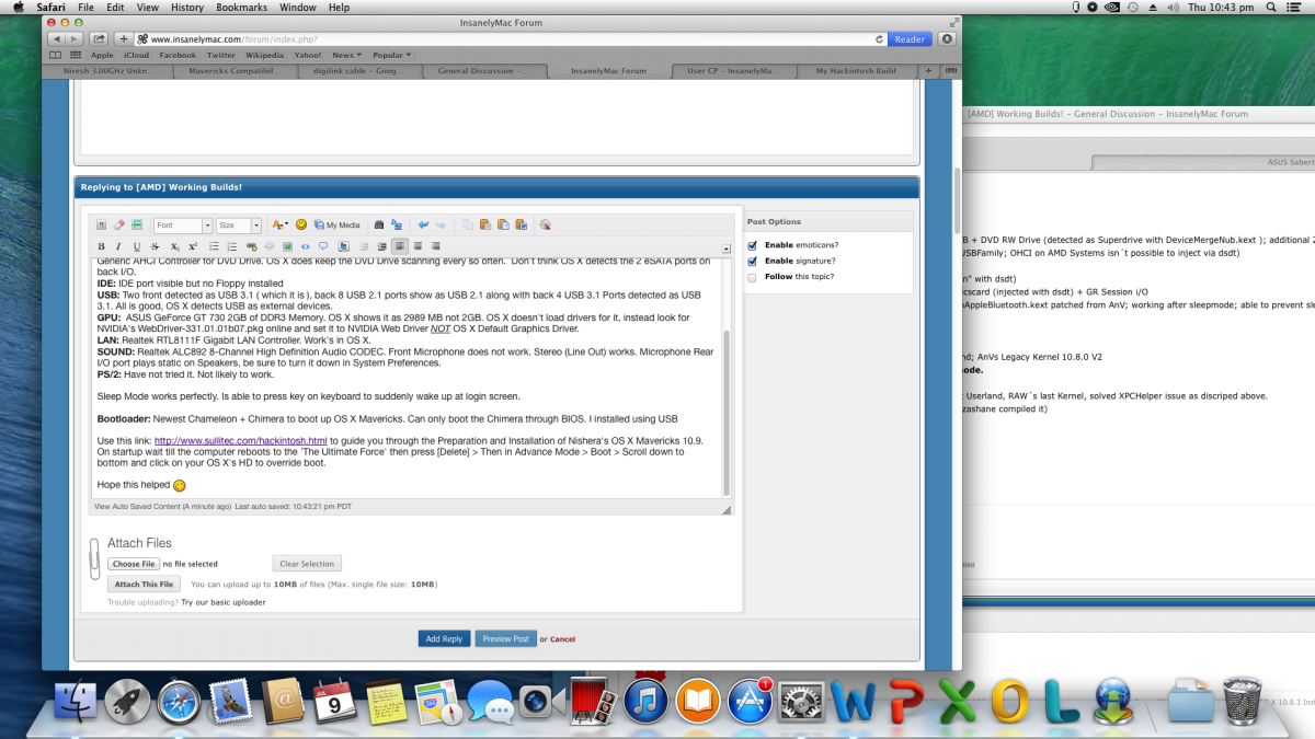

Here's my Successful Hackintosh on Nishera's OS X Mavericks 10.9
CPU: AMD FX-8320 8-Core 3.79GHz. OS X shows it as 3.79GHz Unknown.
MB: ASUS Sabertooth 990FX R2.0
RAM: 4 GB 1066MHz DDR3 (2 x 4 GB)
CHIPSET:  AMD 990FX/SB950
SATA: OS X HD (320 GB) plugged into top first SATA port with Windows HD (500 GB) on Bottom First SATA Port with DVD Drive on Top Second SATA port, these show up under ASMedia ASM1061. DVD detected as the Correct Brand Name along with its Model number.  OS X uses Generic AHCI Controller for DVD Drive. OS X does keep the DVD Drive scanning every so often.  Don't think OS X detects the 2 eSATA ports on back I/O.
IDE: IDE port visible but no Floppy installed
USB: Two front detected as USB 3.1 ( which it is ), back 8 USB 2.1 ports show as USB 2.1 along with back 4 USB 3.1 Ports detected as USB 3.1. All is good, OS X detects USB as external devices.
GPU:  ASUS GeForce GT 730 2GB of DDR3 Memory. OS X shows it as 2989 MB not 2GB. OS X doesn't load drivers for it, instead look for NVIDIA's WebDriver-331.01.01b07.pkg online and set it to NVIDIA Web Driver NOT OS X Default Graphics Driver.
LAN: Realtek RTL8111F Gigabit LAN Controller. Work's in OS X.
SOUND: Realtek ALC892 8-Channel High Definition Audio CODEC. Front Microphone does not work. Stereo (Line Out) works. Line Out with Speakers play static, most likely something to do with VoodooHDA kext.
PS/2: Have not tried it. Not likely to work.
Sleep Mode works perfectly. Is able to press key on keyboard to suddenly wake up at login screen.
Bootloader: Newest Chameleon + Chimera to boot up OS X Mavericks. Can only boot the Chimera through BIOS. I installed using USB
Use this link: http://www.sullitec.com/hackintosh.html to guide you through the Preparation and Installation of Nishera's OS X Mavericks 10.9.
On startup wait till the computer reboots to the 'The Ultimate Force' then press [Delete] > Then in Advance Mode > Boot > Scroll down to bottom and click on your OS X's HD to override boot.
Hope this helped  ;)

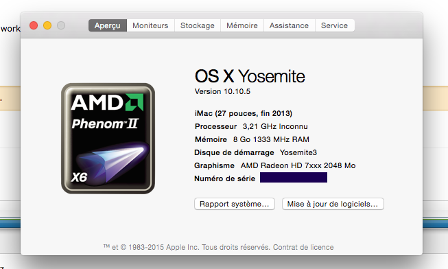

Yosemite 10.10.5
Kernel: y2k4u - 10.10.5R1
Bootloader: Chameleon Enoch rev 2737
Motherboard: Asus M4A88TD-V evo/usb3 880G
CPU: AMD Phenom ll X6 1090T BE
Memory: GSKILL Ripjaws series 8GB 1333MHz (2x4GB)
Video: AMD Radeon H7870 2GB
Lan: Realtek 8168e/8111e (RealtekRTL8111.kext)
Sound: Realtek ALC892 (Voodoohda v2.8.4)
USB 3 : Works with patched AppleUSBXHCI v710.4.11 (10.10.5) ( http://www.insanelymac.com/forum/files/file/150-patched-appleusbxhci/ )
Appstore works
Imessage, Icloud and Facetime do not work
:)  :thumbsup_anim:
post-1384939-0-87685500-1446394480_thumb.png  post-1384939-0-43534200-1446394737_thumb.png
Edited by superclo

in addition to 10.8.5 I used my intel hack for installing 10.10.4 with 10.10.3 Kernel: installed 10.10.4 on second HDD of intel hack, installed kernel and NullCPUPowermanagement with AMD Installer, made dmg from that system and restored dmg to free partition on my amd hack
patched IOPCIFamily.kext + AppleACPIPlattform.kext from above messages required for working system without crashes and freezes
Replaced kexts in /S/L/E/ - patched IOPCIFamily.kext + AppleACPIPlattform.kext and pthread.kext from AMD Installer
All other kexts inject by Clover 2953 from /EFI/CLOVER/kexts/10.10
Geforce GTX 670 - works without injecting or with web-driver
M-Audio Revolution 7.1 works with the same Envy24HTPCIAudioDriver.kext as in 10.8.5
LAN Realtek8111 works with Realtek8111.kext v2.0.0
USB 3 - works with GenericUSBXHCI.kext
USB 2 incompatible with sleep, but works
Also my Wacom Intuos 2 5x4 tablet works with old unsigned driver 6.2.0w4, but can't use prefpanel: need to backup settings from 10.8.5 and restore it in 10.10.4 (but this problem with all Intuos2 tablets in 10.10)
Bootargs in clover: npci=0x2000 -v
Bootarg in system com.apple.Boot.plist: kext-dev-mode=1

  • AMD Athlon II X3 OCed from 3.21 GHZ to 3.6x GHZ (Hoping to reach 4.00 GHZ I couldn't do up to 4.0 GHz :( I got a FX 6300 and am hoping to install yosemite on this build with it).
  • Asus M5A78L-M/USB3 Motherboard
  • 1 Ballistix 4 GB 1600 MHZ DDR3 RAM Stick
  • ZOTAC GeForce GT 220 Video Card
  • OS X 10.10 Yosemite with Bronya's RC3 kernel
  • And a lot of patience
  • Oh and these boot flags "GraphicsEnabler=Yes kext-dev-mode=1 npci=0x3000"
  • Drivers/Kexts VoodooHDA for Audio, RTL81111 network kext and generic USB 3.0 kext
  • Usability status unknown: PS2 USB 3.0 HDMI (Onboard and on video card) SPDI/F Audio.

My Build!
Hardware:
AMD FX- 8350 (OC 4.3)
Gigabyte 990FXA UD5 REV 1.0
10 GB Ram DDR3 1333Mhz
R9 280X Dual 3Gb DDR5 x2
HDD Segate 1Tb (3 - S.O [Yosemite - Win 10 - LinuxMint] )
Bios Config:
AHCI Mode  HDD
Disable AMD for OC
BOOTLOADER:
CLOVER EFI:
Config;

KETXS and Drivers and Kernel:
Audio: VooDooHDA
LAN: RealtekRTL8111.kext
GPU: ATY,AMD,RadeonFramebuffer
Kernel: AMD Kernel Yosemite 10.10.5_SSEPlus V2
Not if I forget something: D
Screenshots:
  • Like 4
