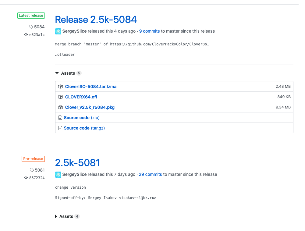

Just a stupid question once again:

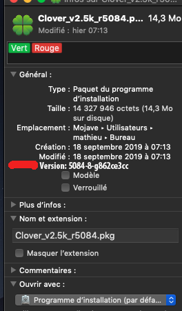

On GitHub Repo, I just made a compilation. Clover keeps the same version number (r5084) as the release, despite additional commits. It's possible to have Clover Nightly Builds number (pre-release version) like on SF :)
45 minutes ago, Matgen84 said:
Hi @Slice all developers
Compiling from github you will have version v2.5k, revision r5084, and additionally commit id like 9cddc6.
A revision which increases with every commit may be generated from git using  "git rev-list --count HEAD" but the revision will be smaller than what is present on svn unless all the history is added into git.
A solution may be to add 6000 to git-rev-list.
Thanks @Slice I know that. Once compiled, the ID number does not appear.
I think @Florin9doi solution will be interesting. Especially for those who compile intermediate versions, and to identify those that might have any bugs. SF repo is very good for that.

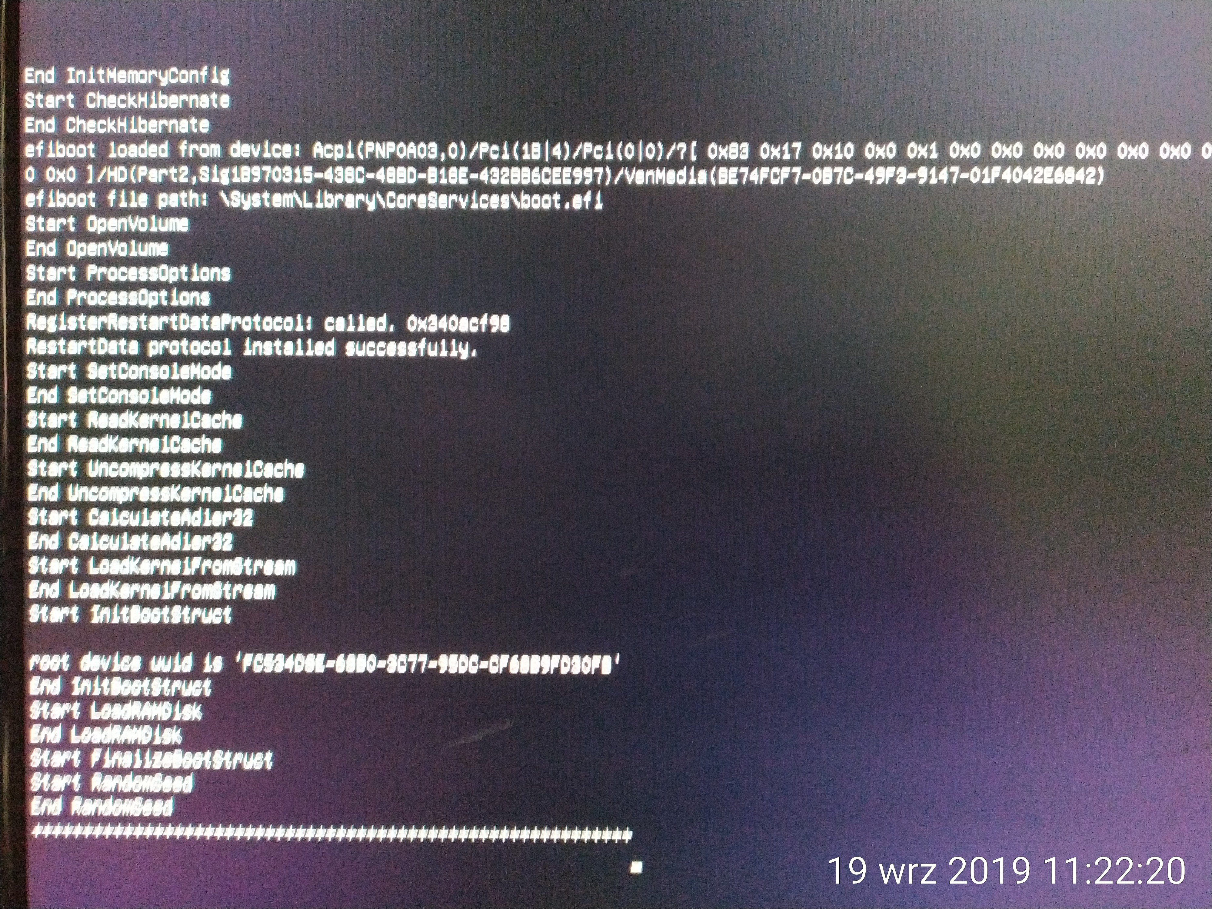

On 9/18/2019 at 4:44 PM, ellaosx said:
Hi
Just want to report. Im still getting x64 exception in legacy mode. I have tried both SVN & Github sources.
With SF commit r5089, I needed to reapply Patches_for_EDK2 to get good build...

6 hours ago, ellaosx said:
What about in github?
as a note, the red screen happens AFTER the clover gui.
All good with GitHub Clover r5084_80c5b67d compilation in macOS with default GCC53 toolchain.

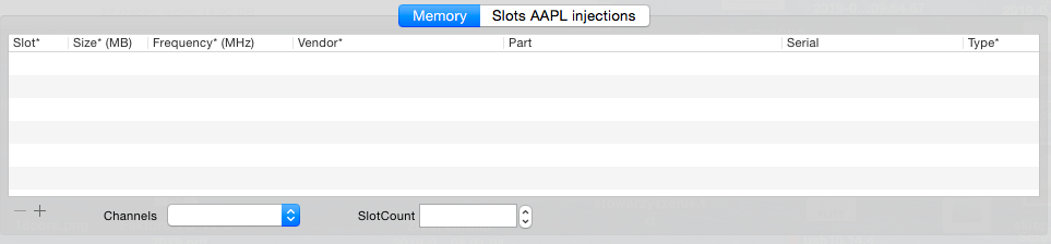

34 minutes ago, ori said:

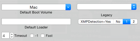

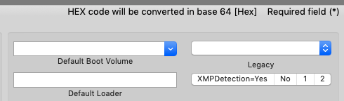

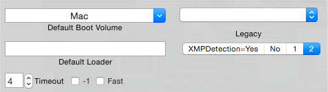

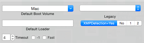

Z390 doesn't boot with 2x32GB memories. After entering the memory, it moves.
Do you try to remove 32GB from SMBIOS? And select XMP Profile 1 or 2 instead in Clover settings.
What Z390 mobo? On Z390 Gigabyte, I have select XMP Profile 1 in BIOS, for 3000MHZ frequency

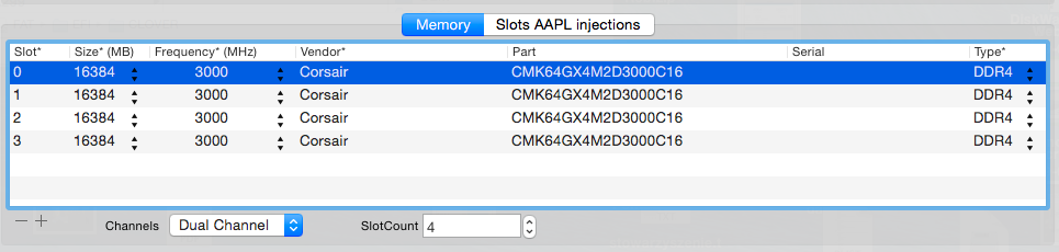

4 hours ago, ori said:
Still not starting.
413396665_Zrzutekranu2019-09-19o11_13_48.png.5ece0fa1a60dbec7e42c151aba56f732.png50600860_Zrzutekranu2019-09-19o11_16_34.png.a78257f5d94bcb938588f17d126f79b4.png
What macOS?
Could you post your EFI Folder. Please.
Edit: put the XMP to profile 1 and set the trust variable to true in clover and rebooted. If you already have the OsxAptioFix2Drv-free2000.efi or AptioMemoryDix installed "and you should also add "slide=0" to the Boot arguments in Clover.
Edited by Matgen84
5 hours ago, ori said:
Gigabyte Z390 M Gamming
BIOS:
XMP Profil1 3000MHz
Clover:
What RAM is that? Have you tried lowering the frequency to something like 2666MHz?
Also, have you tried booting with a single memory stick?
Also, what's the CPU on this system and which SMBIOS profile are you currently using for it?
Also, something else that's not really clear to me... If this is 2 sticks of 32GB each, why did you add your RAM as 4x16GB in config?
Could you, please, add all your hardware information to your signature? It would make things a looot easier. I gotta tell you, at this point, this looks more like a hardware issue rather than a software/Clover issue.

About github version numeration
Dell:CloverHackyColor sergey$ git describe head --tags
5084-8-g862ce3cc
5084 - is the last sync sources with sf.net
8 - a number of commits on github over the revision. So logically it will be 5084+8 but sf.net as well as github has intermediate commits not influencing on binaries.
g862ce3cc - last commit id
5084-8-g862ce3cc
Thanks for your explanations :)

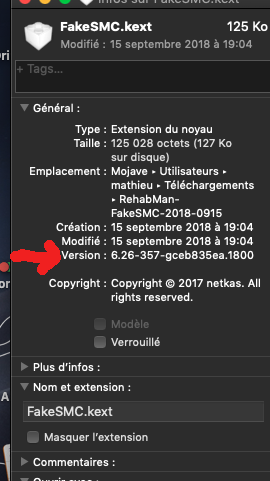

I understand what it is. But the compilation made and the pkg realized, it appears only the revision on the installer: for example, Clover v2.5 r5084. We do not know which commits are included since the release.
Since intermediate numbering is not possible as on SF (and possible on GitHub before r5084, pre-release r5081), we could display its info (commits id) in version line into "Read Info" like FakeSmc Rehabman
Edited by Matgen84
RAM is marked in the picture ( Corsair CMK64GX4M2D3000C16 64 GB (2x 32 GB) 3000 MHz CL16-20-20-38 1.35 V). I also tried Corsair CMK64GX4M2A2666C16 64 GB (2x 32 GB) 2666 MHz and it was the same.
I lowered it even to the lowest values. I disabled XMP in the BIOS. And it did nothing. I tried with one memory and it didn't start either. It wasn't until somewhere on the forum that I found an entry that someone made a post under SMbios 4x16GB and it went. I don't understand why, but it works with this post.
The processor is i7 9700K. SMbios iMac 19.1.
Gigabyte Z390 M Gamming motherboard. I can also check the Z90 Aorus Pro, but I doubt anything will change.
Interesting that on Open Core enters MacOS. Works well with Windows.
It looks like Clover's problem to me. Because I saw more such posts in the forums. This happens on different motherboards. Clover once had a similar problem with memories in the Asus Z370, where it only saw 2 out of 4 RAM and had to be added manually.
Edited by Slice
dont link to tonymac
Thank you for the detailed information! That's a lot better. And also, sorry for not realizing the RAM model was actually in your screenshot. My bad. :D
Well, if it works with Windows, if it works with OC (with what I'm guessing is the same SMBIOS)...then yeah....I guess it could be Clover issue. You don't happen to have one 16GB stick laying around, do you? I would be curious to see what happens in that case. Maybe it works with 64GB actually paired in 4x16GB sticks but not with 2x32GB sticks? I don't see why (although Clover issue could be a possibility), but it would still be an interesting result, in my opinion.
Edited by arsradu
