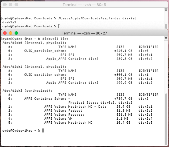

Yep the Clover installs the files on the root instead of the ESP <_<
here's the Diskutil list output:
Spoiler
cyberdevs@Cyberdevss-iMac ~ % diskutil list
/dev/disk0 (internal, physical):
   #:                       TYPE NAME                    SIZE       IDENTIFIER
   0:      GUID_partition_scheme                        *500.1 GB   disk0
   1:                        EFI EFI                     209.7 MB   disk0s1
   2:                 Apple_APFS Container disk2         499.9 GB   disk0s2
/dev/disk1 (internal, physical):
   0:      GUID_partition_scheme                        *240.1 GB   disk1
   1:                        EFI EFI                     209.7 MB   disk1s1
   2:                 Apple_APFS Container disk2         239.8 GB   disk1s2
/dev/disk2 (synthesized):
   0:      APFS Container Scheme -                      +739.7 GB   disk2
                                 Physical Stores disk1s2, disk0s2
   1:                APFS Volume Macintosh HD - Data     3.8 GB     disk2s1
   2:                APFS Volume Preboot                 81.0 MB    disk2s2
   3:                APFS Volume Recovery                526.8 MB   disk2s3
   4:                APFS Volume VM                      1.1 MB     disk2s4
   5:                APFS Volume Macintosh HD            10.3 GB    disk2s5

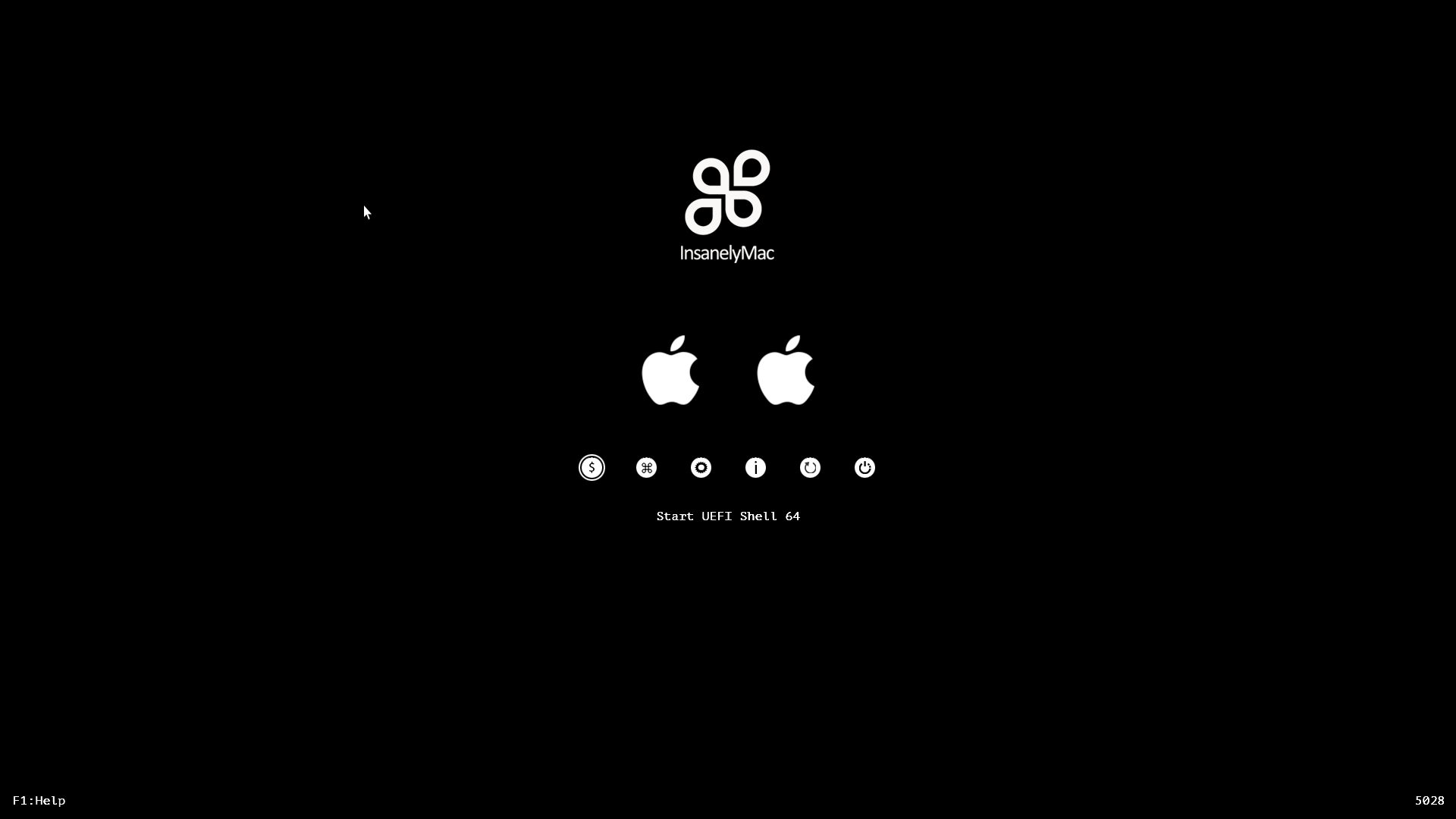

Yes, the ISO is designed for legacy boot (and it really works!). I am just not sure if UEFI boot is also possible.
After a bit of digging around, the answer is definitively YES, it is possible to pure UEFI boot from CD/DVD, but a lot depends on the (U)EFI firmware doing the booting.
The standard Clover ISO only consists of a single 10MB HFS+ volume which can be EFI booted by firmware that understands HFS+ eg Apple machines and VMware Virtual Machines.  For it to boot on standard PCs, however, only the legacy pathway is available via the cdboot/eltorito pathway.
On the other hand, Ubuntu and Linux Mint Installation ISOs have dual formats for UEFI boot or Legacy boot
1) A 2.4MB FAT efi.img that contains grubx64.efi and functions as a "mini" EFI, recognizable for UEFI booting by standard PCs
2) A much larger ISO9660 file system that has all of the installation files and can also boot via the legacy eltorito pathway.
I was able to adapt this procedure from the Debian Wiki: RepackBootableISO, to repack the Clover ISO with an extra 2.4MB FAT efi.img containing CLOVERX64.efi, UEFI drivers, FakeSMC, the embedded theme and a custom config.plist that works for @arsradu to test on his system....
559451826_Cloverr5018UEFIISO.thumb.jpeg.bdd1138eabd21eeb8336ea08d9e9369f.jpeg1262232233_BootUEFIopticalfromCDROM.thumb.png.dfc03e68875857d9d81999e99feeea4d.png
Note: the About Clover GUI screen that shows firmware booting by American Megatrends (not Clover EFI so NOT legacy boot).....and it boots his system fine :D.

Hi Guys, attached a command line called espfinder. The purpose is to find the associated EFI partition that belong to a target volume using the Clover package. Here  actually works with or whitout apfs containers. CoreStorage isn't yet implemented but I'm confident that espfinder will give Us usefull informations about it, in fact this beta version make a dump at ~/Desktop/espfinder.plist.
Usage:
findesp disk2s4
(whole disks like disk0, disk2 etc. are not allowed)
@ricoc90, @Cyberdevs please, I need the dump from both of you. To All,  please confirm you can find the ESP from regular disks (whith apfs containers or other fs).
Thanks in advance
P.S. would be cool to have a dump from a RAID set up as well...
espfinder_0.1_beta.zip

Odd question. Shouldn’t I be able to boot into EFI shell from Clover menu? I do not have that option currently (see below) I just updated to 5018 but the last version didn’t have that menu option either. What am I missing?
EDIT:
Okay, I'm a bonehead. In my attempt to have a "pristine" or "clean" EFI folder, I deleted the folder with the shell in it! Doh! It works now.
Edited by pkdesign
SOLUTION
I have it with 5028. Theme issue...? I've attached my 5028 if you wanna give it a try.

8 hours ago, Cyberdevs said:
@vector sigma
Sorry for the delay here's my log. I have one SSD and one HDD attached to the system and I made the Fusion Drive and I'm running Catalina at the moment.
Please let me know if there's anything else that you need me to do. :)
espfinder.plist.zip
thanks guys! @Cyberdevs in yours I've found something different, so I'm not sure if in Terminal the message was like 'ESP not found', anyway thanks to your log I'm pretty sure will be able in the next version.... version where the log will show me the result :-)
Sure thing man, I will check again and create another log when I get back home and see if it differs from the first log and if it was different I will let you know.
Cheers
