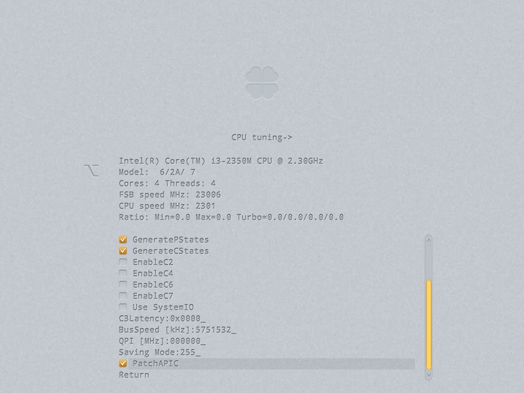

bronxteck Posted August 6, 2019 Share Posted August 6, 2019 (edited) how are we supposed to implement patch APIC after commit 5028. most people that have it enabled in config are having issues booting to a KP. and dont know why the machine that always booted fine now suddenly KP's at boot after rev 5028 and higher. is it a bug or a feature? for the guys above try disabling patch APIC if you have it enabled and see if now it works. Edited August 6, 2019 by bronxteck Link to comment Share on other sites More sharing options...
Badruzeus Posted August 6, 2019 Share Posted August 6, 2019 (edited) 57 minutes ago, bronxteck said: how are we supposed to implement patch APIC after commit 5028. most people that have it enabled in config are having issues booting to a KP. and dont know why the machine that always booted fine now suddenly KP's at boot after rev 5028 and higher. is it a bug or a feature? My problem after r5028++ was machine with 2nd Gen CPU unable to HALT (reboot-shutdown); already tested leaving only mandatory *.efi on \drivers\UEFI (DataHub, FSInject, OsxAptio*, VBoxHfs, SMCHelper), and just minumum 3rd party kexts (HWSensor's FakeSMC v3.5.x & PS2Controller). Also tried clear NVRAM several times with F11 key, as well.. using Clover's on the fly ACPI Patches instead of my custom DSDT/SSDT, booting 10.13.6 upto 10.15 Beta.. etc. BUT all didn't solve the issue, TILL I uncommited r5028 AcpiPatcher.c (rolling back to r5027) and now my mach is back to normal again. #EDIT: Thanks to Florin9doi, anyway. APIC_unPatch.diff.zip r5036_APIC_unPatched.zip Edited August 6, 2019 by Badruzeus 1 Link to comment Share on other sites More sharing options...
onemanOSX Posted August 6, 2019 Share Posted August 6, 2019 26 minutes ago, Badruzeus said: My problem after r5028++ was machine with 2nd Gen CPU unable to HALT (reboot-shutdown); already tested leaving only mandatory *.efi on \drivers\UEFI (DataHub, FSInject, OsxAptio*, VBoxHfs, SMCHelper), and just minumum 3rd party kexts (HWSensor's FakeSMC v3.5.x & PS2Controller). Also tried clear NVRAM several times with F11 key, as well.. using Clover's on the fly ACPI Patches instead of my custom DSDT/SSDT, booting 10.13.6 upto 10.15 Beta.. etc. BUT all didn't solve the issue, TILL I uncommited r5028 AcpiPatcher.c (rolling back to r5027) and now my mach is back to normal again. #EDIT: Thanks to Florin9doi, anyway. APIC_unPatch.diff.zip r5036_APIC_unPatched.zip This solved for my build as well! Thank you @Badruzeus and @Florin9doi 1 Link to comment Share on other sites More sharing options...
Slice Posted August 6, 2019 Share Posted August 6, 2019 1 hour ago, Badruzeus said: My problem after r5028++ was machine with 2nd Gen CPU unable to HALT (reboot-shutdown); already tested leaving only mandatory *.efi on \drivers\UEFI (DataHub, FSInject, OsxAptio*, VBoxHfs, SMCHelper), and just minumum 3rd party kexts (HWSensor's FakeSMC v3.5.x & PS2Controller). Also tried clear NVRAM several times with F11 key, as well.. using Clover's on the fly ACPI Patches instead of my custom DSDT/SSDT, booting 10.13.6 upto 10.15 Beta.. etc. BUT all didn't solve the issue, TILL I uncommited r5028 AcpiPatcher.c (rolling back to r5027) and now my mach is back to normal again. #EDIT: Thanks to Florin9doi, anyway. APIC_unPatch.diff.zip r5036_APIC_unPatched.zip Is it the same result if just set PatchAPIC=NO? 1 Link to comment Share on other sites More sharing options...

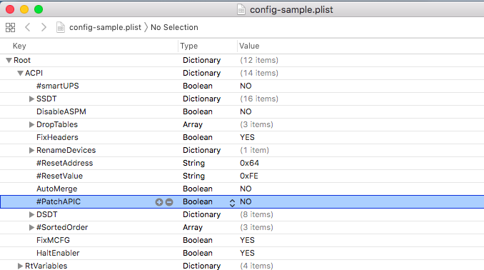

Badruzeus Posted August 6, 2019 Share Posted August 6, 2019 35 minutes ago, Slice said: Is it the same result if just set PatchAPIC=NO? Sorry, is this an option to add on config.plist, or..? 1 Link to comment Share on other sites More sharing options...
vector sigma Posted August 6, 2019 Share Posted August 6, 2019 Just now, Badruzeus said: Sorry, is this an option to add on config.plist, or..? Yes, and you can do that at boot time as well in the GUI 1 Link to comment Share on other sites More sharing options...
Badruzeus Posted August 6, 2019 Share Posted August 6, 2019 1 minute ago, vector sigma said: Yes, and you can do that at boot time as well in the GUI Thanks. So, I need re-using r5028++ AcpiPatcher.c then boot with this `PatchAPIC=NO` right? Will test it ASAP. 1 Link to comment Share on other sites More sharing options...
Badruzeus Posted August 6, 2019 Share Posted August 6, 2019 @vector sigma seems normal using `PatchAPIC=NO` boot-arg (with r5028 commit); But wait, previous issue was actualy random.. I mean, (reboot-shutdown problem) happenned for example after several hours macOS running, then idle (I never let my mach to sleep neither hibernate, btw). If I turn my mach on then turn off immediately, using r5028 (w/o PacthAPIC=NO) mach is HALTED properly. Before r5028 I usually powered my laptop for max 6 days w/o powered off (nor sleep) but having no issue with mach HALT at all. Thanks. Link to comment Share on other sites More sharing options...
vector sigma Posted August 6, 2019 Share Posted August 6, 2019 10 minutes ago, Badruzeus said: seems normal using `PatchAPIC=NO` boot-arg (with r5028 commit); I'm not sure adding that to the boot-args will do the job... 1 Link to comment Share on other sites More sharing options...
vector sigma Posted August 7, 2019 Share Posted August 7, 2019 (edited) On 8/7/2019 at 12:54 AM, meaganmargaret said: So, I have used AptioMemoryFix on my X299 system to manage booting and it has worked extremely well. The bad news is that AptioMemoryFix has been discontinued. No new versions or updates. It's done. Over and out....and of course, AptioMemoryFix is no longer included in Clover, I assume particularly for the reason that some knew about AptioMemoryFix's pending demise.As recently as Clover 5033, I have tried all three of the OsxAptio* versions that are supposed to provide memory mgmt during boot, and they all failed. Badly failed. Couldn't even get a display in verbose mode from any of them.If you use Opencore, there is supposed to be FwRuntimeServices.efi, which may be an offshoot of AptioMemoryFix, but it only works with Opencore, and not in Clover.It appears as if the developers of Clover have decided that my only option is to use Opencore, or sell my X299 board...... This sucks.... Can you try this MemoryFix.efi.zip? Found inside Ceccagnoli Stefano's PC: for more informations read next posts up to page 796 Edited August 8, 2019 by vector sigma Link to comment Share on other sites More sharing options...
Badruzeus Posted August 7, 2019 Share Posted August 7, 2019 (edited) 7 hours ago, vector sigma said: I'm not sure adding that to the boot-args will do the job... Oh my bad, sorry for that. However, `PatchAPIC` is located on ACPI section from config.plist, but on Options menu (when booting Clover) is on CPU Tuning, that' s why I was bit confuse #LOL. I never set it to YES/NO with my 2nd Gen Asus laptop honestly, means this setting is missing from my config. Thanks. Edited August 7, 2019 by Badruzeus Link to comment Share on other sites More sharing options...
Slice Posted August 7, 2019 Share Posted August 7, 2019 10 hours ago, Badruzeus said: @vector sigma seems normal using `PatchAPIC=NO` boot-arg (with r5028 commit); But wait, previous issue was actualy random.. I mean, (reboot-shutdown problem) happenned for example after several hours macOS running, then idle (I never let my mach to sleep neither hibernate, btw). If I turn my mach on then turn off immediately, using r5028 (w/o PacthAPIC=NO) mach is HALTED properly. Before r5028 I usually powered my laptop for max 6 days w/o powered off (nor sleep) but having no issue with mach HALT at all. Thanks. 1 Link to comment Share on other sites More sharing options...

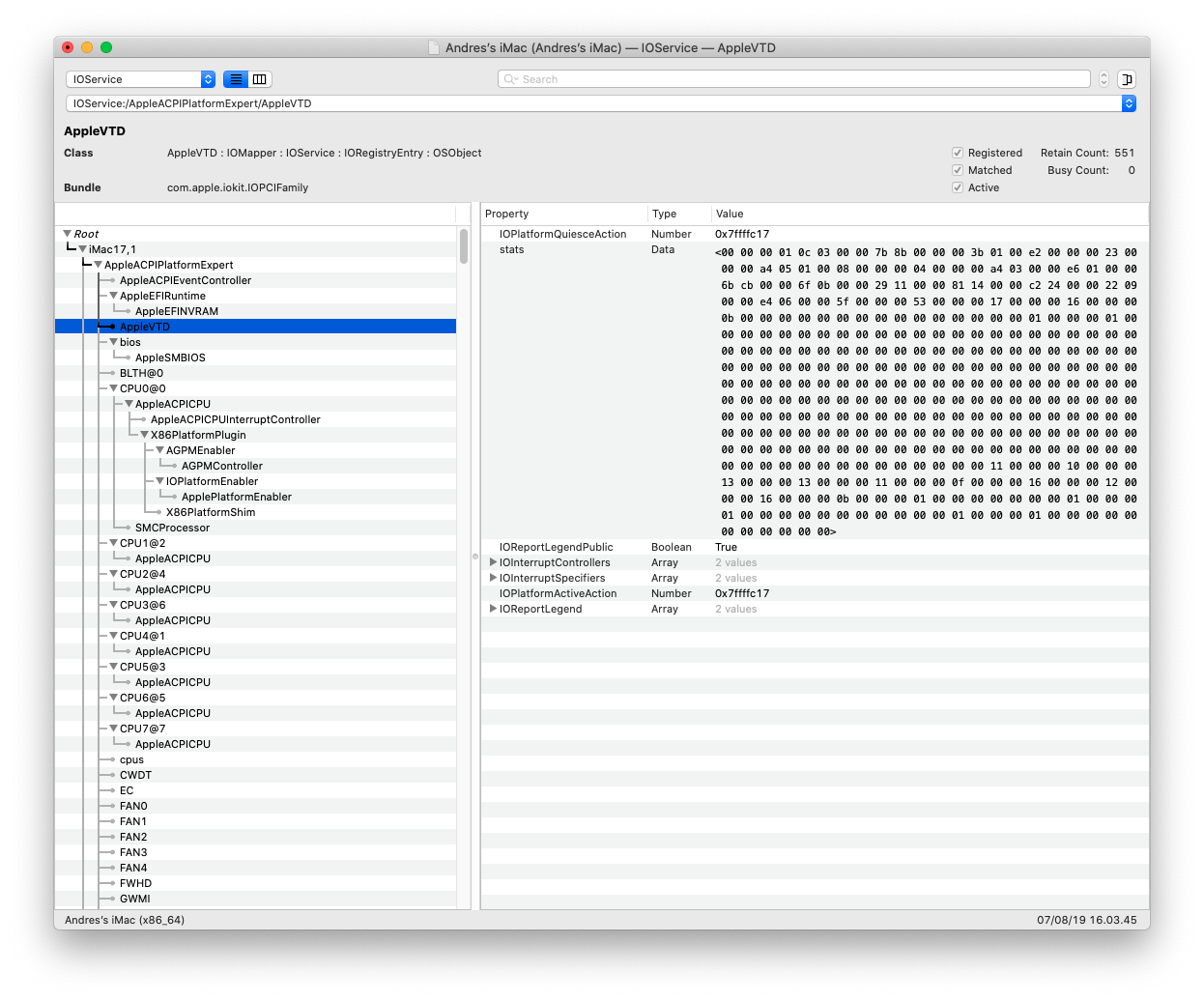

Andres ZeroCross Posted August 7, 2019 Share Posted August 7, 2019 1 hour ago, Slice said: Slice sorry for this question again,, defaul sample of config.plist always drop DMAR table. But i have tested to delete this, AppleVTD is shown in IOREG (DMAR ACPI TABLE) is loaded in macOS with no problem. I have tested it in Broadwell, Skylake, Kabylake and Coffelake. Is this neccessery to drop DMAR table??? or can you point me to the link about old issue with DMAR table? Link to comment Share on other sites More sharing options...
