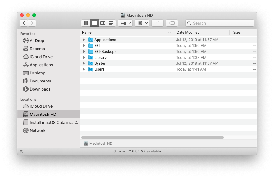

Cyberdevs Posted July 17, 2019 Share Posted July 17, 2019 Yep the Clover installs the files on the root instead of the ESP here's the Diskutil list output: Spoiler cyberdevs@Cyberdevss-iMac ~ % diskutil list /dev/disk0 (internal, physical): #: TYPE NAME SIZE IDENTIFIER 0: GUID_partition_scheme *500.1 GB disk0 1: EFI EFI 209.7 MB disk0s1 2: Apple_APFS Container disk2 499.9 GB disk0s2 /dev/disk1 (internal, physical): #: TYPE NAME SIZE IDENTIFIER 0: GUID_partition_scheme *240.1 GB disk1 1: EFI EFI 209.7 MB disk1s1 2: Apple_APFS Container disk2 239.8 GB disk1s2 /dev/disk2 (synthesized): #: TYPE NAME SIZE IDENTIFIER 0: APFS Container Scheme - +739.7 GB disk2 Physical Stores disk1s2, disk0s2 1: APFS Volume Macintosh HD - Data 3.8 GB disk2s1 2: APFS Volume Preboot 81.0 MB disk2s2 3: APFS Volume Recovery 526.8 MB disk2s3 4: APFS Volume VM 1.1 MB disk2s4 5: APFS Volume Macintosh HD 10.3 GB disk2s5 cyberdevs@Cyberdevss-iMac ~ % another update by @ricoc90 request: Spoiler cyberdevs@Cyberdevss-iMac ~ % diskutil info /dev/disk0 Device Identifier: disk0 Device Node: /dev/disk0 Whole: Yes Part of Whole: disk0 Device / Media Name: ST3500418ASQ Volume Name: Not applicable (no file system) Mounted: Not applicable (no file system) File System: None Content (IOContent): GUID_partition_scheme OS Can Be Installed: No Media Type: Generic Protocol: SATA SMART Status: Verified Disk Size: 500.1 GB (500107862016 Bytes) (exactly 976773168 512-Byte-Units) Device Block Size: 512 Bytes Read-Only Media: No Read-Only Volume: Not applicable (no file system) Device Location: Internal Removable Media: Fixed Solid State: No Virtual: No Hardware AES Support: No cyberdevs@Cyberdevss-iMac ~ % diskutil info /dev/disk1 Device Identifier: disk1 Device Node: /dev/disk1 Whole: Yes Part of Whole: disk1 Device / Media Name: KINGSTON SHSS37A240G Volume Name: Not applicable (no file system) Mounted: Not applicable (no file system) File System: None Content (IOContent): GUID_partition_scheme OS Can Be Installed: No Media Type: Generic Protocol: SATA SMART Status: Verified Disk Size: 240.1 GB (240057409536 Bytes) (exactly 468862128 512-Byte-Units) Device Block Size: 512 Bytes Read-Only Media: No Read-Only Volume: Not applicable (no file system) Device Location: Internal Removable Media: Fixed Solid State: Yes Virtual: No Hardware AES Support: No cyberdevs@Cyberdevss-iMac ~ % diskutil info /dev/disk2 Device Identifier: disk2 Device Node: /dev/disk2 Whole: Yes Part of Whole: disk2 Device / Media Name: KINGSTON SHSS37A240G Volume Name: Not applicable (no file system) Mounted: Not applicable (no file system) File System: None Content (IOContent): EF57347C-0000-11AA-AA11-00306543ECAC OS Can Be Installed: No Media Type: Generic Protocol: SATA SMART Status: Verified Disk / Partition UUID: 23E80DC2-F0ED-4DA7-8598-19AAB272D305 Disk Size: 739.7 GB (739745759232 Bytes) (exactly 1444815936 512-Byte-Units) Device Block Size: 4096 Bytes Read-Only Media: No Read-Only Volume: Not applicable (no file system) Device Location: Internal Removable Media: Fixed Solid State: Yes Virtual: Yes Hardware AES Support: No This disk is an APFS Container. APFS Information: APFS Physical Store: disk1s2 APFS Physical Store: disk0s2 Fusion Drive: Yes cyberdevs@Cyberdevss-iMac ~ % 3 Link to comment https://www.insanelymac.com/forum/topic/284656-clover-general-discussion/page/783/#findComment-2681972 Share on other sites More sharing options...

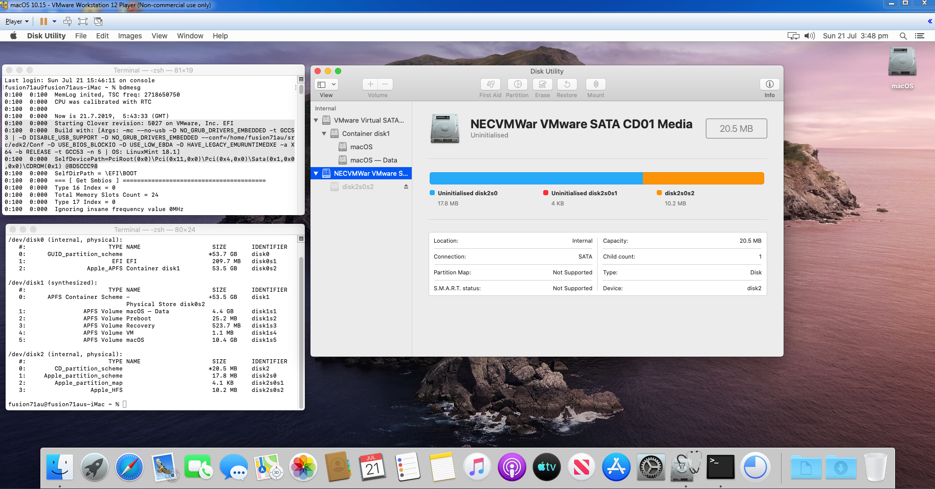

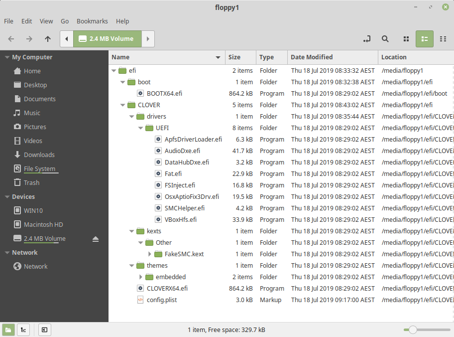

fusion71au Posted July 18, 2019 Share Posted July 18, 2019 (edited) On 7/10/2019 at 2:52 PM, Slice said: ISO image must contain necessary drivers for UEFI boot from the DVD. At least Fat.efi, HFS+, APFS, Aptio, Or UEFI boot from DVD is impossible? On 7/10/2019 at 9:26 PM, vector sigma said: I was guessing about this. Isn't a legacy boot only with the cdboot used? On 7/10/2019 at 9:35 PM, Slice said: Yes, the ISO is designed for legacy boot (and it really works!). I am just not sure if UEFI boot is also possible. After a bit of digging around, the answer is definitively YES, it is possible to pure UEFI boot from CD/DVD, but a lot depends on the (U)EFI firmware doing the booting. The standard Clover ISO only consists of a single 10MB HFS+ volume which can be EFI booted by firmware that understands HFS+ eg Apple machines and VMware Virtual Machines. For it to boot on standard PCs, however, only the legacy pathway is available via the cdboot/eltorito pathway. On the other hand, Ubuntu and Linux Mint Installation ISOs have dual formats for UEFI boot or Legacy boot 1) A 2.4MB FAT efi.img that contains grubx64.efi and functions as a "mini" EFI, recognizable for UEFI booting by standard PCs 2) A much larger ISO9660 file system that has all of the installation files and can also boot via the legacy eltorito pathway. I was able to adapt this procedure from the Debian Wiki: RepackBootableISO, to repack the Clover ISO with an extra 2.4MB FAT efi.img containing CLOVERX64.efi, UEFI drivers, FakeSMC, the embedded theme and a custom config.plist that works for @arsradu to test on his system.... Note: the About Clover GUI screen that shows firmware booting by American Megatrends (not Clover EFI so NOT legacy boot).....and it boots his system fine . Ingredients needed to make a real UEFI bootable Clover CD/DVD 1) A special mbr_template that enables the booting off the 2.4MB FAT efi.img (extracted from Linux Mint 19.1 Installation ISO) ... isohdpfx.bin ---> I saved it to /home/fusion71au/Downloads/CLOVER/isohdpfx.bin 2) A 2.4MB FAT efi.img that contains CLOVERX64.efi, UEFI drivers, FakeSMC, the embedded theme and a config.plist 3) xorriso utility in Linux (Homebrew version for OSX here). I was able to compile Clover with Build_Clover.command, then repacked the Clover ISO with xorriso with the following terminal commands... new_files=~/src/edk2/Clover/CloverPackage/sym/CloverCD new_iso=~/src/edk2/Clover/CloverPackage/sym/CloverISO-5018/Clover-v2.5k-5018-X64_UEFI.iso xorriso -as mkisofs \ > -r -V 'Clover-v2.5k-5018-X64.iso' \ > -o "$new_iso" \ > -J -J -joliet-long -cache-inodes \ > -isohybrid-mbr '/home/fusion71au/Downloads/Clover/isohdpfx.bin' \ > -b /usr/standalone/i386/cdboot \ > -boot-load-size 4 -boot-info-table -no-emul-boot \ > -eltorito-alt-boot \ > -e /EFI/CLOVER/efi.img \ > -no-emul-boot -isohybrid-gpt-basdat -isohybrid-apm-hfsplus \ > "$new_files" End result....Clover-v2.5k-5018-X64_UEFI.iso PS: If you want to play around with that efi.img, you can mount it as a loop device in Linux... Say it is in your ~/Downloads folder Open terminal and type sudo mkdir /media/floppy1 sudo mount -o loop ~/Downloads/efi.img /media/floppy1/ Should then see something like this.... You can add/delete files to the volume as the root user. As you can see, I only have about 300kB left to play with . To unmount the volume, just click the "eject" icon. Edited July 20, 2019 by fusion71au Update UEFI.iso with generic config.plist and AptioMemoryFix.efi instead of OsxAptioFix3Drv.efi 4 2 Link to comment https://www.insanelymac.com/forum/topic/284656-clover-general-discussion/page/783/#findComment-2682028 Share on other sites More sharing options...
arsradu Posted July 18, 2019 Share Posted July 18, 2019 (edited) @fusion71au I think it was a little more than "a bit of" digging around. :)) It was a lot of digging. In and around. All started from a simple question: if they can do it, why couldn't we? Cheers! And thank you! Edit: bdmesg added if you wanna take a look. Terminal Saved Output Clover ISO UEFI Edited July 18, 2019 by arsradu 2 Link to comment https://www.insanelymac.com/forum/topic/284656-clover-general-discussion/page/783/#findComment-2682030 Share on other sites More sharing options...

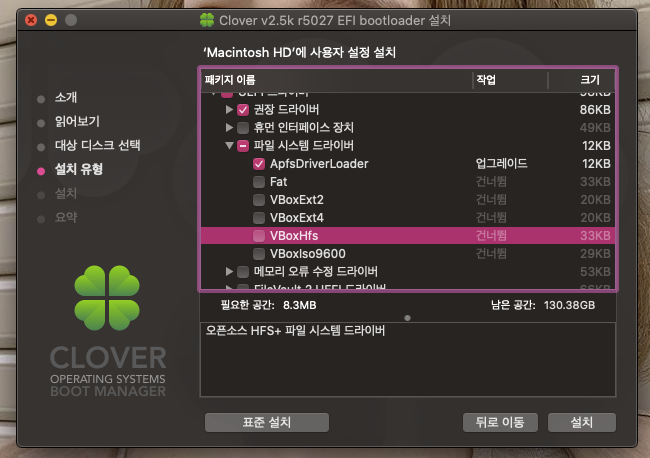

Sherlocks Posted July 20, 2019 Share Posted July 20, 2019 (edited) @vector sigma latest clover vboxhfs default check was removed. is it right? to work hfs, we have been use vboxhfs or hfsplus like current ApfsDriverLoader.efi in latest clover package. old clover package vboxhfs default check. and script check if user have hfsplus.efi, then if have it, vboxhfs installation have been ignore. with this log in install log "Removing drivers64UEFI/VBoxHfs-64.efi driver because HFSPlus driver present" r5027. i removed /Library/Preferences/com.projectosx.clover.installer.plist file. the i capture this default drivers. EDIT1 VirtualSMC.efi case is working i checked this log Removing UEFI/SMCHelper.efi driver because VirtualSMC driver present Edited July 20, 2019 by Sherlocks 2 Link to comment https://www.insanelymac.com/forum/topic/284656-clover-general-discussion/page/783/#findComment-2682253 Share on other sites More sharing options...
joevt Posted July 20, 2019 Share Posted July 20, 2019 On 7/18/2019 at 12:58 AM, fusion71au said: Ingredients needed to make a real UEFI bootable Clover CD/DVD 1) A special mbr_template that enables the booting off the 2.4MB FAT efi.img (extracted from Linux Mint 19.1 Installation ISO) ... isohdpfx.bin ---> I saved it to /home/fusion71au/Downloads/CLOVER/isohdpfx.bin 2) A 2.4MB FAT efi.img that contains CLOVERX64.efi, UEFI drivers, FakeSMC, the embedded theme and a config.plist 3) xorriso utility in Linux (Homebrew version for OSX here). I was able to compile Clover with Build_Clover.command, then repacked the Clover ISO with xorriso with the following terminal commands... new_files=~/src/edk2/Clover/CloverPackage/sym/CloverCD new_iso=~/src/edk2/Clover/CloverPackage/sym/CloverISO-5018/Clover-v2.5k-5018-X64_UEFI.iso xorriso -as mkisofs \ > -r -V 'Clover-v2.5k-5018-X64.iso' \ > -o "$new_iso" \ > -J -J -joliet-long -cache-inodes \ > -isohybrid-mbr '/home/fusion71au/Downloads/Clover/isohdpfx.bin' \ > -b /usr/standalone/i386/cdboot \ > -boot-load-size 4 -boot-info-table -no-emul-boot \ > -eltorito-alt-boot \ > -e /EFI/CLOVER/efi.img \ > -no-emul-boot -isohybrid-gpt-basdat -isohybrid-apm-hfsplus \ > "$new_files" End result....Clover-v2.5k-5018-X64_UEFI.iso As you can see, I only have about 300kB left to play with . To unmount the volume, just click the "eject" icon. Is there a reason why the size of the efi image can't be greater than 2.4 MB? Link to comment https://www.insanelymac.com/forum/topic/284656-clover-general-discussion/page/783/#findComment-2682322 Share on other sites More sharing options...

fusion71au Posted July 21, 2019 Share Posted July 21, 2019 (edited) On 7/21/2019 at 8:21 AM, joevt said: Is there a reason why the size of the efi image can't be greater than 2.4 MB? Good question. Since I was using the Linux Mint 19.1 ISO as my template for a UEFI bootable CD/DVD, I reused its isohybrid-mbr and 2.4MB FAT efi.img for creating the Clover UEFI ISO. I have since created a larger 10MB FAT efi.img... mkfs.msdos -C ~/src/edk2/Clover/CloverPackage/sym/CloverCD/EFI/CLOVER/efi.img 10240 and compiled successfully with xorriso, Clover-v2.5k-5027-X64_UEFI.iso.zip. This also EFI boots Catalina DP4 OK on my VMware12 virtual machine.... Awaiting @arsradu's real world testing on his system <--- Edit: confirmed working on real hardware. On 7/21/2019 at 9:08 AM, Mork vom Ork said: one short question: are the MEMORY FIX drivers just UEFI or are the MEMORY FIX drivers LEGACY & UEFI (especialy the AptioMemoryFix.efi)? never used LEGACY BIOS, that's why i ask. Yes, MEMORY FIX drivers are just for UEFI booting. Never needed AptioMemoryFix.efi for Clover's legacy boot because Clover has its own EFI firmware (based on DUET, not Aptio). Edited July 23, 2019 by fusion71au ISO confirmed working with larger FAT efi.img (UEFI or Legacy boot), added extra kexts, BIOS drivers and more universal config.plist Link to comment https://www.insanelymac.com/forum/topic/284656-clover-general-discussion/page/783/#findComment-2682333 Share on other sites More sharing options...
arsradu Posted July 21, 2019 Share Posted July 21, 2019 (edited) @fusion71au, you know I was asking you the very same question, right? ) I’ll take a look later today. Bit busy right now. EDIT: it boots perfectly fine. Haven't tried Catalina (only Mojave), but I see no reason why it wouldn't boot that one, as well. Edited July 21, 2019 by arsradu 1 Link to comment https://www.insanelymac.com/forum/topic/284656-clover-general-discussion/page/783/#findComment-2682334 Share on other sites More sharing options...

Guest ricoc90 Posted July 21, 2019 Share Posted July 21, 2019 With fusion drives there is no EFI partition on the target volume (obviously), but both physical storage disks do contain an EFI partition. So maybe we could just check if the target volume is a Fusion Drive: # Returns "Yes" is fusion drive and exits non-zero if not diskutil info the_target_volume | grep -i 'Fusion Drive:' | awk '{print $NF}' and grab the first physical storage. i.e.: Link to comment https://www.insanelymac.com/forum/topic/284656-clover-general-discussion/page/783/#findComment-2682375 Share on other sites More sharing options...
Guest ricoc90 Posted July 22, 2019 Share Posted July 22, 2019 (edited) # Check if volume is a Fusion drive if [[ "$(echo $(LC_ALL=C diskutil info "$DiskDevice" | \ grep -i 'Fusion Drive:' | \ awk '{print $NF}'))" == *"Yes"* ]]; then # Volume is Fusion Drive, get its physical store realDisk=($(diskutil info "$DiskDevice" | \ grep -i 'APFS Physical Store:' | \ awk '{print $NF}')) echo Target volume "$1" on "$DiskDevice" is a Fusion Drive on physical store: for Disk in "${realDisk[@]}" do echo -e "\t$Disk" done DiskDevice=$(LC_ALL=C diskutil info "${realDisk[0]}" 2>/dev/null | \ sed -n 's/.*Part [oO]f Whole: *//p') echo Using disk "$DiskDevice" for Clover installation fi Clover EFI installer log - Mon Jul 22 16:13:16 CEST 2019 Installer version: v2.5k r5027 EFI bootloader ====================================================== /dev/disk0 (internal, physical): #: TYPE NAME SIZE IDENTIFIER 0: GUID_partition_scheme *500.1 GB disk0 1: EFI EFI 209.7 MB disk0s1 2: Apple_APFS Container disk2 499.9 GB disk0s2 /dev/disk1 (internal, physical): #: TYPE NAME SIZE IDENTIFIER 0: GUID_partition_scheme *120.0 GB disk1 1: EFI EFI 209.7 MB disk1s1 2: Apple_APFS Container disk2 119.8 GB disk1s2 /dev/disk2 (synthesized): #: TYPE NAME SIZE IDENTIFIER 0: APFS Container Scheme - +619.7 GB disk2 Physical Stores disk0s2, disk1s2 1: APFS Volume Macintosh HD - Data 14.4 GB disk2s1 2: APFS Volume Preboot 43.5 MB disk2s2 3: APFS Volume Recovery 520.4 MB disk2s3 4: APFS Volume VM 1.1 GB disk2s4 5: APFS Volume Macintosh HD 10.0 GB disk2s5 /dev/disk3 (external, physical): #: TYPE NAME SIZE IDENTIFIER 0: GUID_partition_scheme *8.0 GB disk3 1: EFI EFI 209.7 MB disk3s1 2: Apple_HFS Install macOS 10.15 ... 7.7 GB disk3s2 Target volume /Volumes/Macintosh HD on disk2 is a Fusion Drive on physical store: disk0s2 disk1s2 Using disk disk0 for Clover installation ====================================================== Backing up EFI files Backing up stage2 file /Volumes/Macintosh HD/EFIROOTDIR/boot to /Volumes/Macintosh HD/EFI-Backups/r5027/2019-07-22-16h13/boot Backing up /Volumes/Macintosh HD/EFIROOTDIR/EFI folder to /Volumes/Macintosh HD/EFI-Backups/r5027/2019-07-22-16h13/EFI No Active Partition Stage 0 - Writing boot0af to /dev/rdisk0 dd if=/dev/rdisk0 count=1 bs=512 of=/tmp/origMBR cp /tmp/origMBR /tmp/newMBR dd if=//usr/standalone/i386/boot0af of=/tmp/newMBR bs=440 count=1 conv=notrunc fdisk -f /tmp/newMBR -u -y /dev/rdisk0 Stage 1 - Writing boot1f32 to /dev/rdisk0s1 dd if=/dev/rdisk0s1 count=1 bs=512 of=/tmp/origbs boot volume format is FAT32 cp /tmp/boot1f32 /tmp/newbs dd if=/tmp/origbs of=/tmp/newbs skip=3 seek=3 bs=1 count=87 conv=notrunc dd if=/tmp/newbs of=/dev/rdisk0s1 Stage 2 - Written boot6 (x64) to /Volumes/ESP/boot ====================================================== =========== Clover EFI Installation Finish =========== ====================================================== Edited July 23, 2019 by ricoc90 Link to comment https://www.insanelymac.com/forum/topic/284656-clover-general-discussion/page/783/#findComment-2682461 Share on other sites More sharing options...

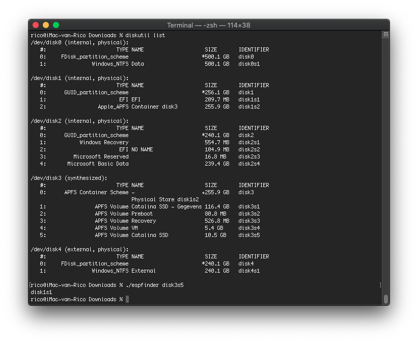

vector sigma Posted July 24, 2019 Share Posted July 24, 2019 Hi Guys, attached a command line called espfinder. The purpose is to find the associated EFI partition that belong to a target volume using the Clover package. Here actually works with or whitout apfs containers. CoreStorage isn't yet implemented but I'm confident that espfinder will give Us usefull informations about it, in fact this beta version make a dump at ~/Desktop/espfinder.plist. Usage: findesp disk2s4 (whole disks like disk0, disk2 etc. are not allowed) @ricoc90, @Cyberdevs please, I need the dump from both of you. To All, please confirm you can find the ESP from regular disks (whith apfs containers or other fs). Thanks in advance P.S. would be cool to have a dump from a RAID set up as well... espfinder_0.1_beta.zip Link to comment https://www.insanelymac.com/forum/topic/284656-clover-general-discussion/page/783/#findComment-2682755 Share on other sites More sharing options...

vector sigma Posted July 24, 2019 Share Posted July 24, 2019 (edited) On 7/20/2019 at 3:17 PM, Sherlocks said: @vector sigma latest clover vboxhfs default check was removed. is it right? to work hfs, we have been use vboxhfs or hfsplus like current ApfsDriverLoader.efi in latest clover package. old clover package vboxhfs default check. and script check if user have hfsplus.efi, then if have it, vboxhfs installation have been ignore. with this log in install log "Removing drivers64UEFI/VBoxHfs-64.efi driver because HFSPlus driver present" @Sherlocks removing the conflictual hfs driver works as intended. : #!/bin/bash #echo "DEBUG: $ 1 = Full path to the installation package the installer app is processing: " $1 #echo "DEBUG: $ 2 = Full path to the installation destination: " $2 #echo "DEBUG: $ 3 = Installation volume (mountpoint) to receive the payload: " $3 #echo "DEBUG: $ 4 = Root directory for the system: " $4 echo "preinstall: Path to installer....... $1" echo "preinstall: Path to destination..... $2" echo "preinstall: Path to dest volume..... $3" echo "preinstall: Root of system folder... $4" ############################################################################# DEST_VOL="${3}" EFI_ROOT_DIR=$(cd "${DEST_VOL}"/EFIROOTDIR; pwd -P) install_log="${DEST_VOL}/Clover_Install_Log.txt" driver_dir="UEFI" driver_name="HFSPlus.efi" if [[ -d "$EFI_ROOT_DIR/EFI/CLOVER/drivers/$driver_dir" ]]; then cd "$EFI_ROOT_DIR/EFI/CLOVER/drivers/$driver_dir" if [[ $driver_name == VBoxHfs.efi ]]; then for driver in *.efi do low=$(echo $driver | tr '[:upper:]' '[:lower:]') if [[ $driver != $driver_name ]] && [[ "$low" == *hfsplus* || "$low" == *grubhfs* ]]; then echo "Removing ${driver_dir}/${driver} because $driver_name is installed!" >> "$install_log" rm -f $driver fi done elif [[ $driver_name == HFSPlus.efi ]]; then for driver in *.efi do low=$(echo $driver | tr '[:upper:]' '[:lower:]') if [[ $driver != $driver_name ]] && [[ "$low" == *boxhfs* || "$low" == *grubhfs* ]]; then echo "Removing ${driver_dir}/${driver} because $driver_name is installed!" >> "$install_log" rm -f $driver fi done elif [[ $driver_name == ApfsDriverLoader.efi ]]; then for driver in *.efi do low=$(echo $driver | tr '[:upper:]' '[:lower:]') if [[ $driver != $driver_name && "$low" == apfs.efi ]]; then echo "Removing ${driver_dir}/${driver} because $driver_name is installed!" >> "$install_log" rm -f $driver fi done fi fi You can see bugs? Consider that the above is a Post install script and this operation is only performed if you install a file system driver, i.e. HFSPlus in this case. On 7/20/2019 at 3:17 PM, Sherlocks said: r5027. i removed /Library/Preferences/com.projectosx.clover.installer.plist file. the i capture this default drivers. what for person like me that really doesn't have any hfs partition? . Anyway I'm not alone... so the the simplest and fastest solution is to remove VBoxHfs.efi from the package when HFSPlus.efi is present w/o messing with infinite statement in the Distribution file. 2 hours ago, Slice said: One drive with several partitions HFS+ You succeded finding the ESP? Edited July 24, 2019 by vector sigma 1 Link to comment https://www.insanelymac.com/forum/topic/284656-clover-general-discussion/page/783/#findComment-2682758 Share on other sites More sharing options...
Guest ricoc90 Posted July 24, 2019 Share Posted July 24, 2019 32 minutes ago, vector sigma said: @ricoc90, @Cyberdevs please, I need the dump from both of you. To All, please confirm you can find the ESP from regular disks (whith apfs containers or other fs). Thanks in advance Here you go for fusion drive: espfinder.plist.zip On my regular system it does find the ESP as it should: Link to comment https://www.insanelymac.com/forum/topic/284656-clover-general-discussion/page/783/#findComment-2682761 Share on other sites More sharing options...
vector sigma Posted July 24, 2019 Share Posted July 24, 2019 2 hours ago, ricoc90 said: On my regular system it does find the ESP as it should: Good! Link to comment https://www.insanelymac.com/forum/topic/284656-clover-general-discussion/page/783/#findComment-2682773 Share on other sites More sharing options...
