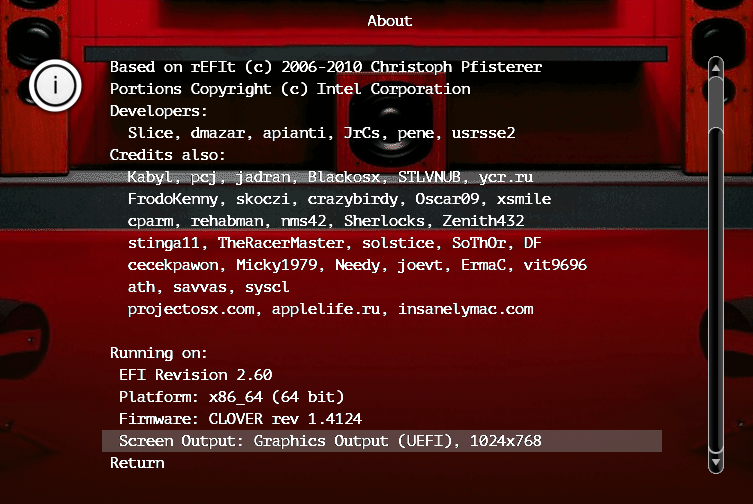

Thanks but I solved my problem in another way, I injected EDID and checked PatchVBios and now I have full hd resolution at boot.
I have another problem but I don't think it's the right thread for it: The Built-in Display is detected as Projector.
I have never been able to get full resolution at boot no matter what I do. I tried injecting EDID and PatchVBios but it doesn’t work. I tried putting the Video ROM in the correct folder but that does nothing.

You can use Darwin Dumper to extract the EDID. One of the best tools I've ever used.
For as far as I know, Clover already detects and injects EDID by default. I could be wrong though...
But anyway, you do have the option to use your own, if you so desire. And Darwin Dumper is, in my opinion, the easiest way to get it on MacOS.
By the way, if the card in your signature is the one you want to use for this case, there might be another way to do it:
1. UEFI GOP VBIOS (if you don't already have it). Basically the video card's ROM (you can request it on manufacturer's forums, usually). You can check if you already have a "UEFI" ROM using GPU-Z on Windows (I'm not aware of a Mac tool that can do that, but there probably are).
2. Disable Windows CSM (Compatibility Support Module) in BIOS. You don't need it, unless you're planning on putting XP on that machine. Which... I don't know why would anyone want to do, but yeah, for newer versions of Windows, you certainly don't need it.
That should bring you full native resolution in preboot.

Even if you already know how to use Clover to set big resolution your nvidia card is limited to this list
static TABLE_0 nvda_res[RESOLUTIONS_NUMBER] = {
  {1280,  720},
  {1280,  800},
  {1360,  768},
  {1400, 1050},
  {1440,  900},
  {1600,  900},
  {1600, 1200},
  {1680, 1050},
  {1920, 1080},
  {1920, 1200},
  {2048, 1536}
Sorry, PatchVBios for Nvidia limited to this list.
