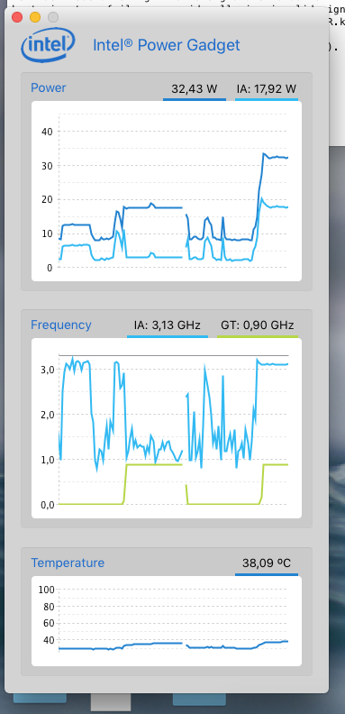

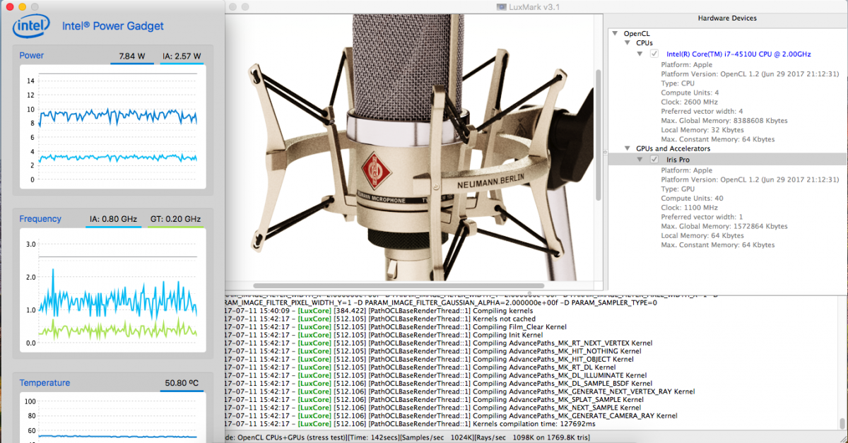

The test is LuzMark 0.3.1 which is able to load only GPU (centre) or GPU + CPU (right end of graphic).
Is this normal?
