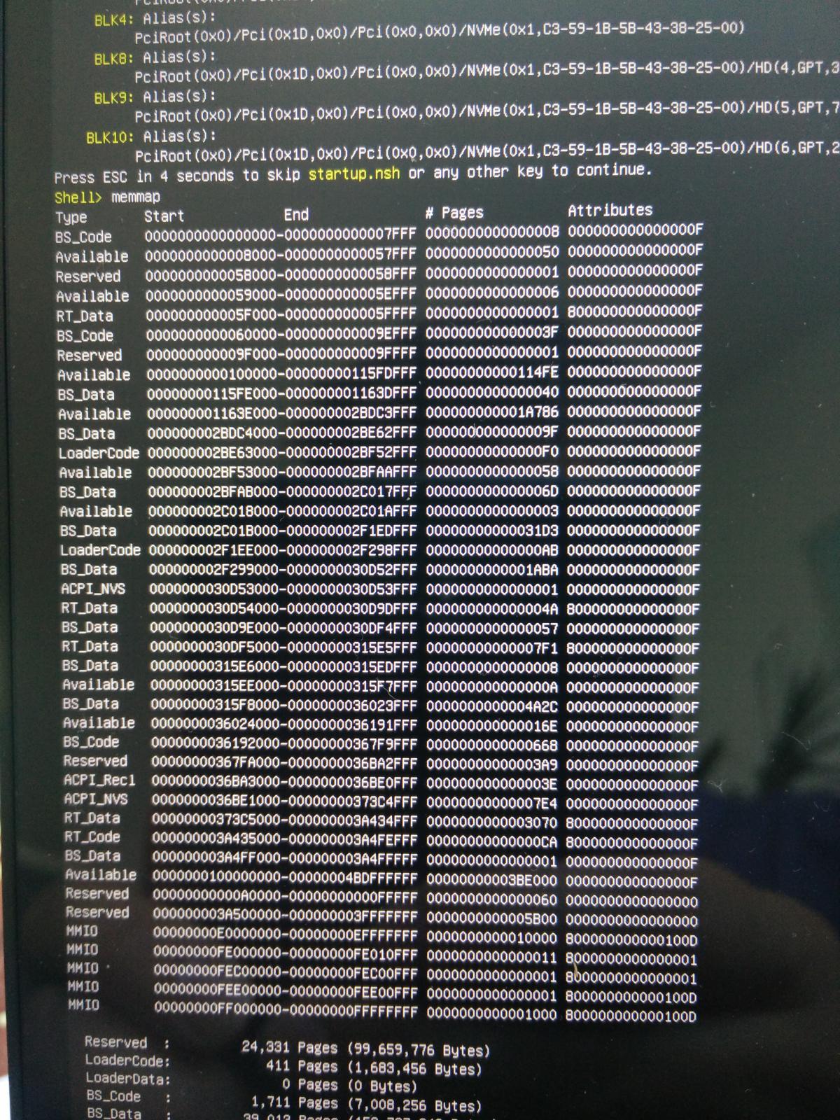

Well, that makes very little sense. There are two problems I see in both, there appears to be some weird page count computation error, and looks like an allocation is being made inside the region that needs allocated. Seems that printing out the memmap when this error happens would be more useful since maybe also other stuff changed.... Damn. Anyway here's the current issue:
As you can see for AptioFix, the relocation block appears to be cut off by a driver, or maybe even clover itself. What's really weird is that the region it wants is completely available according to your memmap, I have a feeling that there must be another allocation here between these two not seen when your memmap was captured.
Requested mem: 5D9C000 - 17701FFF, Pages: 11966, Size: 11966000
Reloc block: 17020000 - 2C97AFFF, Pages: 1595B, Size: 1595B000
Available 000000000EDE4000-000000002C941FFF 000000000001DB5E 000000000000000F
LoaderCode 000000002C942000-000000002CADCFFF 000000000000019B 000000000000000F
Then AptioFix2,
Error allocating 0x275 pages at 0x0000000000ed28000 alloc type 2
Available  0000000000100000-000000000EDA3FFF 000000000000ECA4 000000000000000F
BS_Data    000000000EDA4000-000000000EDE3FFF 0000000000000040 000000000000000F
So, first, I think that there needs to be a better method of determining if the allocation will fail, I think it has to do with the page computation method(s). There's something weird going on there.
Second, and I think this is probably the big thing, need to probably prevent boot time allocations from happening in lower memory where the kernel/device-tree/runtime/etc is going to try to be allocated. This can be easily achieved by hooking the memory allocation functions and modifying boot time allocations to be made above 4GB. Although I'm not sure if this is entirely possible/would not break stuff, but I also don't see why it would since all code should, in theory, be 64bit. Hmmmmmm....

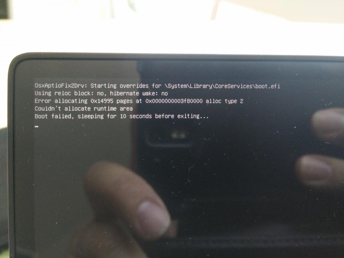

I calculate my slide parameter and add it to clover config, but during boot clover tries to allocate memory in a different location OR the slide parameter now points to a different page than my calculation.
I cannot boot up without free200 variant, but I currently suspect this variant of AF of interfering with my iGPU (if that is possible) since it has become unstable under load, for example in FCPX or compressor using iGPU.

AptioFix changes to slide=0. Don't use any boot fix except the ones that are with clover, those other fixes literally just destroy memory to make the space needed. Did you try both AptioFix and AptioFix2? If so, please show the image of screen where it fails to boot for both. Memory maps would be good too.
This is the memmap:
This is the error with slide=138 when booting with AptioFix264 on latest release of Clover:

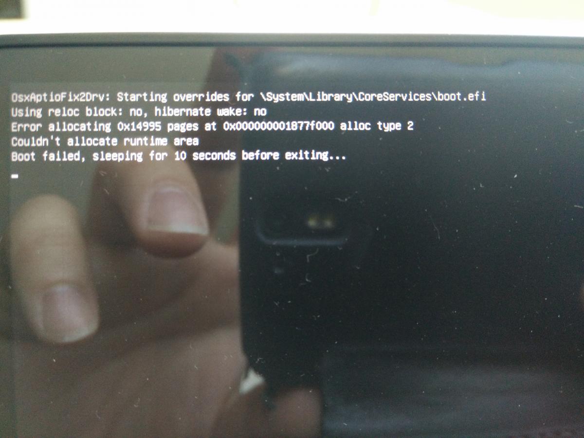

Without any configured slide value it tries to allocate 0x14495 pages and fails
I had to switch to AptioFix2 due to a new BIOS for my Notebook, which apparently requires the use of v2

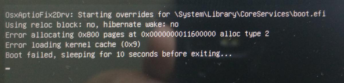

Oh wait you set slide so it will use that, also that is the correct place where the slide is, slide=138 is 0x100000 + (0x200000 * 138) = 0x11500000. Then kernel is loaded address + 0x100000. I think you want slide=139. That being said you have plenty of space at slide=0. I can't tell you where on earth is the best place to allocate, I would probably just remove slide argument and let it pick.
That is what I tried initially and didn't work, also why I decided to post this in this dev oriented thread - because I do hope I don't come across like just seeking support.
Here's the result with no slide argument and having Clover pick a page by itself:
Here's the result with slide=0 for trial:

Nothing to do with dart=0. You don't have enough free pages at slide=0 for that big of allocation. You may not have them at this point in the boot at all below 4GB barrier. It's hard to say what is the result with AptioFix instead of AF2?
