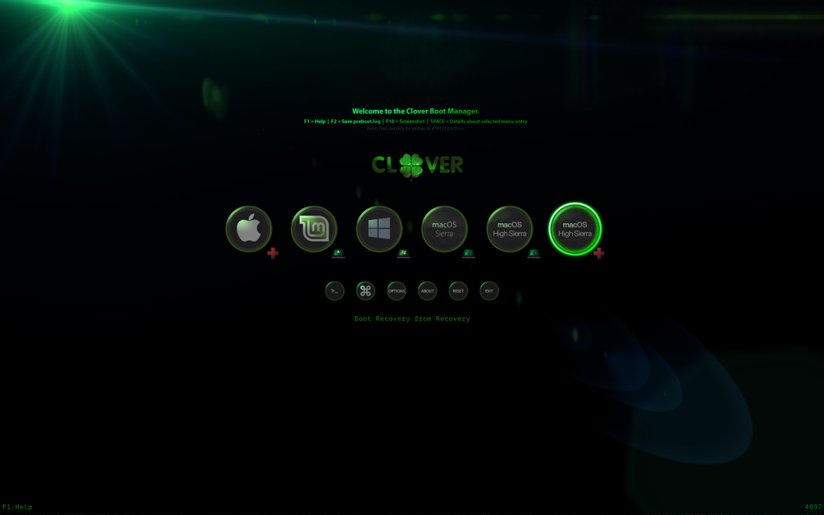

Well the one recovery is for the SierraSSD volume, and another for HiSierraHDD, the one you want is the recovery for whatever you installed in the APFS container, High Sierra? I don't think that they have the same UUIDs, it's probably a bug in configurator. What is the output of these commands
diskutil info disk0s3
diskutil info disk0s4
diskutil info disk3s2
diskutil info disk3s3
EDIT: Actually forgot for the APFS you will want the preboot not recovery.

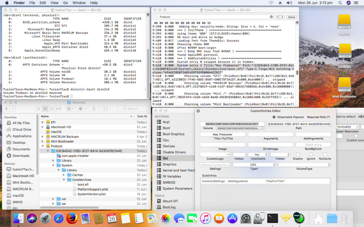

Yeah there's a problem with configurator, probably because of APFS or something. But here are the UUIDs:
Recovery HD:   disk0s3 6C5331E7-AF77-4D12-AB6C-5BCF1AC6EDE4
APFS Preboot:  disk3s2 3FD03752-1484-44BB-A298-DD20545A42DB
APFS Recovery: disk3s3 D9E47E9F-586E-4981-A4F0-95855B0B59DF
Use that method to get the proper UUIDs until configurator retrieves them correctly.

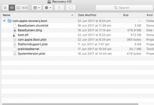

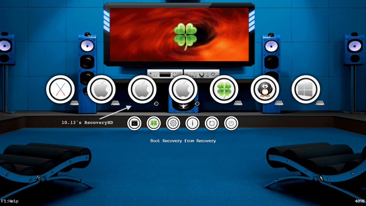

Your Clover Main Menu and output from “diskutil list”, correctly shows 3 Recovery Partitions (note the 3 Red Cross icons  :)) -
disk0s3 (for SierraSSD), disk1s3 (for HiSierraHDD) and disk3s3 (for HiSierraSSD).

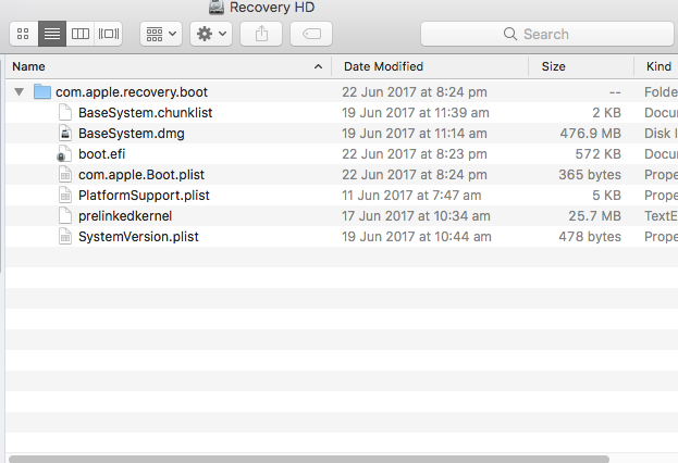

However a standard Recovery Partition should only have 1 boot.efi located in com.apple.recovery.boot …
I suspect the recovery partition for your HiSierraHDD probably has an additional boot.efi file in another folder, related to your encrypted initial High Sierra DP1 install.
In terminal, mount disk1s3, then open the volume in Finder to see its contents:
diskutil mount disk1s3
If necessary, show any hidden folders/files with the attached “ShowAllFiles.app”.  You can delete or rename any "extra" boot.efi to something else eg "boot.efi_disabled" and hopefully this will remove the extra entry on your next reboot  :).

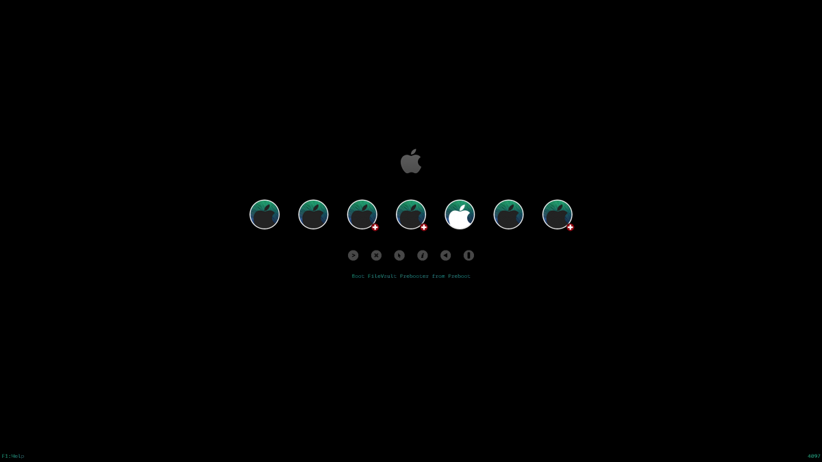

This is my Clover Main Menu...
Pressing F3 at the main menu unhides the previously hidden Recovery Partitions...
Note - I hide the Preboot partition using its UUID:

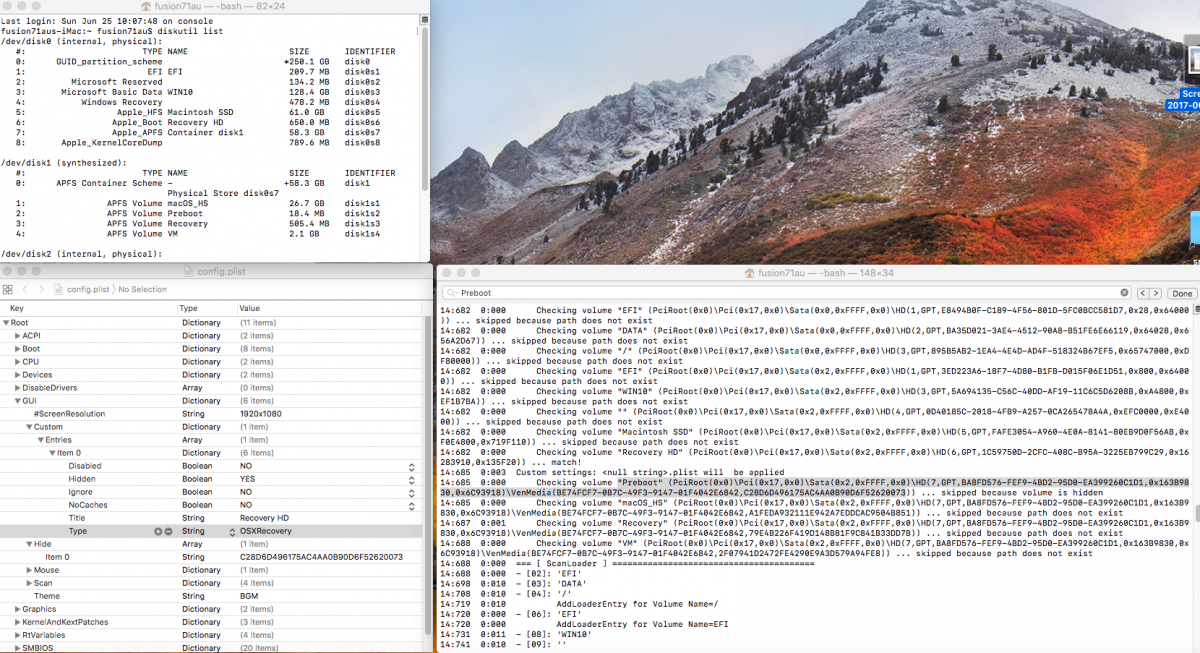

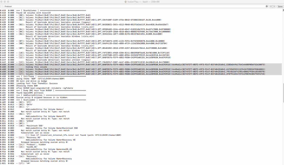

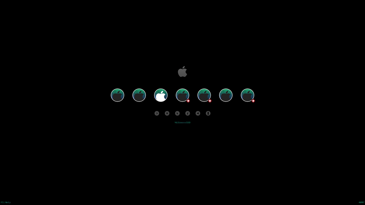

Looking at my bdmesg/boot log in the first screenshot, the UUID is C28D6D496175AC4AA0B90D6F52620073 (will be different on your system)...
so in config.plist/GUI, I also have
<key>Hide</key>
<array>
  <string>C28D6D496175AC4AA0B90D6F52620073</string>
</array>
Entries in this section remain hidden, even after pressing F3 at the Clover Boot Main Menu.

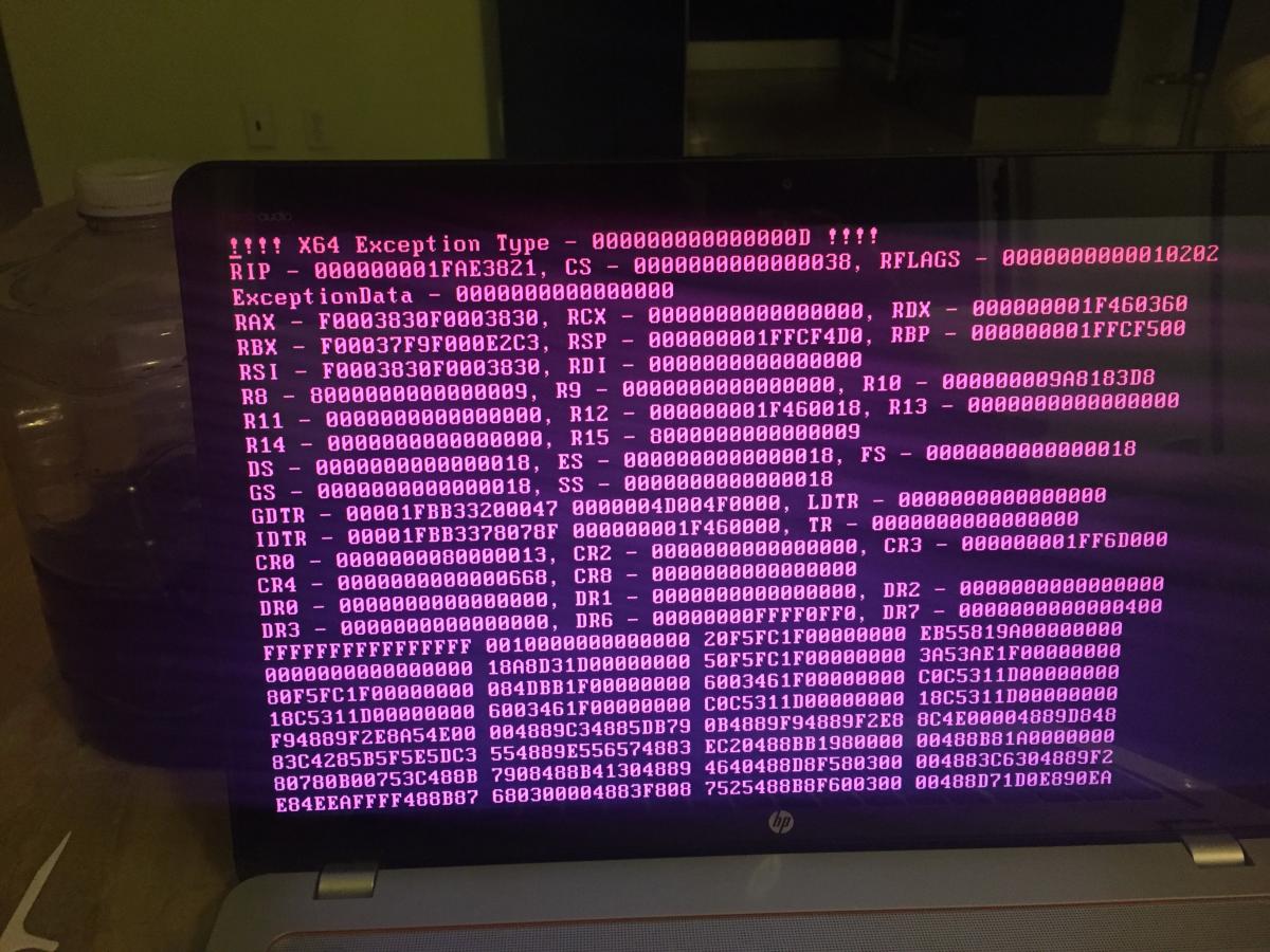

What does this mean?
It started happening with version 4097.  I tried earlier versions and same problem.  I reformatted my EFI partition and same problem.  Nothing I can think of will stop this.  Clover gets to the Clover menu but once I select a partition to boot, any partition, nothing happens and then I get this.  I can still boot from a USB flash drive I have or I wouldn't be posting this.  Any help would be greatly appreciated.

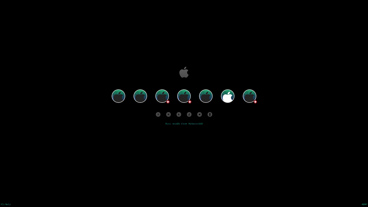

Which one should I use? The Preboot one?

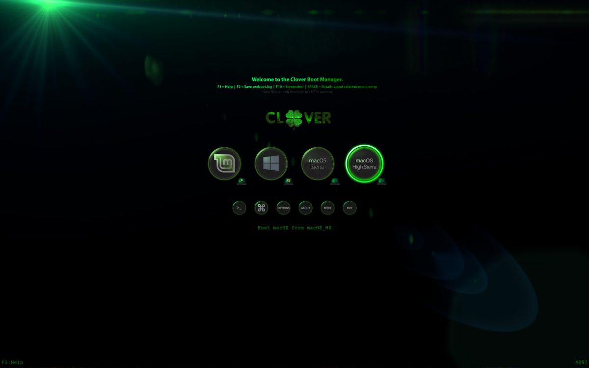

None of the UUIDs above is the one displayed when pressing spacebar on Clover GUI for the APFS volume.
This is what I have in Clover GUI.
I used the same method (UUID from spacebar) for all OSes. Renamed 2 of them with no issues. Why is it Clover Configurator's fault that the same exact syntax doesn't work for APFS FV2 drive? :)) It's the same syntax for all of them. Only the UUID and the FullTitle are different. And the UUID for the APFS volume was not taken with CC in any way. So, I don't see how that could be a detection problem on CC's side. It's not even loaded when Clover starts.
This is what I use for the regular FV2 HFS+ drive. And it works. Just took the UUID from CLOVER GUI, added it into the config, and there you go. Everything ok.
SierraSSD is a HFS+ drive with FileVault. And now it's displayed as SierraSSD in Clover GUI.

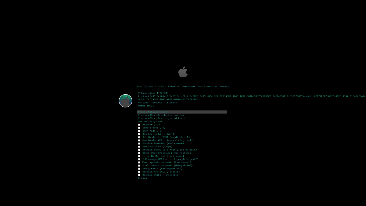

Now, the same exact syntax, only different UUID is used for the APFS FV encrypted partition. The one displayed as "Boot FileVault Preeboter from Preboot". So, since it's from Preboot, I suppose I need the Preboot UUID, right?
So, neither the UUID displayed on spacebar or the one from diskutil info are working.
So, assuming the information displayed in Clover GUI is not correct (though the same method worked for the other two volumes), I thought I would need to add the UUID of the Preboot volume, right? Which, apparently is not the one displayed in Clover GUI (on spacebar).

So, the only things that changed (and this has been edited on the config directly, no CC involved) is the UUID and the FullTitle, right?
The only issue is that it doesn't work. The drive's name (the one I use to boot into HiSierraSSD), is still "Boot FileVault Preeboter from Preboot".
What am I missing here...? :))

@arsradu,
Can you show your Clover boot log ie what is the output of running the bdmesg command in terminal? Also can you show the GUI section of your config.plist?
Eg for my system
Vol 14=Preboot
Vol 15=macOS_HS
Vol 16=Recovery
Vol 17=VM
Notice the UUID I get from the Clover Menu for all 4 APFS volumes is the same: BA8FD576-FEF9-4BD2-95D0-EA399260C1D1
The unique UUID for Vol 14=Preboot on my system is the last one in the VenMedia section ie C28D6D496175AC4AA0B90D6F52620073.
My High Sierra Volume is not encrypted so boot.efi is located on the actual volume (/System/Library/CoreServices/boot.efi in macOS_HS). For FileVault encrypted installs, I'm assuming this boot.efi is located in the Preboot volume instead.

Sure, here's my bdmesg.
Last login: Sun Jun 25 15:17:33 on ttys000
192-168-0-103:~ jimmy$ bdmesg

0:762  0:001  === [ ScanVolumes ] =======================================
0:762  0:000  Found 20 volumes with blockIO
0:762  0:000  - [00]: Volume: PciRoot(0x0)\Pci(0x1F,0x2)\Sata(0x0,0xFFFF,0x0)
0:784  0:022  - [01]: Volume: PciRoot(0x0)\Pci(0x1F,0x2)\Sata(0x1,0xFFFF,0x0)
0:784  0:000          Found optical drive
0:784  0:000  - [02]: Volume: PciRoot(0x0)\Pci(0x1F,0x2)\Sata(0x2,0xFFFF,0x0)
0:785  0:001  - [03]: Volume: PciRoot(0x0)\Pci(0x1F,0x2)\Sata(0x3,0xFFFF,0x0)
0:786  0:000          Result of bootcode detection: bootable unknown (legacy)
0:786  0:000  - [04]: Volume: PciRoot(0x0)\Pci(0x1F,0x2)\Sata(0x0,0xFFFF,0x0)\HD(1,GPT,F5EE06E3-E943-412D-AC4B-44158E2A3195,0x28,0x64000)
0:807  0:020          This is SelfVolume !!
0:807  0:000  - [05]: Volume: PciRoot(0x0)\Pci(0x1F,0x2)\Sata(0x0,0xFFFF,0x0)\HD(2,GPT,38C6C1AE-2E2C-4FF8-8D72-9AC89395A11A,0x64028,0x4A6BE340)
0:807  0:000  - [06]: Volume: PciRoot(0x0)\Pci(0x1F,0x2)\Sata(0x0,0xFFFF,0x0)\HD(3,GPT,D81935A0-CEC7-4AB4-834F-8572B93C1D72,0x4A722368,0x135F20)
0:837  0:030  - [07]: Volume: PciRoot(0x0)\Pci(0x1F,0x2)\Sata(0x2,0xFFFF,0x0)\HD(1,GPT,CFF624F8-C0C3-4448-A8A4-62A66193376C,0x28,0x64000)
0:838  0:000          Result of bootcode detection: bootable unknown (legacy)
0:843  0:004  - [08]: Volume: PciRoot(0x0)\Pci(0x1F,0x2)\Sata(0x2,0xFFFF,0x0)\HD(2,GPT,0F773801-80BD-45F5-8F2F-C45790E3B5FB,0x64028,0xE906A10)
0:843  0:000          Result of bootcode detection: bootable unknown (legacy)
0:843  0:000  - [09]: Volume: PciRoot(0x0)\Pci(0x1F,0x2)\Sata(0x2,0xFFFF,0x0)\HD(3,GPT,6C5331E7-AF77-4D12-AB6C-5BCF1AC6EDE4,0xE96AA38,0x135F20)
0:844  0:000  - [10]: Volume: PciRoot(0x0)\Pci(0x1F,0x2)\Sata(0x2,0xFFFF,0x0)\HD(4,GPT,DCD35DBA-904C-4F0A-801D-1037CADFD0CB,0xEAA0958,0xE5EC7F0)
0:844  0:000          Result of bootcode detection: bootable unknown (legacy)
0:844  0:000  - [11]: Volume: PciRoot(0x0)\Pci(0x1F,0x2)\Sata(0x2,0xFFFF,0x0)\HD(5,GPT,DB0968EA-61E0-45D8-ADE3-FFE6F8ABE9EA,0x1D08D148,0x138800)
0:845  0:000  - [12]: Volume: PciRoot(0x0)\Pci(0x1F,0x2)\Sata(0x3,0xFFFF,0x0)\HD(1,GPT,4B8588D0-6E43-4B29-A475-0B1254F46C4A,0x28,0x64000)
0:846  0:000          Result of bootcode detection: bootable unknown (legacy)
0:872  0:026  - [13]: Volume: PciRoot(0x0)\Pci(0x1F,0x2)\Sata(0x3,0xFFFF,0x0)\HD(2,GPT,1A2217AC-33B4-42D0-8D17-920E9FA99621,0x6C800,0x4BFD8A58)
0:873  0:000  - [14]: Volume: PciRoot(0x0)\Pci(0x1F,0x2)\Sata(0x3,0xFFFF,0x0)\HD(3,GPT,0100BFD5-1EBF-4711-B9B2-33F00C91280D,0x4C085258,0x18EDDA8)
0:873  0:000  - [15]: Volume: PciRoot(0x0)\Pci(0x1F,0x2)\Sata(0x3,0xFFFF,0x0)\HD(4,GPT,6E01D029-3175-43E1-9390-8D208CDAA12D,0x4D9B3000,0x26D53800)
0:874  0:000  - [16]: Volume: PciRoot(0x0)\Pci(0x1F,0x2)\Sata(0x2,0xFFFF,0x0)\HD(4,GPT,DCD35DBA-904C-4F0A-801D-1037CADFD0CB,0xEAA0958,0xE5EC7F0)\VenMedia(BE74FCF7-0B7C-49F3-9147-01F4042E6842,5237D03F8414BB44A298DD20545A42DB)
0:874  0:000  - [17]: Volume: PciRoot(0x0)\Pci(0x1F,0x2)\Sata(0x2,0xFFFF,0x0)\HD(4,GPT,DCD35DBA-904C-4F0A-801D-1037CADFD0CB,0xEAA0958,0xE5EC7F0)\VenMedia(BE74FCF7-0B7C-49F3-9147-01F4042E6842,D88DC35029E2E930A5B91EF623E60C8A)
0:874  0:000  - [18]: Volume: PciRoot(0x0)\Pci(0x1F,0x2)\Sata(0x2,0xFFFF,0x0)\HD(4,GPT,DCD35DBA-904C-4F0A-801D-1037CADFD0CB,0xEAA0958,0xE5EC7F0)\VenMedia(BE74FCF7-0B7C-49F3-9147-01F4042E6842,9F7EE4D96E588149A4F095855B0B59DF)
0:874  0:000  - [19]: Volume: PciRoot(0x0)\Pci(0x1F,0x2)\Sata(0x2,0xFFFF,0x0)\HD(4,GPT,DCD35DBA-904C-4F0A-801D-1037CADFD0CB,0xEAA0958,0xE5EC7F0)\VenMedia(BE74FCF7-0B7C-49F3-9147-01F4042E6842,FBBB5C655D03A5408555A20AA841031B)
0:874  0:000  === [ InitTheme ] =========================================
0:875  0:001  Using theme 'lightup' (EFI\CLOVER\themes\lightup)
0:875  0:000  OS main and drive as badge
0:879  0:003  Loading font from ThemeDir: Success
0:880  0:000  Choosing theme lightup
0:880  0:000  after NVRAM boot-args=-alcbeta -lilubeta
0:880  0:000  === [ Dump SMC keys from NVRAM ] ==========================
0:880  0:000  found AppleSMC protocol
0:899  0:019  === [ ScanLoader ] ========================================
0:899  0:000  - [04]: 'EFI'
0:899  0:000  - [05]: 'HiSierraHDD'
0:952  0:053          AddLoaderEntry for Volume Name=HiSierraHDD
0:978  0:025      Check if volume Is Hibernated:
0:978  0:000      Check sleep image 'by signature':
1:032  0:053      read prefs \Library\Preferences\com.apple.PowerManagement.plist status=Success
1:032  0:000      using default sleep image name = \private\var\vm\sleepimage
1:052  0:019      no valid sleep image offset was found
1:052  0:000       sleepimage offset could not be acquired
1:052  0:000      hibernated: no - sign
1:072  0:020  not png, try icns
1:073  0:000  not png, try icns
1:073  0:000  - [06]: 'Recovery HD'
1:110  0:036          AddLoaderEntry for Volume Name=Recovery HD
1:152  0:042  not png, try icns
1:152  0:000  not png, try icns
1:153  0:000  - [07]: 'EFI'
1:153  0:000  - [09]: 'Recovery HD'
1:155  0:002          AddLoaderEntry for Volume Name=Recovery HD
1:156  0:000      Check if volume Is Hibernated:
1:156  0:000      Check sleep image 'by signature':
1:156  0:000      using default sleep image name = \private\var\vm\sleepimage
1:156  0:000      sleepimage not found -> Not Found
1:156  0:000      hibernated: no - sign
1:157  0:000  not png, try icns
1:157  0:000          AddLoaderEntry for Volume Name=Recovery HD
1:158  0:001  not png, try icns
1:159  0:000  - [12]: 'EFI'
1:159  0:000  - [13]: 'Storage'
1:159  0:000  - [14]: 'Stuff'
1:159  0:000  - [15]: 'Tools'
1:159  0:000  - [16]: 'Preboot'
1:161  0:002          AddLoaderEntry for Volume Name=Preboot
1:164  0:002      Check if volume Is Hibernated:
1:164  0:000      Check sleep image 'by signature':
1:164  0:000      using default sleep image name = \private\var\vm\sleepimage
1:164  0:000      sleepimage not found -> Not Found
1:164  0:000      hibernated: no - sign
1:164  0:000  not png, try icns
1:166  0:001  - [17]: 'HiSerraSSD'
1:166  0:000  - [18]: 'Recovery'
1:167  0:001          AddLoaderEntry for Volume Name=Recovery
1:169  0:001  not png, try icns
1:170  0:001  - [19]: 'VM'
1:170  0:000  === [ AddCustomTool ] =====================================
1:178  0:007  found tool \EFI\CLOVER\tools\Shell64U.efi
1:178  0:000  Checking EFI partition Volume 4 for Clover
1:178  0:000   Found Clover
1:182  0:003  === [ GetEfiBootDeviceFromNvram ] =========================
1:182  0:000   - efi-boot-device-data: PciRoot(0x0)\Pci(0x1F,0x2)\Sata(0x2,0xFFFF,0x0)\HD(4,GPT,DCD35DBA-904C-4F0A-801D-1037CADFD0CB,0xEAA0958,0xE5EC7F0)\VenMedia(BE74FCF7-0B7C-49F3-9147-01F4042E6842,5237D03F8414BB44A298DD20545A42DB)
1:182  0:000    - Volume: 'PciRoot(0x0)\Pci(0x1F,0x2)\Sata(0x2,0xFFFF,0x0)\HD(4,GPT,DCD35DBA-904C-4F0A-801D-1037CADFD0CB,0xEAA0958,0xE5EC7F0)\VenMedia(BE74FCF7-0B7C-49F3-9147-01F4042E6842,5237D03F8414BB44A298DD20545A42DB)'
1:182  0:000    - LoaderPath: '<null string>'
1:182  0:000    - Guid = DCD35DBA-904C-4F0A-801D-1037CADFD0CB
1:182  0:000  === [ FindStartupDiskVolume ] =============================
1:182  0:000    - Volume: partition = PciRoot(0x0)\Pci(0x1F,0x2)\Sata(0x2,0xFFFF,0x0)\HD(4,GPT,DCD35DBA-904C-4F0A-801D-1037CADFD0CB,0xEAA0958,0xE5EC7F0)\VenMedia(BE74FCF7-0B7C-49F3-9147-01F4042E6842,5237D03F8414BB44A298DD20545A42DB)
1:182  0:000     - searching for that partition
1:182  0:000      - found entry 4. 'Boot FileVault Prebooter from Preboot', Volume 'Preboot'
1:182  0:000  Boot redirected to Entry 4. 'Boot FileVault Prebooter from Preboot'
1:182  0:000  DefaultIndex=4 and MainMenu.EntryCount=12
1:244  0:062  GUI ready

7:661  0:011  SetStartupDiskVolume:
7:661  0:000    * Volume: 'Preboot'
7:661  0:000    * LoaderPath: '<null string>'
7:661  0:000    * DevPath: Preboot
7:661  0:000    * GUID = DCD35DBA-904C-4F0A-801D-1037CADFD0CB
7:662  0:000    * efi-boot-device: <array><dict><key>IOMatch</key><dict><key>IOProviderClass</key><string>IOMedia</string><key>IOPropertyMatch</key><dict><key>UUID</key><string>DCD35DBA-904C-4F0A-801D-1037CADFD0CB</string></dict></dict></dict></array>
7:662  0:000  Custom boot is disabled

  • Use diskutil list to list your disks and partitions
  • Use "diskutil mount diskxsy" to mount the Preboot Volume (x=disk number of APFS synthesized disk, y=Preboot partition number)
  • Use the "Go" menu in Finder to navigate to /Volumes and determine the unique folder name in the Preboot Volume
  • Use CC to modify the Custom Entry to point to boot.efi (in my case, \E3C94042-178D-3F27-8414-5A3D0FB21445\System\Library\CoreServices\boot.efi, will be different for you)
I understand I need to use the last part... In my case 5237D03F8414BB44A298DD20545A42DB.
Ok. But still, right now I'm not trying to hide the volume. I'm trying to rename it. And using the string above as OSX Custom Entry, replacing the one in my previous post (this 3FD03752-1484-44BB-A298-DD20545A42DB with this 5237D03F8414BB44A298DD20545A42DB), does nothing.
I understand your trying to rename, using the method above I was able to hide my preboot volume so instead of hide you just rename. Was only posting as reference to hopefully help.

@arsradu,
Can you also show the GUI section from your config.plist?  Maybe try removing the "scan" section and only relying on custom entries?
Should now be included. :) I edited my post earlier.
Sent from my SM-G930F using Tapatalk
Yep, that was very useful information. :) Thank you! However, I think that the fact that my APFS drive is also encrypted with FileVault...makes all the difference. And now I'm trying to decrypt it to see if it works, and the Turn Off FileVault is greyed out... And yes, even after unlocking that section. Anyway, that's another topic.

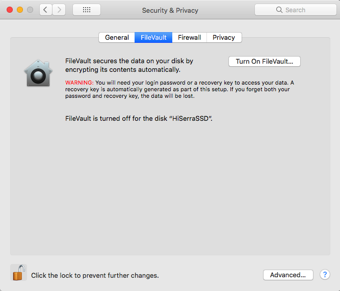

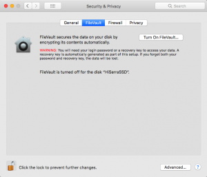

I managed to disable FileVault from command line. I'm still waiting for it to complete, but I guess we'll see after that if it makes a difference or not.
To disable FileVault from Terminal, use this (for anyone interested, in case you're stuck with greyed out "Turn Off FileVault" button like I was.)
sudo fdesetup disable
I actually, have similar question as @Arsadu. Fyi I'm using Single GPT Disk (SATA), on my case:
~ I've installed 10.13 Beta 1 using Core.pkg on HFS+ Partition w/o including "macOSUpd10.13.RecoveryHDUpdate.pkg"
~ I then converted it to APFS using DiskUtility.app within macOS USB Installer
~ First reboot with APFS took long time entering Desktop for unknown reason, but I figured out there was a new @615MB Partition named "Recovery" (w/o ~HD) under macOS 10.13. Second reboot, It appeared on Clover boot screen, but I couldn't boot into it.
~ I updated to 10.13 Beta 2 with including "macOSUpd10.13.RecoveryHDUpdate.pkg" (finally failed though) and then I get another new partition named "RecoveryHD".
~ So now, I have 2 Recovery Partitions and both are bootable 10.13 volumes. I think need to hide one of them within Clover's GUI.

Well, I'm not sure it's the same thing here. Mine was a FileVault entry point for the encrypted partition which wasn't encrypted anymore after reinstall. :)
For hiding Recovery partitions though, see if fusion71au's post here can help. I didn't get the chance to use it since, in the meantime, I wiped the entire HDD (I only use it for High Sierra HDD testing, so I didn't actually lose anything) and reinstalled DP2 from scratch.
It's a general protection fault meaning that memory was accessed outside of what the memory map said was accessible memory.

You can just take any unique part of the identifier of the partition from your boot log and use that as the volume identifier, since it will compare with the whole device path string. It seems the last part of an APFS volume device path is the unique part. Unsure where those other UUIDs are from then and why on earth they wouldn't be directly used as the partition UUID when thats what they say they are in diskutil. I was saying the problem with CC is when CC is running, it can't correctly determine the UUIDs. It's obvious why, the APFS volumes don't have a consistent usage of them.
Try changing the type of the volume to OSXRecovery or Other.
@arsradu,
Can you show your Clover boot log ie what is the output of running the dmesg command in terminal?  Also can you show the GUI section of your config.plist?
Eg for my system
Vol 14=Preboot
Vol 15=macOS_HS
Vol 16=Recovery
Vol 17=VM
I think he has a different problem going on, you are right the unique part is the last section of the device path. I think he has a corrupted config.plist or something, as there is no custom entries scan taking place.

I don't see the AddCustomEntries section in your boot.log. It should come before the ScanLoader section. Please post your boot.log and config.plist as attachments.
@arsradu,
Your boot log confirms the unique UUID for the Preboot Volume is 5237D03F8414BB44A298DD20545A42DB.
but doesn't look like your custom entries are working (only autoscan by Clover)?
PS: I recommend you edit your config.plist with a plist editor like Xcode to avoid syntax errors....
Yeah there's something wrong. There is no custom entry scan.

I would probably remove the one that doesn't work and expand whatever OS partition you can. Or reinstall. But yeah hide the recovery with either GUI/Hide or GUI/Custom/Entries.
You should only disable filevault in recovery, lol.
@apanti
I tried setting that as OSXRecovery. No change.
I didn't find an option to disable FileVault from Recovery. :) I already tried. You can only unlock the volume, which doesn't help much. But I couldn't find an option to decrypt it permanently.
However, I managed to do that with the command above.
Which brings me to the next issue: 7 boot entries. Again. This time, the extra one is the "FileVault Prebooter". But there is no FileVault, so not sure what the hell is that doing there. And a regular boot for HiSierraSSD (unencrypted volume). Also, a dedicated recovery, just like before. ALL pointing to the same UUID.
post-1303722-0-42527900-1498405586_thumb.png post-1303722-0-09255100-1498405594_thumb.png
Anyway, boot.log and config.plist attached.
EDIT:
Ok, we can rule out CC from this. Why? Well, because it works perfectly fine on the non-encrypted disk. So it's not the fact that I'm editing the config with CC. I'm not defending it. I'm just saying this issue has nothing to do with that. I had the exact same issue when I edited it with Xcode, and even manually with Sublime.
Now, all I had to do was to point the unencrypted partition to the UUID displayed in Clover UI (on spacebar). Just like I did for the other partitions. And it works. So, it looks like the problem appears when using APFS with FileVault. FileVault on HFS works, HFS alone works, APFS alone works. But FileVault on APFS does not.
Maybe we're not pointing it in the right direction. Or maybe it needs something else. But these are my results so far. So I hope it helps.
bootlog.log.txt
config_test.plist.zip
