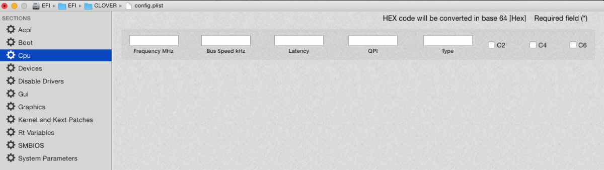

arsradu Posted November 8, 2014 Share Posted November 8, 2014 Guys, from a few versions now, I've got this weird issue with Clover. It seems like my hw memory and CPU frequency are not quite properly recognized. In About This Mac, it shows CPU clocked at 3.19 GHz instead of 3.2 GHz and the RAM on my GPU at 2047 MB instead of 2048 MB. Why is this? Though I agree that this is not a major issue or anything, this issue has been here for at least 3-4 versions of Clover and even though initially I thought that this is a bug somewhere in Clover, now I'm starting to think that maybe I did something that caused it. In case that makes any difference, I'm using official Nvidia drivers, checked nvda_drv=1 in config (though it works just as well without it) and unchecked anything related to Graphics Injection, since I don't need it. Still...if this had anything to do with the graphics, it still doesn't explain the issue with the CPU readings. So, does anyone know what causes this or how to fix it? Link to comment Share on other sites More sharing options...

arsradu Posted November 8, 2014 Share Posted November 8, 2014 Please post your boot.log so we can see what's going on, CPU speed being a little different probably is just a timing issue, maybe your CPU just lagged a little bit at beginning because of slightly different code generation during CPU detection. +-0.01 is not really that big of a deal... But the RAM should be detected correctly no matter what, not sure why it would randomly subtract 1 megabyte. Hello boot.log attached. And this thing is not random. It always displays -1MB on the RAM value and -10MHz (if my math is right) on the CPU frequency. As I said, this happened starting with an update to Clover...a few versions ago. boot.log.zip Link to comment Share on other sites More sharing options...
Maniac10 Posted November 8, 2014 Share Posted November 8, 2014 I see the same TSC "error" with my i7 2600k. It's overclocked through turbo multipliers, nothing else: 4:284 0:000 CPU Vendor = 756E6547 Model=206A7 4:284 0:000 The CPU supported turbo 4:284 0:000 BrandString = Intel(R) Core(TM) i7-2600K CPU @ 3.40GHz 4:284 0:000 MSR 0xE2 before patch 1E000403 4:284 0:000 MSR 0xE4 00020414 4:284 0:000 MSR 0xCE 00001000_70012200 4:284 0:000 non-usable FLEX_RATIO = F0000 4:284 0:000 corrected FLEX_RATIO = E0000 4:284 0:000 MSR 0x1B0 00000000 4:284 0:000 FSBFrequency=129MHz DMIvalue=100000kHz 4:284 0:000 Corrected FSBFrequency=100MHz 4:284 0:000 Vendor/Model/Stepping: 0x756E6547/0x2A/0x7 4:284 0:000 Family/ExtFamily: 0x6/0x0 4:284 0:000 MaxDiv/MinDiv: 34.0/16 4:284 0:000 Turbo: 44/44/45/45 4:284 0:000 Features: 0xBFEBFBFF 4:284 0:000 Threads: 8 4:284 0:000 Cores: 4 4:284 0:000 FSB: 100 MHz 4:284 0:000 CPU: 4400 MHz 4:284 0:000 TSC: 4400 MHz 4:284 0:000 PIS: 400 MHz 4:509 0:000 Calibrated TSC frequency =3410014023 =3410MHz 11:918 0:00 Finally: Bus=100294kHz CPU=3410MHz Link to comment Share on other sites More sharing options...
arsradu Posted November 8, 2014 Share Posted November 8, 2014 About your cpu speed, not sure what's up there's some weird stuff, like it says your TSC is running at 3400MHz. That's not really possible unless the firmware somehow misconfigured your CPU. I think maybe you did change some firmware settings. 0:749 0:000 FSBFrequency=106MHz DMIvalue=100000kHz 0:749 0:000 Corrected FSBFrequency=100MHz 0:749 0:000 Vendor/Model/Stepping: 0x756E6547/0x3C/0x3 0:749 0:000 Family/ExtFamily: 0x6/0x0 0:749 0:000 MaxDiv/MinDiv: 32.0/8 0:749 0:000 Turbo: 36/36/36/36 0:749 0:000 Features: 0xBFEBFBFF 0:749 0:000 Threads: 4 0:749 0:000 Cores: 4 0:749 0:000 FSB: 100 MHz 0:749 0:000 CPU: 3400 MHz 0:749 0:000 TSC: 3400 MHz 0:749 0:000 PIS: 400 MHz but 10:124 0:000 Finally: Bus=99768kHz CPU=3192MHz so my guess is you have also changed bus speed in your config.plist. 10:501 0:000 NVidia GFX injection not set Nothing is being done with your graphics, so what ever is happening is probably either because your cpu is slightly off or because something changed in the detection of the card in the kext drivers. I don't think I changed anything CPU related in Clover config... And I surely didn't change the Bus Speed... Also, as I said, this issue was not always there. Something changed. I just can't figure out what. Link to comment Share on other sites More sharing options...
arsradu Posted November 8, 2014 Share Posted November 8, 2014 Hmmm strange, can you revert back to your previous version of clover and see if the problem persists or is gone? I can... I just don't know how many versions do I have to go back. ) Maybe something around 2737.. or something? I don't even know where should I get that version. Since it doesn't seem to be on sourceforge. Update: I reinstalled 2747 on a memory stick. And...I got the same behavior, with or without the default config. I also tried using the default Yosemite video drivers instead of the Nvidia web drivers. Same thing. Also, I reset my UEFI settings to default optimized just for fun. Same result. So, there might be something else here... Link to comment Share on other sites More sharing options...

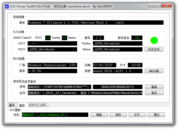

liujianwei Posted November 9, 2014 Share Posted November 9, 2014 I am experimenting with Clover's SLIC loading function and trying to load a Dell Server 2.2 SLIC to activate Server 2012 (for educational purposes only , I much prefer OSX). After placing SLIC.aml into EFI/Clover/ACPI/Windows and rebooting into Windows, I observed that SLIC version, Public Key and Marker were unchanged from my stock BIOS SLIC (Dell M09, ver 2.1) but the XSDT & RSDT are successfully changed to Dell PE_SC3: photo.JPG Activation cannot succeed until XSDT=RSDT=PubKey=Marker, then loading the corresponding SLIC certificate and key........ In my case use daz loader RSDT=PubKey=Maker is enough to activate Windows 7,no need XSDT.However After placing SLIC.aml into EFI/Clover/ACPI/Windows and rebooting into Windows, I observed that SLIC Dump ToolKit said SLIC doesn't exit. Seems like SLIC inject is not success.And my Clover in HFS+ can't log,in FAT32 clover won't boot,How to use clover activate Windows7? Link to comment Share on other sites More sharing options...
Philip Petev Posted November 9, 2014 Share Posted November 9, 2014 SLIC Dump ToolKit.png In my case use daz loader RSDT=PubKey=Maker is enough to activate Windows 7,no need XSDT.However After placing SLIC.aml into EFI/Clover/ACPI/Windows and rebooting into Windows, I observed that SLIC Dump ToolKit said SLIC doesn't exit. Seems like SLIC inject is not success.And my Clover in HFS+ can't log,in FAT32 clover won't boot,How to use clover activate Windows7? That happens, because the SLIC Dump Toolkit doesn't support Windows UEFI installs. Try anything else like AIDA64 and you'll see that the SLIC is actually there. Link to comment Share on other sites More sharing options...
