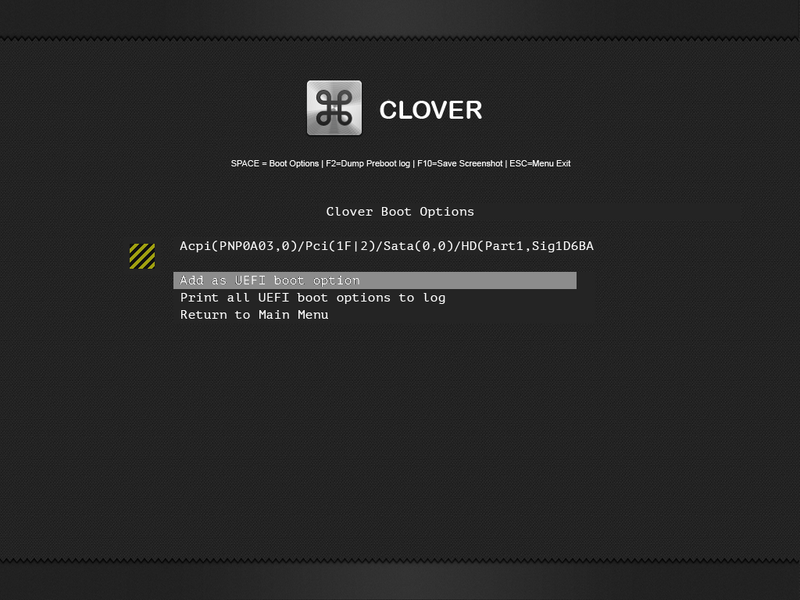

Mieze Posted December 29, 2013 Share Posted December 29, 2013 I've discovered a really strange issue with an Asrock B85M Pro4 board doing UEFI boot with Clover (r2403): I setup a 10.9 hard disk drive with Clover in UEFI boot mode. When I put the drive into a USB enclosure and connect it to the board, it boots up fine. But when I connect the same drive directly to one of the board's SATA ports it refuses to boot. The UEFI (tried V1.60 and V1.90, both patched with PMPatch and vanilla) doesn't recognize the drive as boot device. Has anyone else observed this issue with Asrock boards too? Mieze Link to comment https://www.insanelymac.com/forum/topic/284656-clover-general-discussion/page/137/#findComment-1980013 Share on other sites More sharing options...

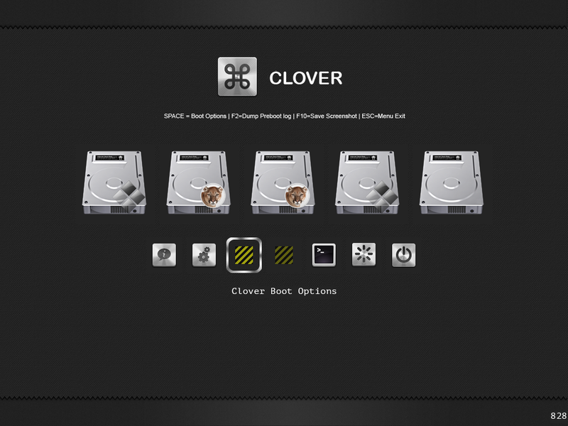

Bruxo Posted December 29, 2013 Share Posted December 29, 2013 (edited) I'm friends with a question regarding the configuration of a specific starting CloverEFI in HD! I have two hd's. An installed the Mavericks 10.9.1 which I use as the main system and another installed 10.9.2 Mavericks (Build13C32 beta) for testing. Except that when I boot the boot by CloverEFI, he fires up the HD test and not on my main system. How do I change the automatic boot hd test for my main? You can identify the HD boot by config.plist clover by UUID specific HD!!! I've discovered a really strange issue with an Asrock B85M Pro4 board doing UEFI boot with Clover (r2403): I setup a 10.9 hard disk drive with Clover in UEFI boot mode. When I put the drive into a USB enclosure and connect it to the board, it boots up fine. But when I connect the same drive directly to one of the board's SATA ports it refuses to boot. The UEFI (tried V1.60 and V1.90, both patched with PMPatch and vanilla) doesn't recognize the drive as boot device. Has anyone else observed this issue with Asrock boards too? Mieze In what formats are your boot drives?? Edited December 29, 2013 by Bruxo Link to comment https://www.insanelymac.com/forum/topic/284656-clover-general-discussion/page/137/#findComment-1980015 Share on other sites More sharing options...
Mieze Posted December 29, 2013 Share Posted December 29, 2013 In what formats are your boot drives?? HFS+ (Journaled) with GPT partition scheme setup on a real Mac with Disk Utility. I always do OS X installation on real Macs as it makes things much easier. Mieze Link to comment https://www.insanelymac.com/forum/topic/284656-clover-general-discussion/page/137/#findComment-1980016 Share on other sites More sharing options...
Bruxo Posted December 29, 2013 Share Posted December 29, 2013 HFS+ (Journaled) with GPT partition scheme setup on a real Mac with Disk Utility. I always do OS X installation on real Macs as it makes things much easier. Mieze Check in the drive uses UEFI Bios is represented as EFI boot boot!! If not possiver! Riding EFI system partition and check if anything wrong in Clover installed in this unit, check also if RC scripts were installed on that partition! Link to comment https://www.insanelymac.com/forum/topic/284656-clover-general-discussion/page/137/#findComment-1980018 Share on other sites More sharing options...
Mieze Posted December 29, 2013 Share Posted December 29, 2013 Check in the drive uses UEFI Bios is represented as EFI boot boot!! If not possiver! Riding EFI system partition and check if anything wrong in Clover installed in this unit, check also if RC scripts were installed on that partition! Yes, I checked the Clover installation and UEFI setup several times and found no error but the issue remains: connected via USB: UEFI recognizes the drive as bootable and Clover successfully boots OS X. connected via SATA: UEFI doesn't recognize any boot device (the drive is the only one in the system). Secure boot is disabled (tried both settings) and CSM enabled (also tried both) but those settings doesn't seem to have any influence. Mieze Link to comment https://www.insanelymac.com/forum/topic/284656-clover-general-discussion/page/137/#findComment-1980025 Share on other sites More sharing options...
Bruxo Posted December 29, 2013 Share Posted December 29, 2013 Yes, I checked the Clover installation and UEFI setup several times and found no error but the issue remains: connected via USB: UEFI recognizes the drive as bootable and Clover successfully boots OS X. connected via SATA: UEFI doesn't recognize any boot device (the drive is the only one in the system). Secure boot is disabled (tried both settings) and CSM enabled (also tried both) but those settings doesn't seem to have any influence. Mieze Doing so: Initialize a pendriver with Clover; go to Boot Options Clover; add the UEFI Boot options 1 Link to comment https://www.insanelymac.com/forum/topic/284656-clover-general-discussion/page/137/#findComment-1980026 Share on other sites More sharing options...

Mieze Posted December 29, 2013 Share Posted December 29, 2013 Doing so: Initialize a pendriver with Clover; go to Boot Options Clover; add the UEFI Boot options Hello Bruxo, that worked and resolved the issue. Now I can even disable CSM. Obrigada! Mieze Link to comment https://www.insanelymac.com/forum/topic/284656-clover-general-discussion/page/137/#findComment-1980077 Share on other sites More sharing options...
Bruxo Posted December 29, 2013 Share Posted December 29, 2013 Hello Bruxo, that worked and resolved the issue. Now I can even disable CSM. Obrigada! Mieze enjoy! Link to comment https://www.insanelymac.com/forum/topic/284656-clover-general-discussion/page/137/#findComment-1980090 Share on other sites More sharing options...
