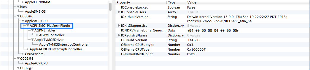

1. Power management seems to be working, I get a lot of turbo states but this likely seems to be Mavericks kernel power management.

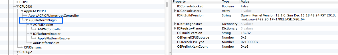

It appears there is still problem with kernel power management then since that's what the fourth generation cpus now use in os x. So messing with the other stuff is probably not really doing anything useful. As for the SLIC, you can place SLIC.aml in \EFI\CLOVER\acpi\Windows\ and it will inject it. Previously it only injected the SLIC placed in this folder without checking for or dropping the previous SLIC which it should now do, removing any conflict that occured.
Although I see there appears to be a few more changes for haswell, if you can build 2431, there is no official package though.

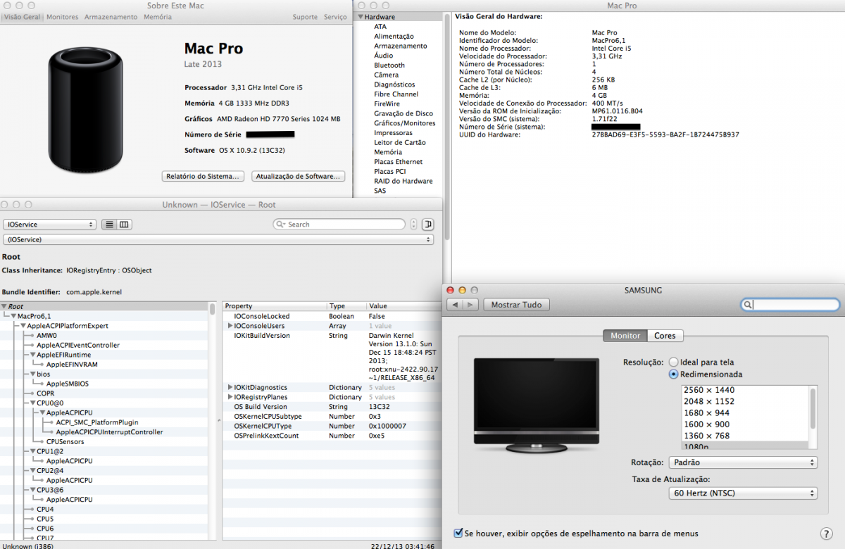

4º - I need a IOREG that your machine to check the control ACPI if it is correct.
Post everything to análizes and return the result set!
Your machine is compatible with the latest release 10.9.2 Beta Apple in the month of Desembro!

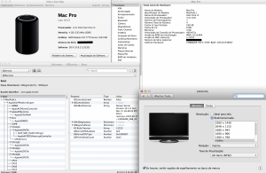

IOREG is to debug your ACPI if it is correct!!
Understand that no native ACPI, Avera not sleep or SpeedStep!!
I just make sure everything is correct, or needs corrections;
Attach DSDT, SSDT and IOREG!
@magnifico, newest revision 2435 should fix your restart issue, I think....
@frankiee, it most likely is a combination of unsupported hardware and incorrect ACPI patches/modifications. Bruxo seems to be able to help.
Project to build, but my processor Sandy and is not Ivy or Haswell!
My project:
Make sure there will AGPM this project!
Frankiee download this file!
He then generate SSDT post the result here for analysis.
His IOREG demonstrate activation ACPI wrong for your processor:
Your IOREG demonstration ACPI_SMC_PlatformPlugin
The Right to be X86PlatformPlugin
This is due to the use of Mac Pro5,1 and he did not use Ivy processor
Ivy be used in Mac Pro6,1
ssdtPRGen.zip
