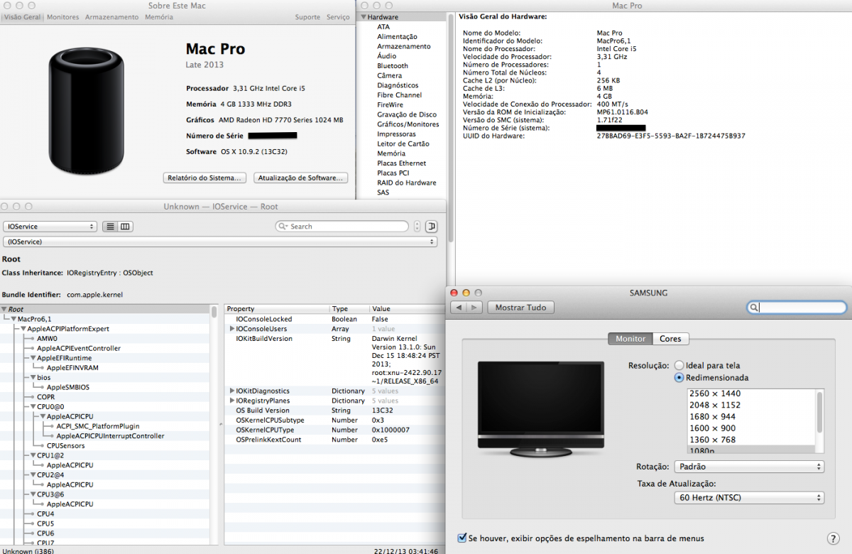

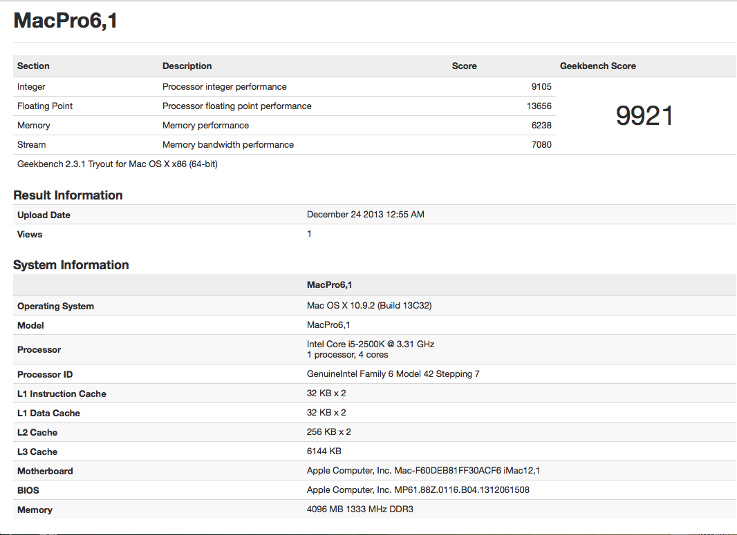

Bruxo Posted January 2, 2014 Share Posted January 2, 2014 Frankiee I do not take your personal comments! Now you could read your posts, since I integrate 6.1 to Config.plist you a long time! What about CPUs I just do what is routine but here is how I do lab tests and do not have your setup for more tests yet! MacPro6,1 </dict> <key>SMBIOS</key> <dict> <key>BiosVendor</key> <string>Apple Computer, Inc.</string> <key>BiosVersion</key> <string>MP61.88Z.0116.B04.1312061508</string> <key>Board-ID</key> <string>Mac-F60DEB81FF30ACF6</string> <key>BoardManufacturer</key> <string>Apple Computer, Inc.</string> <key>ChassisManufacturer</key> <string>Apple Computer, Inc.</string> <key>Family</key> <string>Mac Pro</string> <key>Manufacturer</key> <string>Apple Computer, Inc.</string> <key>ProductName</key> <string>MacPro6,1</string> <key>SerialNumber</key> <string>F5KLT016F694</string> <key>Trust</key> <true/> <key>Version</key> <string>1.0</string> </dict> Take care! This is a bomb in the wrong hands kkkkkkkk Link to comment https://www.insanelymac.com/forum/topic/284656-clover-general-discussion/page/140/#findComment-1981220 Share on other sites More sharing options...
frankiee Posted January 2, 2014 Share Posted January 2, 2014 Now you could read your posts, since I integrate 6.1 to Config.plist you a long time! Ahh. Yes you are right, I must have overlooked that. Thanks alot, I will try this now and look what happens. What about CPUs I just do what is routine but here is how I do lab tests and do not have your setup for more tests yet! Yeah, I think esp. with fewer cores you will not run into that problem. But if you have >10 cores and entries C00A+ are missing, then boot fails. So it seems while you can delete CPU definitions that are not actually needed, it is not working the other way round. Take care! This is a bomb in the wrong hands kkkkkkkk Yeah no worries! I only use that for testing. For my real setup I will generate that file from anew anyway. Thanks again! Link to comment https://www.insanelymac.com/forum/topic/284656-clover-general-discussion/page/140/#findComment-1981230 Share on other sites More sharing options...
Bruxo Posted January 2, 2014 Share Posted January 2, 2014 Frankiee Truth be careful! Here I make test with 6.1 and have turbo system! He fully utilize ACPI control its power. Link to comment https://www.insanelymac.com/forum/topic/284656-clover-general-discussion/page/140/#findComment-1981233 Share on other sites More sharing options...
Fab1Man Posted January 2, 2014 Share Posted January 2, 2014 Bruxo, could I fix my issue with SpeedStep not properly working with Haswell by using MacPro6,1 SMBIOS? I currently use the MacPro5,1 and added the MacPro5,1 Board-ID to X86PlatformPlugin, copied from an iMac 14,2 Board-ID. This worked on my Ivy Bridge build, on which I had SpeedStep working with MacPro5,1 SMBIOS, but Haswell seems to work different, even more since it's working through the kernel. SSDT or letting Clover patch it on the fly makes no difference in result. Link to comment https://www.insanelymac.com/forum/topic/284656-clover-general-discussion/page/140/#findComment-1981267 Share on other sites More sharing options...
apianti Posted January 2, 2014 Share Posted January 2, 2014 I don't see any device ids because I think in linux you need to also specify -n or -nn. It must be a device id issue as linux is using the generic ehci pci driver... Change Devices/FakeID/XHCI to hex device id you want to fake, then make sure you enable ACPI/DSDT/Fixes/FixUSB_1000=true. Also it is always a good idea to use a patched dsdt even though it may be difficult to patch, since you probably need many other fixes and why you have sleep issue. This issue is most definitely caused by improper dsdt for os x, it's happened to many people. I think that just fixing ehci will probably fix it though. About cpu, what does your boot.log look like, can you post it? @Fab1Man, you should definitely use the MacPro6,1 smbios since it's the only one that has true haswell support. Unless you plan on using MacBookPro smbios, in which case you'll probably have many more issues.... Link to comment https://www.insanelymac.com/forum/topic/284656-clover-general-discussion/page/140/#findComment-1981270 Share on other sites More sharing options...
Pike R. Alpha Posted January 3, 2014 Share Posted January 3, 2014 @Fab1Man, you should definitely use the MacPro6,1 smbios since it's the only one that has true haswell support. Unless you plan on using MacBookPro smbios, in which case you'll probably have many more issues.... Why do you say that? First. The new Mac Pro comes with Ivy Bridge Xeon's and isn't even available with a single Haswell processor, and secondly. Apple uses FrequencyVectors for models that come with a Haswell processor, to support a new feature in Mavericks. One of them being: In OS X Mavericks, Timer Coalescing groups low-level operations together, creating tiny periods of idle time that allow your CPU to enter a low-power state more often. With its activity reduced up to 72 percent, the CPU uses less energy, giving your battery a break, too. This happens so fast you won’t notice a thing. And your Mac still gets just as much done just as quickly. Note: This feature is currently not supported by the new Mac Pro. 1 Link to comment https://www.insanelymac.com/forum/topic/284656-clover-general-discussion/page/140/#findComment-1981289 Share on other sites More sharing options...
Bruxo Posted January 3, 2014 Share Posted January 3, 2014 Bruxo, could I fix my issue with SpeedStep not properly working with Haswell by using MacPro6,1 SMBIOS? I currently use the MacPro5,1 and added the MacPro5,1 Board-ID to X86PlatformPlugin, copied from an iMac 14,2 Board-ID. This worked on my Ivy Bridge build, on which I had SpeedStep working with MacPro5,1 SMBIOS, but Haswell seems to work different, even more since it's working through the kernel. SSDT or letting Clover patch it on the fly makes no difference in result. Can not deduce anything without knowing what to have on hand! What is your hardware? Furthermore we know that the active X86PlatformPlugin not only SMBIOS, but a group among them "SMBIOS + SSDT edition! Regarding Mac Pro6 a set of several Xeons including: Intel Xeon E5-1620 v2@3.70 GHz 1 processor, 4 cores, 8 threads It faces a haswell i7! But this hypothesis is not confirmed yet! In respect of the ACPI Mac Pro6 everything indicates that we can edit X86PlatformPlugin.kext Mac-F60DEB81FF30ACF6.plist to meet our daily Box Specifications! Link to comment https://www.insanelymac.com/forum/topic/284656-clover-general-discussion/page/140/#findComment-1981302 Share on other sites More sharing options...
