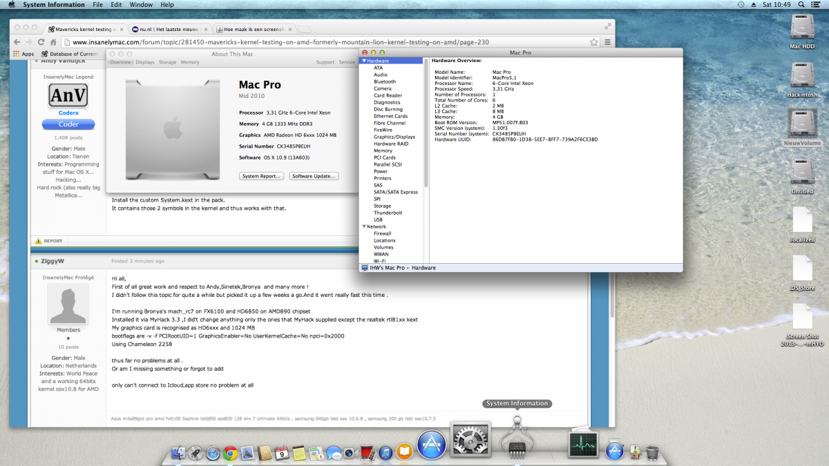

Hi all,
First of all great work and respect to Andy,Sinetek,Bronya  and many more !
I didn't follow this topic for quite a while but picked it up a few weeks a go.And it went really fast this time .
I'm running Bronya's mach_rc7 on FX6100 and HD6850 on AMD890 chipset
Installed it via MyHack 3.3 ,I did't change anything only the ones that MyHack supplied except the realtek rtl81xx kext
My graphics card is recognised as HD6xxx and 1024 MB
bootflags are -v -f PCIRootUID=1 GraphicsEnabler=No UserKernelCache=No npci=0x2000
Using Chameleon 2258
thus far no problems at all .
Or am I missing something or forgot to add
only can't connect to Icloud,app store no problem at all
