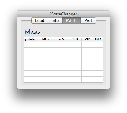

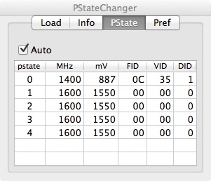

aziiz3 Posted November 10, 2013 Share Posted November 10, 2013 Ok, family is the same as 0x00600000 which happens to be Bulldozer and Piledriver. I noticed that it uses the same mechanism as K10 (kext defaults for families above 0x00200000 to the following: inline UInt32 AMDGetK11Frequency(UInt8 fid, UInt8 did) { return (100 * (fid + 0x08) >> did);} Which is bad for K15. K15 is the same as K10 namely: inline UInt32 AMDGetK10Frequency(UInt8 fid, UInt8 did) { return (100 * (fid + 0x10) >> did);} According to the AMD CPU docs. I modified the kext, could you guys (gils + aziiz) test the new PM pack? Normally the frequency should be correct now... Please test and post the following table (see screenshot) EDIT: Oh yeah, and also the CPU max frequency please... so I can compare... my cpu max frequency should be : 3300Mhz/3.3Ghz and this is the table: Link to comment https://www.insanelymac.com/forum/topic/281450-mavericks-kernel-testing-on-amd-formerly-mountain-lion-kernel-testing-on-amd/page/170/#findComment-1966371 Share on other sites More sharing options...
Andy Vandijck Posted November 10, 2013 Share Posted November 10, 2013 my cpu max frequency should be : 3300Mhz/3.3Ghz and this is the table: ps copy.jpg Damn... still not good...Going to check it tomorrow evening I'm tired so I'm gonna get some sleep... Link to comment https://www.insanelymac.com/forum/topic/281450-mavericks-kernel-testing-on-amd-formerly-mountain-lion-kernel-testing-on-amd/page/170/#findComment-1966376 Share on other sites More sharing options...
aziiz3 Posted November 10, 2013 Share Posted November 10, 2013 Damn... still not good... Going to check it tomorrow evening I'm tired so I'm gonna get some sleep... OK, Sleep tight andy Link to comment https://www.insanelymac.com/forum/topic/281450-mavericks-kernel-testing-on-amd-formerly-mountain-lion-kernel-testing-on-amd/page/170/#findComment-1966377 Share on other sites More sharing options...
