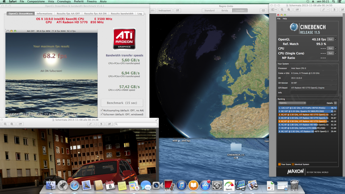

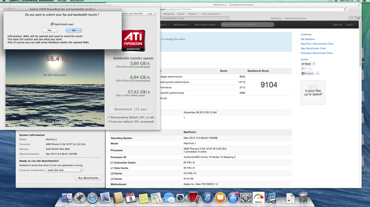

I got clover working, I had to disable usb injection and ownership and disable fix usb in DSDT, and I currently have Mavericks running with cinebench giving a 65 FPS score, perfectly smooth. I'm going to get a game downloaded on steam and see how that goes.
nVidia works just as well as ATI now. Running some test on my GT430 (Worked OOB).
attachicon.gifScreen Shot 2013-11-08 at 00.37.41.png attachicon.gifScreen Shot 2013-11-08 at 00.38.33.png

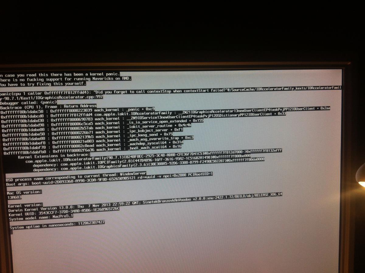

How did you GT430 working and QE/CI? Mine is not want to work :( I am using Sinetek kernel with graphics fix, boot with:
npci=0x2000 GraphicsEnabler=Yes PCIRootUID=1 -v
and Mavericks see my card and in system I can see the full name with 1024mb but I've got no QE/CI.
Any kext added, drivers, or something?
I don't have NVDResman.kext in my Extensions, but if I will add it to my Extensions then I've got KP like this (no matter what flags):
So the NVDAResman is not a problem, because we can delete it :)
But I am still don't have QE/CI and my graphics is with some artifacts :(
