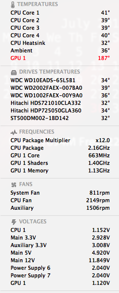

tot318 Posted July 29, 2012 Share Posted July 29, 2012 Try latest rev. from GitHub. Just uploaded with some changes. Impossible. Hide it from prefs app. Ok just installed the latest revision but it gives 187C....it can't be right.. Link to comment https://www.insanelymac.com/forum/topic/275429-hwsensors/page/23/#findComment-1838549 Share on other sites More sharing options...

kozlek Posted July 30, 2012 Author Share Posted July 30, 2012 Hi Kozlek, Great update to the application. Is there any chance you can include a way to also display the average load across all cores? Thanks. Don't think so. For other stuff use iStat Menus or similar. Ok just installed the latest revision but it gives 187C....it can't be right.. I still need your kernel log. Link to comment https://www.insanelymac.com/forum/topic/275429-hwsensors/page/23/#findComment-1838661 Share on other sites More sharing options...
tot318 Posted July 30, 2012 Share Posted July 30, 2012 Don't think so. For other stuff use iStat Menus or similar. I still need your kernel log. Here you go Darwin Kernel Version 12.0.0: Sun Jun 24 23:00:16 PDT 2012; root:xnu-2050.7.9~1/RELEASE_X86_64 vm_page_bootstrap: 6120149 free pages and 138539 wired pages kext submap [0xffffff7f8073e000 - 0xffffff8000000000], kernel text [0xffffff8000200000 - 0xffffff800073e000] zone leak detection enabled standard timeslicing quantum is 10000 us standard background quantum is 2500 us mig_table_max_displ = 74 corecrypto kext started! Running kernel space in FIPS MODE Plist hmac value is 735d392b68241ef173d81097b1c8ce9ba283521626d1c973ac376838c466757d Computed hmac value is 735d392b68241ef173d81097b1c8ce9ba283521626d1c973ac376838c466757d corecrypto.kext FIPS integrity POST test passed! corecrypto.kext FIPS AES CBC POST test passed! corecrypto.kext FIPS TDES CBC POST test passed! corecrypto.kext FIPS SHA POST test passed! corecrypto.kext FIPS HMAC POST test passed! corecrypto.kext FIPS ECDSA POST test passed! corecrypto.kext FIPS DRBG POST test passed! corecrypto.kext FIPS POST passed! AppleACPICPU: ProcessorId=1 LocalApicId=0 Enabled AppleACPICPU: ProcessorId=2 LocalApicId=2 Enabled AppleACPICPU: ProcessorId=3 LocalApicId=4 Enabled AppleACPICPU: ProcessorId=4 LocalApicId=6 Enabled AppleACPICPU: ProcessorId=5 LocalApicId=1 Enabled AppleACPICPU: ProcessorId=6 LocalApicId=3 Enabled AppleACPICPU: ProcessorId=7 LocalApicId=5 Enabled AppleACPICPU: ProcessorId=8 LocalApicId=7 Enabled AppleACPICPU: ProcessorId=9 LocalApicId=136 Disabled AppleACPICPU: ProcessorId=10 LocalApicId=137 Disabled AppleACPICPU: ProcessorId=11 LocalApicId=138 Disabled AppleACPICPU: ProcessorId=12 LocalApicId=139 Disabled AppleACPICPU: ProcessorId=13 LocalApicId=140 Disabled AppleACPICPU: ProcessorId=14 LocalApicId=141 Disabled AppleACPICPU: ProcessorId=15 LocalApicId=142 Disabled AppleACPICPU: ProcessorId=16 LocalApicId=143 Disabled calling mpo_policy_init for TMSafetyNet Security policy loaded: Safety net for Time Machine (TMSafetyNet) calling mpo_policy_init for Sandbox Security policy loaded: Seatbelt sandbox policy (Sandbox) calling mpo_policy_init for Quarantine Security policy loaded: Quarantine policy (Quarantine) Copyright (c) 1982, 1986, 1989, 1991, 1993 The Regents of the University of California. All rights reserved. MAC Framework successfully initialized using 16384 buffer headers and 10240 cluster IO buffer headers IOAPIC: Version 0x20 Vectors 64:87 IOAPIC: Version 0x20 Vectors 88:111 ACPI: System State [s0 S3 S4 S5] (S3) PFM64 (36 cpu) 0xf10000000, 0xf0000000 [ PCI configuration begin ] RTC: Only single RAM bank (128 bytes) AppleIntelCPUPowerManagement: (built 23:03:24 Jun 24 2012) initialization complete HWSensors Project Copyright 2012 netkas, slice, usr-sse2, kozlek, navi, THe KiNG. All rights reserved. FakeSMCDevice: 22 preconfigured key(s) added SMC: successfully initialized IntelThermal: CPU family 0x6, model 0x1a, stepping 0x4, cores 4, threads 8, TJmax 100 PCI configuration changed (bridge=7 device=3 cardbus=0) [ PCI configuration end, bridges 9 devices 21 ] mbinit: done [128 MB total pool size, (85/42) split] Pthread support ABORTS when sync kernel primitives misused rooting via boot-uuid from /chosen: 45DA2195-0C92-3235-A6FD-5BD31AFFDD0F Waiting on <dict ID="0"><key>IOProviderClass</key><string ID="1">IOResources</string><key>IOResourceMatch</key><string ID="2">boot-uuid-media</string></dict> com.apple.AppleFSCompressionTypeZlib kmod start com.apple.AppleFSCompressionTypeDataless kmod start com.apple.AppleFSCompressionTypeZlib load succeeded com.apple.AppleFSCompressionTypeDataless load succeeded AppleIntelCPUPowerManagementClient: ready [RealtekRTL81xx:init] RealtekRTL81xx.kext v0.0.90 (c)2010-2011 by Lnx2Mac (lnx2mac@gmail.com) FireWire runtime power conservation disabled. (2) SuperIODevice: found Winbond W83667HG on port=0x2e address=0x290 W836xMonitor: started [RealtekRTL81xx:init] _logLevel is now 132 (0x0084) [RealtekRTL81xx:init] Using updated PHY config method [RealtekRTL81xx:init] init completed [RTL81xx@0xe800:rtl8168_init_board] NIC identified as RTL8168C/8111C (mcfg=5) NouveauSensors: VBIOS successfully read from PRAMIN NouveauSensors: BIT VBIOS found NouveauSensors: detected an NV50 generation card (0x0a0100a2) with 896 Mib of GDDR3 memory Got boot device = IOService:/AppleACPIPlatformExpert/PCI0@0/AppleACPIPCI/SATA@1F,2/AppleAHCI/PRT2@2/IOAHCIDevice@0/AppleAHCIDiskDriver/IOAHCIBlockStorageDevice/IOBlockStorageDriver/WDC WD1002FAEX-00Y9A0 Media/IOGUIDPartitionScheme/LION@2 BSD root: disk2s2, major 1, minor 9 FireWire (OHCI) VendorID 1106 ID 3403 built-in now active, GUID 001e8c0001b23521; max speed s400. Kernel is LP64 No interval found for . Using 8000000 No interval found for . Using 8000000 No interval found for . Using 8000000 com_lnx2mac_RealtekRTL81xx: Ethernet address 00:23:54:a5:3c:42 Previous Shutdown Cause: 0 HDAEnabler: Copyright (c) 2008 by Kabyl HDAEnabler: 05/05/2008 Added SP-Audio support by Taruga HDAEnabler: 03/07/2009 Compiled for 32/64-bit by Taruga NVDANV50HAL loaded and registered. DSMOS has arrived [iOBluetoothHCIController][start] -- completed No interval found for . Using 8000000 No interval found for . Using 8000000 No interval found for . Using 8000000 AppleTyMCEDriver::start coreVIDPID = 0xffffffff Number of packages = 1 Number of cpus = 8 memory monitor trough MCA [AGPM Controller] build GPUDict by Vendor10deDevice05e2 macx_swapon SUCCESS Sound assertion "0 != result" failed in "/SourceCache/AppleHDA/AppleHDA-184.4.3/AppleHDA/AppleHDAWidget.cpp" at line 3794 goto handler Sound assertion "0 != widget->setUnsolicited ( true )" failed in "/SourceCache/AppleHDA/AppleHDA-184.4.3/AppleHDA/AppleHDACodecGeneric.cpp" at line 1099 goto handler coreaudiod (map: 0xffffff8031746ed0) triggered DYLD shared region unnest for map: 0xffffff8031746ed0, region 0x7fff8ca00000->0x7fff8cc00000. While not abnormal for debuggers, this increases system memory footprint until the target exits. CODE SIGNING: cs_invalid_page(0x1000): p=256[GoogleSoftwareUp] clearing CS_VALID Finder (map: 0xffffff8031746a48) triggered DYLD shared region unnest for map: 0xffffff8031746a48, region 0x7fff8e800000->0x7fff8ea00000. While not abnormal for debuggers, this increases system memory footprint until the target exits. System Preferenc (map: 0xffffff802f149ed0) triggered DYLD shared region unnest for map: 0xffffff802f149ed0, region 0x7fff8ca00000->0x7fff8cc00000. While not abnormal for debuggers, this increases system memory footprint until the target exits. plugin-container (map: 0xffffff802fd1dcb0) triggered DYLD shared region unnest for map: 0xffffff802fd1dcb0, region 0x7fff8ca00000->0x7fff8cc00000. While not abnormal for debuggers, this increases system memory footprint until the target exits. 0 [Time 1343595714] [Message Wake reason = RTC RTC: maintenance alarm 2012/7/29 21:50:05, sleep 2012/7/29 21:01:54 No interval found for . Using 8000000 No interval found for . Using 8000000 No interval found for . Using 8000000 Previous Sleep Cause: 0 Graphics suppressed 13209 ms 0 [Time 1343598636] [Message Wake reason = RTC RTC: maintenance alarm 2012/7/29 22:44:21, sleep 2012/7/29 21:50:37 No interval found for . Using 8000000 No interval found for . Using 8000000 No interval found for . Using 8000000 Previous Sleep Cause: 0 Graphics suppressed 13222 ms 0 [Time 1343601892] [Message Wake reason = RTC RTC: maintenance alarm 2012/7/29 23:38:37, sleep 2012/7/29 22:44:52 No interval found for . Using 8000000 No interval found for . Using 8000000 No interval found for . Using 8000000 Previous Sleep Cause: 0 Graphics suppressed 13183 ms 0 [Time 1343605148] [Message Wake reason = RTC RTC: maintenance alarm 2012/7/30 01:39:07, sleep 2012/7/29 23:39:08 No interval found for . Using 8000000 No interval found for . Using 8000000 No interval found for . Using 8000000 Previous Sleep Cause: 0 Graphics suppressed 13299 ms 0 [Time 1343612378] [Message Wake reason = RTC RTC: maintenance alarm 2012/7/30 03:39:37, sleep 2012/7/30 01:39:38 No interval found for . Using 8000000 No interval found for . Using 8000000 No interval found for . Using 8000000 Previous Sleep Cause: 0 Graphics suppressed 13191 ms 0 [Time 1343619608] [Message Wake reason = No interval found for . Using 8000000 No interval found for . Using 8000000 No interval found for . Using 8000000 Previous Sleep Cause: 0 The USB device Microsoft\M-B\M-. 2.4GHz Transceiver v6.0 (Port 1 of Hub at 0x3d000000) may have caused a wake by issuing a remote wakeup (2) HID tickle 157 ms Sound assertion "0 != result" failed in "/SourceCache/AppleHDA/AppleHDA-184.4.3/AppleHDA/AppleHDAWidget.cpp" at line 3794 goto handler Sound assertion "0 != widget->setUnsolicited ( true )" failed in "/SourceCache/AppleHDA/AppleHDA-184.4.3/AppleHDA/AppleHDACodecGeneric.cpp" at line 1099 goto handler Link to comment https://www.insanelymac.com/forum/topic/275429-hwsensors/page/23/#findComment-1838663 Share on other sites More sharing options...
kozlek Posted July 30, 2012 Author Share Posted July 30, 2012 Here you go Ok. Seems temperature diode is disabled. Did you used NVClock before and does it shows something? Link to comment https://www.insanelymac.com/forum/topic/275429-hwsensors/page/23/#findComment-1838669 Share on other sites More sharing options...
tot318 Posted July 30, 2012 Share Posted July 30, 2012 Ok. Seems temperature diode is disabled. Did you used NVClock before and does it shows something? No, I never use NVClock before. Link to comment https://www.insanelymac.com/forum/topic/275429-hwsensors/page/23/#findComment-1838670 Share on other sites More sharing options...
kozlek Posted July 30, 2012 Author Share Posted July 30, 2012 No, I never use NVClock before. I could integrate NVClock i2c methods to read temperature from onboard monitoring chip. But before, could you install nvclock and run it to check the temps? NVClock: nvclock0.8b5_7-bin-universal.zip Install memomrymap.kext driver, reboot and run "nvclock" utility from the archive with "-T" parameter. Link to comment https://www.insanelymac.com/forum/topic/275429-hwsensors/page/23/#findComment-1838674 Share on other sites More sharing options...
tot318 Posted July 30, 2012 Share Posted July 30, 2012 I could integrate NVClock i2c methods to read temperature from onboard monitoring chip. But before, could you install nvclock and run it to check the temps? NVClock: nvclock0.8b5_7-bin-universal.zip Install memomrymap.kext driver, reboot and run "nvclock" utility from the archive with "-T" parameter. ok here is what I get sh-3.2# ./nvclock -T GT200 [GeForce GTX 260] => GPU temperature: 63C => Board temperature: 49C Just incase you want my kernel log after installation of memorymap.kext Darwin Kernel Version 12.0.0: Sun Jun 24 23:00:16 PDT 2012; root:xnu-2050.7.9~1/RELEASE_X86_64 vm_page_bootstrap: 6120149 free pages and 138539 wired pages kext submap [0xffffff7f8073e000 - 0xffffff8000000000], kernel text [0xffffff8000200000 - 0xffffff800073e000] zone leak detection enabled standard timeslicing quantum is 10000 us standard background quantum is 2500 us mig_table_max_displ = 74 corecrypto kext started! Running kernel space in FIPS MODE Plist hmac value is 735d392b68241ef173d81097b1c8ce9ba283521626d1c973ac376838c466757d Computed hmac value is 735d392b68241ef173d81097b1c8ce9ba283521626d1c973ac376838c466757d corecrypto.kext FIPS integrity POST test passed! corecrypto.kext FIPS AES CBC POST test passed! corecrypto.kext FIPS TDES CBC POST test passed! corecrypto.kext FIPS SHA POST test passed! corecrypto.kext FIPS HMAC POST test passed! corecrypto.kext FIPS ECDSA POST test passed! corecrypto.kext FIPS DRBG POST test passed! corecrypto.kext FIPS POST passed! AppleACPICPU: ProcessorId=1 LocalApicId=0 Enabled AppleACPICPU: ProcessorId=2 LocalApicId=2 Enabled AppleACPICPU: ProcessorId=3 LocalApicId=4 Enabled AppleACPICPU: ProcessorId=4 LocalApicId=6 Enabled AppleACPICPU: ProcessorId=5 LocalApicId=1 Enabled AppleACPICPU: ProcessorId=6 LocalApicId=3 Enabled AppleACPICPU: ProcessorId=7 LocalApicId=5 Enabled AppleACPICPU: ProcessorId=8 LocalApicId=7 Enabled AppleACPICPU: ProcessorId=9 LocalApicId=136 Disabled AppleACPICPU: ProcessorId=10 LocalApicId=137 Disabled AppleACPICPU: ProcessorId=11 LocalApicId=138 Disabled AppleACPICPU: ProcessorId=12 LocalApicId=139 Disabled AppleACPICPU: ProcessorId=13 LocalApicId=140 Disabled AppleACPICPU: ProcessorId=14 LocalApicId=141 Disabled AppleACPICPU: ProcessorId=15 LocalApicId=142 Disabled AppleACPICPU: ProcessorId=16 LocalApicId=143 Disabled calling mpo_policy_init for TMSafetyNet Security policy loaded: Safety net for Time Machine (TMSafetyNet) calling mpo_policy_init for Sandbox Security policy loaded: Seatbelt sandbox policy (Sandbox) calling mpo_policy_init for Quarantine Security policy loaded: Quarantine policy (Quarantine) Copyright (c) 1982, 1986, 1989, 1991, 1993 The Regents of the University of California. All rights reserved. MAC Framework successfully initialized using 16384 buffer headers and 10240 cluster IO buffer headers IOAPIC: Version 0x20 Vectors 64:87 IOAPIC: Version 0x20 Vectors 88:111 ACPI: System State [s0 S3 S4 S5] (S3) PFM64 (36 cpu) 0xf10000000, 0xf0000000 [ PCI configuration begin ] RTC: Only single RAM bank (128 bytes) AppleIntelCPUPowerManagement: (built 23:03:24 Jun 24 2012) initialization complete HWSensors Project Copyright 2012 netkas, slice, usr-sse2, kozlek, navi, THe KiNG. All rights reserved. FakeSMCDevice: 22 preconfigured key(s) added SMC: successfully initialized IntelThermal: CPU family 0x6, model 0x1a, stepping 0x4, cores 4, threads 8, TJmax 100 PCI configuration changed (bridge=7 device=3 cardbus=0) [ PCI configuration end, bridges 9 devices 21 ] mbinit: done [128 MB total pool size, (85/42) split] Pthread support ABORTS when sync kernel primitives misused rooting via boot-uuid from /chosen: 45DA2195-0C92-3235-A6FD-5BD31AFFDD0F Waiting on <dict ID="0"><key>IOProviderClass</key><string ID="1">IOResources</string><key>IOResourceMatch</key><string ID="2">boot-uuid-media</string></dict> com.apple.AppleFSCompressionTypeZlib kmod start com.apple.AppleFSCompressionTypeDataless kmod start com.apple.AppleFSCompressionTypeZlib load succeeded com.apple.AppleFSCompressionTypeDataless load succeeded AppleIntelCPUPowerManagementClient: ready [RealtekRTL81xx:init] RealtekRTL81xx.kext v0.0.90 (c)2010-2011 by Lnx2Mac (lnx2mac@gmail.com) FireWire runtime power conservation disabled. (2) SuperIODevice: found Winbond W83667HG on port=0x2e address=0x290 W836xMonitor: started [RealtekRTL81xx:init] _logLevel is now 132 (0x0084) [RealtekRTL81xx:init] Using updated PHY config method [RealtekRTL81xx:init] init completed [RTL81xx@0xe800:rtl8168_init_board] NIC identified as RTL8168C/8111C (mcfg=5) NouveauSensors: VBIOS successfully read from PRAMIN NouveauSensors: BIT VBIOS found NouveauSensors: detected an NV50 generation card (0x0a0100a2) with 896 Mib of GDDR3 memory Got boot device = IOService:/AppleACPIPlatformExpert/PCI0@0/AppleACPIPCI/SATA@1F,2/AppleAHCI/PRT2@2/IOAHCIDevice@0/AppleAHCIDiskDriver/IOAHCIBlockStorageDevice/IOBlockStorageDriver/WDC WD1002FAEX-00Y9A0 Media/IOGUIDPartitionScheme/LION@2 BSD root: disk2s2, major 1, minor 10 Kernel is LP64 FireWire (OHCI) VendorID 1106 ID 3403 built-in now active, GUID 001e8c0001b23521; max speed s400. No interval found for . Using 8000000 No interval found for . Using 8000000 No interval found for . Using 8000000 com_lnx2mac_RealtekRTL81xx: Ethernet address 00:23:54:a5:3c:42 Previous Shutdown Cause: 0 HDAEnabler: Copyright (c) 2008 by Kabyl HDAEnabler: 05/05/2008 Added SP-Audio support by Taruga HDAEnabler: 03/07/2009 Compiled for 32/64-bit by Taruga DSMOS has arrived [iOBluetoothHCIController][start] -- completed No interval found for . Using 8000000 No interval found for . Using 8000000 No interval found for . Using 8000000 AppleTyMCEDriver::start coreVIDPID = 0xffffffff Number of packages = 1 Number of cpus = 8 memory monitor trough MCA macx_swapon SUCCESS Sound assertion "0 != result" failed in "/SourceCache/AppleHDA/AppleHDA-184.4.3/AppleHDA/AppleHDAWidget.cpp" at line 3794 goto handler Sound assertion "0 != widget->setUnsolicited ( true )" failed in "/SourceCache/AppleHDA/AppleHDA-184.4.3/AppleHDA/AppleHDACodecGeneric.cpp" at line 1099 goto handler NVDANV50HAL loaded and registered. [AGPM Controller] build GPUDict by Vendor10deDevice05e2 driver_MapMemory[0xffffff802f884c00]::start(0xffffff802eb9e100) driver_MapMemory[0xffffff802f884c00]::copyGlobalMemory() coreaudiod (map: 0xffffff802fce20e8) triggered DYLD shared region unnest for map: 0xffffff802fce20e8, region 0x7fff8da00000->0x7fff8dc00000. While not abnormal for debuggers, this increases system memory footprint until the target exits. CODE SIGNING: cs_invalid_page(0x1000): p=233[GoogleSoftwareUp] clearing CS_VALID Finder (map: 0xffffff8031701ed0) triggered DYLD shared region unnest for map: 0xffffff8031701ed0, region 0x7fff8f600000->0x7fff8f800000. While not abnormal for debuggers, this increases system memory footprint until the target exits. System Preferenc (map: 0xffffff802fce2d98) triggered DYLD shared region unnest for map: 0xffffff802fce2d98, region 0x7fff8da00000->0x7fff8dc00000. While not abnormal for debuggers, this increases system memory footprint until the target exits. considerRebuildOfPrelinkedKernel driver.MapMemory triggered rebuild driver_MapMemoryUserClient[0xffffff8031600f00]::start(provider = 0xffffff802f884c00) driver_MapMemoryUserClient[0xffffff8031600f00]::clientMemoryForType() driver_MapMemoryUserClient[0xffffff8031600f00]::clientClose() driver_MapMemoryUserClient[0xffffff8031600f00]::stop(provider = 0xffffff802f884c00) driver_MapMemoryUserClient[0xffffff8031155a00]::start(provider = 0xffffff802f884c00) driver_MapMemoryUserClient[0xffffff8031155a00]::clientMemoryForType() driver_MapMemory[0xffffff802f884c00]::copyGlobalMemory() driver_MapMemoryUserClient[0xffffff8031155a00]::clientClose() driver_MapMemoryUserClient[0xffffff8031155a00]::stop(provider = 0xffffff802f884c00) firefox (map: 0xffffff802fce3ed0) triggered DYLD shared region unnest for map: 0xffffff802fce3ed0, region 0x7fff8da00000->0x7fff8dc00000. While not abnormal for debuggers, this increases system memory footprint until the target exits. Sandbox: sandboxd(2649) deny mach-lookup com.apple.coresymbolicationd Link to comment https://www.insanelymac.com/forum/topic/275429-hwsensors/page/23/#findComment-1838678 Share on other sites More sharing options...
kozlek Posted July 30, 2012 Author Share Posted July 30, 2012 ok here is what I get sh-3.2# ./nvclock -T GT200 [GeForce GTX 260] => GPU temperature: 63C => Board temperature: 49C That's result. Seems it's found monitoring chip. In the next update I'll try to implement i2c methods into driver. Link to comment https://www.insanelymac.com/forum/topic/275429-hwsensors/page/23/#findComment-1838679 Share on other sites More sharing options...
tot318 Posted July 30, 2012 Share Posted July 30, 2012 That's result. Seems it's found monitoring chip. In the next update I'll try to implement i2c methods into driver. great, hope the next release it will show my GTX260 temp correctly...thank you kozlek.... Link to comment https://www.insanelymac.com/forum/topic/275429-hwsensors/page/23/#findComment-1838682 Share on other sites More sharing options...

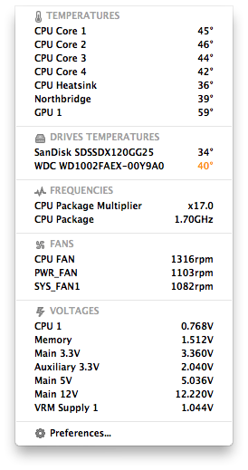

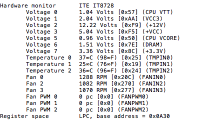

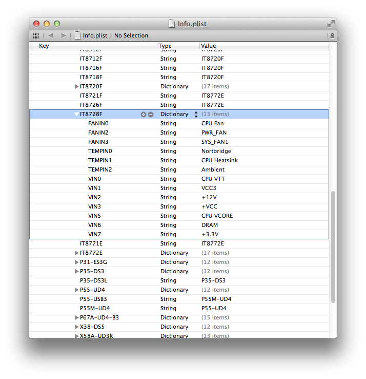

AppleGeek Posted July 30, 2012 Share Posted July 30, 2012 I don't understand what's the problem is. Ok, I will try to explain.It's not big deal for me I only want to fix my voltage values.I follow your guide in post #264 where you explain how to fix voltage values.So first step was take Dump from HWMonitor in windows, to find out sensors names. Second step that I did it was to set names for each sensor in IT8728F Dictionary, because I need to get Vraw value form HWMonitor from OSX, which I will need later.When I did this I loose all voltage sensors and also some temperature sensors.Ineed to delete the entireIT8728F Dictionary order to have some voltage values in hwmonitor.app I think there's problem with sensor detection. Thanks for your patience Link to comment https://www.insanelymac.com/forum/topic/275429-hwsensors/page/23/#findComment-1839048 Share on other sites More sharing options...
kozlek Posted July 31, 2012 Author Share Posted July 31, 2012 Ok, I will try to explain.It's not big deal for me I only want to fix my voltage values.I follow your guide in post #264 where you explain how to fix voltage values.So first step was take Dump from HWMonitor in windows, to find out sensors names. Second step that I did it was to set names for each sensor in IT8728F Dictionary, because I need to get Vraw value form HWMonitor from OSX, which I will need later.When I did this I loose all voltage sensors and also some temperature sensors.Ineed to delete the entireIT8728F Dictionary order to have some voltage values in hwmonitor.app I think there's problem with sensor detection. Thanks for your patience The names are hardcoded and couldn't be any. Use sensors names from other config from plist. Copy & paste them to prevent mistakes. P.S. Any hardcoded/predefined name could be on any position in the same sensors group (temperature group, voltage ...). Sensor name in plist that's how you tell to driver to assign specific SMC key to specific sensor input. Link to comment https://www.insanelymac.com/forum/topic/275429-hwsensors/page/23/#findComment-1839075 Share on other sites More sharing options...
AppleGeek Posted July 31, 2012 Share Posted July 31, 2012 My bad now I understand.Thank for your help. Here is modified Info.plist for Z68X-UD3H-B3 boards and for IT8728F i/o chips.Please can you add this to project Z68X-UD3H-B3.zip HWMonitor for OSX HWMonitor for Windows As you can see no there is no difference.Only I'm not sure about Auxiliary 3V but both programs shows same value.Maybe VCC3 is not Auxiliary 3V I don't know Link to comment https://www.insanelymac.com/forum/topic/275429-hwsensors/page/23/#findComment-1839318 Share on other sites More sharing options...
kozlek Posted July 31, 2012 Author Share Posted July 31, 2012 My bad now I understand.Thank for your help. Here is modified Info.plist for Z68X-UD3H-B3 boards and for IT2878E i/o chips.Please can you add this to project Z68X-UD3H-B3.zip HWMonitor for OSX HWMonitor for Windows As you can see no there is no difference.Only I'm not sure about Auxiliary 3V but both programs shows same value.Maybe VCC3 is not Auxiliary 3V I don't know Yes, sure. In the next update. 1 Link to comment https://www.insanelymac.com/forum/topic/275429-hwsensors/page/23/#findComment-1839333 Share on other sites More sharing options...
