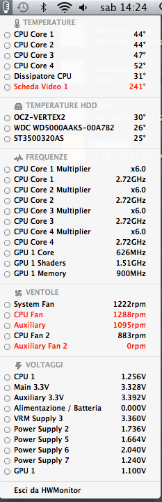

stefano.85 Posted May 12, 2012 Share Posted May 12, 2012 Hi Zokiek, i've got a problem with the last 2-3 revision of geforceX.kext and my geforce 9800gt G92... it shows me always 241°C... I've attached a screenshot of the problem. cheers and tnx in advance for troubleshooting... Link to comment https://www.insanelymac.com/forum/topic/275429-hwsensors/page/18/#findComment-1819999 Share on other sites More sharing options...
kozlek Posted May 12, 2012 Author Share Posted May 12, 2012 Hi Zokiek, i've got a problem with the last 2-3 revision of geforceX.kext and my geforce 9800gt G92... it shows me always 241°C... I've attached a screenshot of the problem. cheers and tnx in advance for troubleshooting... And it was ok before? From the beginning or after patches requested by Petruzska? Link to comment https://www.insanelymac.com/forum/topic/275429-hwsensors/page/18/#findComment-1820003 Share on other sites More sharing options...

kozlek Posted May 14, 2012 Author Share Posted May 14, 2012 oh, sorry but i don't remember that. In the last times i don't have so much time to follow all the changes and the discussions. If i remember correctly, the first two revisions of the new GeforceX plugin worked flawlessy, if you can attach one of the oldest one i can make a try (since i don't know where to find them). Tnx Please, try latest rev. Im using Asus temperature method now only if calibrated temperature register returns zero. Ok, I can confirm changing of the Farenheit conversion to (9.0f / 5.0f) * t + 32.0f it works properly and values match those from istat. Fixed now. Thanks for feedback. I didn't compared temps with iStat but I hope they should be correct Link to comment https://www.insanelymac.com/forum/topic/275429-hwsensors/page/18/#findComment-1820411 Share on other sites More sharing options...

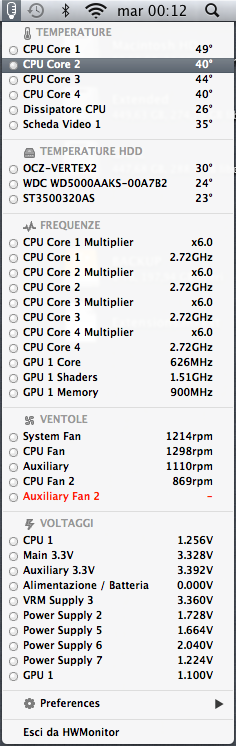

stefano.85 Posted May 14, 2012 Share Posted May 14, 2012 Please, try latest rev. Im using Asus temperature method now only if calibrated temperature register returns zero. Here i am! with your last revision 5d2a293 all works perfectly again! (see screenshot) as always... tnx for your feedback and for the time you spend on troubleshooting! cheers. Stefano Link to comment https://www.insanelymac.com/forum/topic/275429-hwsensors/page/18/#findComment-1820574 Share on other sites More sharing options...
