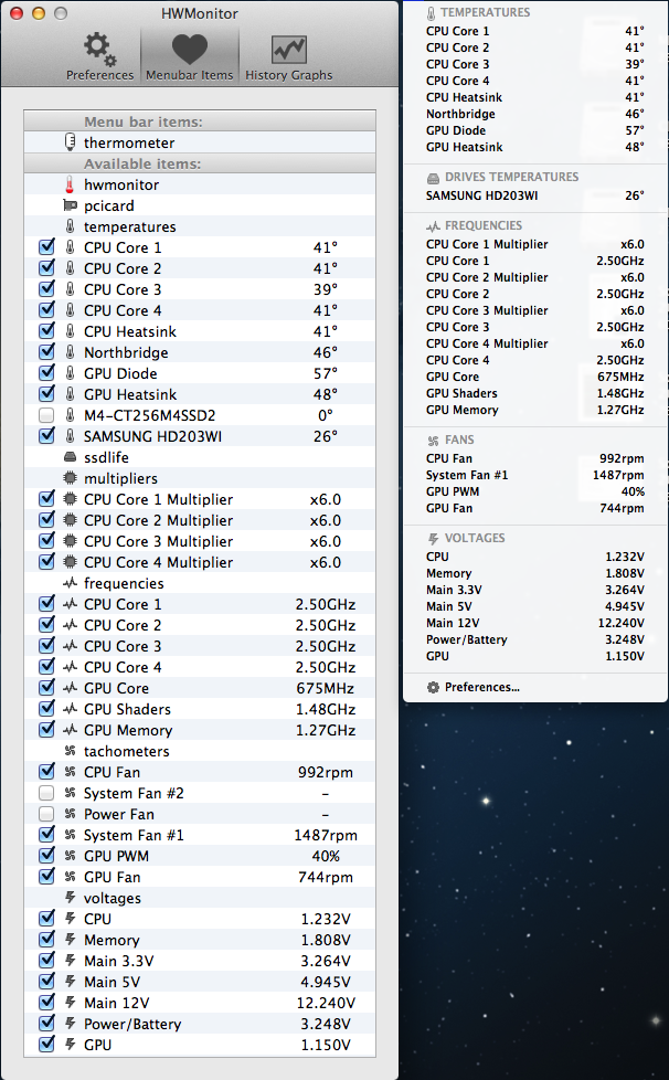

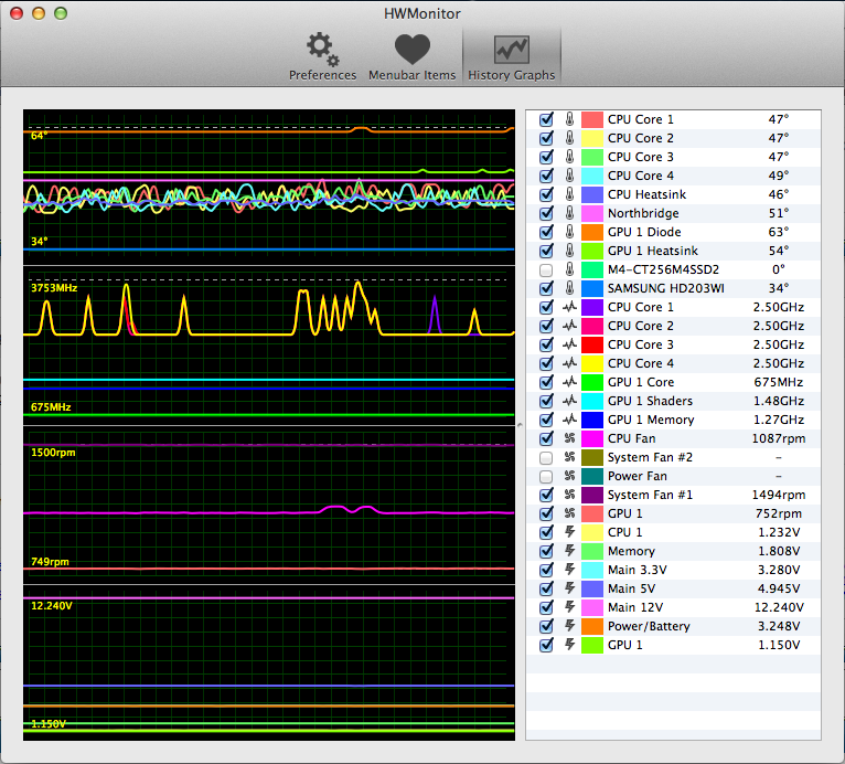

D-an-W Posted August 27, 2012 Share Posted August 27, 2012 I think your config should be the same as EP45-UD3R or EP45-DS3R, so add this line: If it'll be ok I'll add this section into project. That will be great, going to try it now... EDIT: So far so good, looks much better now! Can I ask what the Power/Battery figure of 3.248V is? Also, would I be ok to remove the "1" from the entries where I only have a single core GPU? Thanks again for the prompt reply kozlek. Link to comment https://www.insanelymac.com/forum/topic/275429-hwsensors/page/28/#findComment-1847958 Share on other sites More sharing options...

D-an-W Posted August 28, 2012 Share Posted August 28, 2012 After installing HWMonitor the keyboard backlight on my MacBook stopped working. I believe that may have been installed some kext that caused the problem. How do I fix? Has anyone experienced this? Personally, I would remove what you installed and see if it starts working again. Also, I could be wrong here but I think these files were developed for Hacks not Macs. @kozlek, many, many thanks for adding the ED45-UD3P! Can I ask, should I also be using the ACPISensors.kext file as I currently don't (It was showing up in the list of loaded kexts so I removed it)? Also, in the attached screenshot you can see a System Fan #1 and a CPU 1 entry remains, I assume you meant to remove the 1 from all these or was it just GPU entries you worked on? If possible, could you give me any more info on what the Power/Battery (3.248V) reading is telling me? Link to comment https://www.insanelymac.com/forum/topic/275429-hwsensors/page/28/#findComment-1848556 Share on other sites More sharing options...
kozlek Posted August 29, 2012 Author Share Posted August 29, 2012 If possible, could you give me any more info on what the Power/Battery (3.248V) reading is telling me? I don't know what is it. Link to comment https://www.insanelymac.com/forum/topic/275429-hwsensors/page/28/#findComment-1848655 Share on other sites More sharing options...
TimeWalker75a Posted August 29, 2012 Share Posted August 29, 2012 Isn't it cmos battery? That's the one w/ 3.3v 1 Link to comment https://www.insanelymac.com/forum/topic/275429-hwsensors/page/28/#findComment-1848671 Share on other sites More sharing options...
D-an-W Posted August 29, 2012 Share Posted August 29, 2012 I don't know what is it. Ok thanks, I will try and find more information on it. It could be the CMOS Battery voltage I guess... EDIT: Looks like TimeWalker75a and I agree on that Would it be possible to separate the Core Multipliers from the Frequencies as I think it would be more readable that way? Link to comment https://www.insanelymac.com/forum/topic/275429-hwsensors/page/28/#findComment-1848672 Share on other sites More sharing options...
kozlek Posted August 29, 2012 Author Share Posted August 29, 2012 Would it be possible to separate the Core Multipliers from the Frequencies as I think it would be more readable that way? No. Link to comment https://www.insanelymac.com/forum/topic/275429-hwsensors/page/28/#findComment-1848679 Share on other sites More sharing options...

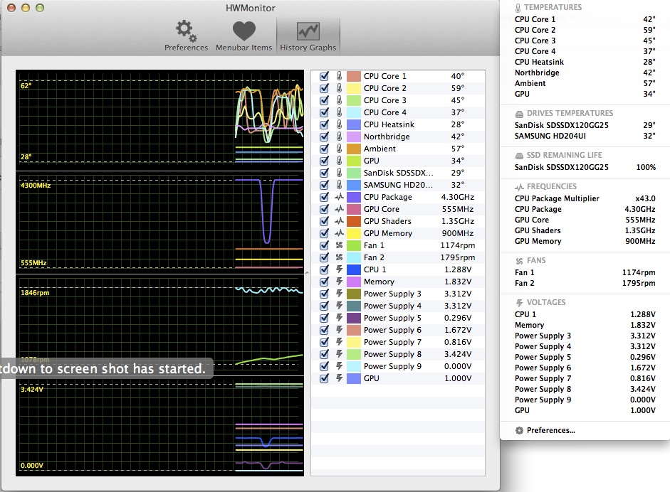

skysea76 Posted August 30, 2012 Share Posted August 30, 2012 With the latest release, I get the following: CPU temps and voltage seems correct (except there's quite an amplitude in between cores, but I'll have to check windows, who knows maybe I seated my heatsink wrong ), as does the GPU (I don't even think windows displays that much info, good work ). CPU heatsink, maybe (seems kind of low in comparison with CPU core). Ambient has to be off, it's ~15ºC in the room, so there's no way that ambient is going to be higher than the CPU by a whooping 5-10ºC. The latest release fixed the reading for my Fan 2 (it used to be red [?]; BTW Fan 1 = CPU Fan 1 and Fan 2 = Chassis Fan 2 for my motherboard). PSU 3 & 4 are 3v and 3v backup, this I'm sure of. The rest, I can't make heads or tails of... The memory is the only one that seems easy to fix (since I know which one it is and I have a BIOS value for it which I can calculate the gain with -1.6v as far as I can remember) Again, if someone can help me work out a working plist entry for my MB, it would be greatly appreciated... Link to comment https://www.insanelymac.com/forum/topic/275429-hwsensors/page/28/#findComment-1848922 Share on other sites More sharing options...
D-an-W Posted August 30, 2012 Share Posted August 30, 2012 Are there any boards in the plist that are close to yours? It was easy (For koxlek!) to get mine added as the UD3R was already in there, this made a huge difference to my display... Link to comment https://www.insanelymac.com/forum/topic/275429-hwsensors/page/28/#findComment-1848924 Share on other sites More sharing options...
skysea76 Posted August 30, 2012 Share Posted August 30, 2012 I've been looking at the plist, the closest would be the Z68 Pro3-M I guess, but as far as I could tell, the actual sensor configuration isn't that close... I tried editing it myself but I didn't get very far, since I can't determine the gain for many of the values (as I don't know what they correspond to in the BIOS, and OpenHWMonitor can't read them any better...). Link to comment https://www.insanelymac.com/forum/topic/275429-hwsensors/page/28/#findComment-1848925 Share on other sites More sharing options...
