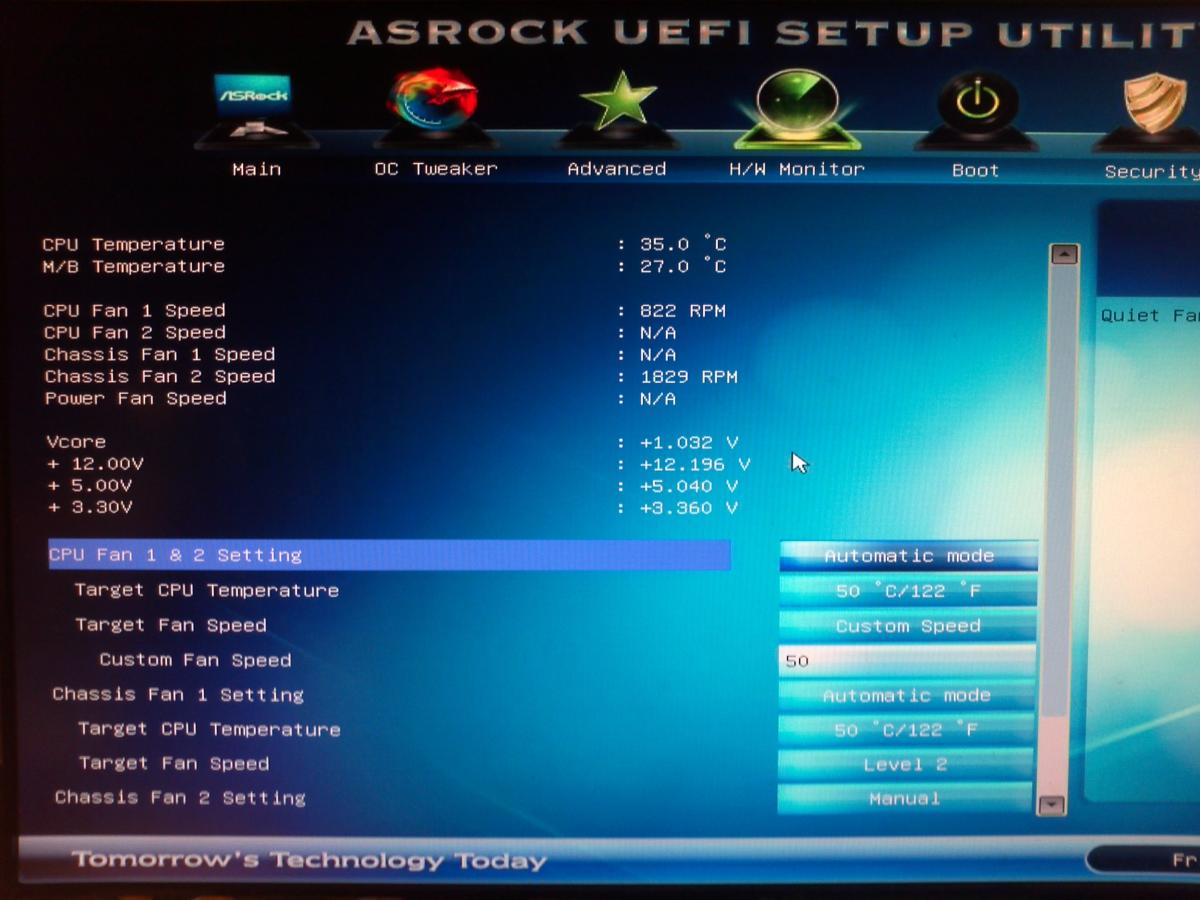

skysea76 Posted August 24, 2012 Share Posted August 24, 2012 Hi, I have an ASRock Z77 Pro4-M and I'm trying to get my NCT6776F to work with the latest release. If possible I'd like to get ACPISensors running, but I couldn't find much on this (checked projectosx.com), and basic monitoring would be a good start. This is what I've been able to gather: OpenHardwareMonitor Dump: Sensors | +- ASRock Z77 Pro4-M (/mainboard) | | | +- Nuvoton NCT6776F (/lpc/nct6776f) | | +- CPU VCore : 0.928 0.92 1.24 (/lpc/nct6776f/voltage/0) | | +- 12V : 1.84 1.832 1.84 (/lpc/nct6776f/voltage/1) | | +- AVCC : 3.328 3.328 3.328 (/lpc/nct6776f/voltage/2) | | +- 3VCC : 3.328 3.312 3.328 (/lpc/nct6776f/voltage/3) | | +- VIN4 : 0.04 0.04 0.304 (/lpc/nct6776f/voltage/4) | | +- VIN5 : 1.672 1.672 1.68 (/lpc/nct6776f/voltage/5) | | +- VIN6 : 0.816 0.816 0.816 (/lpc/nct6776f/voltage/6) | | +- 3VSB : 3.424 3.424 3.424 (/lpc/nct6776f/voltage/7) | | +- CPU Package : 29 29 30 (/lpc/nct6776f/temperature/1) | | +- Temperature #2 : 44.5 43 45 (/lpc/nct6776f/temperature/2) | | +- Motherboard : 28 28 28 (/lpc/nct6776f/temperature/3) | | +- CPU Fan : 823 823 828 (/lpc/nct6776f/fan/1) | | +- Chassis Fan 2 : 1829 1778 1839 (/lpc/nct6776f/fan/4) ASRock Utility: MB T: 28 CPU T: 37 5V: 5.016V DRAM: 1.6V VTT: 1.085V VCCSA: 0.925V 3.3v: 3.328V 12V: 12.144V PCH: 1.059V CPU PLL: 1.693V IGPU Voltage Offset: +0mV HWMonitor Dump: Mainboard Model Z77 Pro4-M (0x000002C7 - 0x163BC0C8) LPCIO ------------------------------------------------------------------------- LPCIO Vendor Nuvoton LPCIO Model NCT6776 LPCIO Vendor ID 0x5CA3 LPCIO Chip ID 0xC3 LPCIO Revision ID 0x33 Config Mode I/O address 0x2E Config Mode LDN 0xB Config Mode registers 00 01 02 03 04 05 06 07 08 09 0A 0B 0C 0D 0E 0F 00 FF FF 00 FF FF FF FF 0B FF FF FF FF FF FF FF FF 10 FF FF FF FF FF FF FF FF FF FF F0 68 80 00 FF FF 20 C3 33 FF 00 5C 00 00 C0 00 FF 62 08 80 00 00 03 30 E1 FF FF FF FF FF FF FF FF FF FF FF FF FF FF FF 40 FF FF FF FF FF FF FF FF FF FF FF FF FF FF FF FF 50 FF FF FF FF FF FF FF FF FF FF FF FF FF FF FF FF 60 02 90 00 00 FF FF FF FF FF FF FF FF FF FF FF FF 70 00 FF FF FF FF FF FF FF FF FF FF FF FF FF FF FF Register space LPC, base address = 0x0290 Hardware Monitors ------------------------------------------------------------------------- Hardware monitor Nuvoton NCT6776 Voltage 0 0.92 Volts [0x73] (CPU VCORE) Voltage 1 1.84 Volts [0xE6] (VIN1) Voltage 2 3.33 Volts [0xD0] (AVCC) Voltage 3 3.33 Volts [0xD0] (3VCC) Voltage 4 0.04 Volts [0x5] (VIN4) Voltage 5 1.67 Volts [0xD1] (VIN5) Voltage 6 0.82 Volts [0x66] (VIN6) Temperature 0 28∞C (82∞F) [0x1C] (SYSTIN) Temperature 1 31∞C (86∞F) [0x3D] (CPUTIN) Temperature 2 45∞C (112∞F) [0x59] (AUXTIN) Temperature 3 36∞C (96∞F) [0x24] (TMPIN3) Fan 1 827 RPM [0x33B] (CPUFANIN) Fan 4 1781 RPM [0x6F5] (AUXFANIN2) Link to comment https://www.insanelymac.com/forum/topic/275429-hwsensors/page/27/#findComment-1847344 Share on other sites More sharing options...

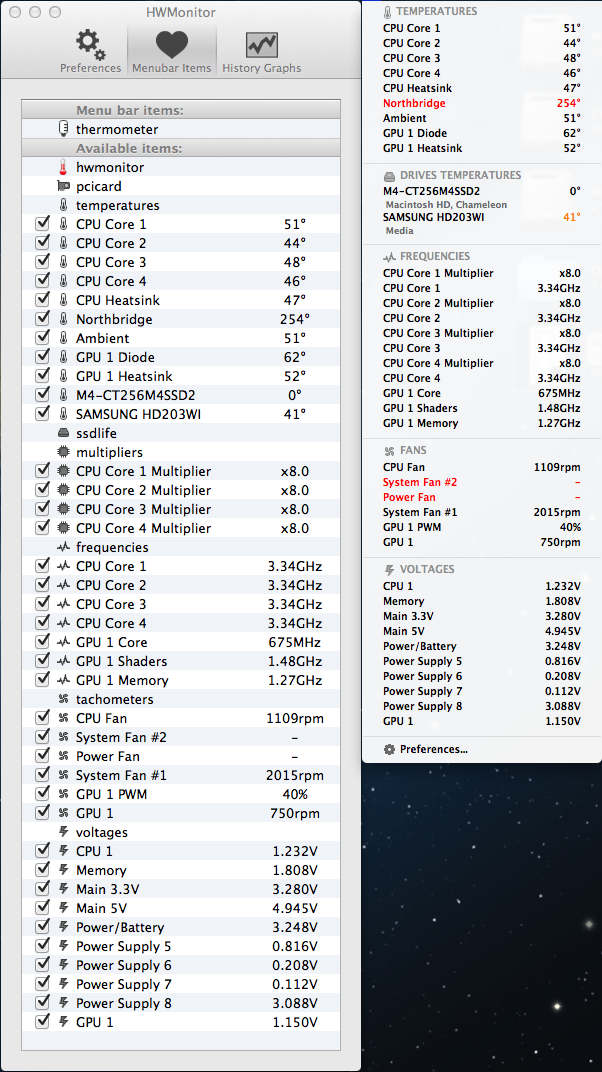

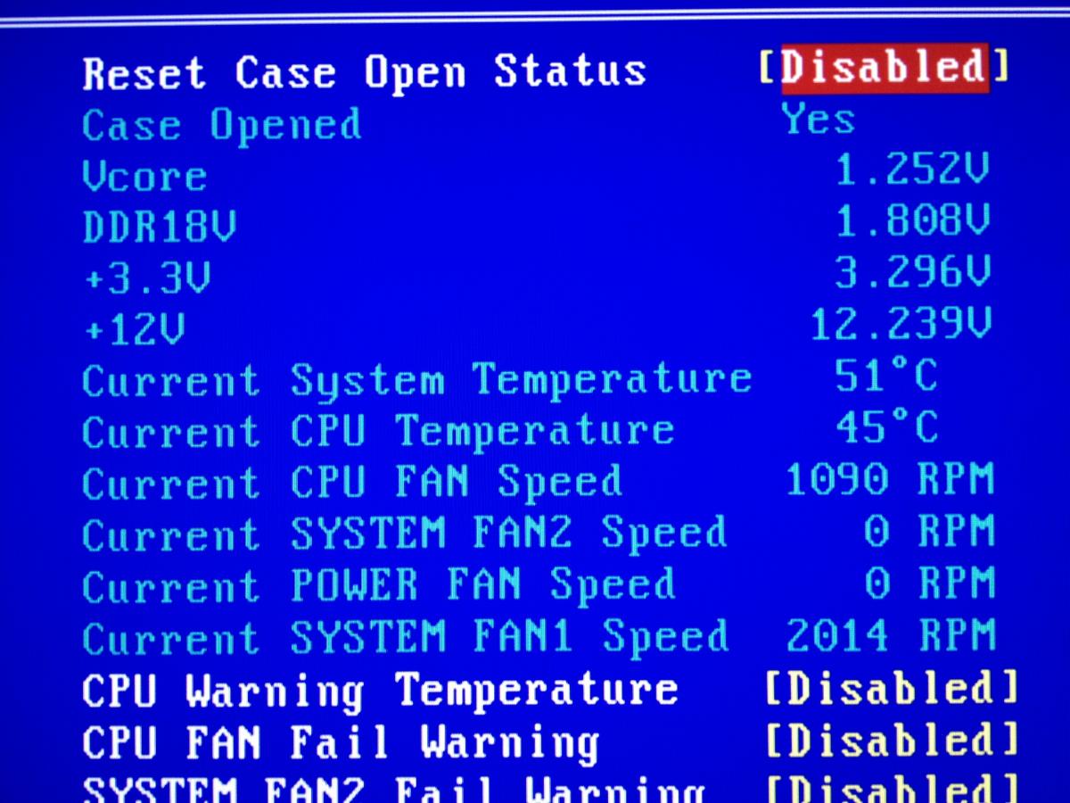

D-an-W Posted August 26, 2012 Share Posted August 26, 2012 Any tips on setting this up for my motherboard, a Gigabyte EP45-UD3P with iTE IT8718 controller. I have had a go at editing the info.plist but the section for the 8718 is empty and any attempt I made at editing a similar section just made that entry disappear from HWMonitor after Kext Utility and a reboot. I have a DarwinDumper report if that helps (Thanks blackosx) and also a couple of screenshots of the progress so far. I have loaded the following kexts in S/L/E CPUSensors.kext FakeSMC.kext GPUSensors.kext MotherboardSensors.kext If I add ACPISensors.kext it doesn't seem to make any difference to the readings. Thanks for any advice you folks can offer. Link to comment https://www.insanelymac.com/forum/topic/275429-hwsensors/page/27/#findComment-1847896 Share on other sites More sharing options...
kozlek Posted August 27, 2012 Author Share Posted August 27, 2012 Any tips on setting this up for my motherboard, a Gigabyte EP45-UD3P with iTE IT8718 controller. I have had a go at editing the info.plist but the section for the 8718 is empty and any attempt I made at editing a similar section just made that entry disappear from HWMonitor after Kext Utility and a reboot. I have a DarwinDumper report if that helps (Thanks blackosx) and also a couple of screenshots of the progress so far. I have loaded the following kexts in S/L/E CPUSensors.kext FakeSMC.kext GPUSensors.kext MotherboardSensors.kext If I add ACPISensors.kext it doesn't seem to make any difference to the readings. Thanks for any advice you folks can offer. I think your config should be the same as EP45-UD3R or EP45-DS3R, so add this line: If it'll be ok I'll add this section into project. 1 Link to comment https://www.insanelymac.com/forum/topic/275429-hwsensors/page/27/#findComment-1847943 Share on other sites More sharing options...
