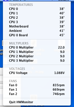

and here is the result
fan wrong & fixed
no multipler no volt no chipset temp :(
fan wrong & fixed

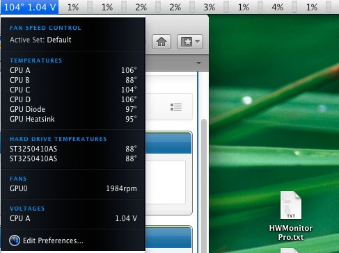

Latest Nuvoton kext didn't KP. Seems to be misreading though...
iStat
HWMonitor
