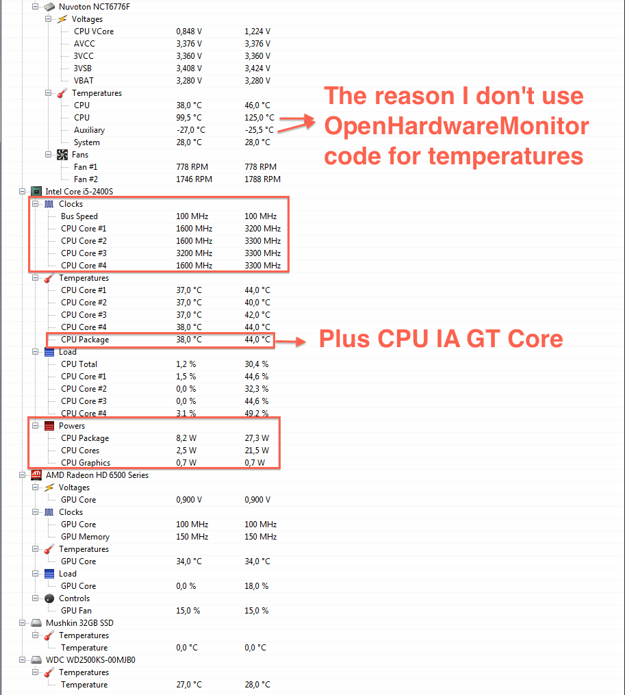

I fixed NCT677x plugin, at least for my setup but IMHO should work for others too.
Limited the temperatures to 2: Sytem and CPU,, the Auxiliary, as rest of NCT677x capable sensors reading temperature require a much elaborated code since it depends on Vendor implementation (if more then 2 fans are implemented and stuff like that).
OpenHardwareMonitor as Linux code is as best in beta stage, anyway they try to get max 3.
Voltages, only CPU and 3V one are correct, rest require a math(see datasheet and programming guide) and since I cant bet on iStat(it does own math depending on specific key) I need to have them implemented in monitoring app/menuextra, or figure out how to compile those, if possible...
Fans, only 2 are set for now, if you have more just add the desired name on FANINx entry in info.plist.
Enjoy!

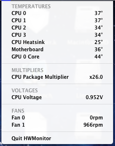

Works fine for me, thanks. :)
post-413183-0-12777300-1329183232_thumb.png post-413183-0-13818800-1329183300_thumb.png

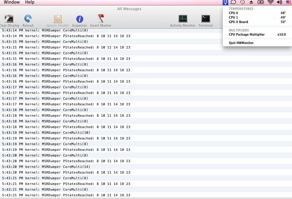

I only want to remember to check real stepping after using new fakesmc + intelthermal by msrdumper.
For me it was not only an cosmetic problem - showing an fixed 10* multiplier , it was real fixed multiplier problem. Stepping stopped working.
For me, IntelThermal shows fixed multiplier 10* and that was real - no stepping shown also in msr dumper. Went back to older fakesmc + InteCPUMonitor = stepping works again with same OSX and same dsdt.
Dont know if maybe bit newer builds or other C2D cpus like mine (E7400) dont have that effect but i would cross check stepping with msrdumper.
my first thinking: could it be that IntelThermal MSR reads can block the native AppleIntelCPU.kext in changing the MSR stepping tasks by timing problems / interrupt problems in the msr read code (maybe depends on CPU type also if problem happens) ?
